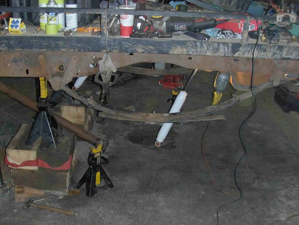

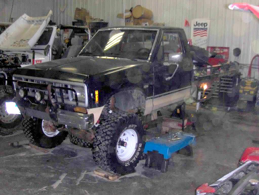

So anyway, on to the swap. First jack the truck up and put stands under the frame in front of the rear axle. Remove your rear tires, and put jack stands under the axle. Then, remove the U-bolts, soft brake line from the center of the axle, shocks, and e-brake cables. I have Skyjacker brake lines and am not hooking up the e-brake at all so yours may be different. I know that the Skyjacker brake line splitter block is different than the factory one. In any case it’s not a big deal. This is what you should end up with:
Shran's Ford Ranger
Stock rear axle removed

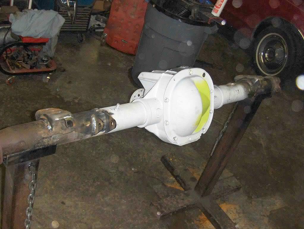

At this point, you should cut whatever you don’t need off of the 8.8. This included, for me, spring perches and sway bar mounts. Get your housing cleaned up after this and grind the new spring perches to fit if necessary (the Summit ones are for a 3” axle tube, the Ex 8.8 is 3.25”, so they just need to be ground a little bit.

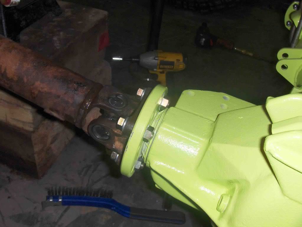

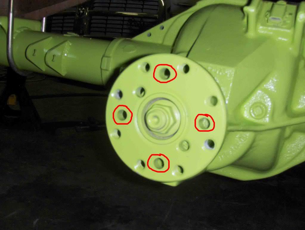

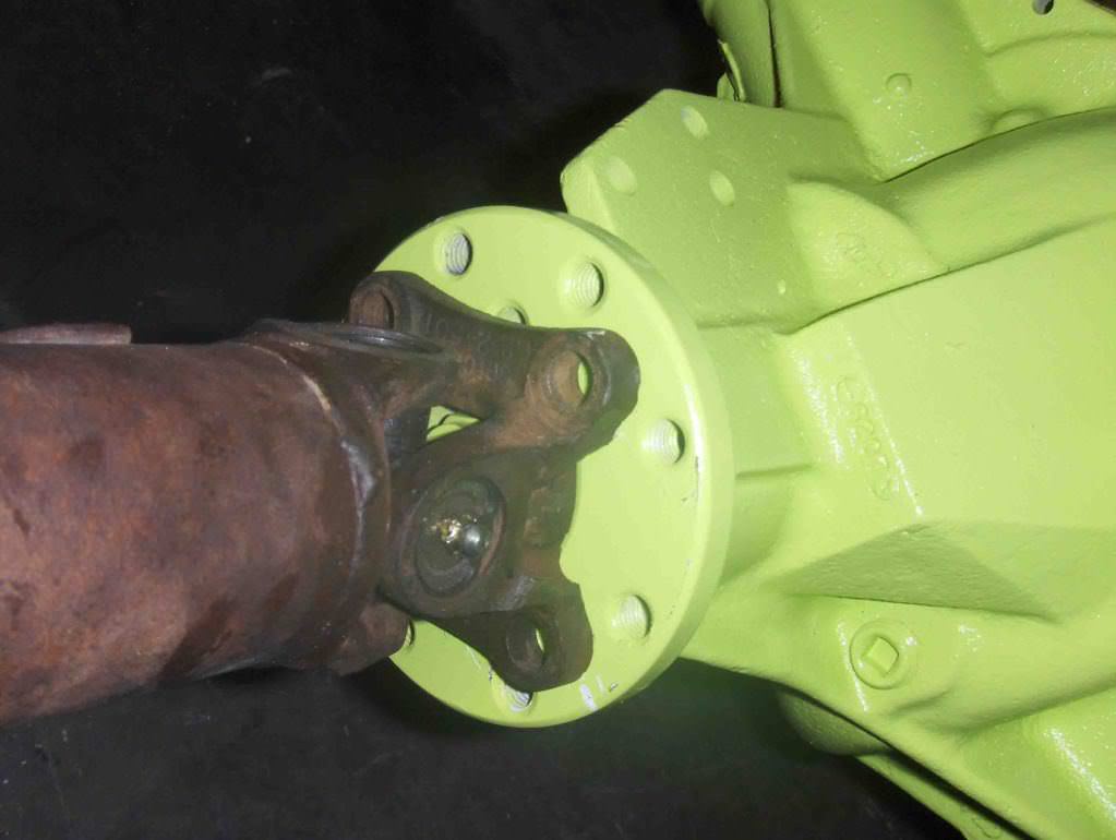

The next step depends on what you’re doing for a driveline. There are two different pinion yokes that come with an 8.8 – the smaller one in Rangers, and the larger one in Explorers and fullsize trucks. The problem here is that if you’re in my case, you have a 1210 u-joint in your stock driveline and the larger flange on the axle. There is not a conversion u-joint made, so after some experimentation, we found that the smaller driveline yoke will fit on the larger pinion flange, and you just need to drill holes since it’s drilled for the larger driveline yoke. If you’re doing the swap like I did, you will need to get this taken care of before moving further. Since I am going to be doing a 302/NP435/205 swap, I will have to get a new driveline built anyway so this will work fine for now.
Here’s what I meant by drilling new holes. The holes circled in red were not there to begin with.
Ford 8.8 axle swap
small yoke and big flange
And here’s how the small yoke is attached to the bigger flange:
Yoke bolted to flange

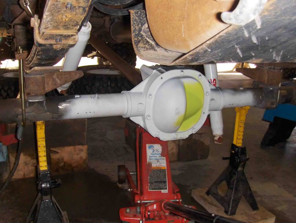

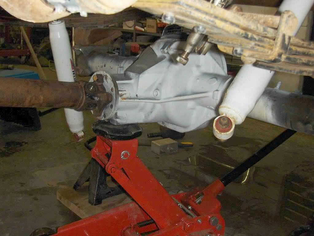

After this, get your new axle under the truck with the perches just sitting in there. Don’t weld anything yet because you need to set your pinion angle. Put your blocks in if you’re using blocks and put in one U-bolt per side. They need to be tight enough so that everything stays together, but not any tighter than this because you will be rotating the axle. At this point, you need to put a jack under the axle and lift so that the truck is off the jack stands that were under the frame. Drop these and lower the truck so that the rear axle is sitting on jack stands. You need to do this because your pinion angle can be measured accurately when the leaf springs are compressed like they would be when the tires are on and it’s sitting on the ground.
Axle on jack stands
Bolt your driveline on. Then, put a jack under the pinion yoke and rotate the axle by lifting. We just eyeballed the pinion angle. Have someone there with you that knows how to do this because it’s pretty important. The guy I had help me builds buggy’s and stuff. Once you get your pinion angle set, tack the perches in place. Then move on to your shocks. They should be at a slight outward angle. I put them about 4” away from the spring perches. Tack these on too.

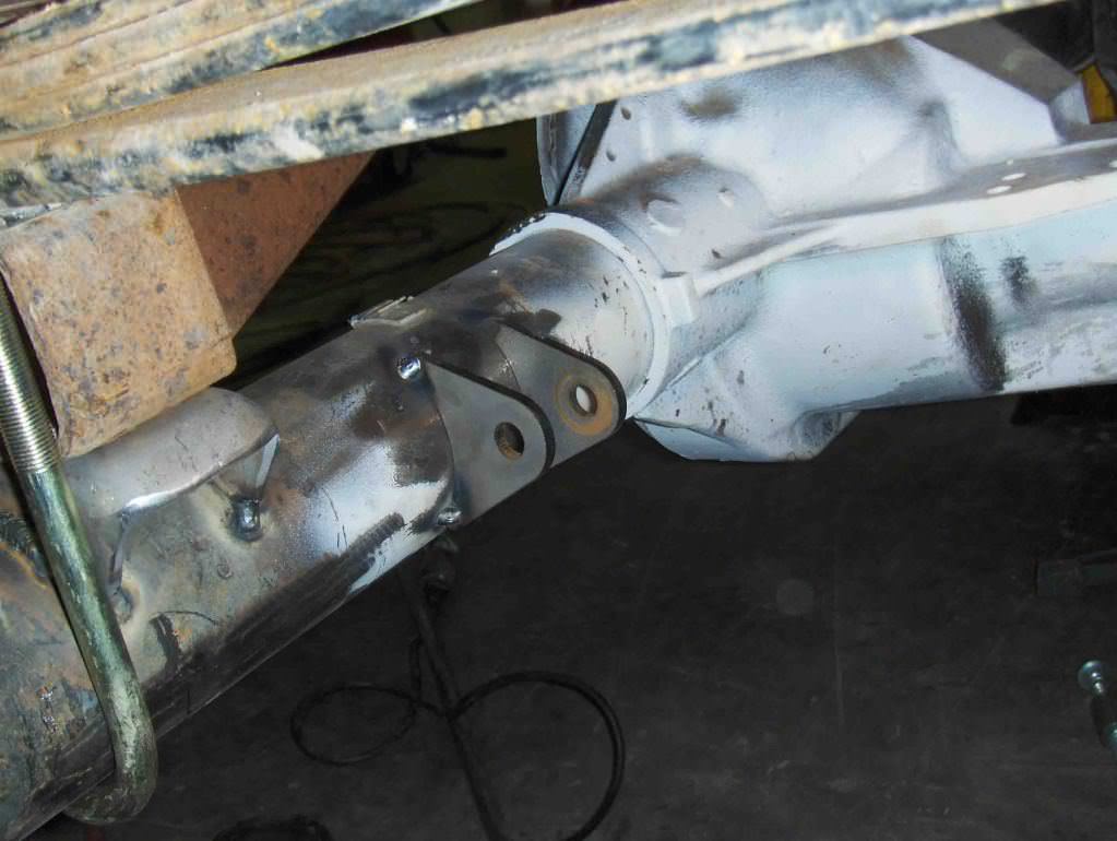

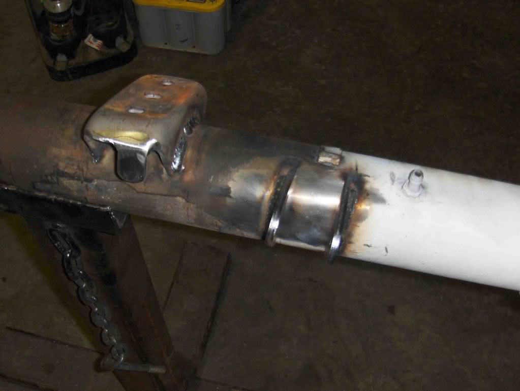

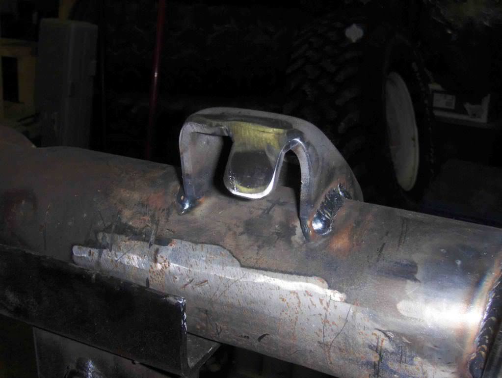

At this point you need to make tabs on the spring perches for the soft brake lines to bolt onto. If you’re doing it the same way I did, just put the tabs there, otherwise you need to put the shafts and most of the brakes together so that you can find out what location would work best to bolt onto. I just used some flat plate. Do this on both sides. After this, remove your axle and finish welding the perches and shock tabs on.
weld the spring perch
Weld the shock mount at an angle
spring perches and shock mounts welded

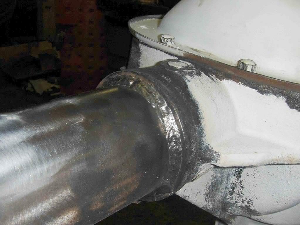

I also opted to weld the axle tubes to the center section at this time.

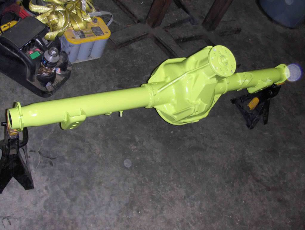

You are now ready to clean up your axle to the point that you can start painting now. For me this was just a little work with a wire wheel. Painted:
Painted

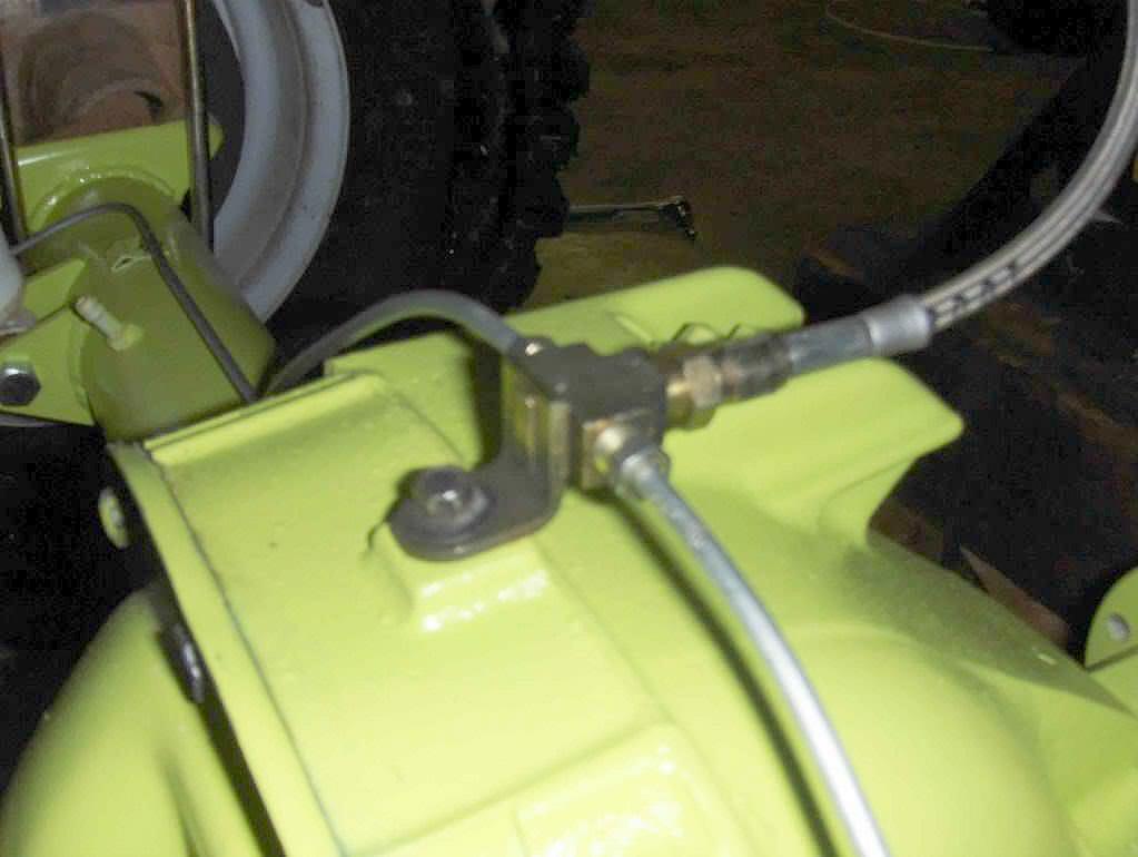

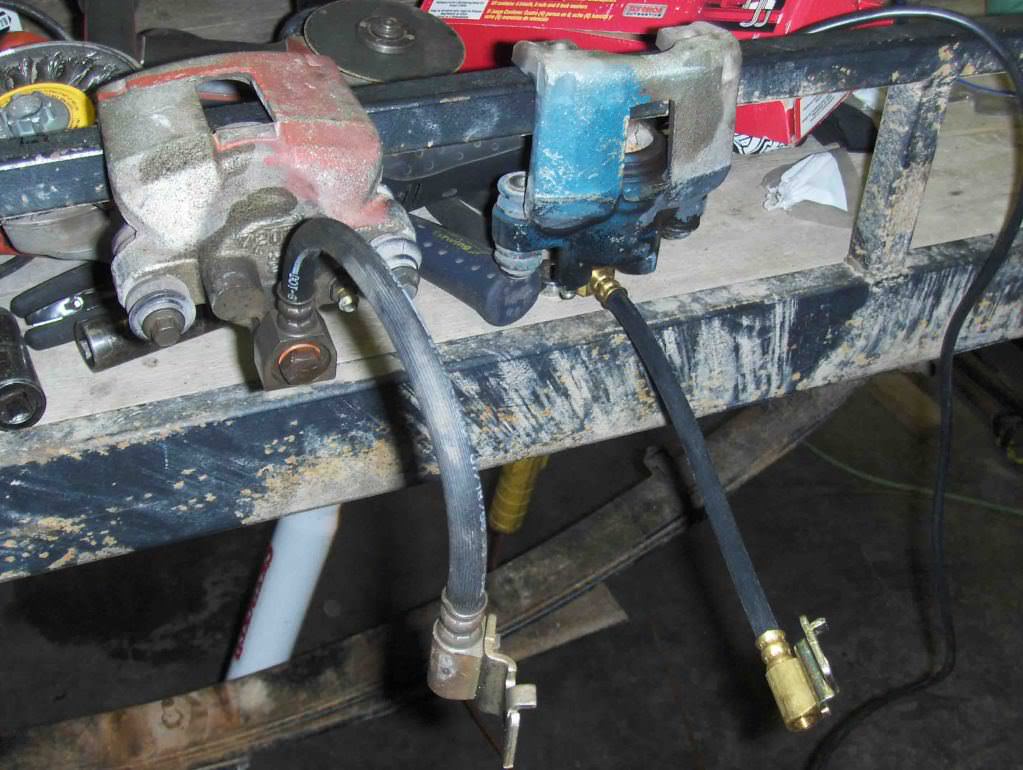

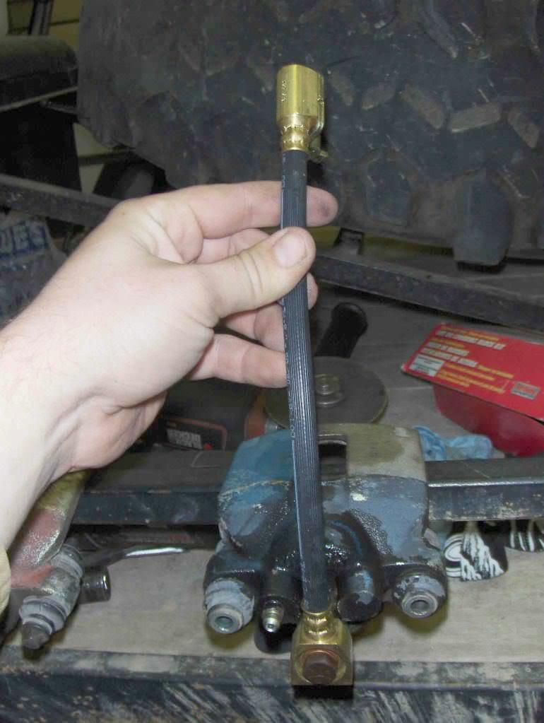

Once it’s dry, you are at the point where you can set the axle under the truck again and get it bolted back onto the leaf springs. You can also do your shocks and put the brake caliper brackets on. Now for the fun part with brake lines. I am fairly sure if your truck is lifted, you will either have extended brake lines and an aftermarket splitter block like I do. If not, you will probably need both. You will also need the soft line like mentioned above because the splitter on an Explorer is part of one of the soft lines and will not work. So, you need two passenger side soft lines. Like this:
Rear brake calipers and brake lines
rear brake hose

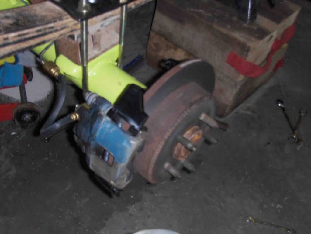

Drill holes in the tabs you welded to the perches so that you can bolt the soft lines on. I just used self-tapping screws here. You can now put your shafts in and put the brakes together. Run your hard lines wherever. You may need to cut and re-flare them, depending on how you do yours. I had to cut about 6” off one and 9” off the other. Since I am removing the e-brake stuff, you can remove the dust covers and all the e-brake hardware, as I have done. I had considered setting up the e-brake, but it was just too much of a pain in the ass for something I don’t use much.
Regarding master cylinders: I have heard all kinds of stuff about what master cylinder you need for disc brakes. I can’t speak for earlier trucks with the metal mc, but mine has the plastic one and it seems to be fine so far…I have not got the chance to make sure yet because I am missing two spider gears though. Will update as soon as I get that fixed.
From this point you can put your brakes together and put the axle shafts in. I will not explain how to do this here.
Here’s that splitter I was talking about with the steel lines run:
brake lone splitter

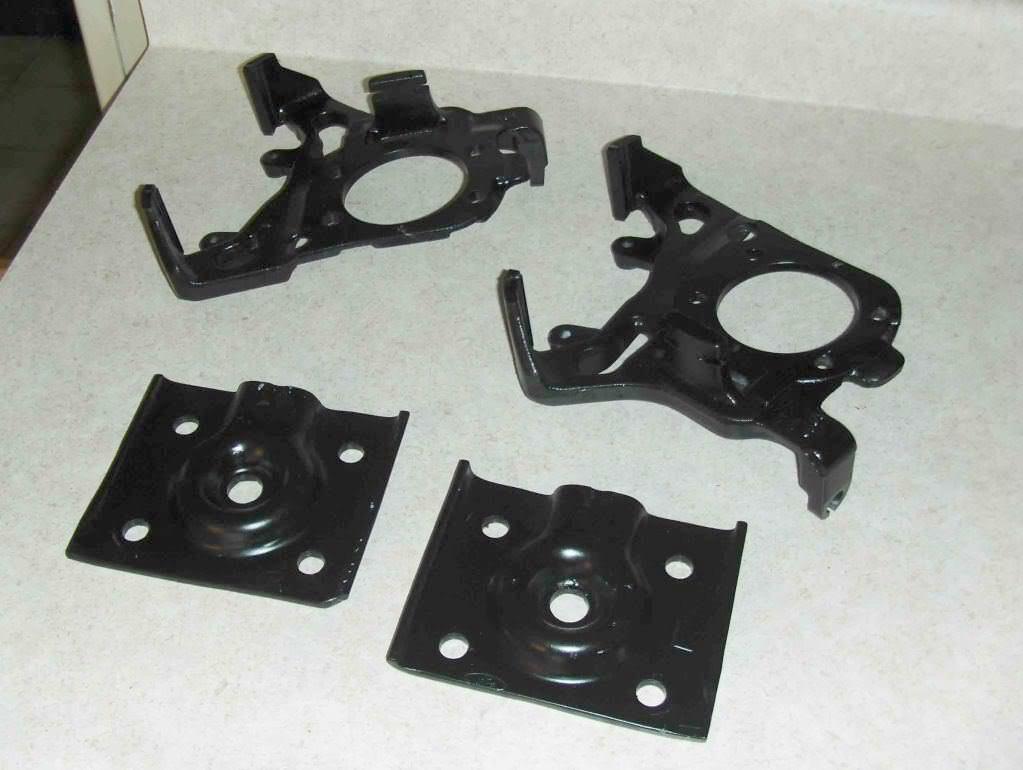

Brake pieces with the e-brake stuff removed (and spring retainer plates):
Spring retainer plates and caliper brackets

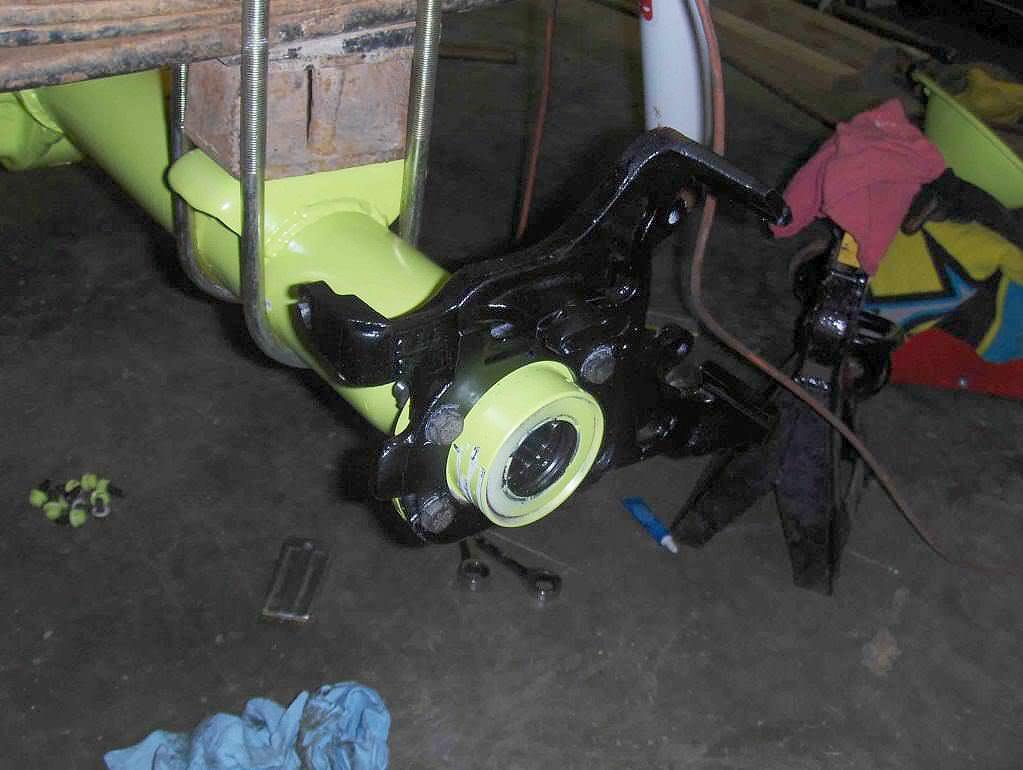

Caliper brackets mounted:
caliper brackets mounted
Brakes put together:
completed Ford 8.8 swap
