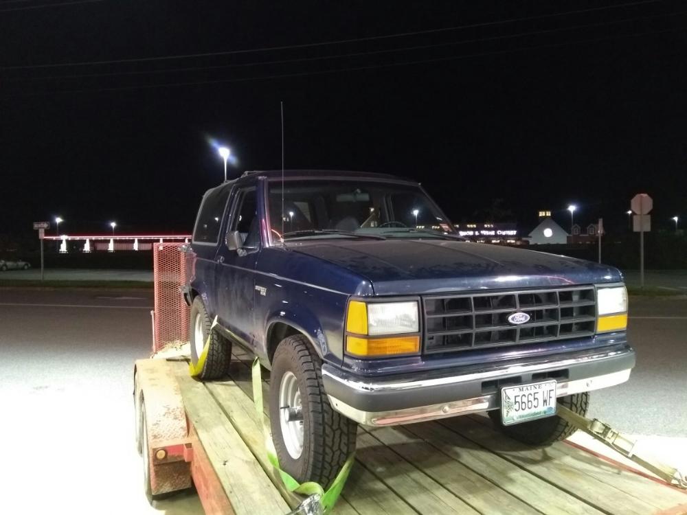

When ECGreen bought his 1989 Bronco II, it had a blown head gasket. The body was in good shape for its age, but the truck needed some work before it was ready for the trails. He repaired the engine, treated the frame for rust and began building the Bronco II into a small, capable 4×4.

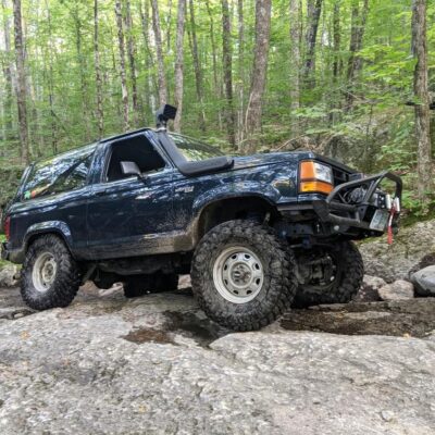

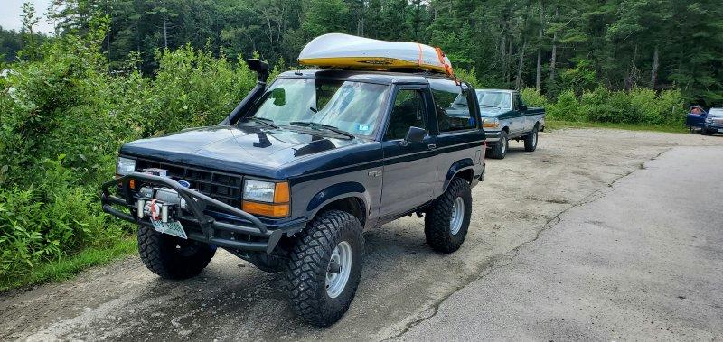

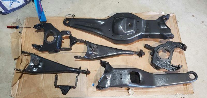

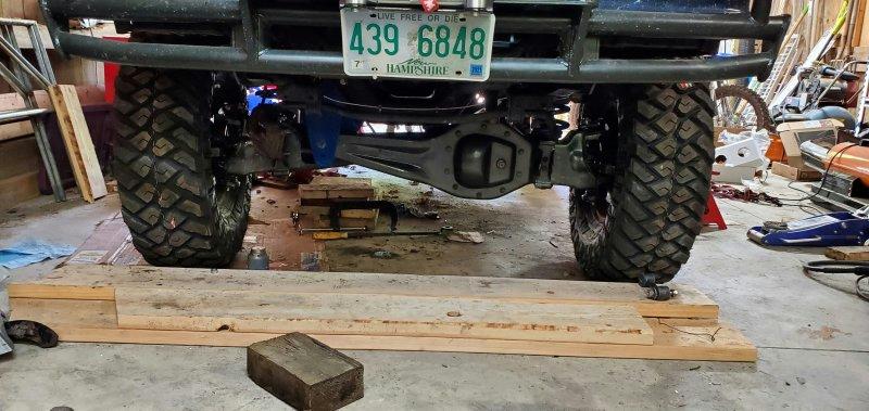

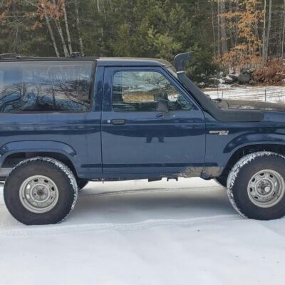

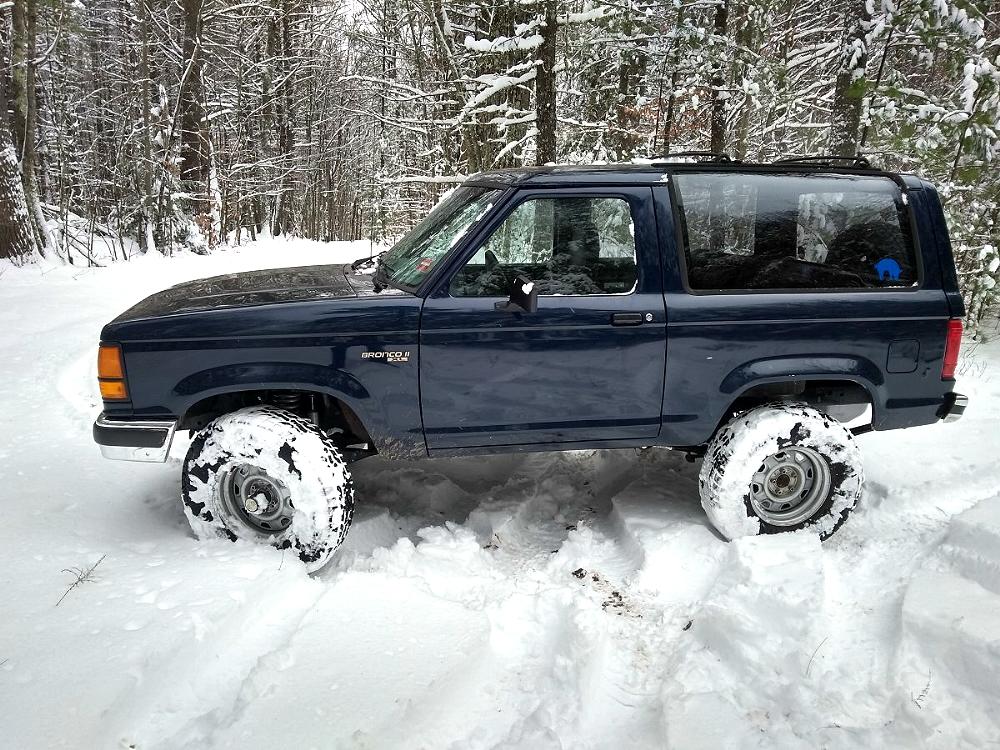

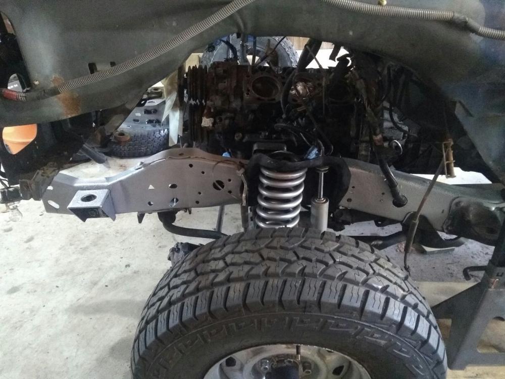

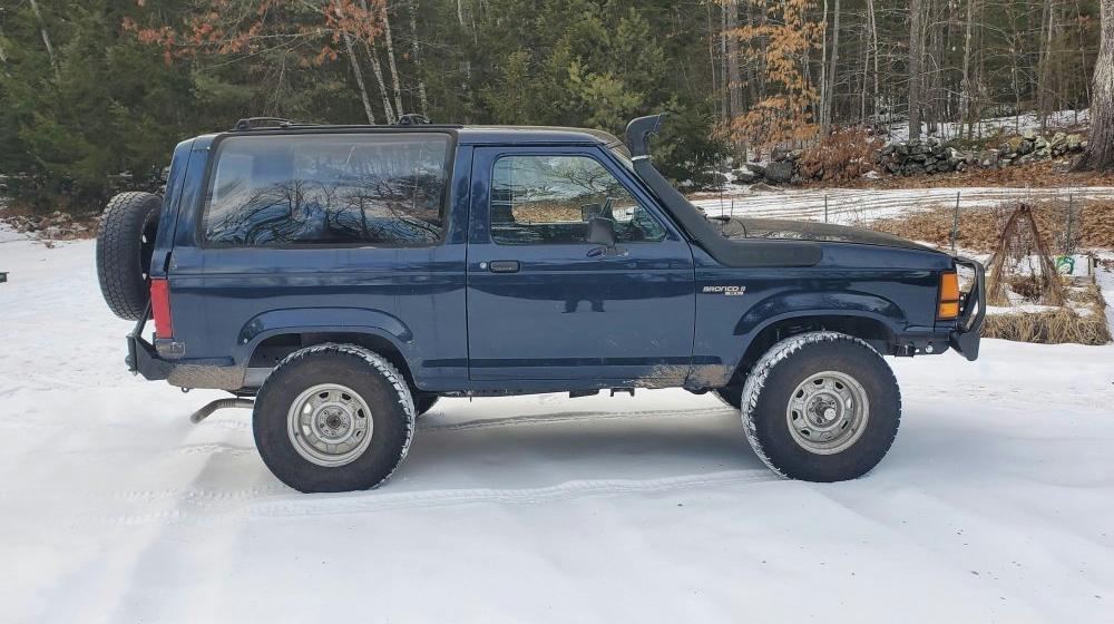

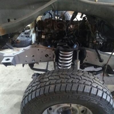

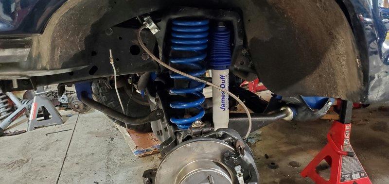

The Blue Pig didn’t start out with the suspension it would eventually run. ECGreen initially installed a Rough Country 1.5-inch lift and ran 31-inch tires. As the build evolved and he decided to step up to 33s, the Rough Country setup was replaced with a James Duff Stage 1 suspension providing approximately three inches of lift.

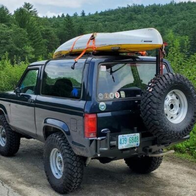

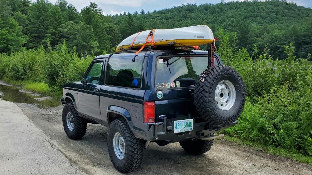

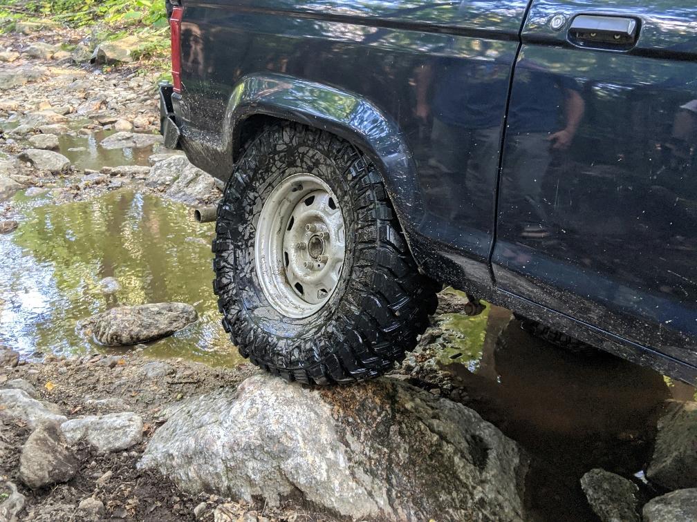

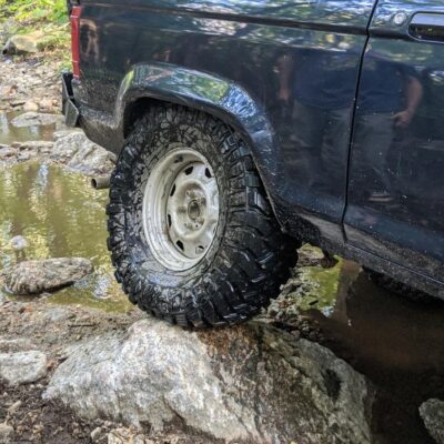

ECGreen chose 33×10.50R15 Maxxis RAZR MT tires on the factory 15×7 wheels. The narrow 33s were intentional. He liked the way the 10.50-inch-wide tires fit the Bronco II’s narrow body and kept the tires tucked into the wheel wells. Only minor trimming was required at the rear when the suspension was fully compressed.
There was a tradeoff. The combination of narrow tires and the Bronco II’s relatively narrow track width made the truck feel somewhat tippy on the highway and in corners. Wheel spacers could have widened the stance, but ECGreen initially kept the narrow configuration.

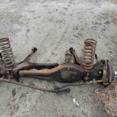

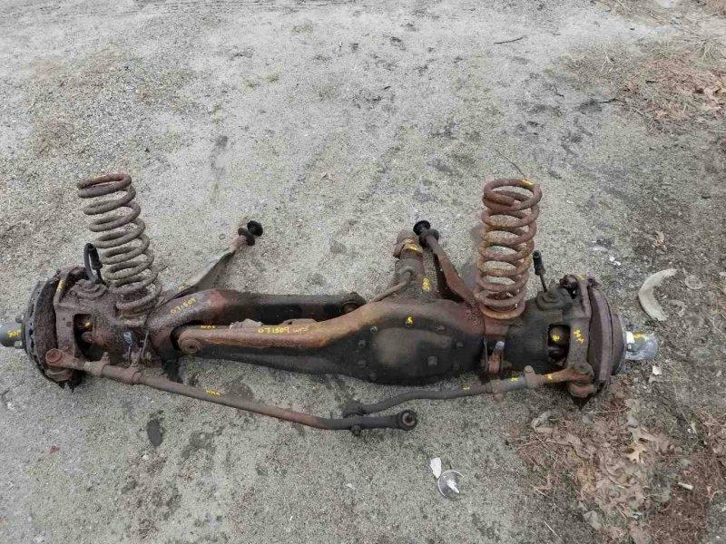

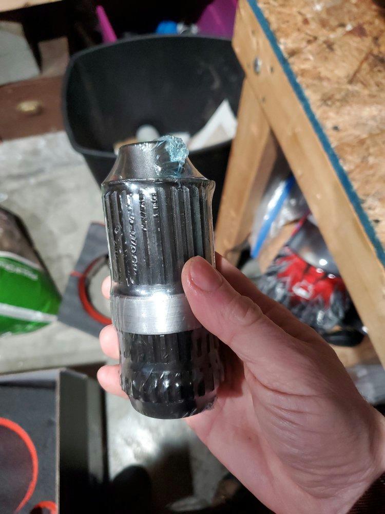

Up front, the factory axle was replaced with a Dana 35 from a 1992 Explorer. The Dana 35 was rebuilt and equipped with 4.56 gears and an Aussie locker.

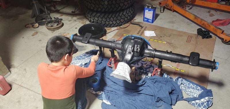

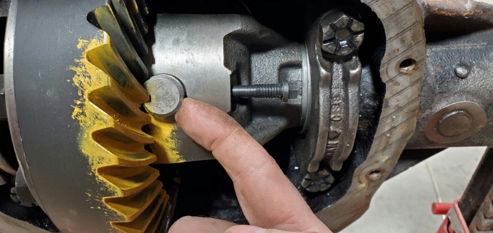

The original 7.5-inch rear axle was rebuilt as well and received 4.56 gears and a Lock-Right locker.

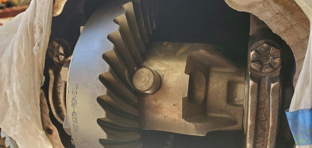

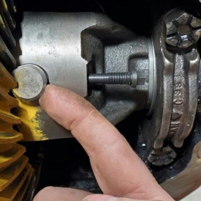

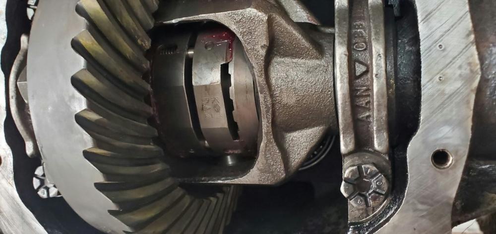

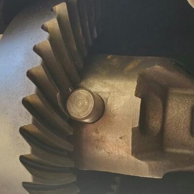

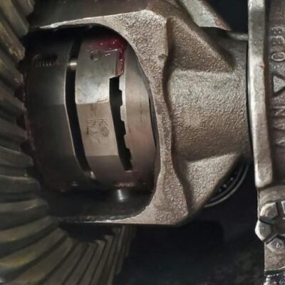

Getting the 4.56 gears and Lock-Right installed in the 7.5 wasn’t quite as simple as expected. The new gearset didn’t provide enough clearance for the cross pin with the Lock-Right installed. Since a notched cross pin cannot be used with a Lock-Right, ECGreen determined that he would have to carefully grind one of the ring gear teeth to provide the necessary clearance.
It worked, and he subsequently put more than 1,000 miles on the setup without a problem.
This is one of those small but important details that can make the difference between a parts list and a useful build feature. See TRS: 7.5-inch Rear Axle Cross-Pin Clearance for more information on the clearance issue and solution.

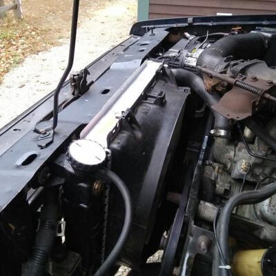

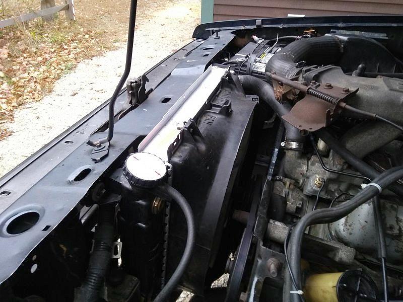

The Blue Pig received James Duff front and rear bumpers and a Warn M8000 winch. A 4.0L radiator was installed for additional cooling capacity, and ECGreen replaced a long list of aging components as he worked through the truck.

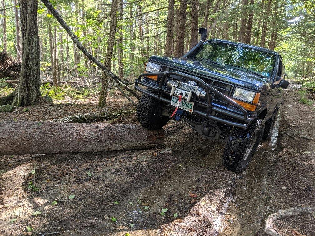

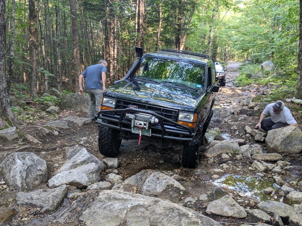

First Off-Road Testing

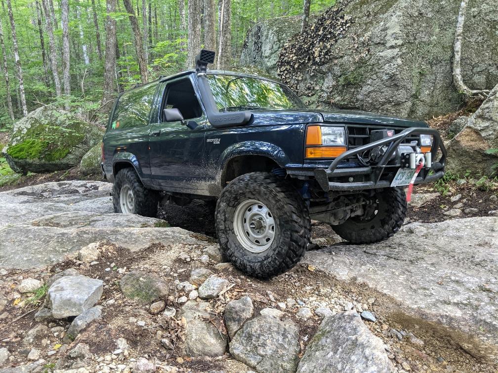

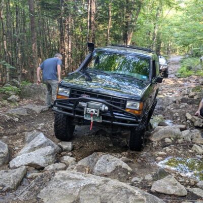

By September 2021, The Blue Pig was ready for some real testing.
The combination of 33-inch tires, 4.56 gears and lockers at both ends made a noticeable difference off-road. ECGreen was happy with the suspension, but the first outing also exposed the next limitation: even with the 4.56 gears, he wanted a lower crawl ratio for slower, more technical terrain.
The sway bars were still connected during the initial testing, and he planned to disconnect them on a later trip to evaluate the additional suspension movement.
The Bronco II was working, but the testing gave ECGreen a better idea of what he wanted to change next.

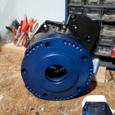

By 2022, the drivetrain was headed in a more serious direction.

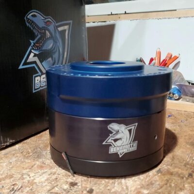

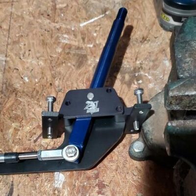

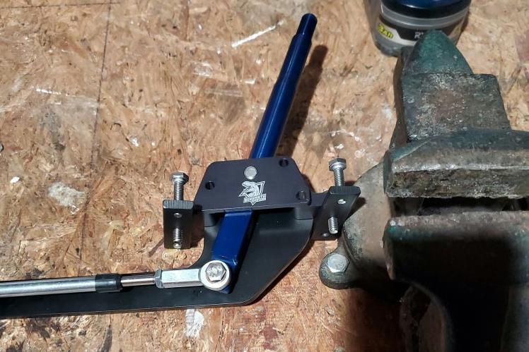

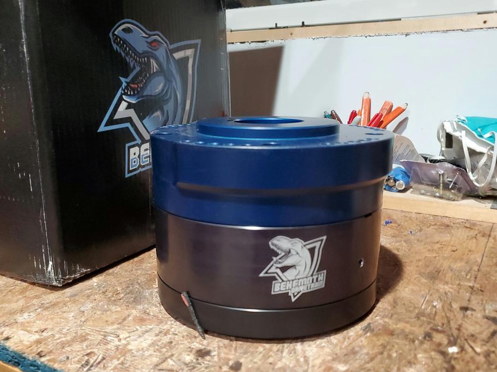

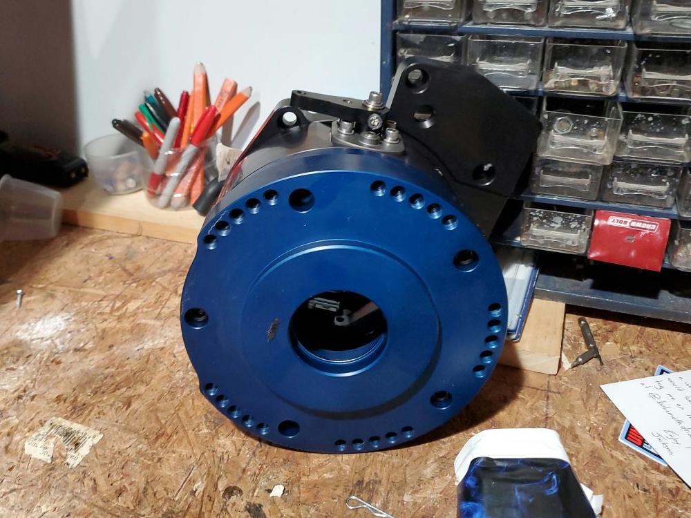

ECGreen purchased a Behemoth Strongbox Shorty dual-transfer-case setup. His plan was to retain the existing electric transfer case and add the Strongbox, giving the Bronco II substantially lower gearing for technical off-road driving.
At the same time, the FM146 manual transmission was approaching the end of its useful life, so he was looking for an M5OD replacement.
The direction of the build was becoming clear. Rather than simply adding larger tires or more lift, ECGreen was concentrating on traction, gearing and reliability.

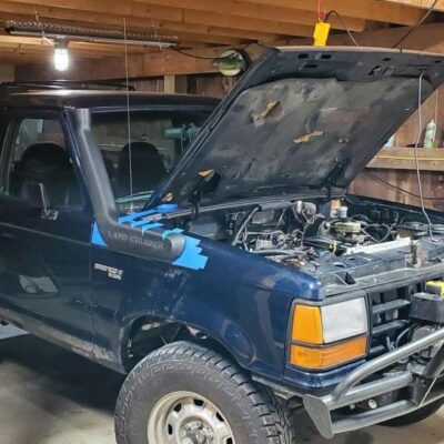

The Snorkel

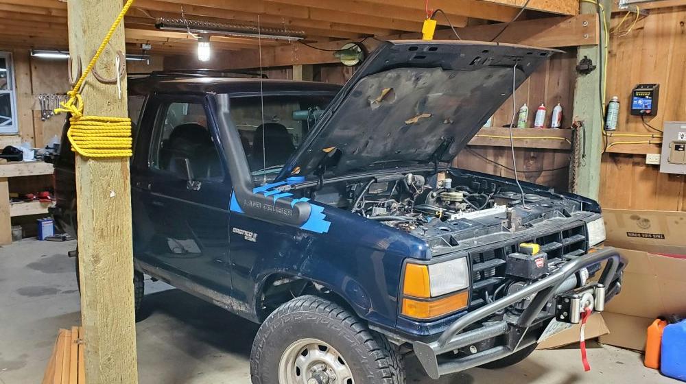

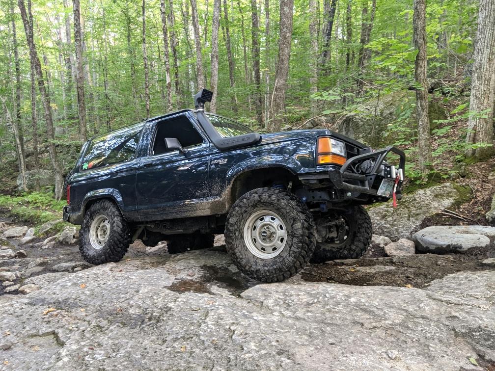

One of the more unusual modifications was the snorkel.

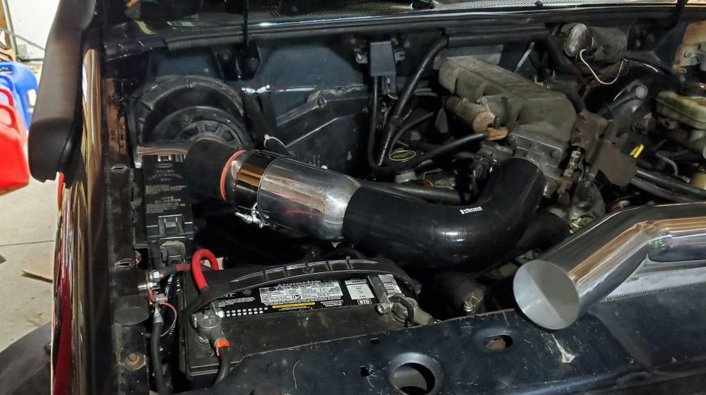

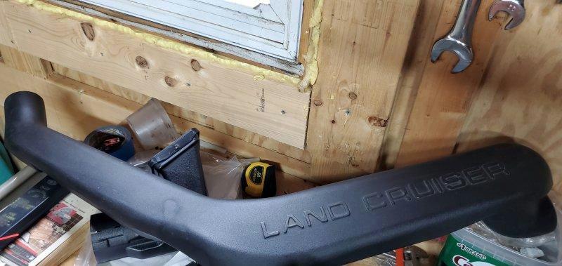

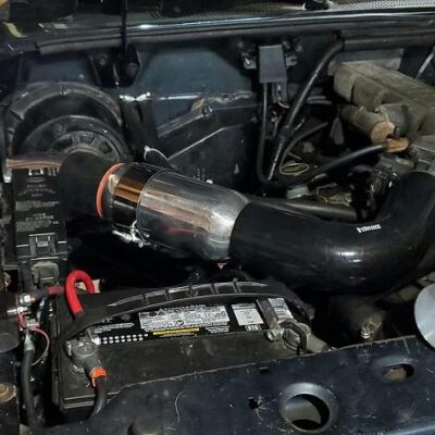

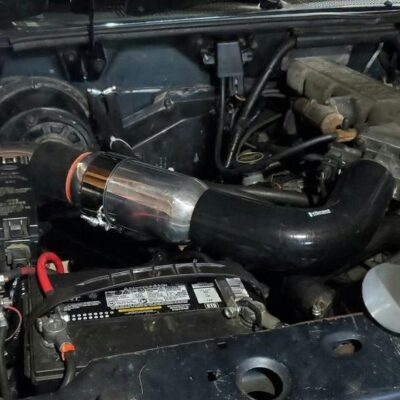

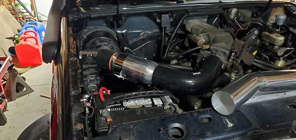

ECGreen adapted a Land Cruiser snorkel to the 1989 Bronco II, modifying the snorkel and intake plumbing to work with the Ford. The installation involved cutting and drilling the Bronco II’s body and fabricating the connection between the snorkel and air intake.
The project eventually became its own TRS article, so it deserves more attention than a paragraph in a vehicle feature.
[See TRS: Snorkeling in an ’89 Bronco II]
