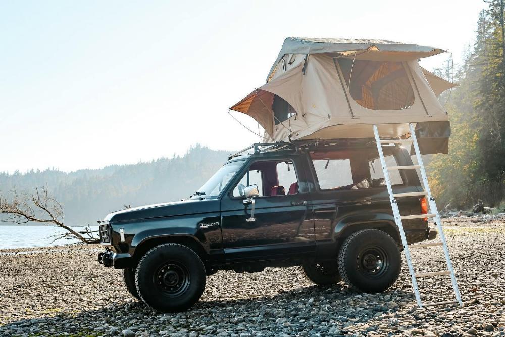

1. Roof Top Tent
Placing 150+ lbs. on a roof that is already nearly six feet off the ground drastically raises your CG. Even a slight off-camber lean on a trail can become a point of no return and flop the vehicle onto its side. On the highway, an RTT acts like a sail. In a crosswind or emergency swerve, that top-heavy weight generates massive “body roll,” making it nearly impossible to regain control once the vehicle starts to lean.

Roof Top Tent or Ground Tent
Roof Top Tent
A roof top tent is great for setting up camp quickly at the end of a long journey. You don’t have to worry about finding a place to set up your tent that’s flat, dry, and free of sticks and rocks, and you’re up off of the ground if it rains. You’re also up off the ground from animals, rodents, and snakes.
The downside is that a roof top tent weighs over 100 lbs., makes the Bronco II more prone to rolling over, and you can only set it up where you can legally park.
