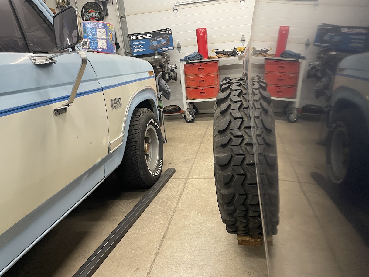

Also since my last update I scored a Warn 8274 winch, a Riddler D44 diff cover, bunch of other small stuff. I bought a tubing bender on Black Friday last year and will be using that for a roll cage and probably a few other things - armor around the wheel wells & stuff. Still undecided on front suspension parts, I am leaning towards air shocks/coilovers/ORI's, or something like that rather than coil springs. I used Ford radius arms on my other SAS and they were the weak link in that build, the bushings don't last very long.
That other truck has RCV shafts and Yukon locking hubs, there is like $2000 worth of parts there that I will be removing and putting in this one, stock parts can go back in the Ranger.

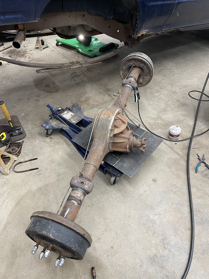

Over the weekend I set the pinion angle and welded the perches on. Rear is sitting on its own weight. I will need to redo the brakes plus it needs shocks/tabs, driveshaft, some other little things but I'm happy with the suspension height so I can move to the front and finish up the small stuff on the rear later. Really surprised at how wide the rear axle isn't - I've only got maybe 3" of tire outside the wheel well.

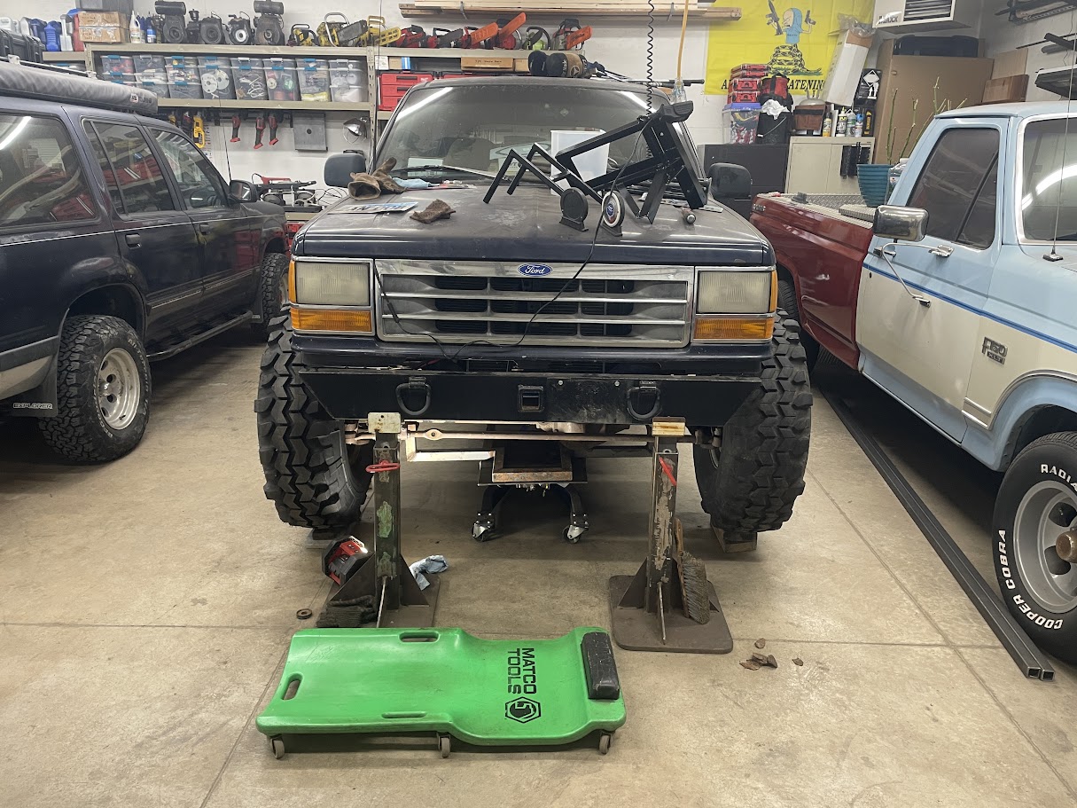

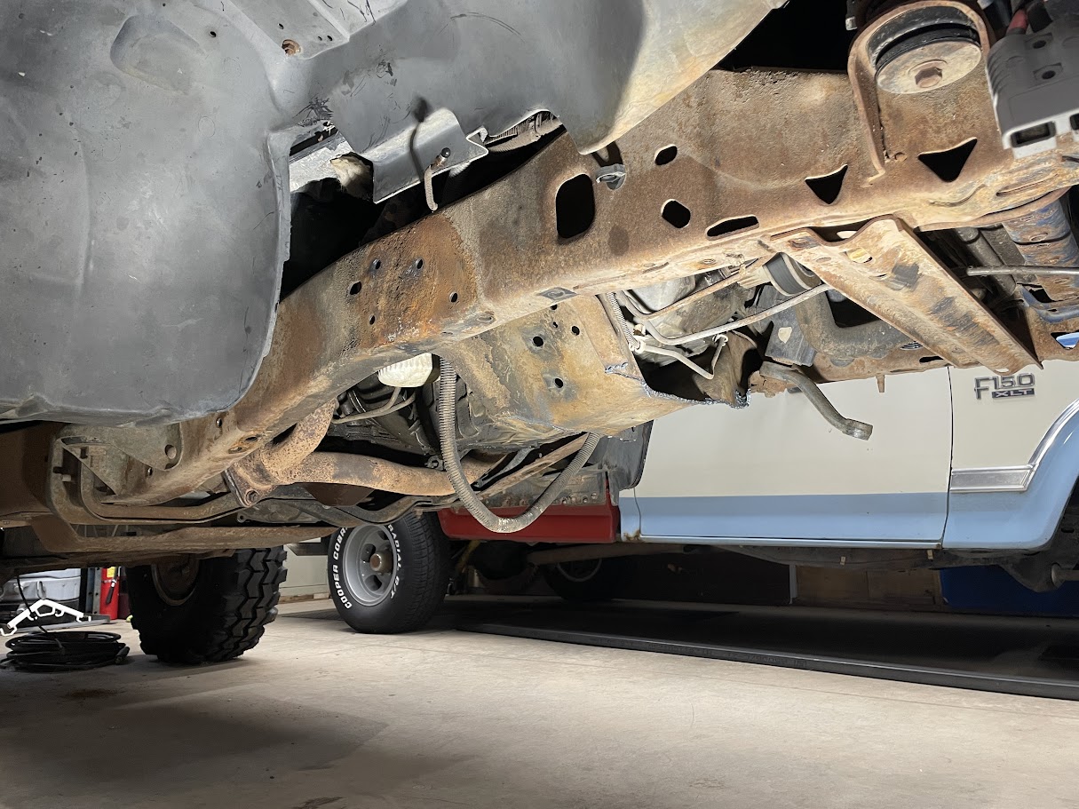

I pulled the front axle out and got all the F150 stuff removed off of it. I also torched the TTB stuff off of the Explorer frame. Pretty much no going back now! I need to get a rough caster measurement now that the axle is under the truck and somewhat in its new location so I can get measurements for links... planning on a 3 link as I think that will be easiest.
Looks cool AF with the full width axle... pics somewhat in order:

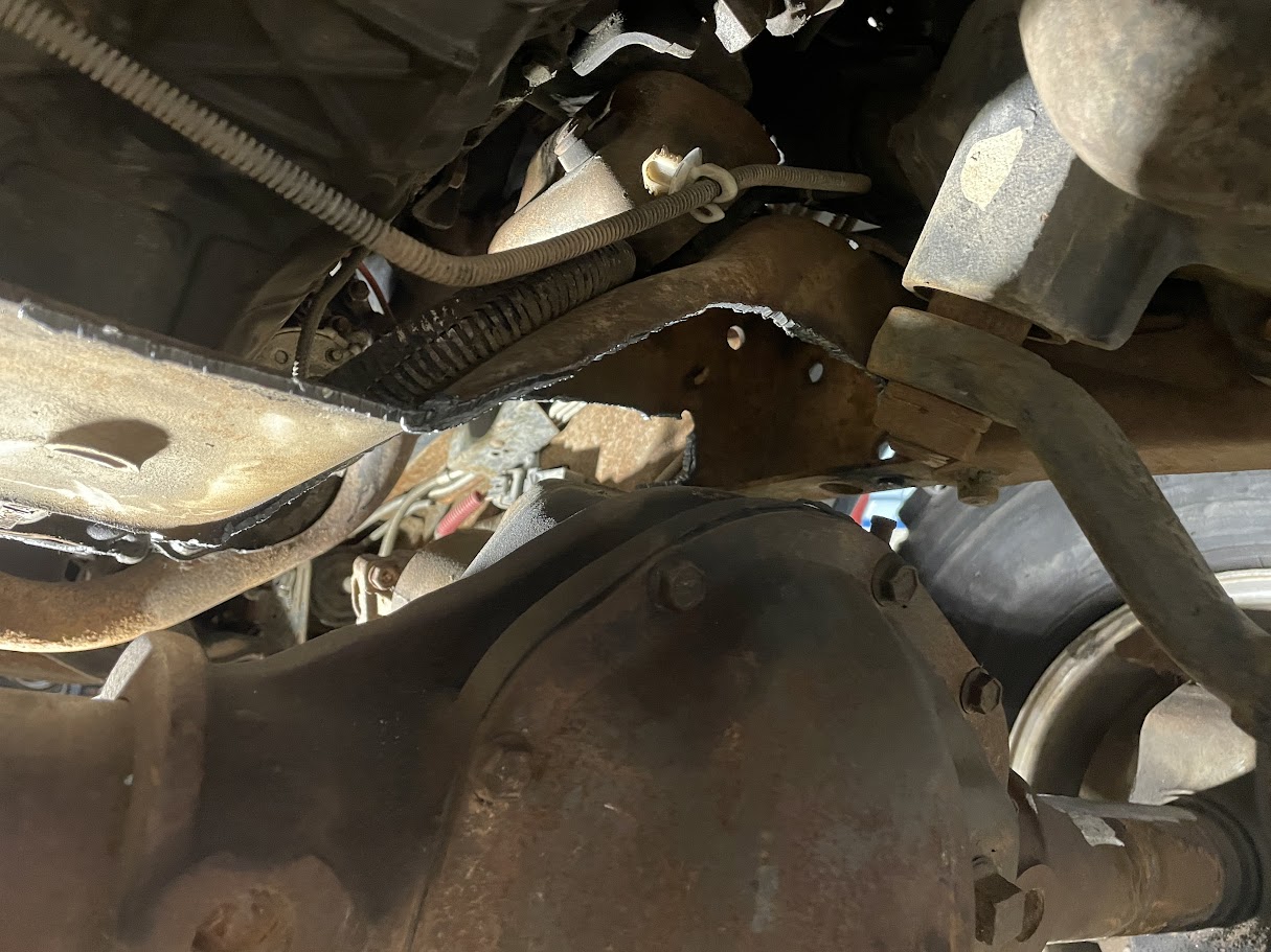

I am thinking this is about where my up travel stops. I'm running into clearance issues with small things like the exhaust and engine crossmember (already removed a lot of it) but the steering box is going to be a problem. Not sure if I want to try and move it forward or leave everything where it is now and live with it... I have hydro steering floating in the back of my mind too but that might be a project to mess with later.
