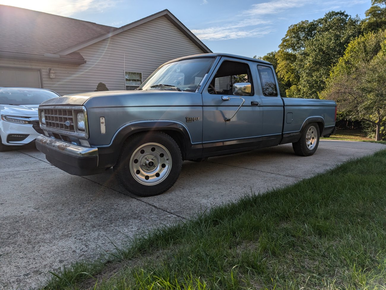

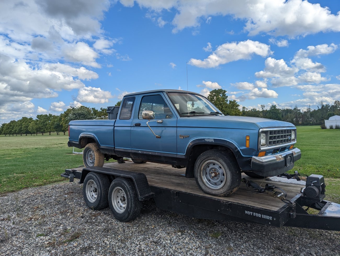

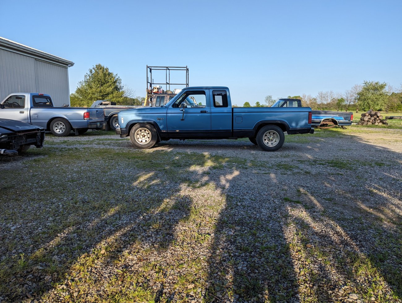

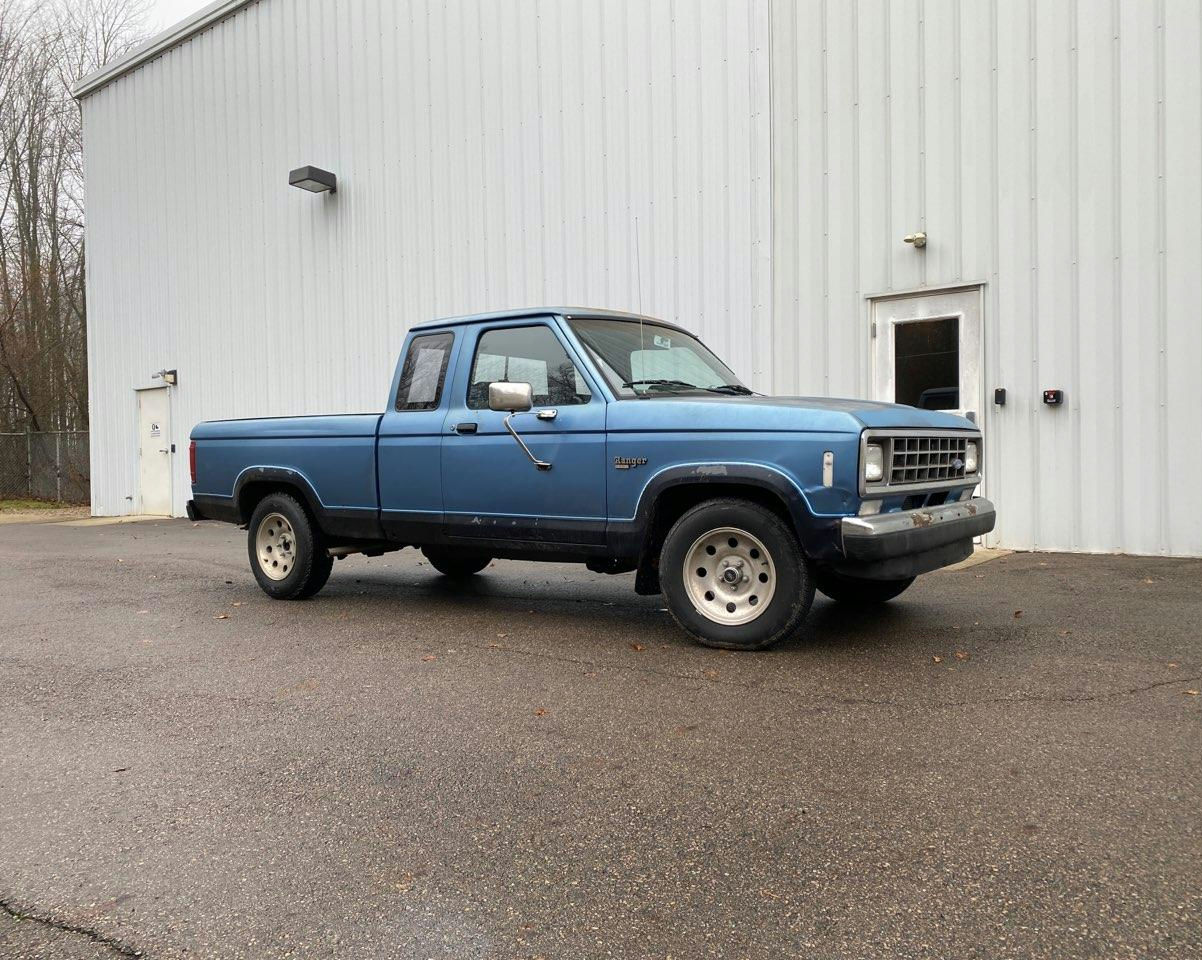

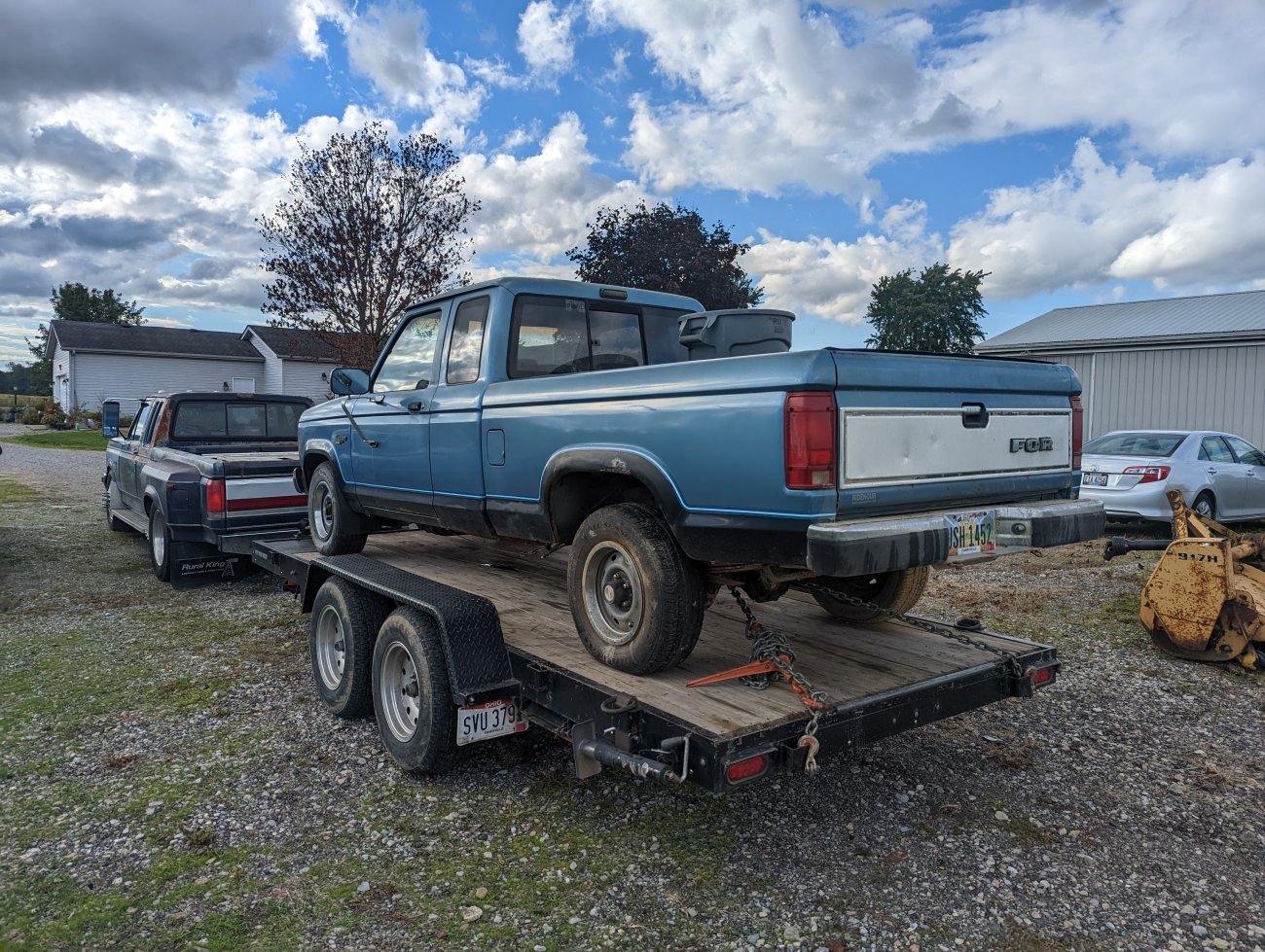

Probably time I start a thread for this 88 SuperCab I have been tinkering on.

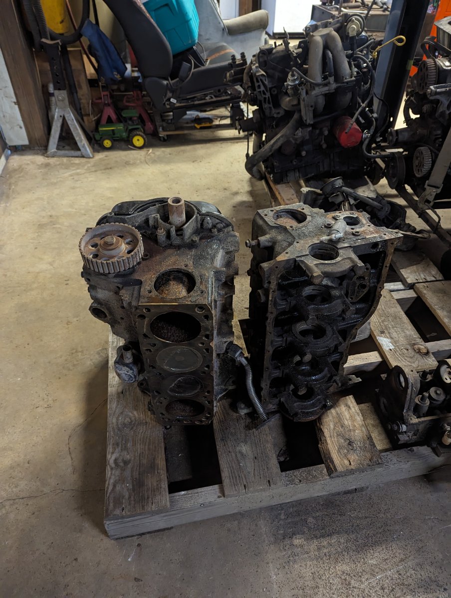

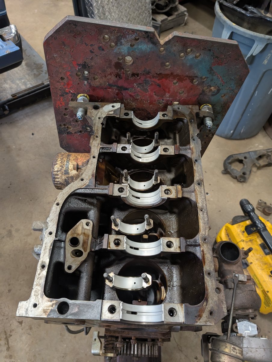

Bought it cheap running on 3 cylinders and super gross inside.

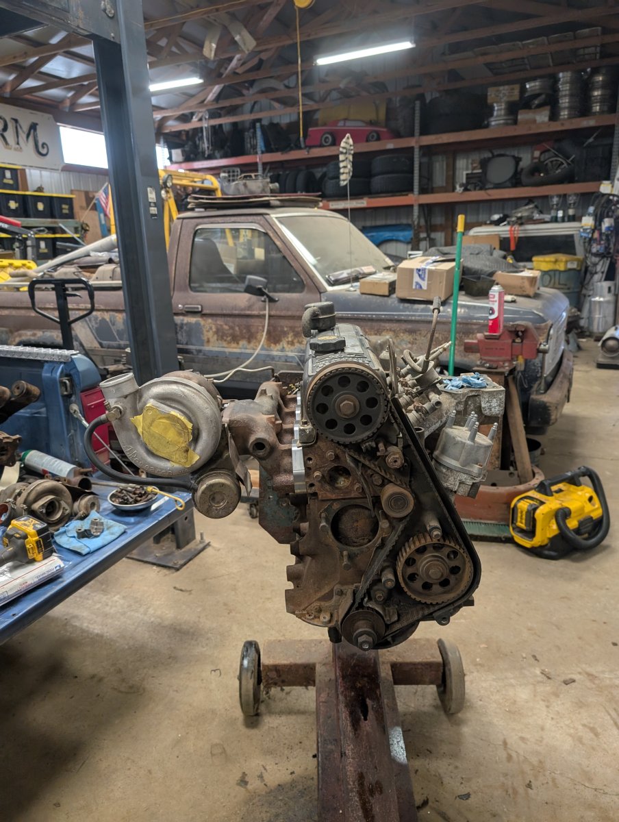

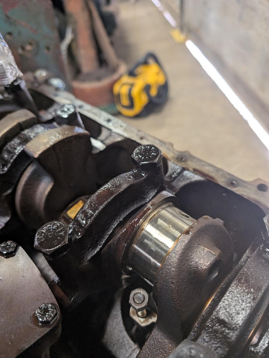

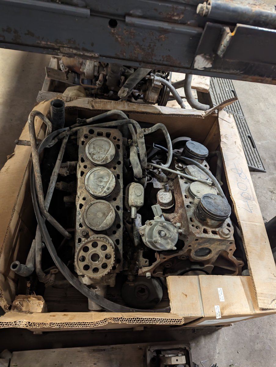

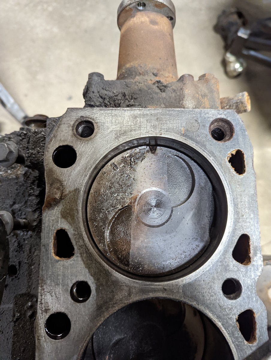

Tore it down and found a broken piston, transmission full of milky oil, and an ECU full of corrosion....safe to say I think it was flooded and likely hydro locked at some point.

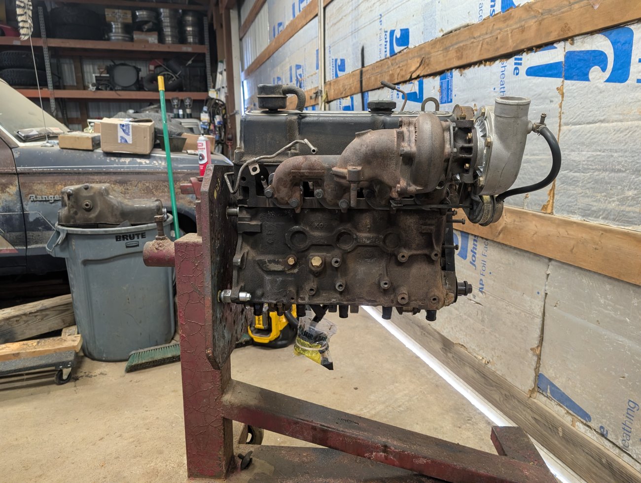

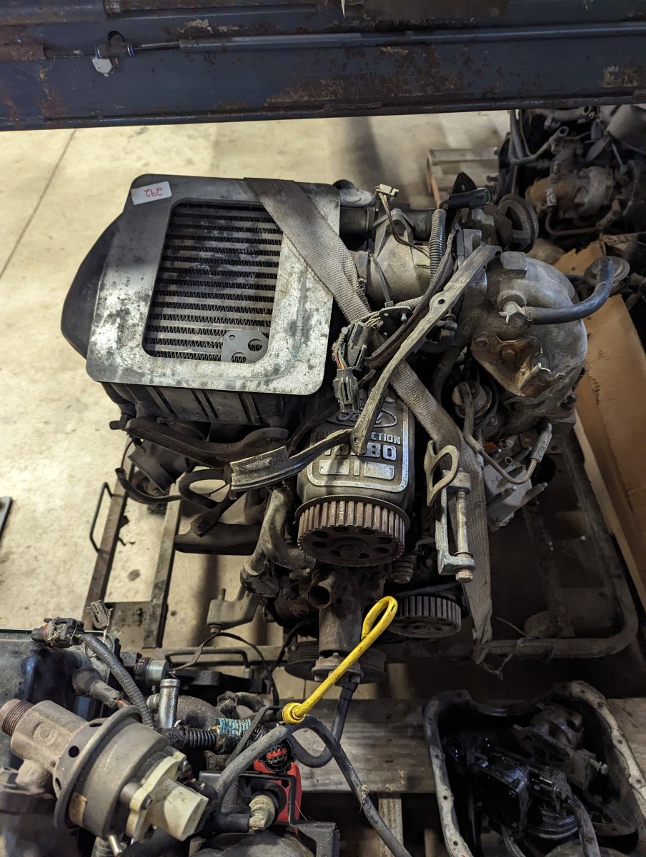

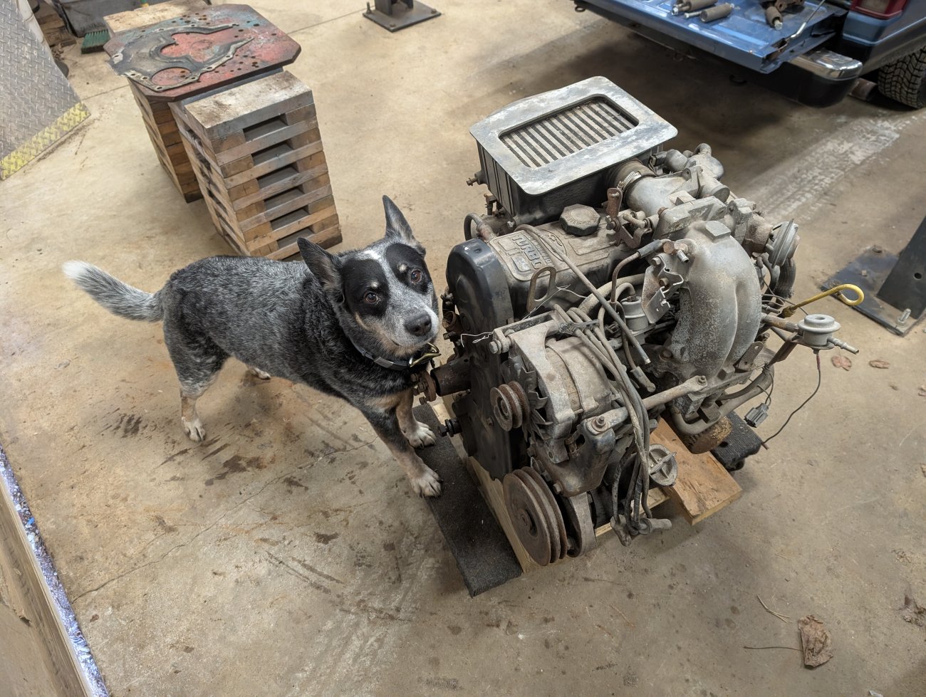

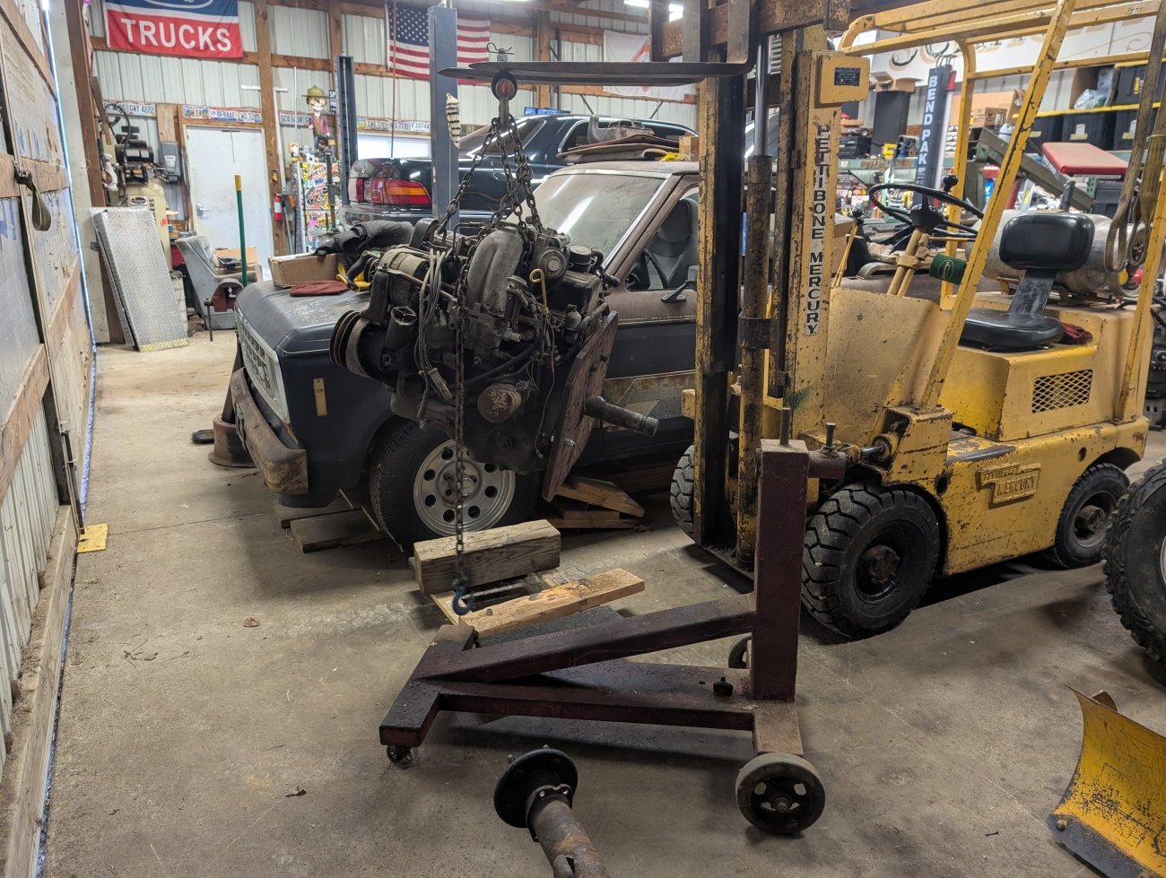

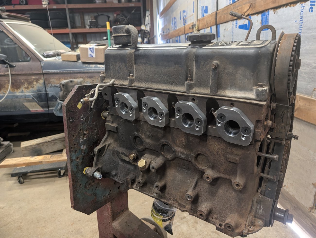

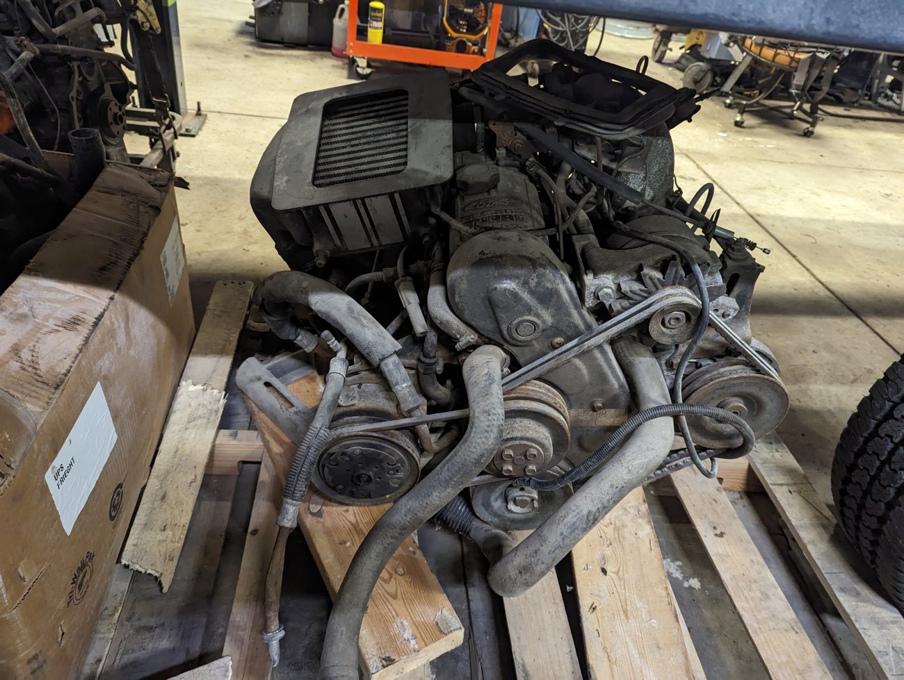

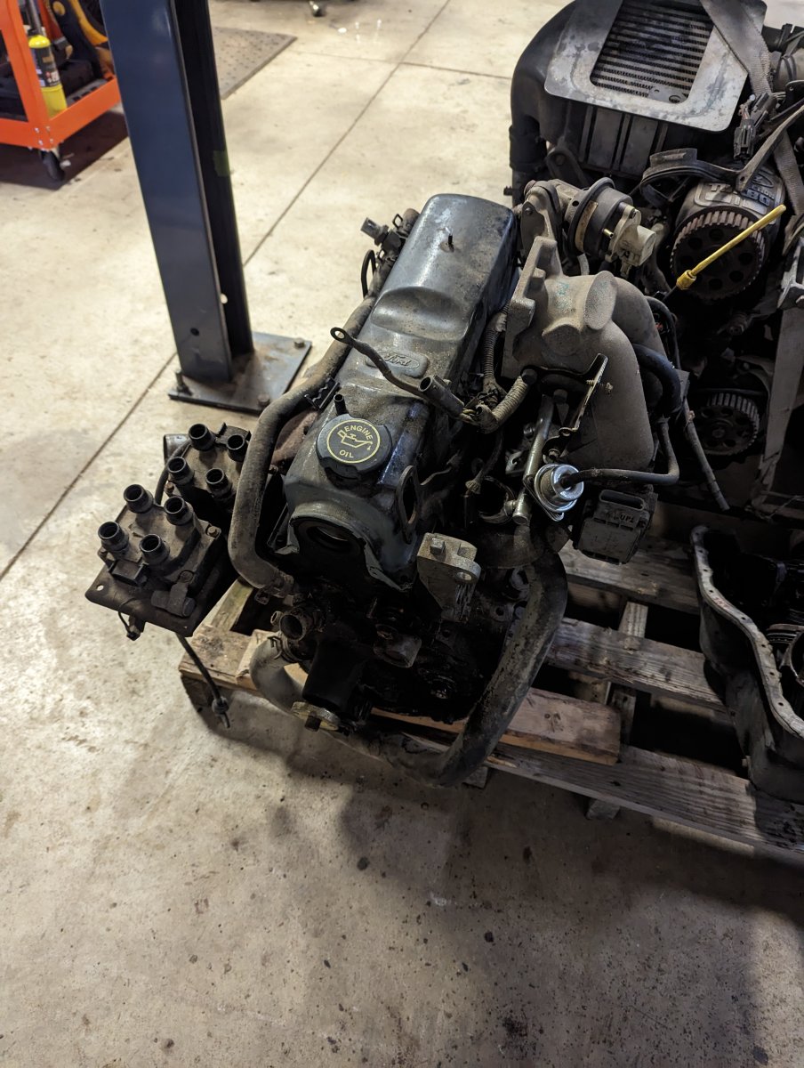

Picked up a low mileage Mustang 2.3 for it and swapped over the 4 plug head and roller cam setup.

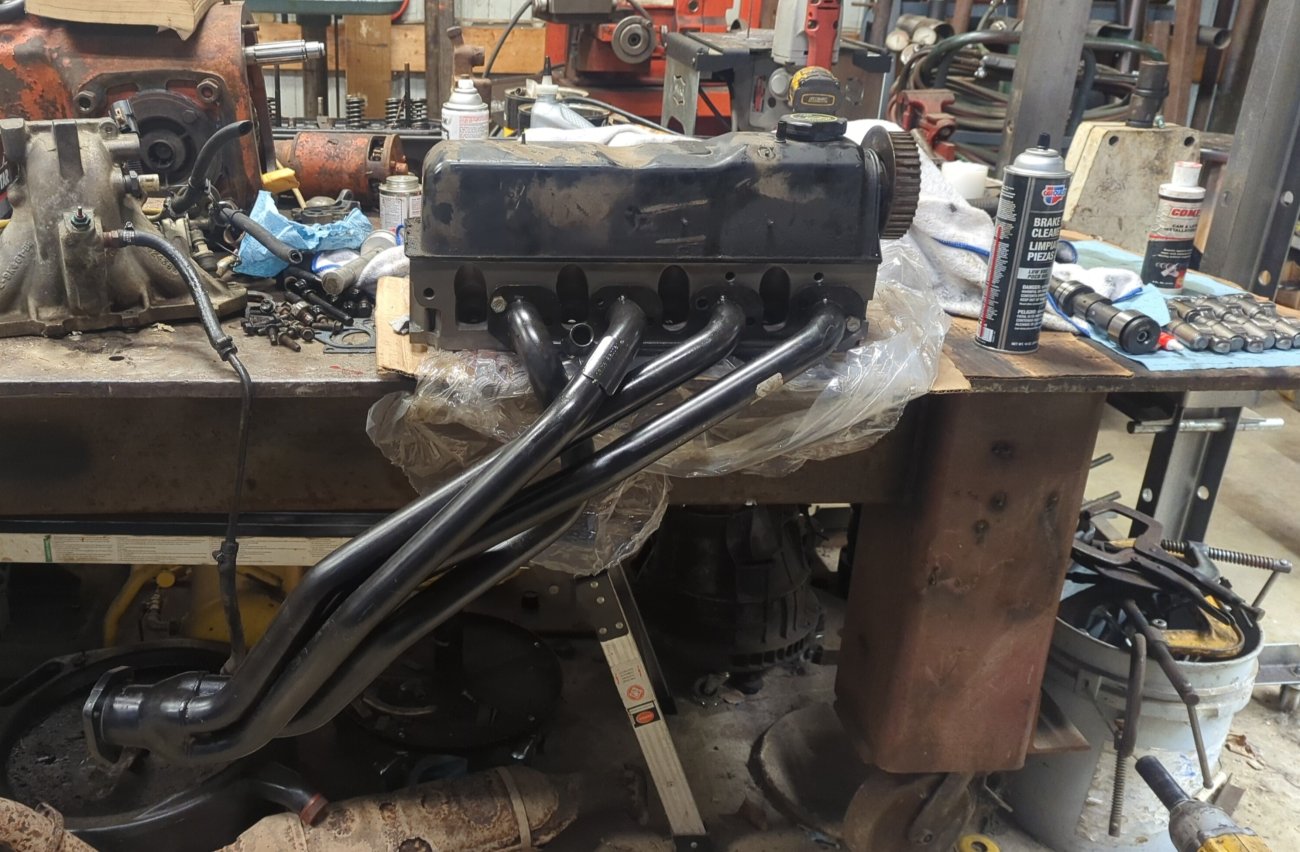

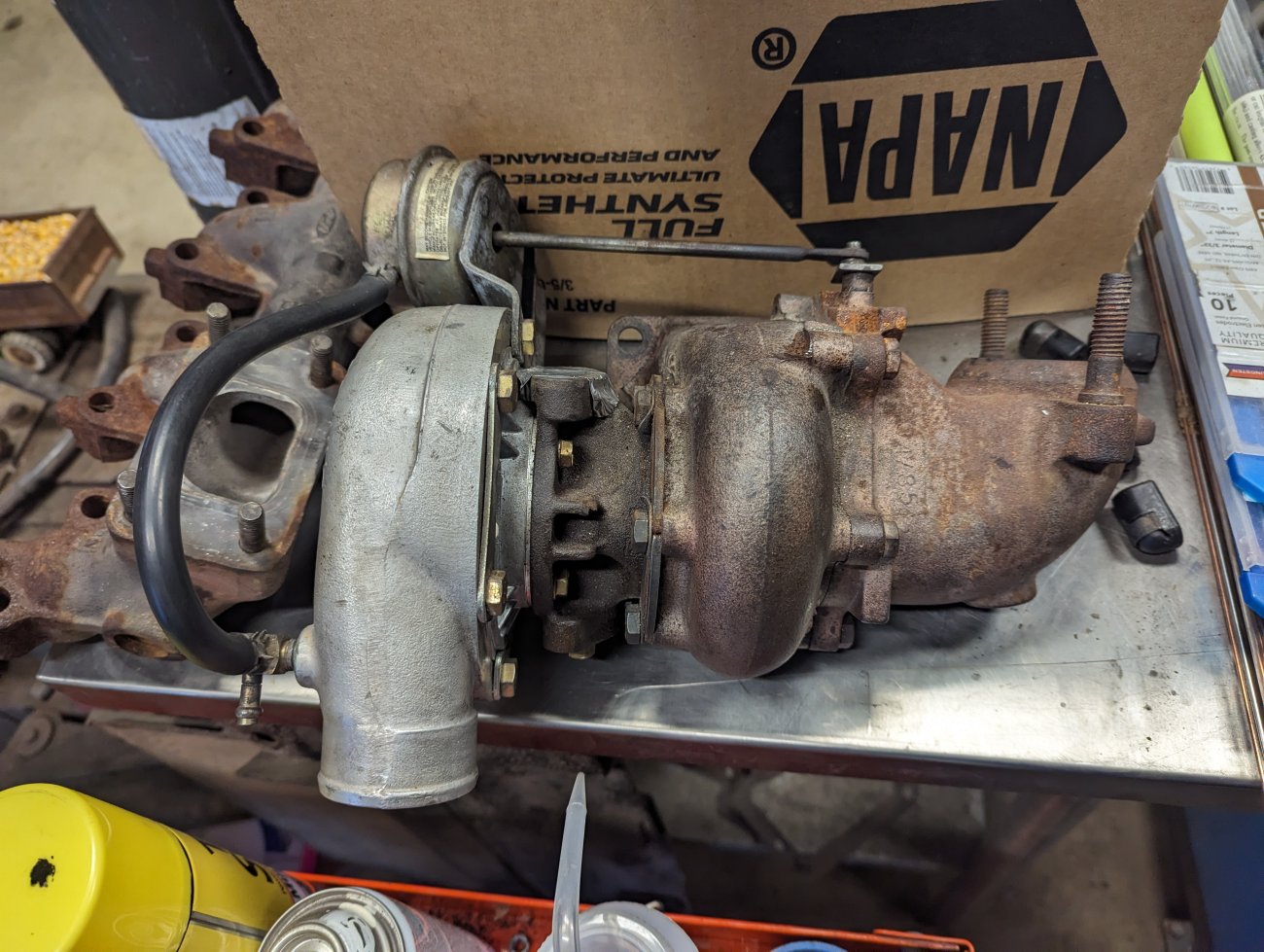

Scored a long tube header on Summit's clearance rack..so I ditched the FUBARed manifold and EGR

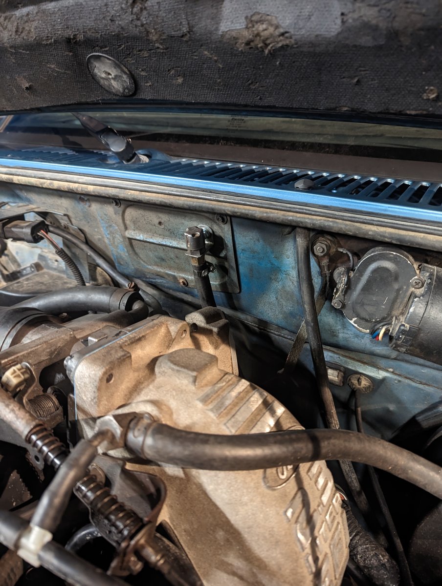

The Mustang didnt have the same mounting holes for accessory brackets as the Ranger and the Mustang PS pump didnt clear the steering box....so I deleted the power steering and used a 94ish Ranger 3G alternator setup on the passenger side.

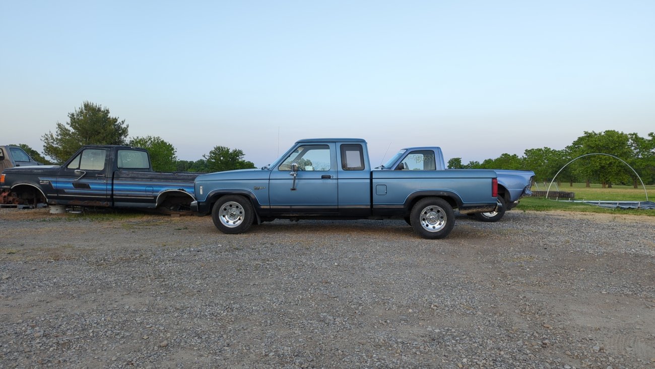

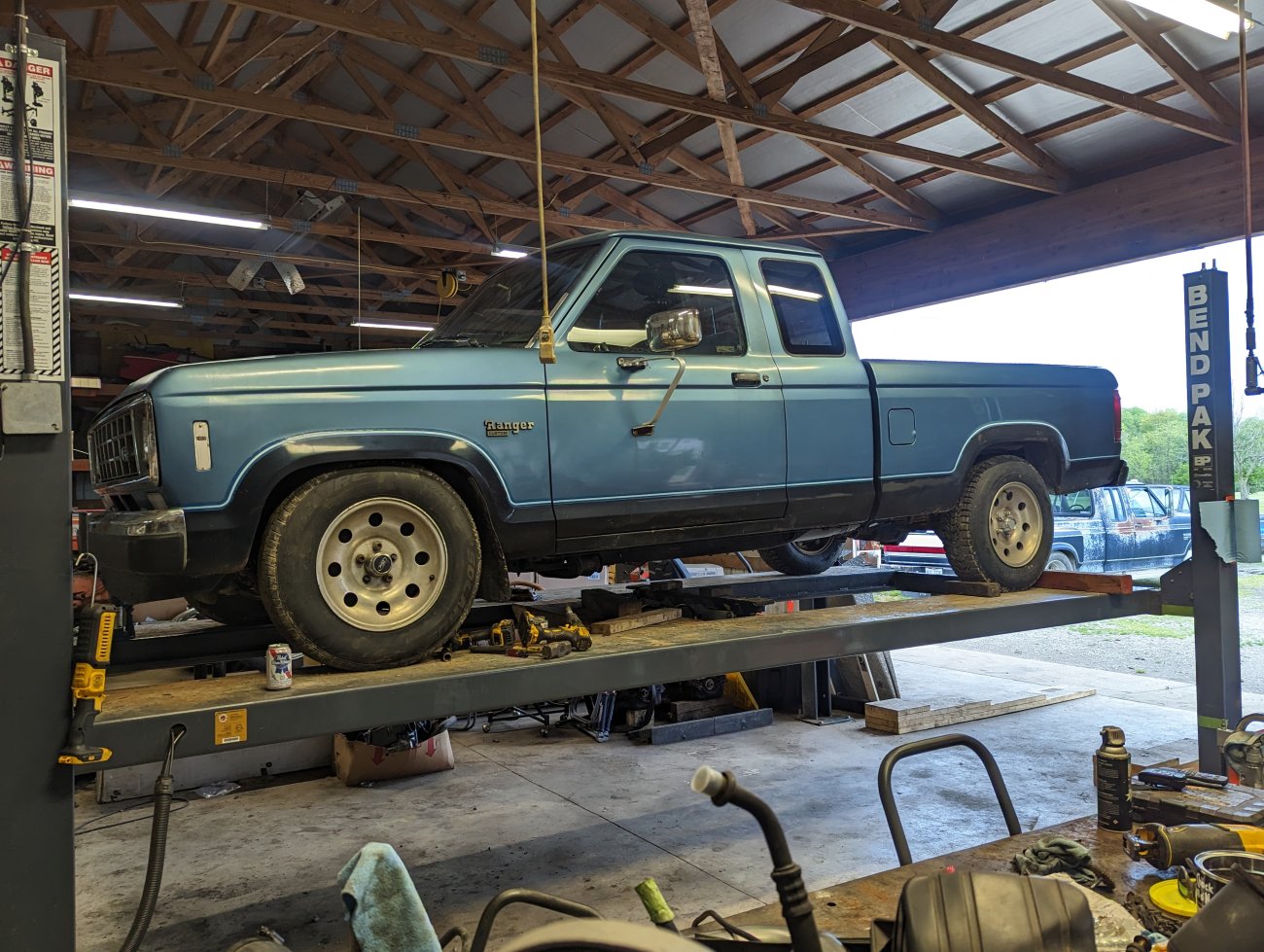

Pulled the bumper back out, deleted on the amber and ran it for while with just flipped rear hangers and ratty looking Alcoas
It had like two add a leaves in the back and looked ridiculous....so I pulled those out and put dream beams with 95-97 dual piston spindles up front.

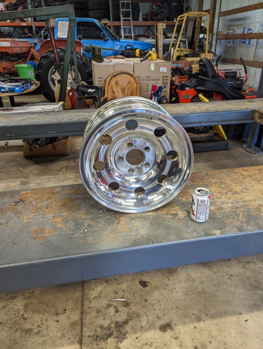

Polished up some wheels for it

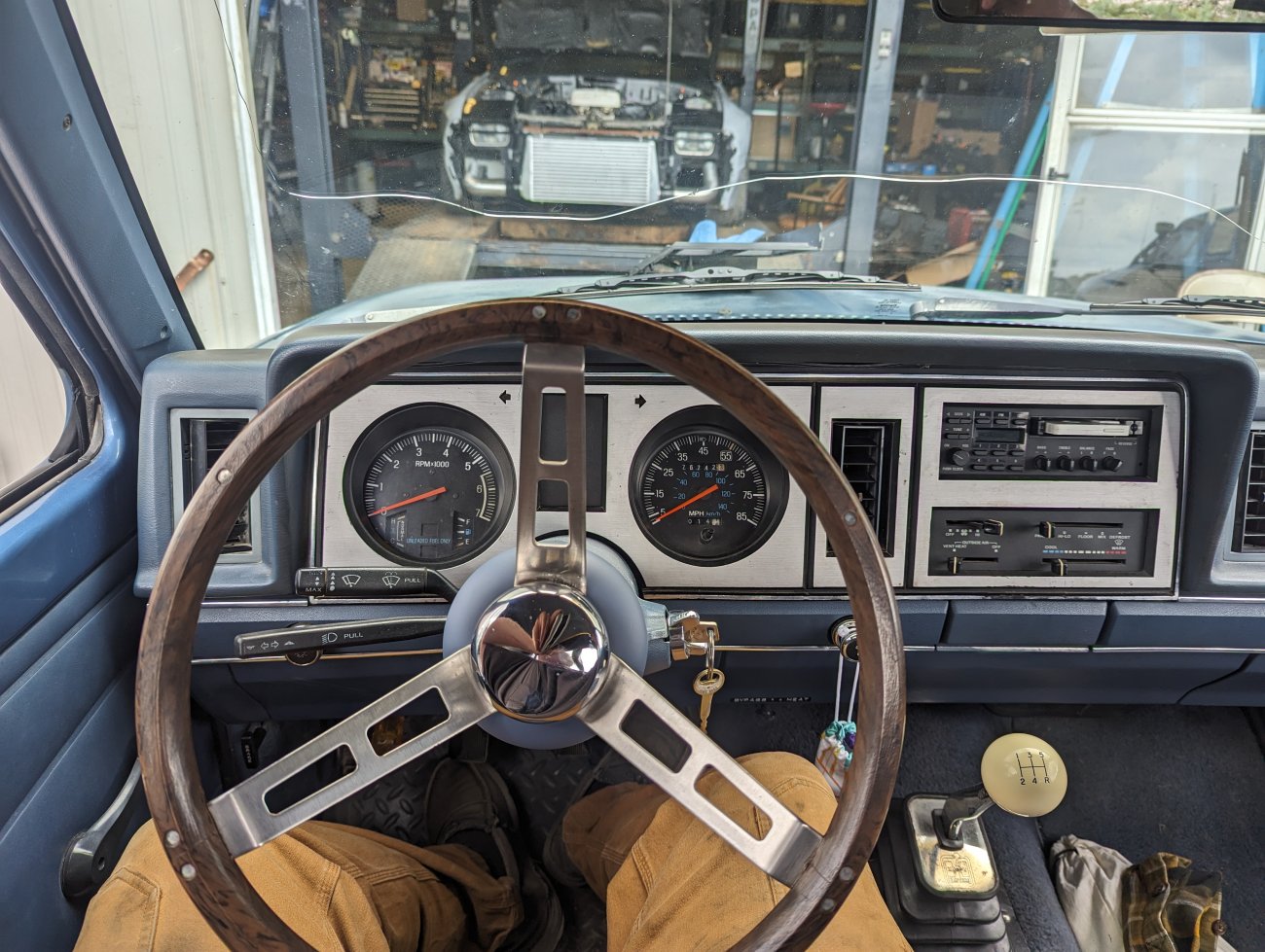

At some point I put a Hurst shifter in that I had laying around as well as a steering wheel that I'm pretty sure came off of a boat. I also put an OEM radio and brushed aluminum dash bezel in.
added a transmission breather since the Hurst closes up the factory vent

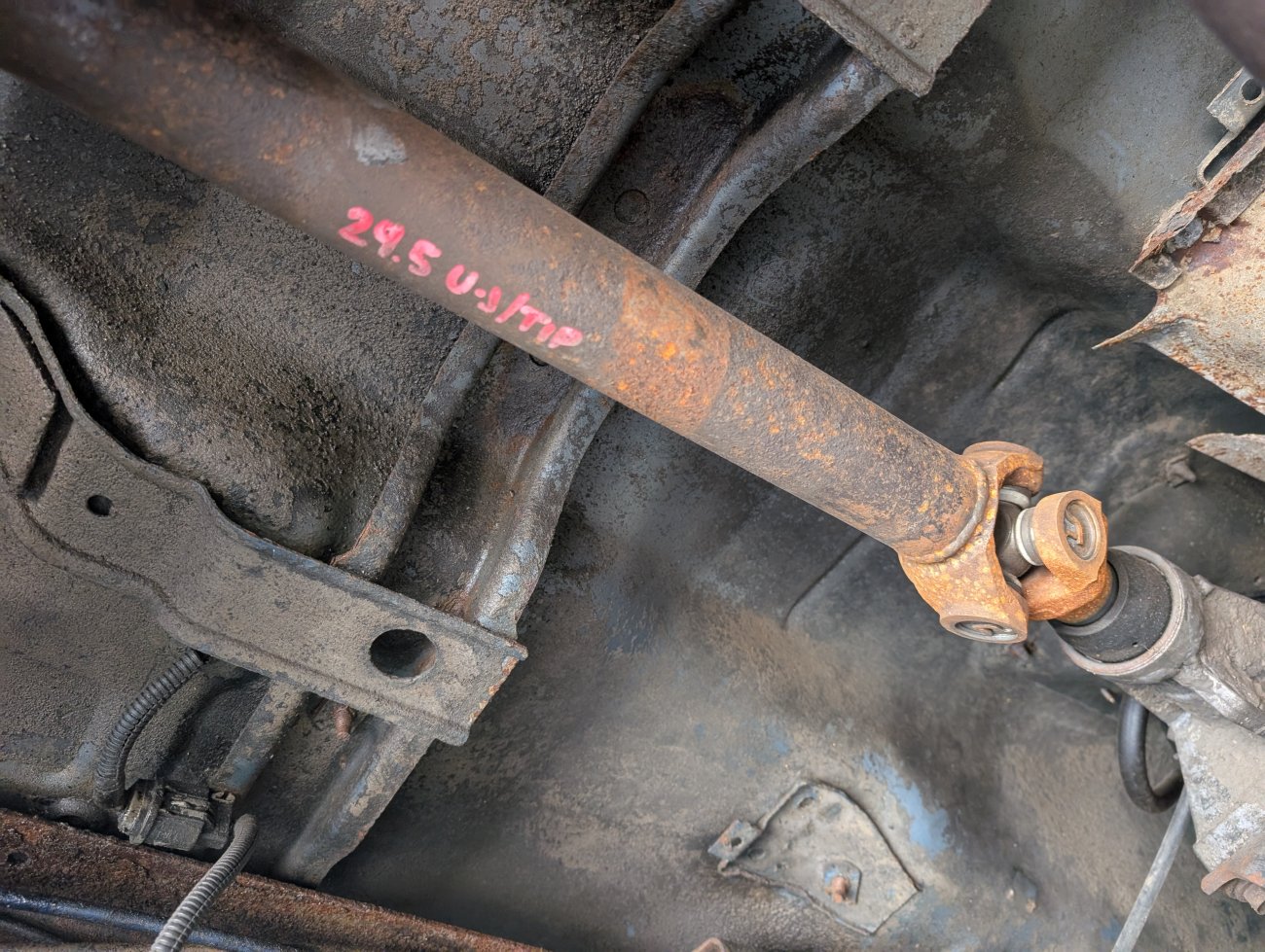

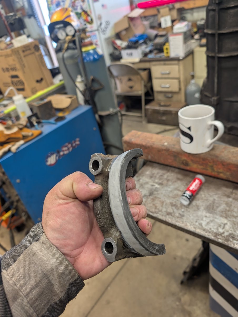

The factory guibo was hanging by a thread since the previous owner had the trans crossmember in backwards putting everything in a bind....Im still looking for the pictures....but I cut it out and welded in a traditional 1310 yoke and slip setup.

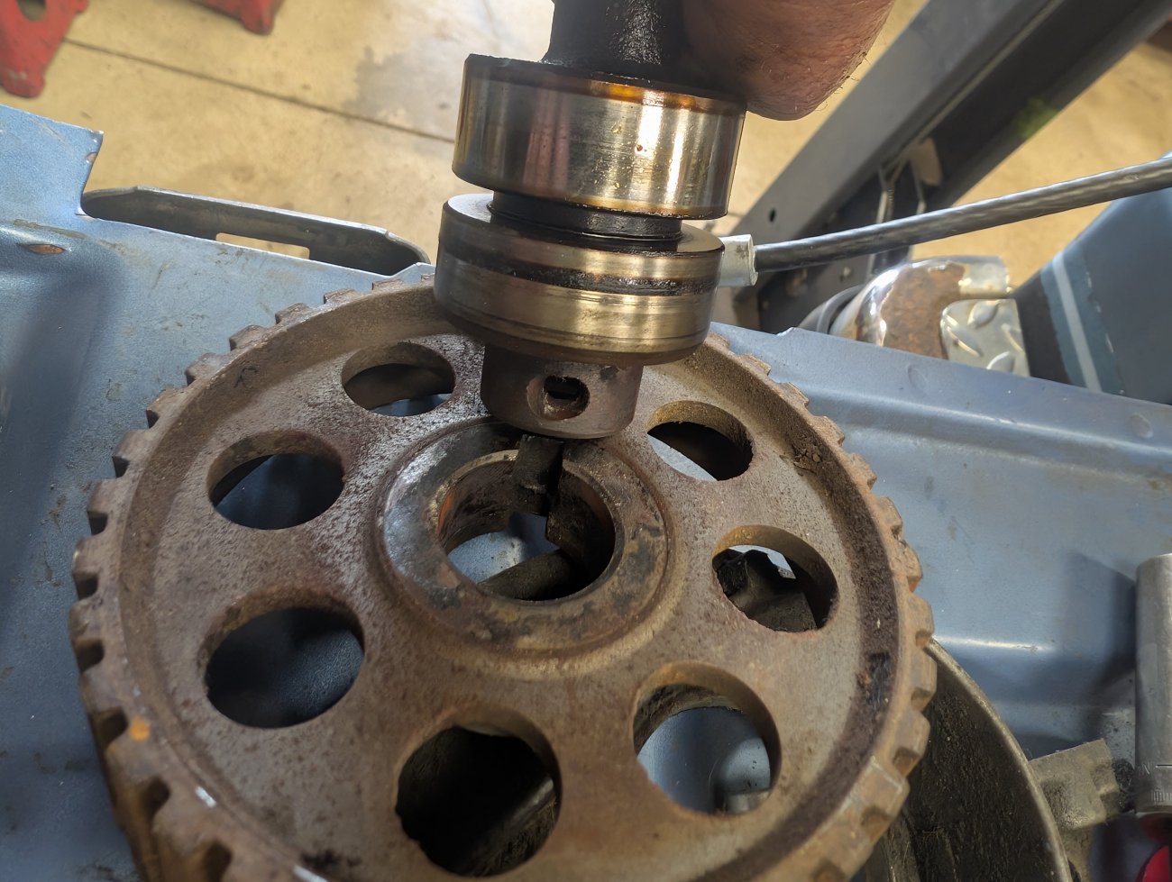

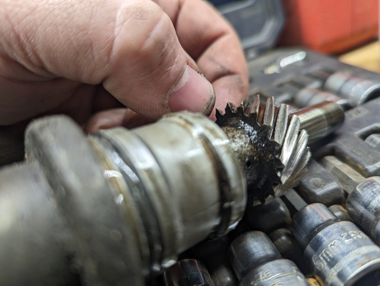

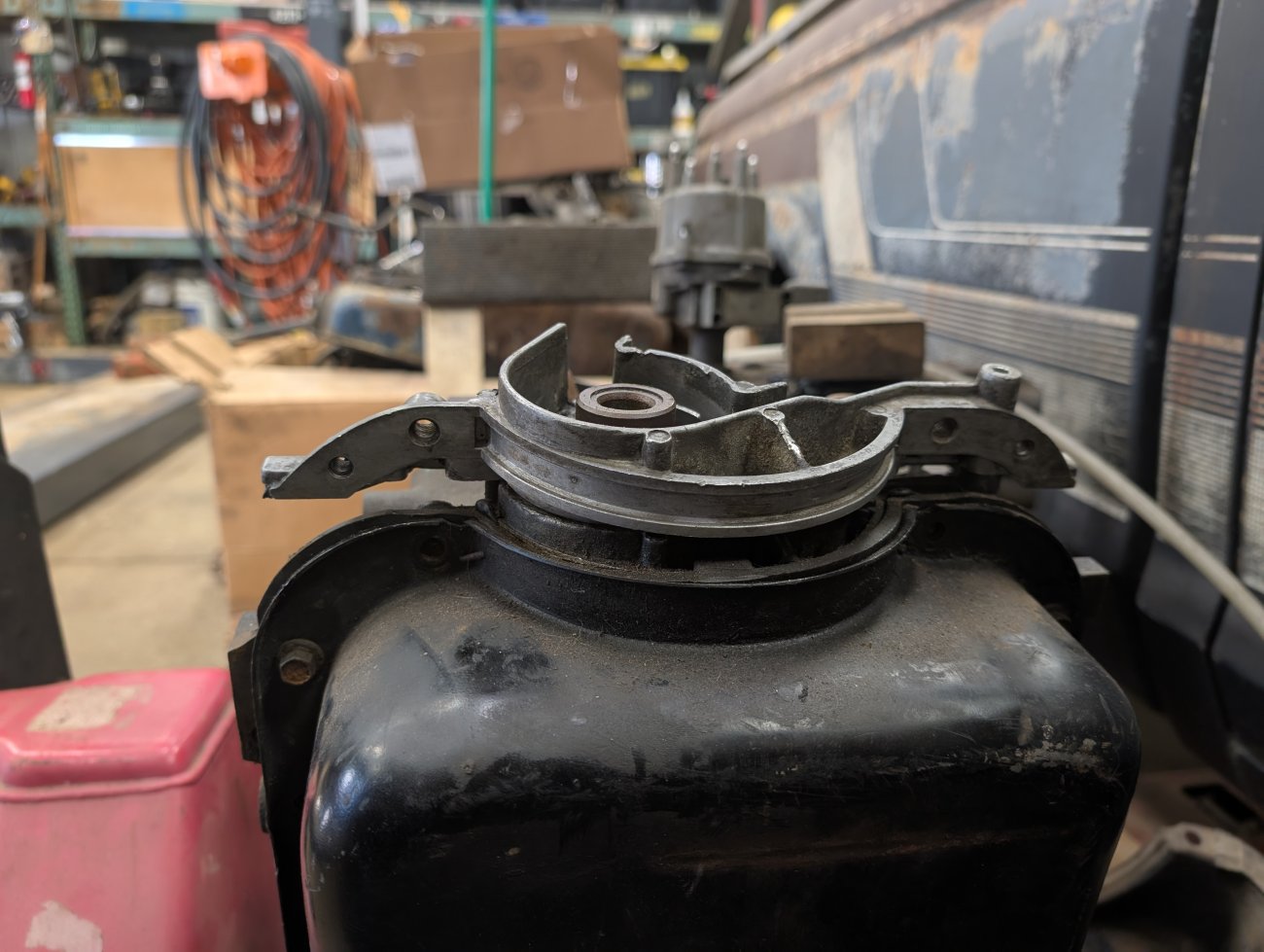

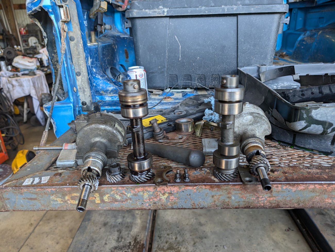

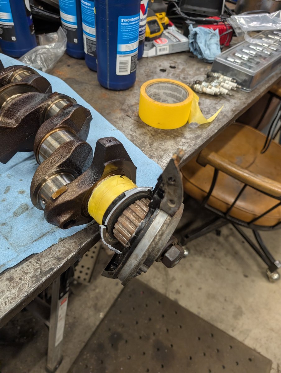

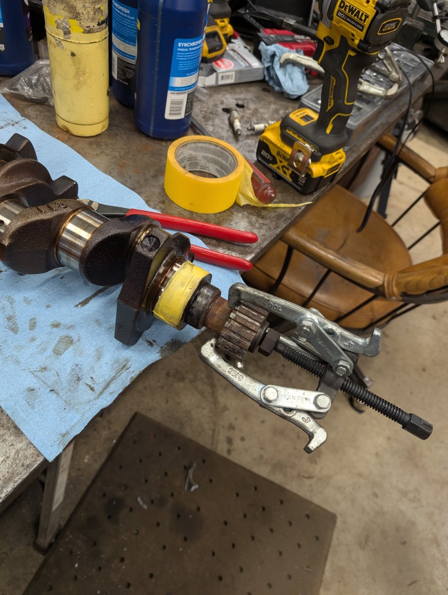

Not long after I started driving it the distributor gear gave up the ghost. I swapped in another distributor quick and it was good for 20k miles or so.
Then it did it again, so I swapped the auxiliary shaft and gear this time. I am assuming the issue was the gear materials or something from using a distributor on what was originally a newer non distributor aux shaft or something.
