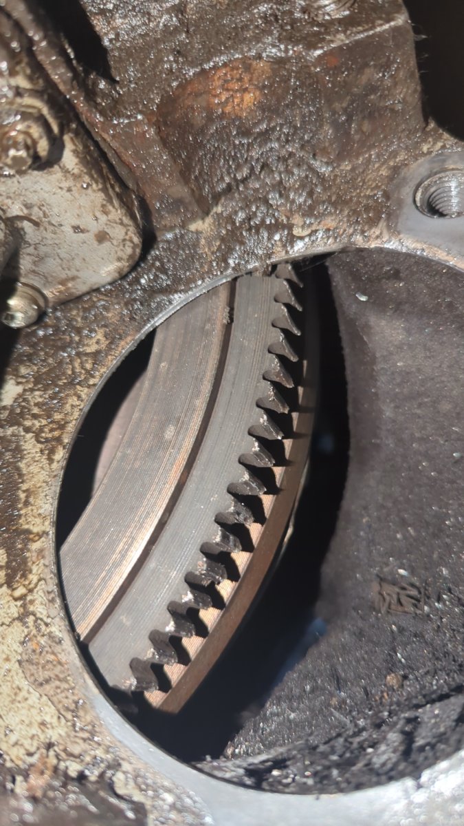

I drove it like that for a bit until the flywheel ring gear got destroyed as pictured below (and yes it had a massive PS fluid leak plus a few others that are still there).
Soul crushed and seeking advice on starting problems
When the flywheel gave out I made the choice to buy some more tools, a new flywheel, and ultimately replaced it while the truck was parked in my apartment's parking complex.
This worked great for almost exactly one month before damage appeared in the new flywheel and I am now back in the same boat as before. The truck was working great and I wasn't having issues starting after all the work for 2 or 3 weeks but then it got worse and it started struggling to start even when cold (and hot as before).
Being desperate without another rig at the time I did continue to spray starting fluid into it as an attempt which I thought was helping it start, but my friend actually looked at it with me and we determined that it was having inconstant spark when attempting to start. We checked the ohms on the coil and they seem to be good, plus spark was good once it started and it ran smoothly with plenty of power.
At this point the truck is parked once again with a damaged ringear unable to crank over.

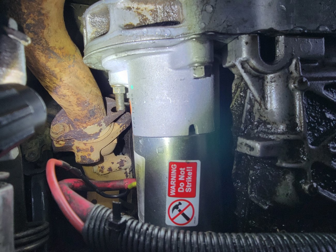

With the amount of dirt and grime around the hole, that tells me the starter wasn't bolted down tight.
My guess is the bolts holding the starter on are to long and bottoming out.

That whole area obviously needs to be crud free before re-installing. If it's just grease and oil easy peazy....if it's crusty means it has been that way for awhile and will require a bit more effort.

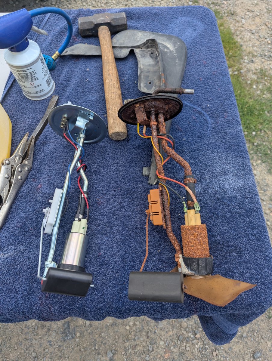

So I actually did check that. No fuel in the FPR vacuum line. l replaced the fuel pump in the truck and the old was SUPER crusty.
The pump does run for a few seconds with key on. When it would start though the truck it had plenty of torque and power.. I once accidentally spun the rear tires in 2nd gear and that was before replacing the pump and it doesn't choke out at all when revving out. Fuel filter also replaced. I have opened the PCM and the capacitors didn't seem to have leaked out, but they did have a bit of a bulge on the top so I had replaced them. Still not completely sure if the PCM is working right though as it would like to idle high, but otherwise would run go with no check engine light. Idle would return to normal if I disconnected the idle control valve. Same behavior with an aftermarket and original idle valve.

Starter and bolts look better than I expected from that first pic. Unless the bolts are working loose it seems odd that it’s eating flywheels. Does it sound like it engages/disengages cleanly with no grinding?

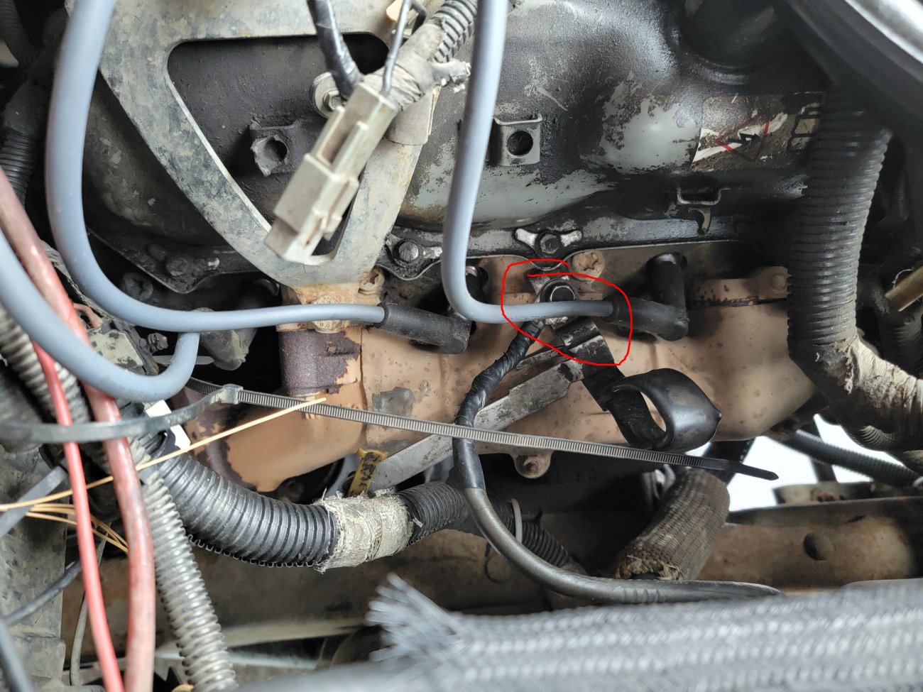

Grounds can cause all sorts of issues even with cranking speed being ok. The normal place for the block ground is on the side of the block above the motor mount on these. Newer trucks take the block ground to the starter but anywhere block/starter/heads works. Normal configuration was a wire that went from the negative terminal to the frame and then over to the block. I usually run separate 4 gauge wires. That one you have on there all taped up concerns me about how well it’s doing its job.
The “dinky” ground wire is by the battery, just a short bit of 10 or 8 gauge running from the negative terminal over to the core support.
That is a super crusty pump! Yikes!

Do those look like factory starter bolts? The bottom one seems normal to me but the top one always stood out as odd since it's got all the extra threads on it after the bolt. I did clean them before reinstalling too.

I taped up the ground wire.. felt like I should put something around it since it was near the exhaust.

I'm wondering if the seperator plate between engine and trans has an oblong hole where the starter is supposed to engage? If it isn't correctly positioning the starter that could cause ring gear wear.

Starter, starter bolts, separator plate, and bellhousing are all the common suspects for chewing up a flywheel. But usually it makes noise before it chews up a flywheel and nothing is glaring obvious as a problem and it sounds like you’ve been make good effort so it’s either something dumb that we are all overlooking or I dunno.
