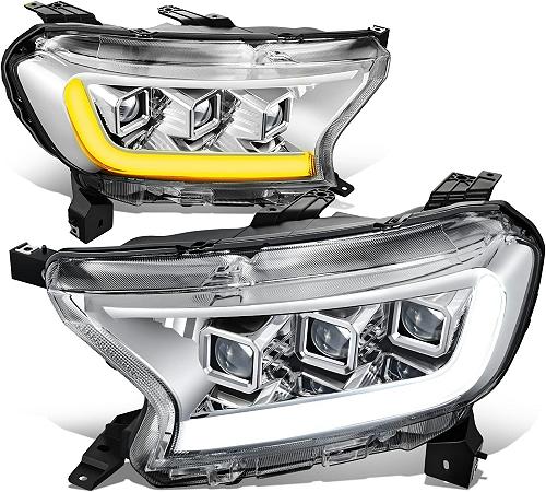

Upgraded Headlights
If your Ford Ranger didn’t come with LED headlights, you can upgrade them. For me, brighter lights are a necessity. The rural roads here in Texas have a 75-MPH speed limit, and you can come up on a feral hog, loose cow, deer, and armadillo pretty fast in the middle of the night. You don’t need to purchase the factory LED headlight assemblies if you don’t want, you can purchase aftermarket LED headlight assemblies.
2019-2023 Ford Ranger LED headlights

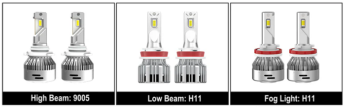

If you don’t want to swap out your headlight assemblies, you can upgrade by simply swapping your headlight bulbs To LED Bulbs. Check Out: Upgrading 2019+ Headlights To LED.
Stock Headlights
  • H11 – Fog Lights / 1,200 Lumens
  • H11 – Low Beam / 1,200 Lumens
  • 9005 – High Beam / 1,700 Lumens
LED bulbs are sold in pairs, so their Lumen rating is typically the combinations of both lights. When comparing LED headlights to Halogen lights, think of Halogen lights as having a combined Low Beam of 2,400 lm and a combined High Beam of 3,400 lm.
Most LED headlight bulb manufacturers seem to lie about the lumen output of their bulbs and if you compared them to LED light bars, you’d find that the some of these bulbs are claiming to put out more lumens than light bars. The only company that I have found that seems to list truthful lumen ratings is LASFIT.
Lasfit LED light bulbs

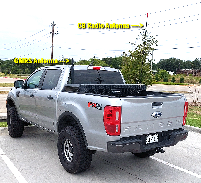

Antenna Mounts
When installing a GMRS or 2-Meter radio you’ll need an NMO antenna mount. Companies like Larson and Bullet Proof Diesel both offer third brake light NMO antenna mounts that fit between the truck cab and the third brake light.
I actually made my own antenna mount using flat metal stock bolted to my toolbox. I personally couldn’t see spending over $200 for an antenna mount when I could make my own.
Third brake light NMO antenna mount
CB and GMRS Radio antennas on a Ford Ranger
DIY GMRS antenna mount
