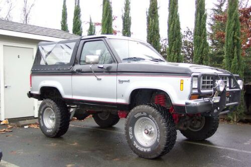

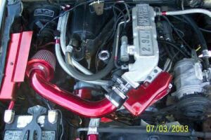

After purchasing the truck Joseph set out to find a set of rolling stock to get rid of the steel pizza cutters. After purchasing a set of rims and tires, there was soon to be rubbing issues with the larger than stock rubber. A 3-inch TrailMaster body lift was purchased shortly after for the start of the lift. Now not being satisfied with that Joseph did some research on TRS and soon settled on a Skyjacker 6-inch class I lift. Now with 9-inches of lift Joseph was leery on how Bronco II handled, so the 3-inch body lift was removed. With the added height a new set of tires in the tune of 32’s was added. The stock axles hold the wheels and tires to the frame. As Joseph found out that the 2.9L, backed by a Mitsubishi 5-speed and BW1350 T-case, needed a bit more to get the Bronco II rolling. With a bit more research again he found that an aftermarket intake tube from a 1995 Dodge Neon fit the bill. After fixing the valve cover leak he soon realized that gas is really the only thing you need to add to keep a vehicle running, for 250 miles at a time.
The lift didn’t stop there. A set of extended radius arms were ordered to make the 6-inch kit a full Class II lift. He was now satisfied with the truck…………or was he????

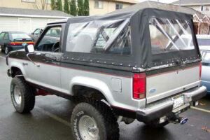

We all know someone who just cannot leave a good thing alone, well now you know another. The idea of a removable hardtop struck his fancy. That little devil on his shoulder kept telling him “Do It, Do It, I’ll help”. So, with the advice from the little devil, he set out chopping the top. After weeks of not hearing from the little helper, he was left to finish the project that was beyond going back. After time things worked out until it started raining. This is where things get interesting. Joseph put the hard top on hold and decided to shop around for a custom soft top. After the second top he was satisfied and leaned a valuable lesson. A proper chop top is a lot of work even for the average fabricator.
Ford Bronco II soft top
Inside view of soft top

From what I can tell the only thing this guy hasn’t changed is the front quarter panels and hood. A front brush guard was found and installed. Well after the chop Joseph had no place to mount his spare tire, so a rear tire carrier from James Duff was bolted in place of the stock rear bumper. Seems as though it’s a great mod for the ones who have chopped the top.
