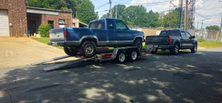

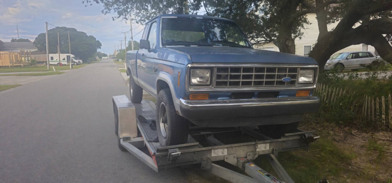

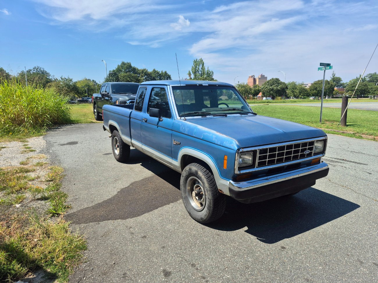

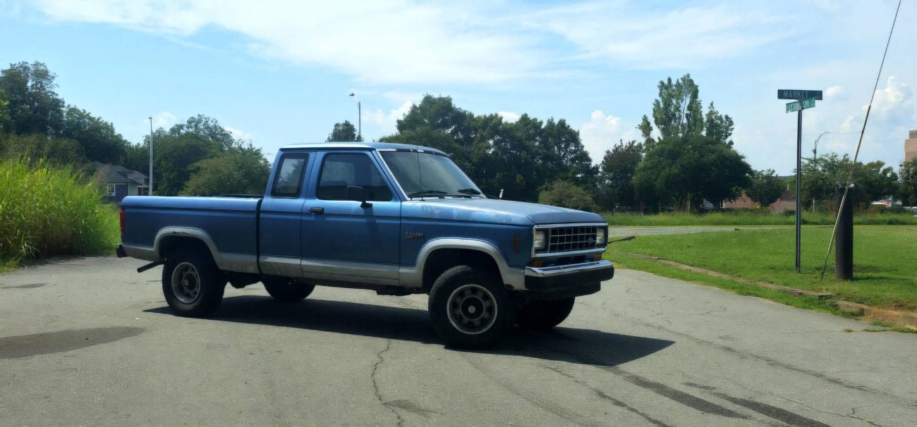

First week of September, found this survivor 4 hours away. I'll chronicle as best I can as I work on her.
Seller is a Junk Car guy and didn't know it was 4WD until I asked him to take underside photos and send to me before I commit to the road trip. He actually sent video of the underside, including his cursing out his guys for not letting him know it was 4WD before he listed at his asking price. Needless to say, the price was better than I was willing to spend, although it did hurt me in negotiating because the price was so good. She's a 5 spd 2.9 and shows 69,xxx miles on the old 5 digi odometer and runs smooth in the videos he sent.

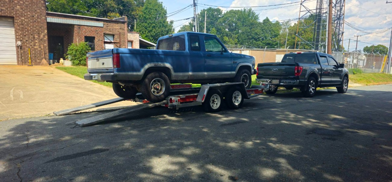

When I arrived, it was still up on the top level of a double deck trailer, so I was able to gander at her underside, noticing the body bushing rear driver side down. She's has frame rust, but no rot I could find. She fired right up after I verified the motor was cold to the touch; no smoke, no knocks, no ticks. Brake fluid squirted out from the right front as he eased her off the trailer. I let her sit and idle for 15 minutes after he backed her down. Temp gauge didn't work, but everything else did. The old face under the hood to feel if she heated up too much proved she didn't. She's dirty and grimy under the hood with the usual suspect valve cover leaking on the exhaust manifold. The tranny has oil down on it, hopefully from just the valve covers, not the rear main, but we'll tackle that as well if needed.
In my humble and hopeful opinion, she's rolled the odometer once. I didn't see anything to feel like she's been rebuit/replaced. She runs too good for two trips around the odometer.

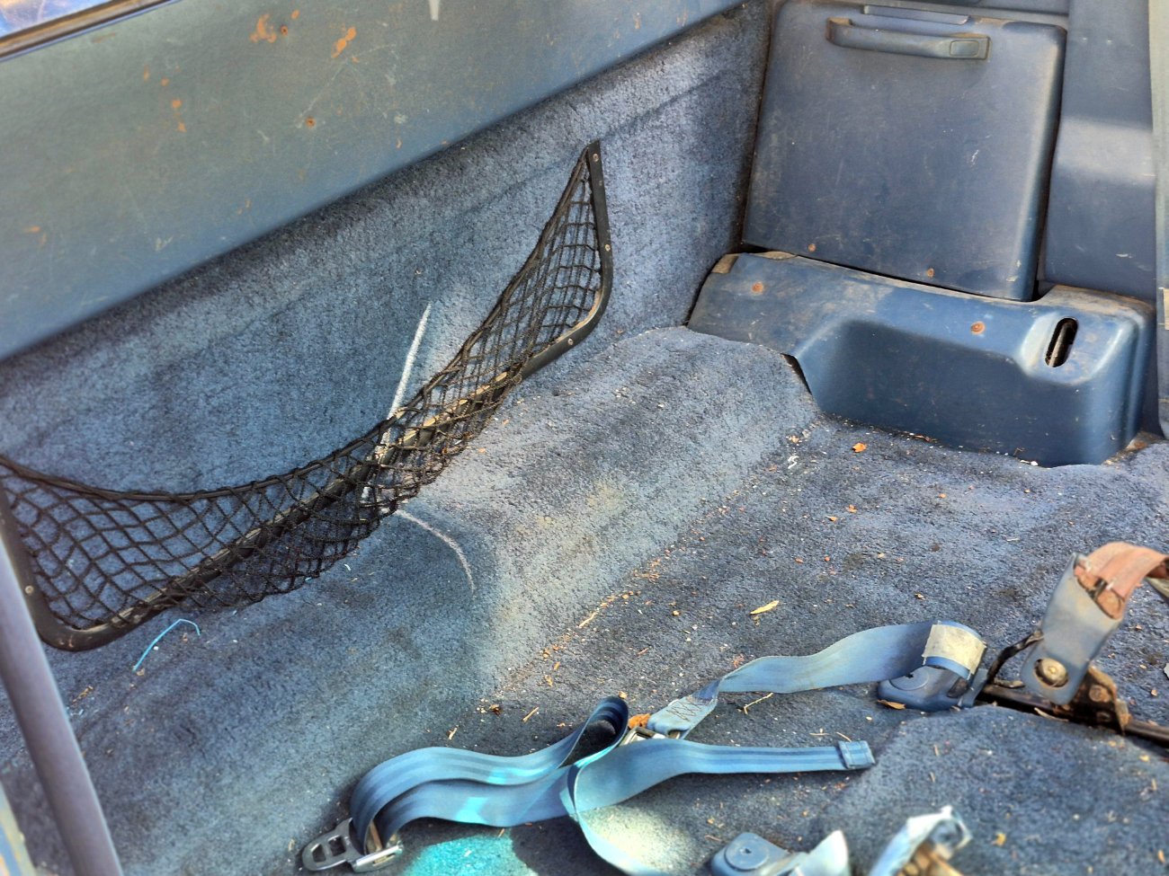

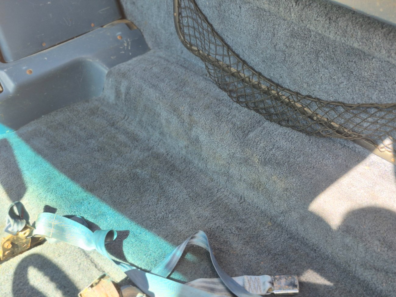

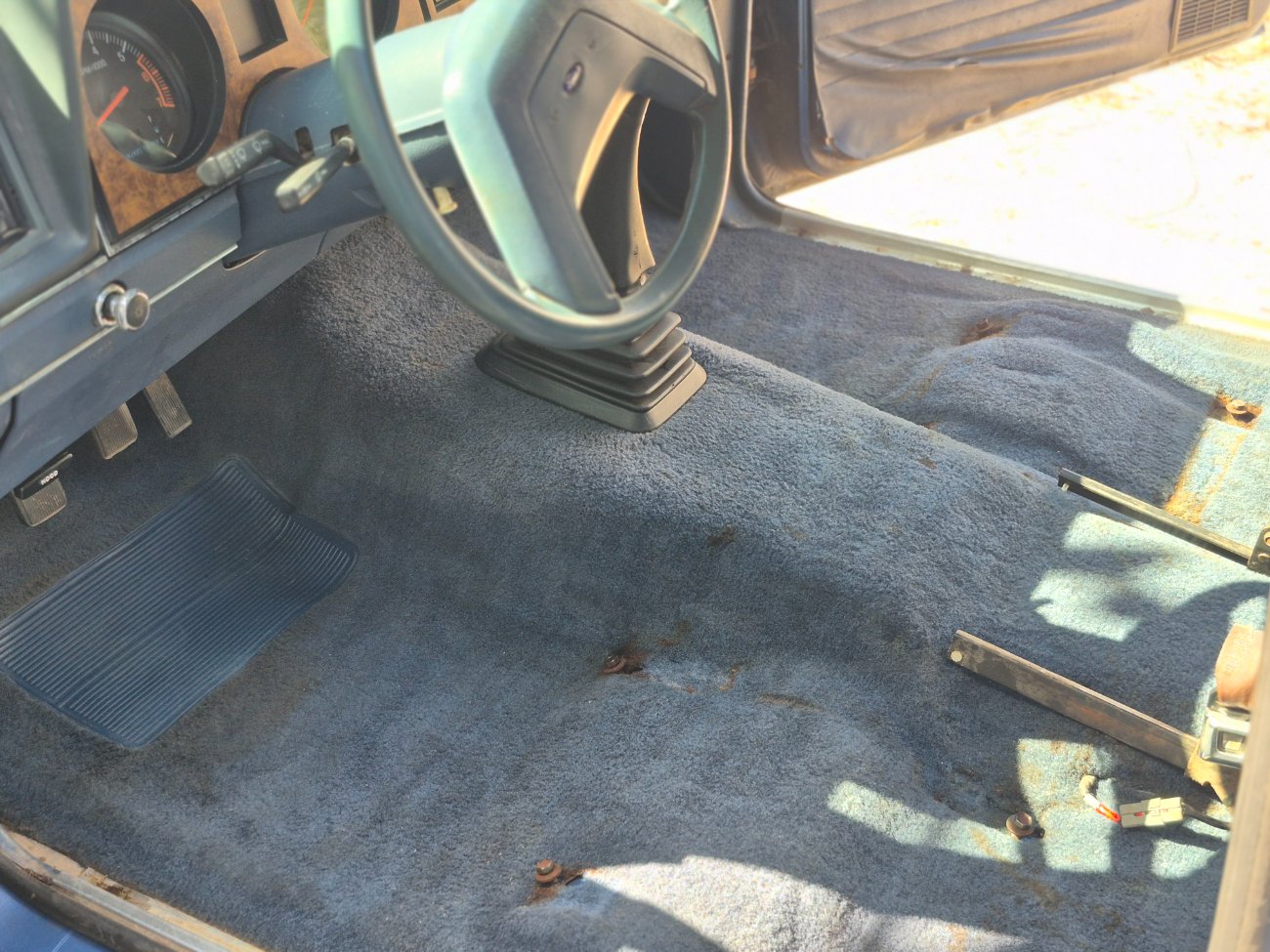

The exterior is the original paint, sun faded witha couple edges showing patina. Each rear fender shows rust, but feeling inside, it doesn't seem to be in the inner fender. The right front has a rot spot just behind the bumper edge. The interior, for a 38 year old truck is exceptionally good shape, minus the door cards warped and vinyl torn at the bottom, but the cards are there with all the pieces. Everything else was there and no matted carpets. Dirty, yes, but she can be cleaned.

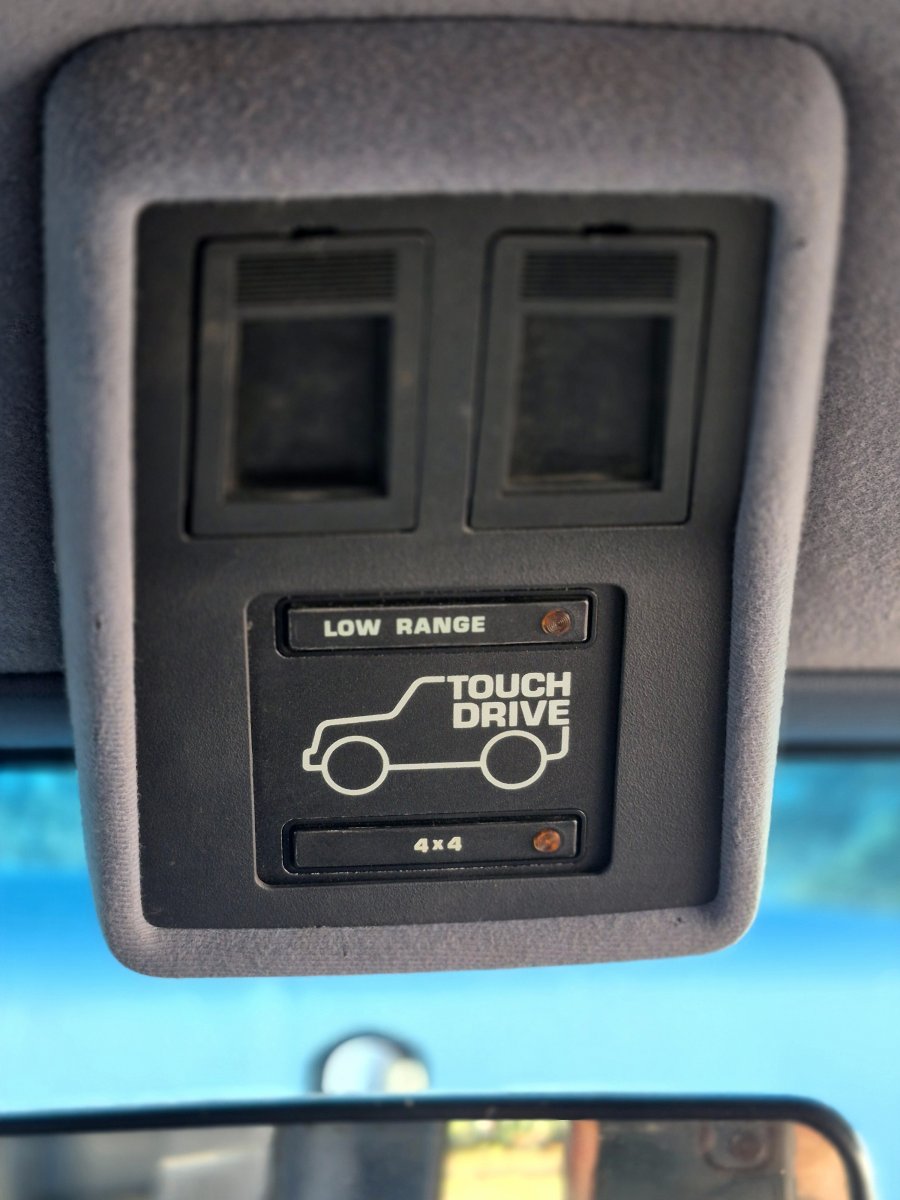

AC doesn't work, but I did get the compressor clutch to engage by jumping it. Blower works as well as blend doors. Touch Drive doesn't work, but she's in 2WD, so working on that wasn't pressing. Right side speakers go in and out, left side works fine. All the knobs, buttons and lights work except the brake lights. We negotiate and settle on a deal. I got a couple hundos off his asking but I easily scored her for more than half of what she's worth. This could be an easy flip, but she checks all the boxes for what I want.
The coup de grâce is the original 1988 Title placed in my hand. She was a one owner. She appears to be 100% unmolested. I loaded her up my the rented Uhaul and strapped her down for the 4 hour journey home. Clutch was a little soft, so hopefully just chasing air bubbles is on the agenda.
I started my month long hiatus from work, so I have been busy piddling around with her. She'll be my kayak hauler for fishing so my 21 F150 takes a break from those duties.

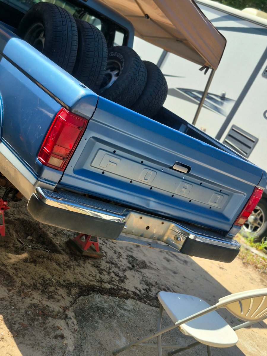

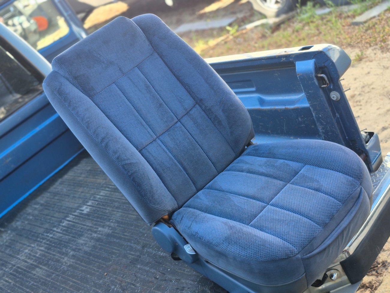

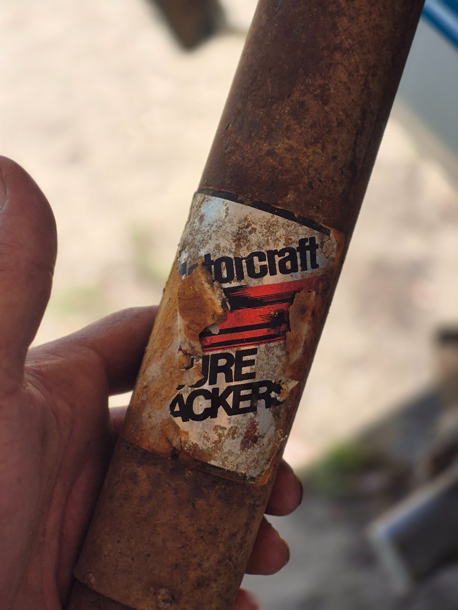

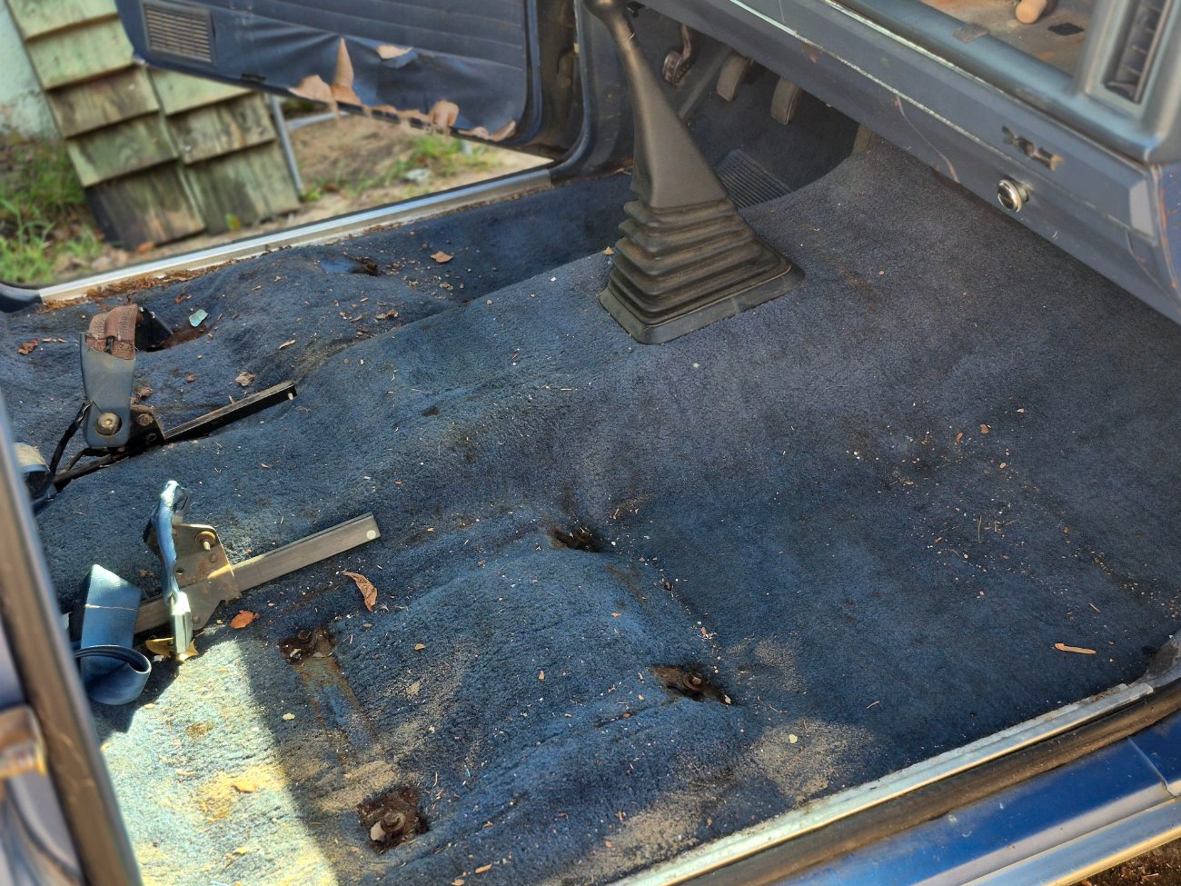

Some photos before & after the clean up. Also Shocks and brakes. I think the shocks were a bit wore out. That ashtray has never seen a cigarette.

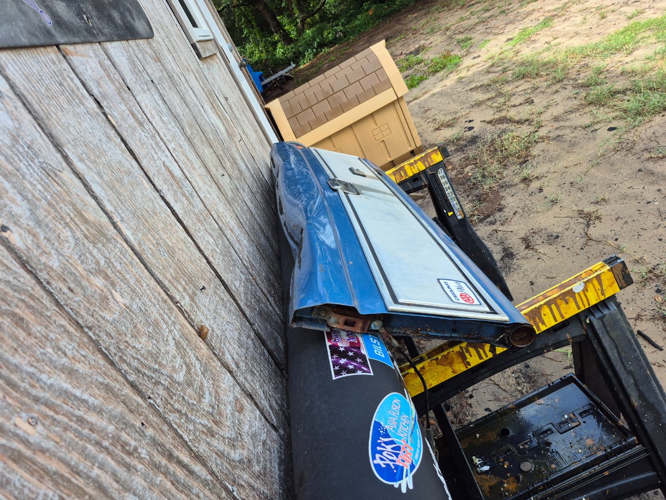

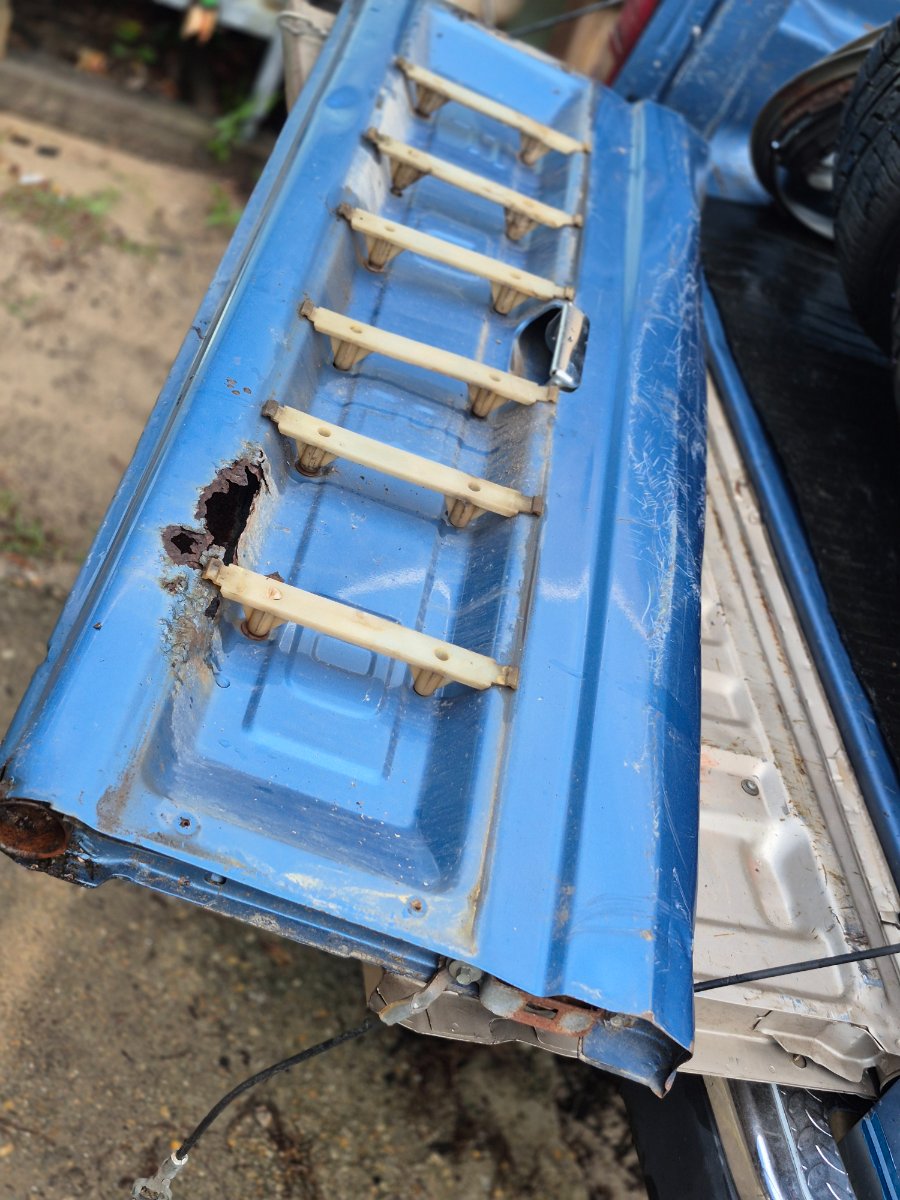

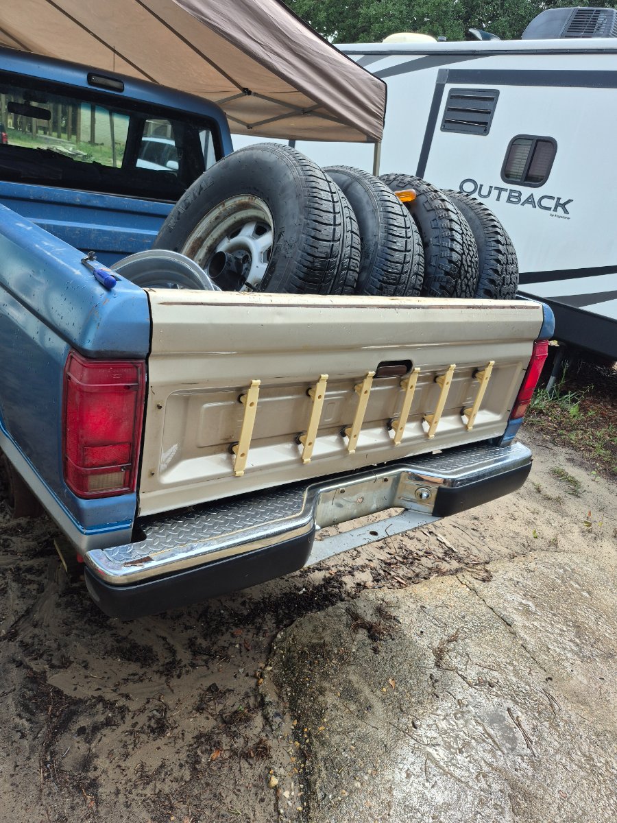

Scored a donor tail gate. I am no painter, but she's close enough matched for horseshoes or hand grenades.

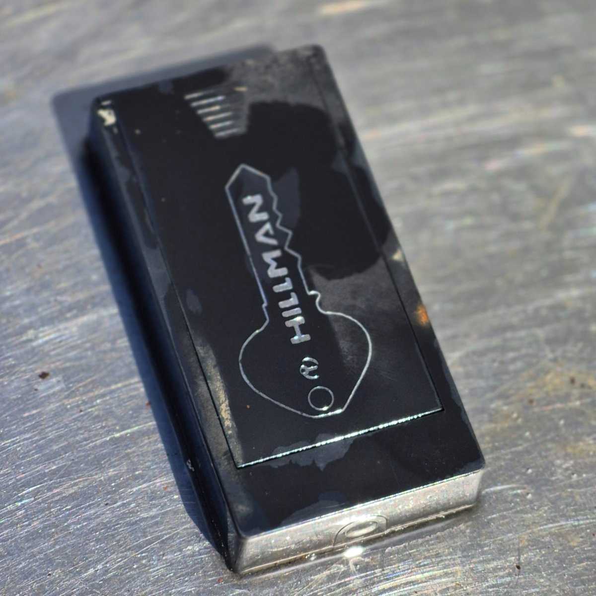

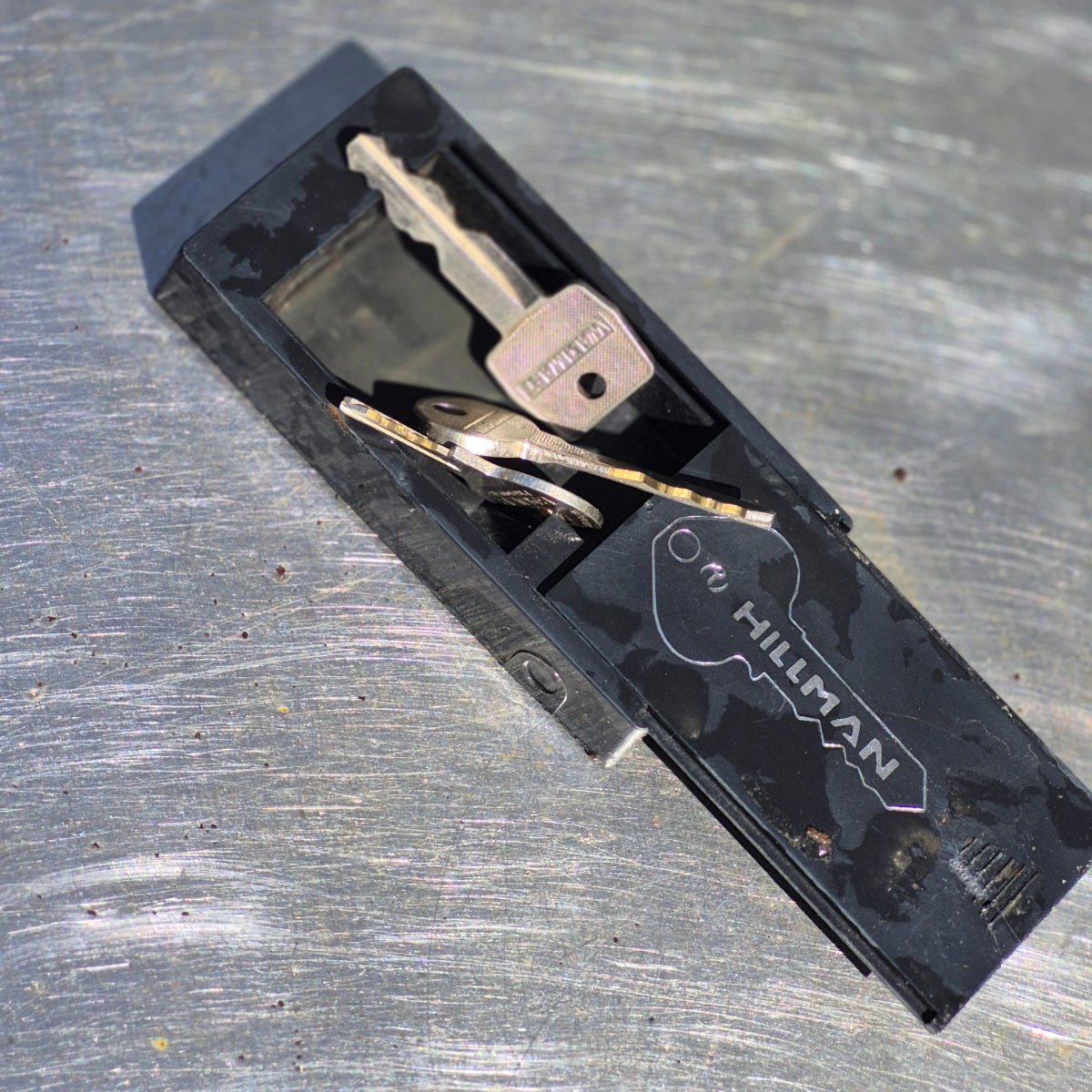

I did find some spare keys tucked in the frame rail while taking off the old shocks. Score!

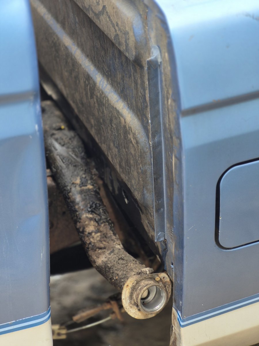

Brake line was rusted through where the metal meets the rubber hose on the right front, so ordered the truck's metal line set from Classic Tube.

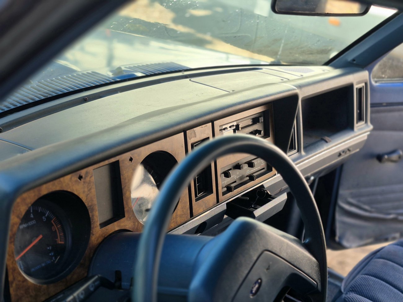

That dash is in phenom shape and the bed cleaned up nicely as well.

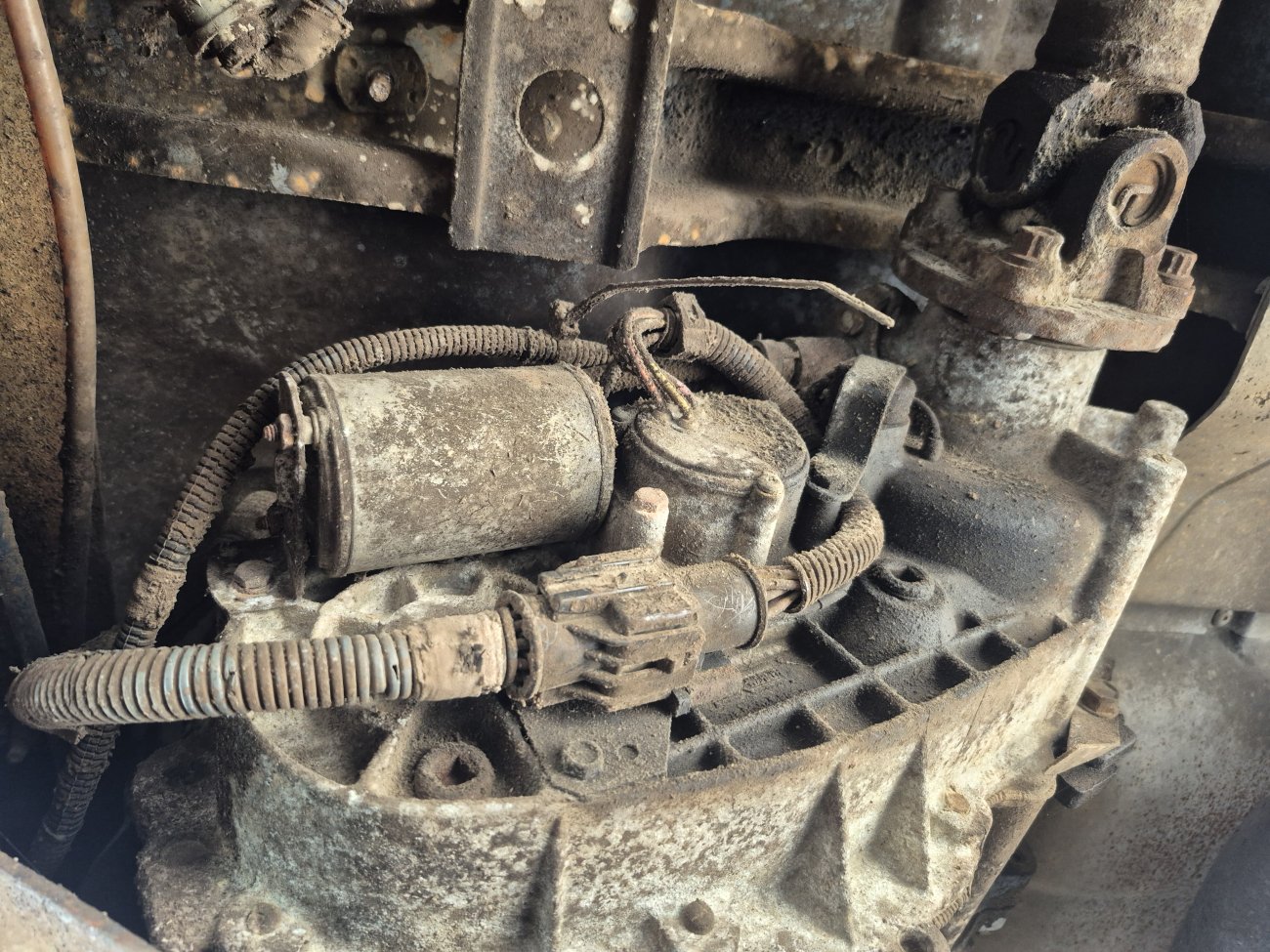

4wd fixed. Touch Drive actuator motor's internal stop bushing was gone, so a trimmed down piece of vacuum hose got her back right.

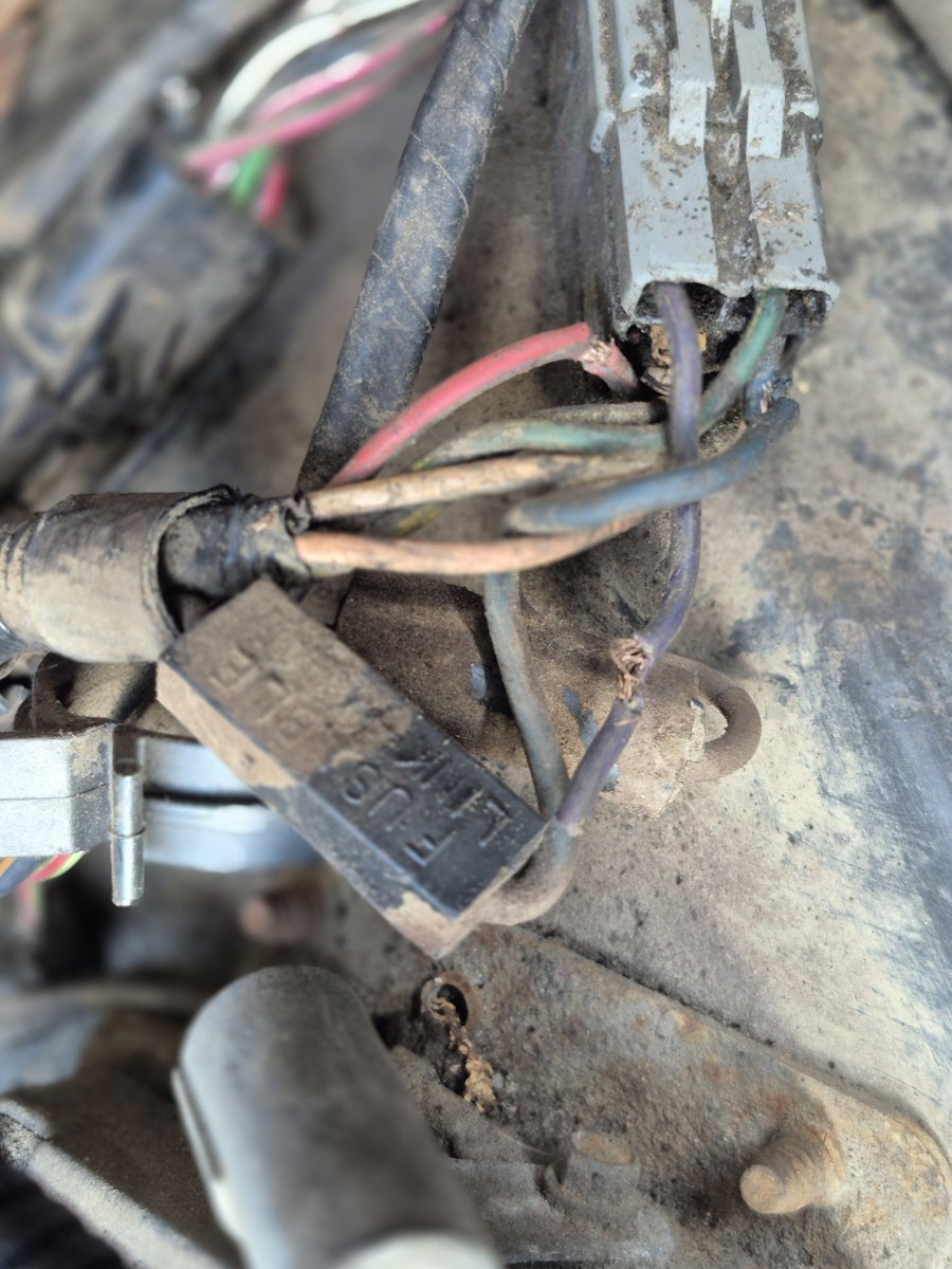

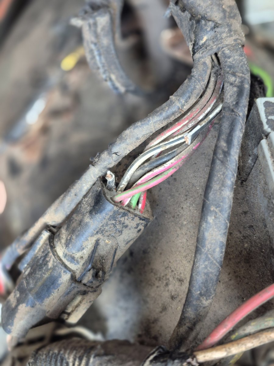

Found some jacked up and cut through wiring under the hood, got those repaired.

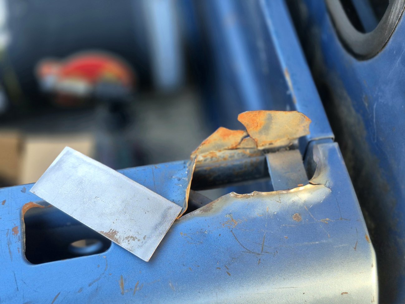

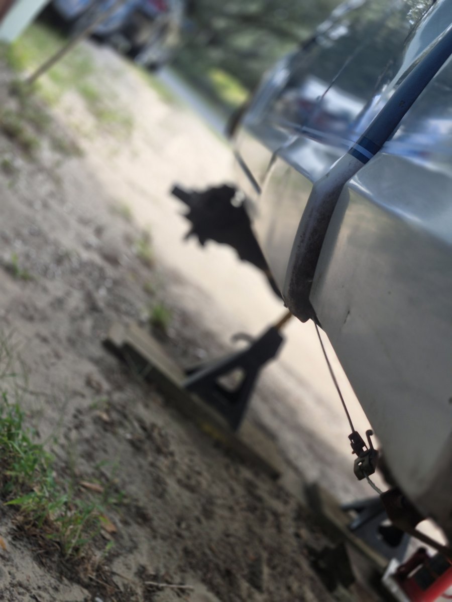

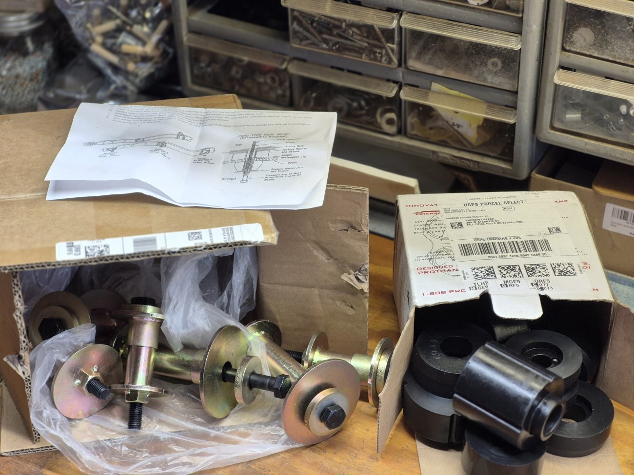

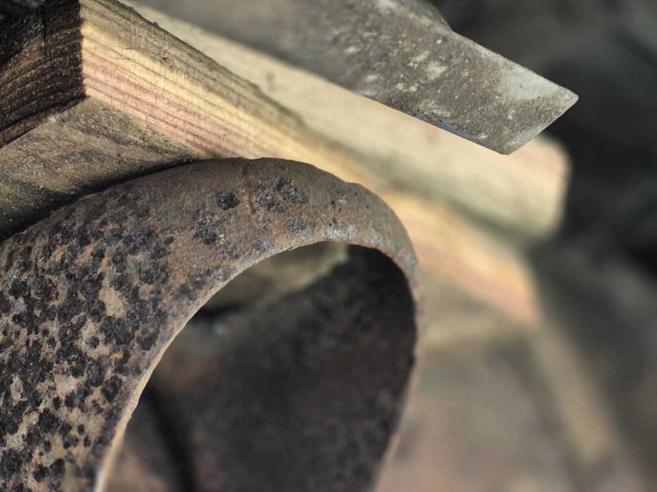

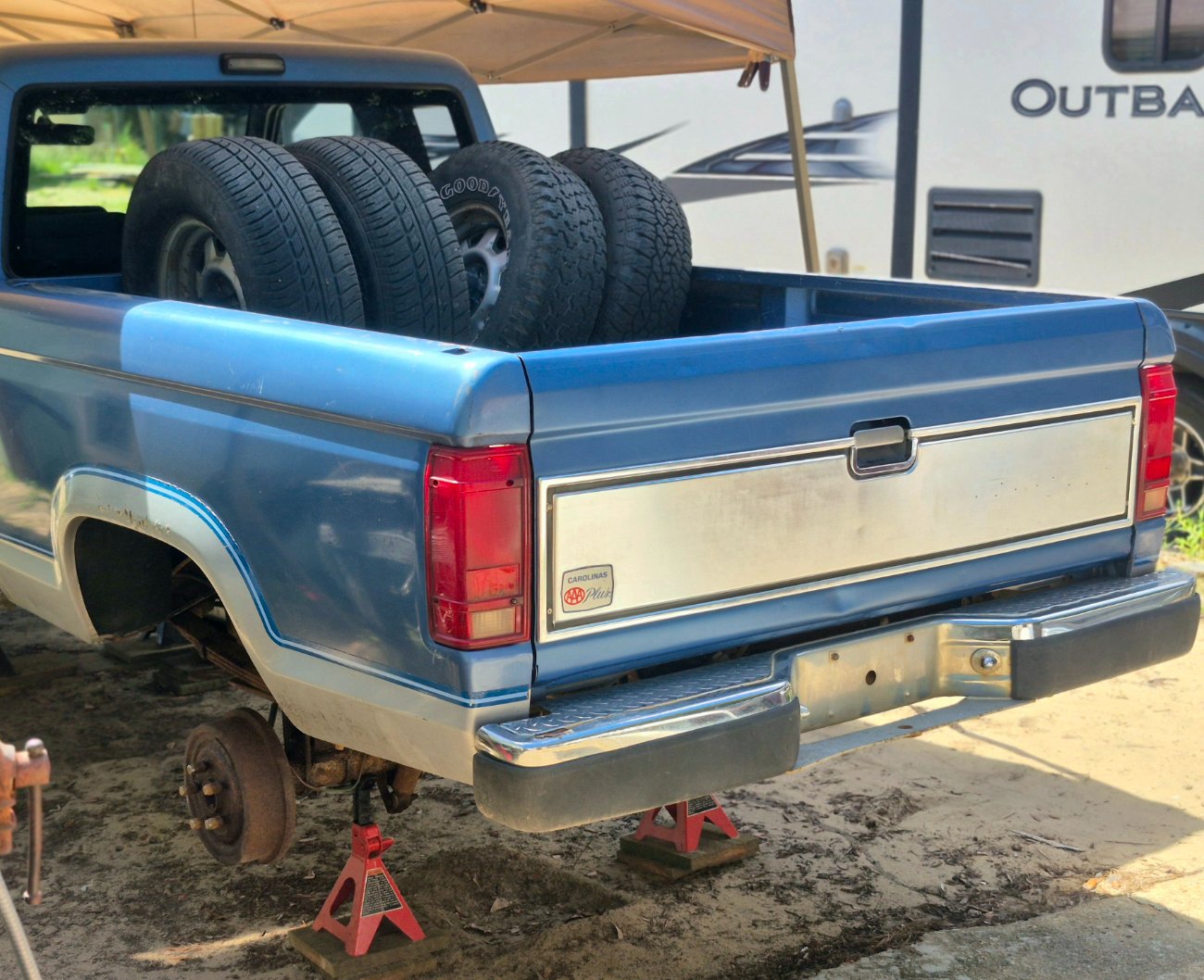

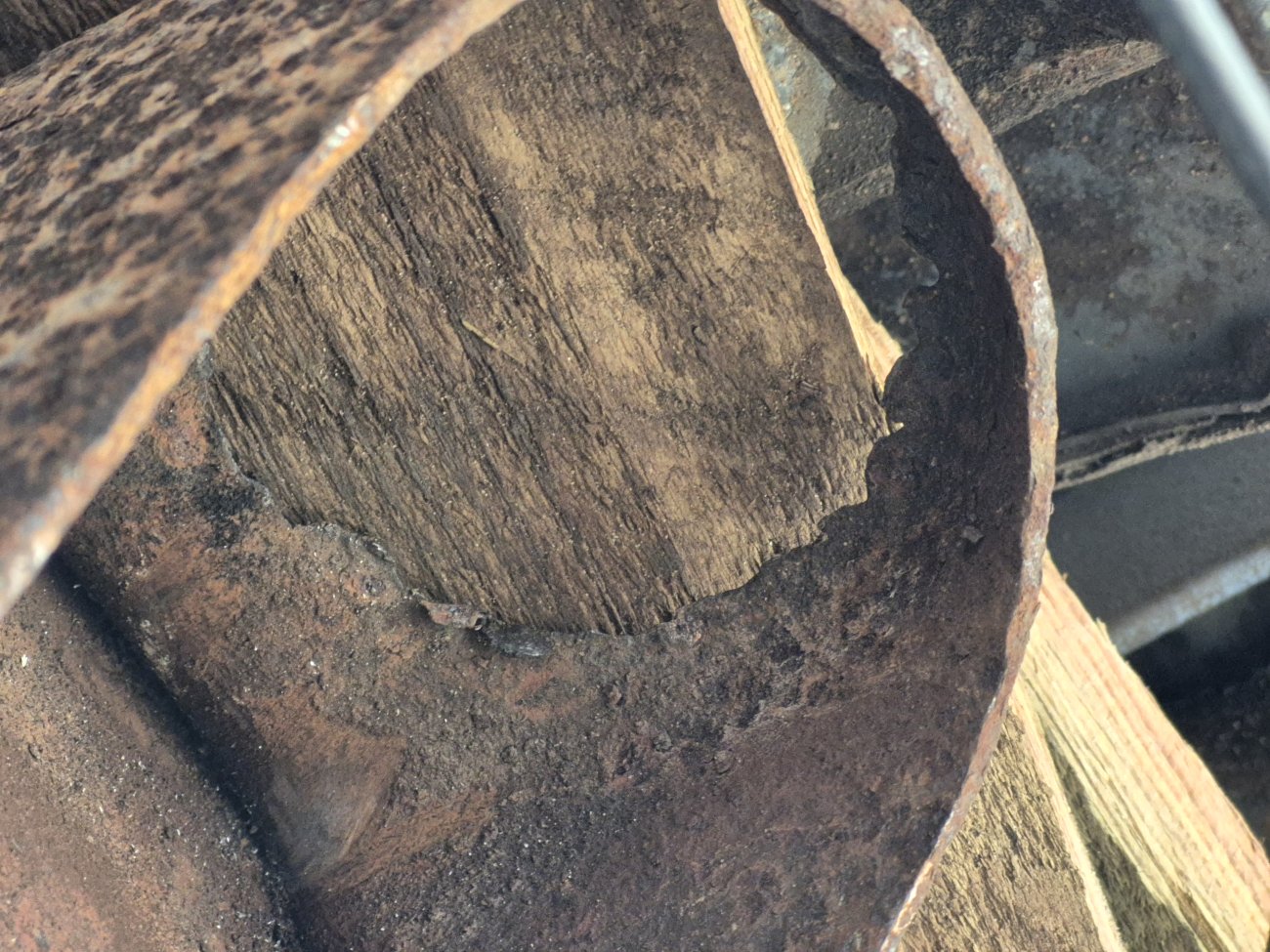

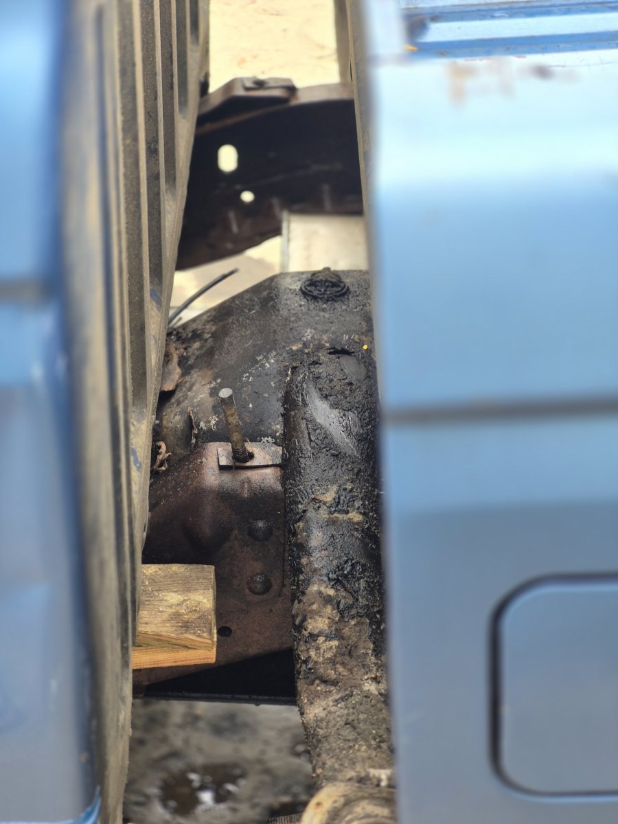

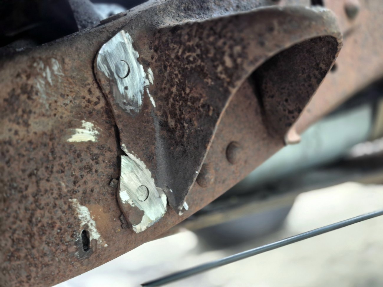

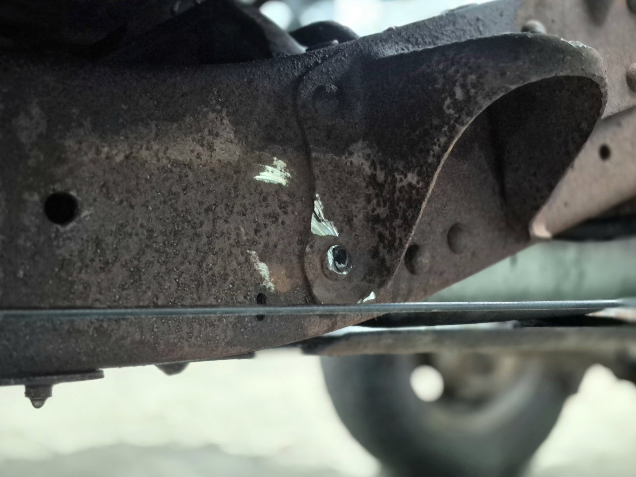

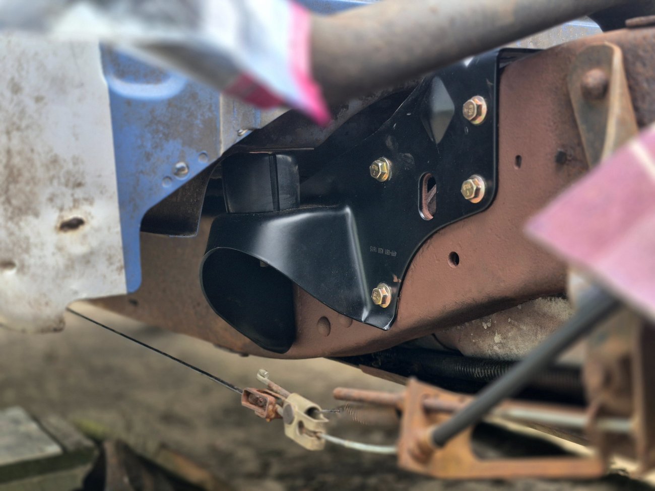

Body bushings came in and that's when I found the rot. Just the rear driver side, clear through the mount. Temp pieces of wood until the just ordered perch from Parts Geek arrives. The 5 other mounts are good and the bushing replacement went pretty easy otherwise.

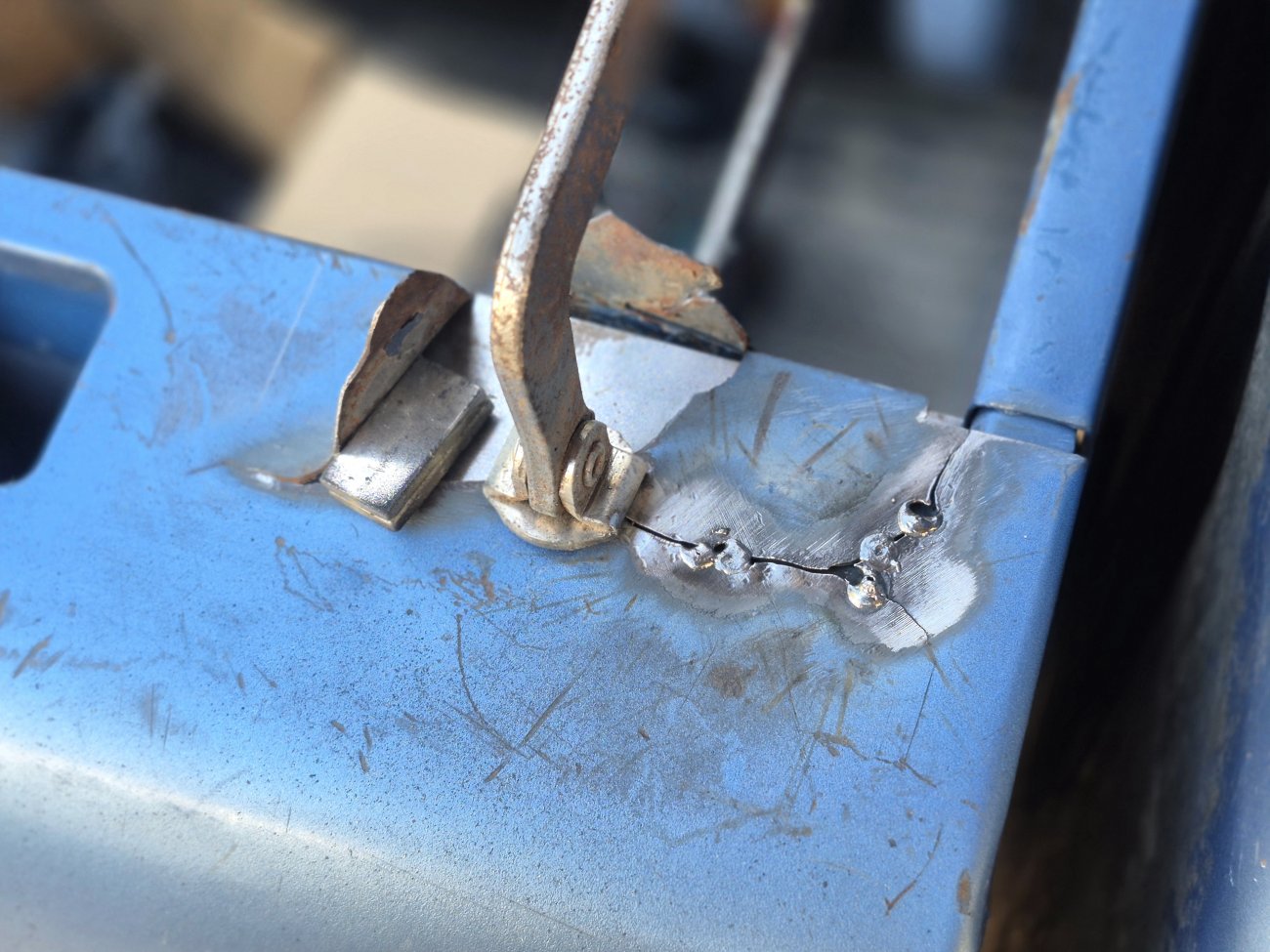

I absolutely loathe flux core, but she gets the job done in a pinch.

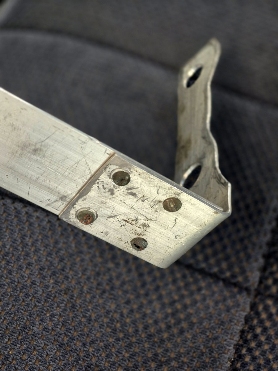

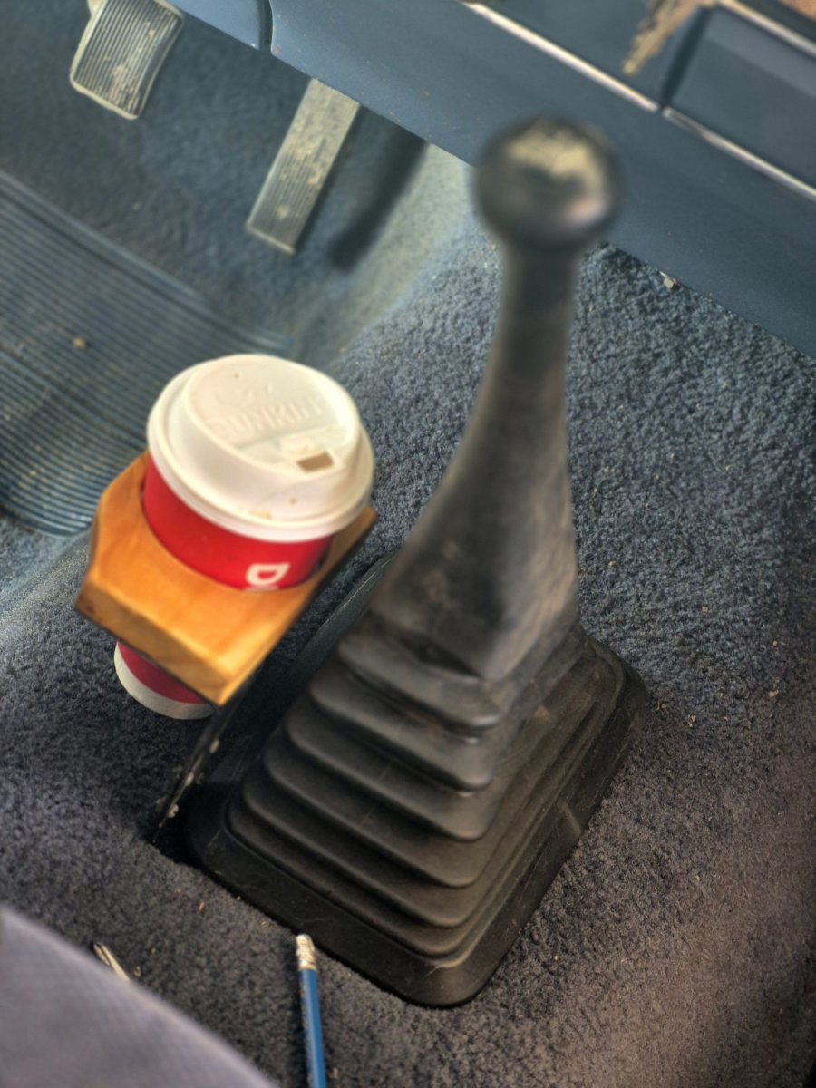

What do you get when you have some aluminum flat bar, brass nuts & bolts plus some random wood scrap laying around? You get a floating cup holder for the God Juice Dunkin Donuts Coffee.

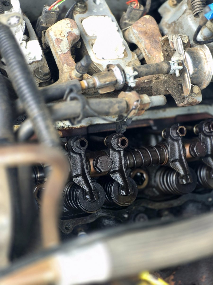

Good news is I figured out why the valve covers were leaking so bad. The bad news is that I have to helicoil 3 bolt holes.

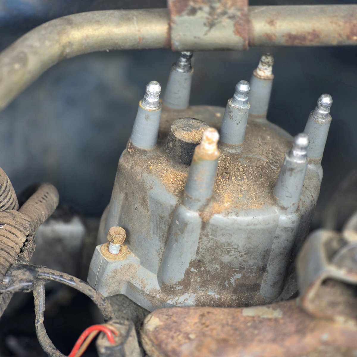

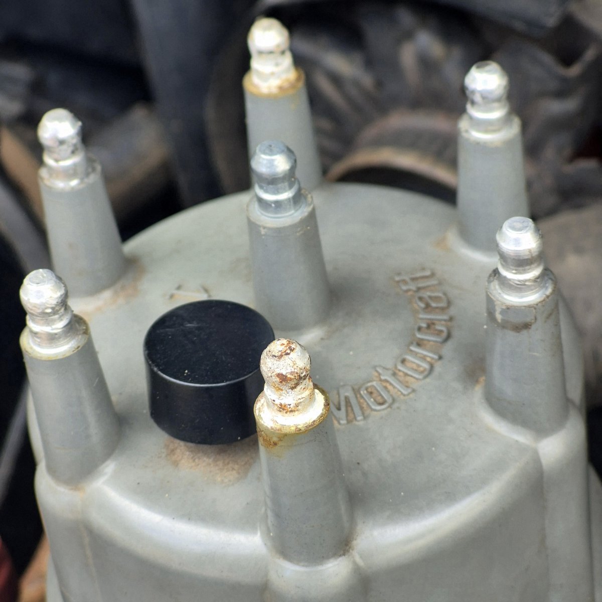

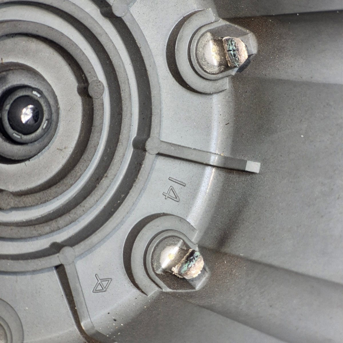

This cap has had a life. Makes me wonder why she runs so smooth.

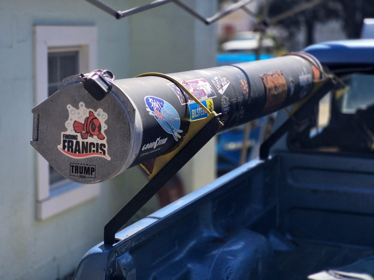

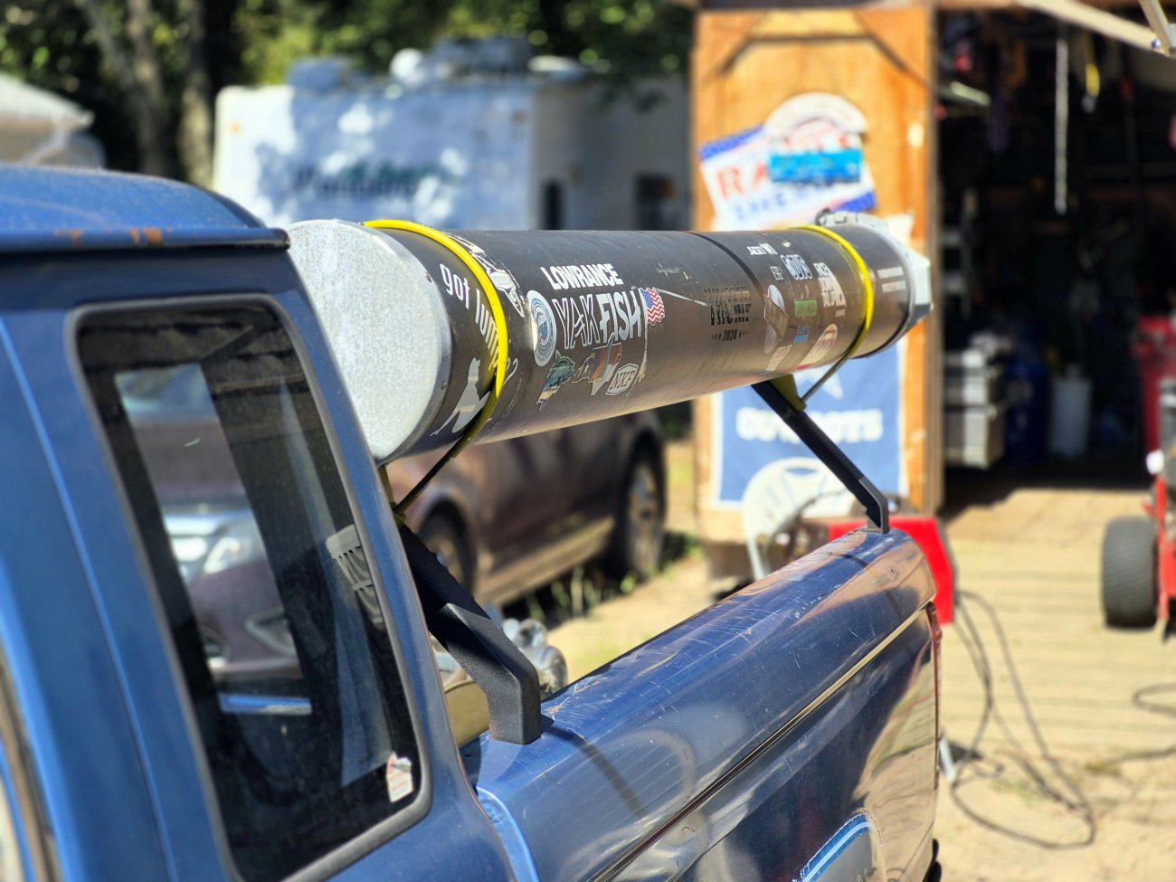

I did get to make (re) the rack for the rod holder.

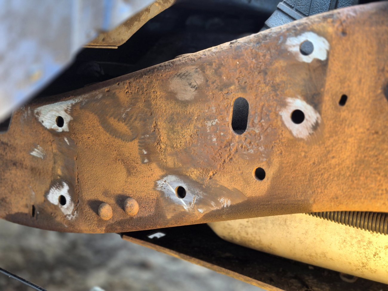

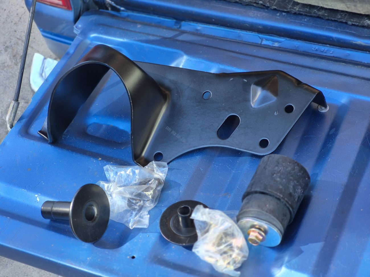

The damn 2.9 valve cover oil leak demon is still alive and well. I"ll have to tear her down the bastard again and re try. With that, the perch arrived, so I have the upcoming joy of grinding factory rivots, Yay me.

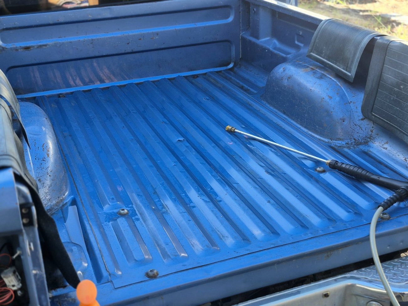

Prepping for the Truck Cab Mount, is it wierd I am looking forward to pressure washing this gunk?

I should've invested in an air chisel, but oh well.

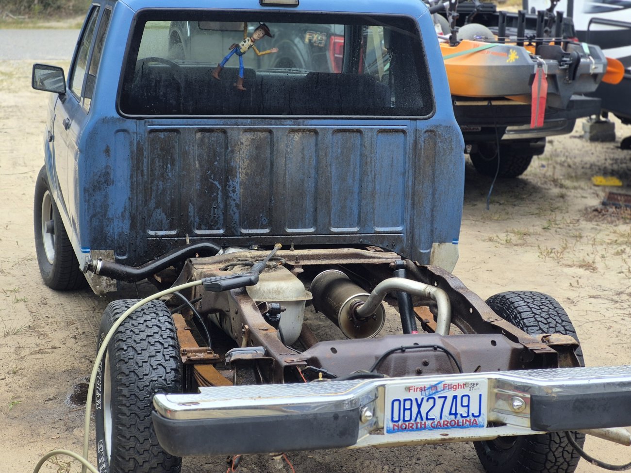

Got her replaced. Not dropping the fuel tank proved to be where all the time was consumed; trying to get the hardware into the frame rail for the front portion of the rear cab mount.
