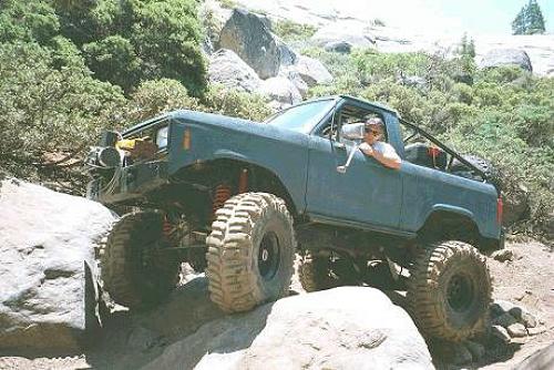

Shawn Heywood first built this Ford Bronco II to be a serious off-roader swapping in a Ford Explorer 4.0L V6 and Dana 35 TTB, but eventually swapped to a Dana 44 front and 9-inch rear axle with 5.13 gears, Detroit Locker in the front, spool in the rear, and 39-inch bias ply Super Swamper IROKs

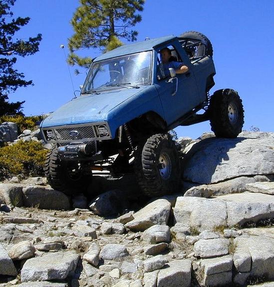

    • Although this is a 4-inch suspension lift, if you want massive articulation you need to use 6″ lift springs. The trick is to make custom rear shackle mounts and flip the shackle, so the spring is on the top of the shackle, this allows about 5″ more drop when there is no weight on the wheel, and it is at full droop. I found that Skyjacker Softride are the most articulation friendly springs you can get w/o going custom. Since the shackle is flipped you end up with a 4-inch lift. This setup has nearly 20″ of articulation. The spring beds are welded at a desired angle to the transfer case so the shims/wedges on the springs are eliminated and provide a more solid setup. Four shock mounts were welded onto the trussed part of the rearend, and the other end of the shocks connect to a custom-built shock mount that fits between the frame and the cab, near the front of the rear wheels. A 2″ body lift was needed for this custom shock mount, but it is the only way to get such long shocks under the vehicle w/o going through the body. All rearend bushings were replaced with urethane and oversized U-bolts hold the rear end onto the springs. As with the front end, many more minor mods were needed to make this all work.

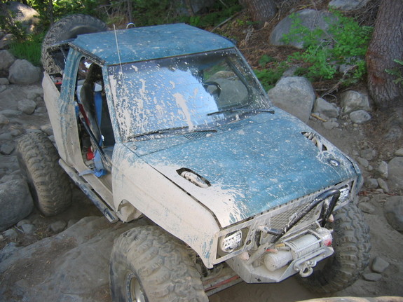

    • The entire bronco is painted with Durabak Bedliner, it has a very rough texture and is nearly impossible to scratch. it is up to a 1/4″ thick in more vulnerable areas.
  • Body:
    • The body has a 2-inch lift that enable for the larger tires, custom rear shock mounts, and also allows the 4.0 to fit under the hood better.
    • The fenders have a lot of trimming, especially in the front. The sides are protected with 2″ x 3/16″ strip of steel between the front and rear wheels; this protects me from the occasional side rock.

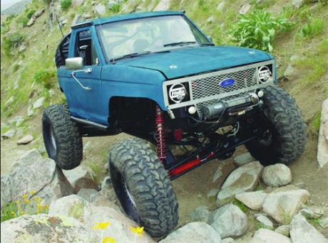

The 4.0L now uses a Ford Racing Performance Parts chip. The fuel is supplied from a Summit Racing aluminum fuel cell. A B&M shift kit firms up a C4 automatic transmission and a 5:1 Advance Adapters Atlas II transfer case was recently added for strength and gear reduction.
The axles were swapped out for a Dana 44 front and 9-Inch rear from a 1970’s F-150. The front axle uses Warn chromoly axle shafts, Longfield u-joints, 5.13 gears, and a Detroit locker. The rear axle is a 31-spline, big bearing unit with a heavily trussed housing, disc brakes from a Lincoln Versailles, and a nodular third member filled with 5.13 gears and a spool.

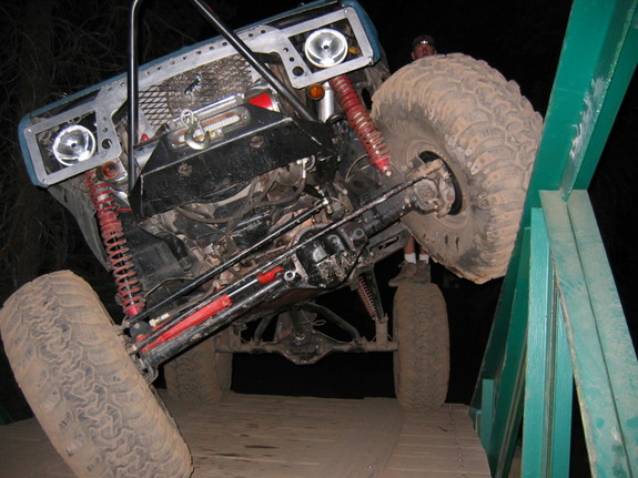

The front is sprung via 16-inch travel Sway-a-Way coilovers and Eibach 200 pound over 250-pound springs along with a tender spring. The axle is located by way of a three-link setup. The rear suspension currently uses Rubicon Express coils with a triangulated four link that also incorporates a panhard bar. Heywood is still dialing in the suspension for the best combination of flex and stability. All the links were made from .375 wall 2-inch DOM tubing and incorporate a combination of Heim joints and polyurethane bushings. The new suspension pushes the wheelbase out to 101-inch and provides room for 39-inch bias ply Super Swamper IROKs mounted on 15×10 Champion beadlock wheels. Hydraulic assist steering turns the big meats using a stock box, a Saginaw pump, and an industrial Chief ram.
The front fenders and hood were narrowed and a custom grille fabricated from aluminum to fill the void. In the rear, the top was cut behind the B-pillar and a custom cage was designed to take its place.
