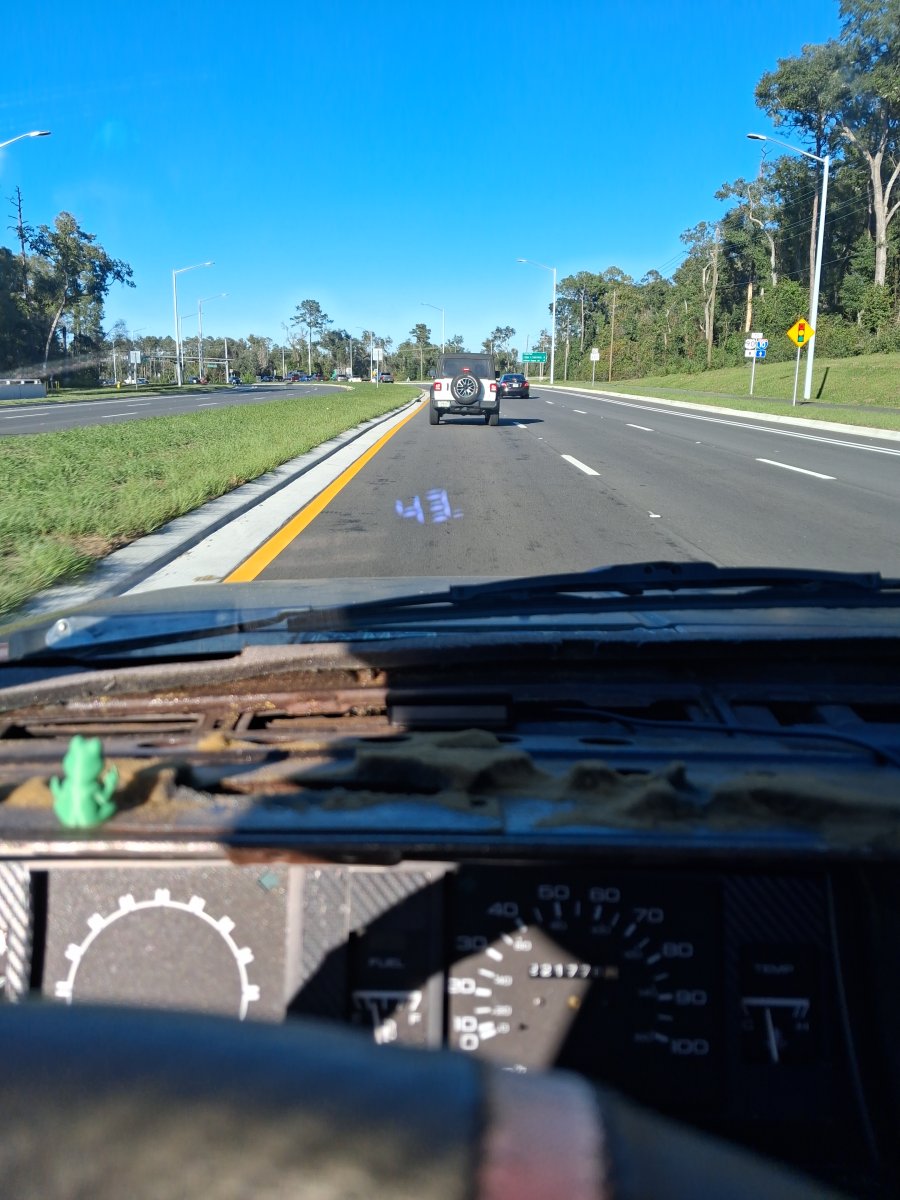

I got one of these. It plugs into a USB and projects on the windshield HUD style. I use it in my Nissan because the speedo needle has fallen off too many times to count. It's dead on accurate with my phones GPS, as far as MPH goes. It's real simple to use. Plug it in and go. It does take longer to "connect" sometimes, but we're talking 10 seconds, not minutes or anything.
