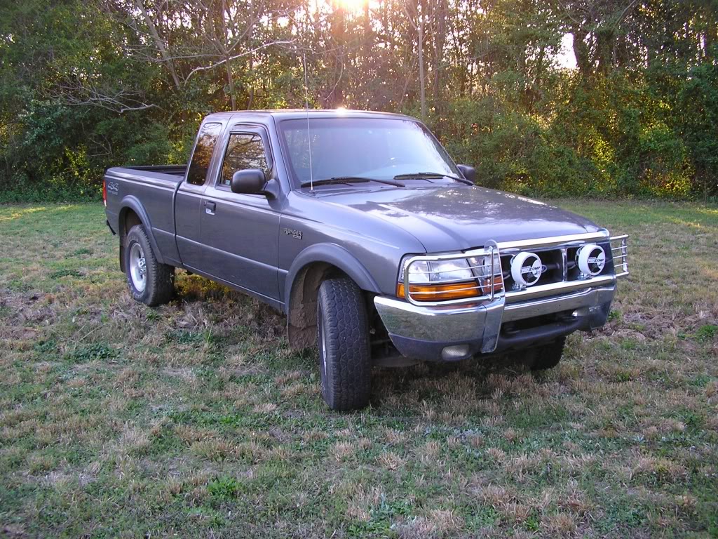

Not long after purchase. At this point I'd only installed the brush guard, lights, vent visors, and new tires.

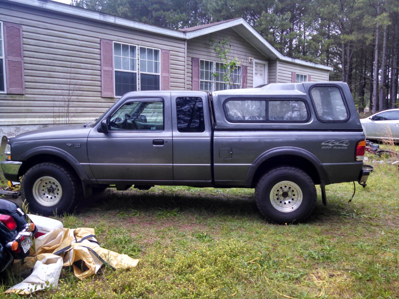

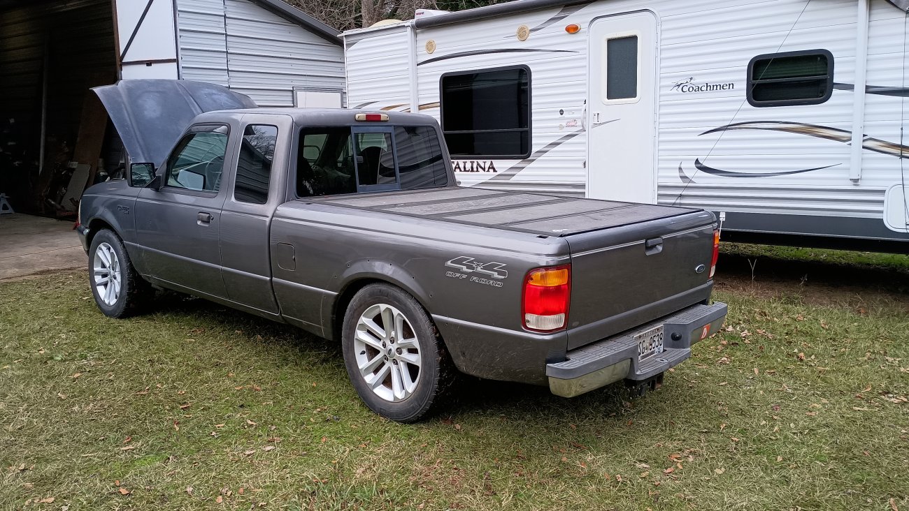

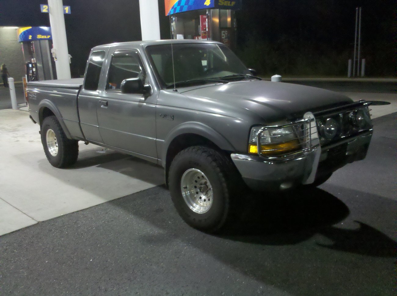

Several years later with a torsion twist, 32x10.5 on 15x8 wheels. I'd acquired a second hand Undercover Tonneau, nice cover, but didn't like having to remove to use the bed. Then with a high rise truck cap that I tried for a little while, still have it out back and might give it another go if I devise an easy on/off system.

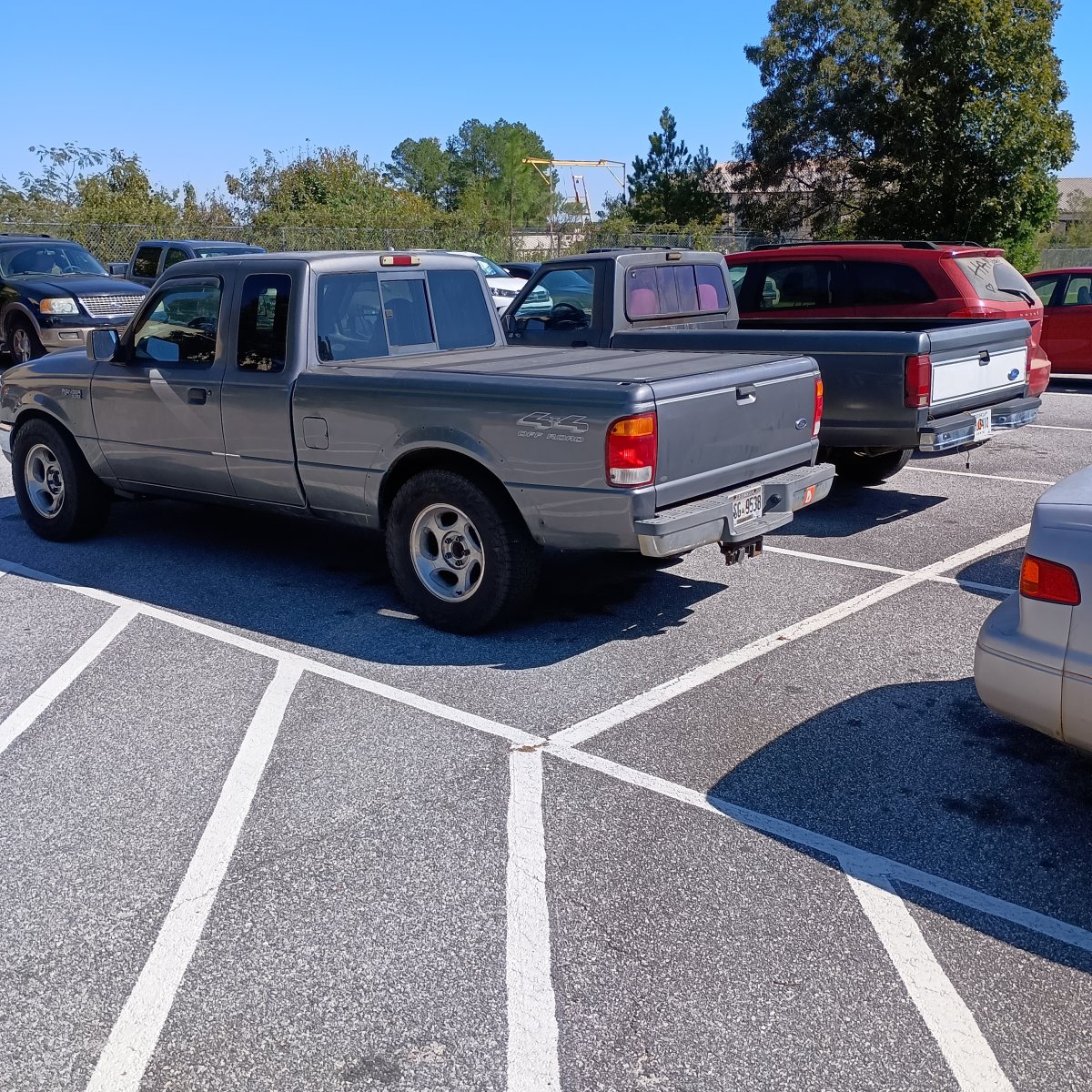

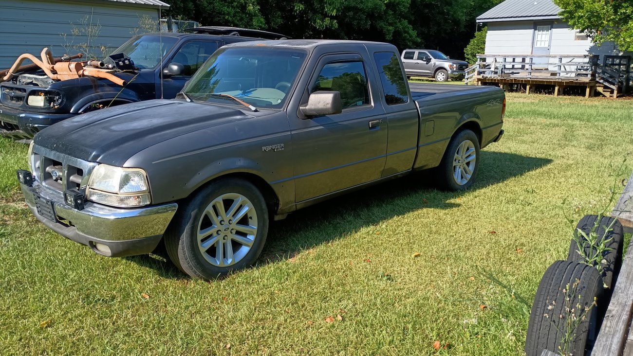

During the V8 AWD swap and lowering. Set of 18" explorer wheels and as low as it could go and still be drivable in front, but really needed longer upper control arms that weren't available. First picture rear is flipped spring under with extended shackles and maybe Explorer springs. IIRC yes, the axle is further back than it should be, that was intentional at the time. Second picture it may be back at stock 2wd height. The front would actually go lower, but the camber was so bad that I couldn't keep it like that. Needed a set of longer control arms to help with camber and extreme balljoint angles, but no one was making them at the time.

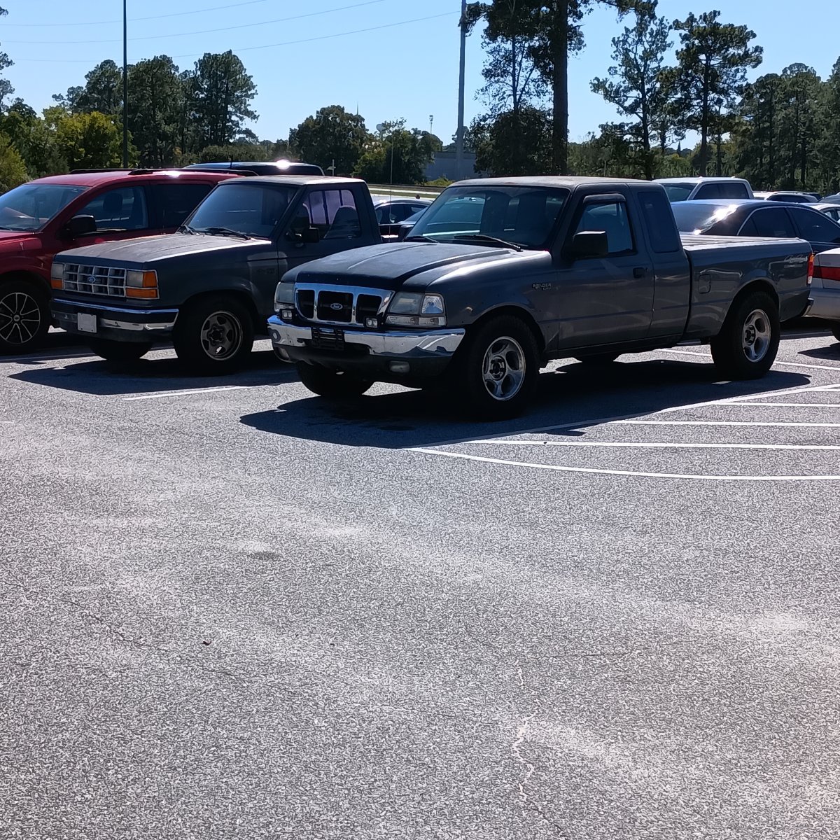

After that I actually raised it back up a bit in front, reinstalled the stock wheels and stockish size tires I was running prior to swap, and was going to run it like that until I could get someone to make me control arms to lower further. Shown here sitting next to a random stock 2wd second gen. Rick's Rangers eventually put the arms out late last year, but by that time the plan was pretty much set to go back up. Combination of being underwhelmed by the performance/handling and mom insisting that I get dad's F-150 Ecoboost which was quicker/faster, more efficient, and more comfortable.
