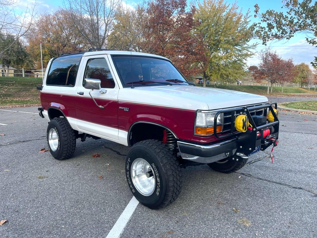

Suspension Lift
A common upgrade is to add a suspension lift to make room for larger tires.
  • 1.5-Inch Lift & Fender Trimming = 31-Inch Tires
  • 4-Inch Lift = 31-Inch Tires
  • 4-Inch Lift and Cutout Fenders / Fender Flares = 33-Inch Tires
  • 6-Inch Lift = 33-Inch Tires
