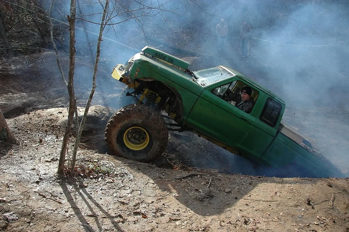

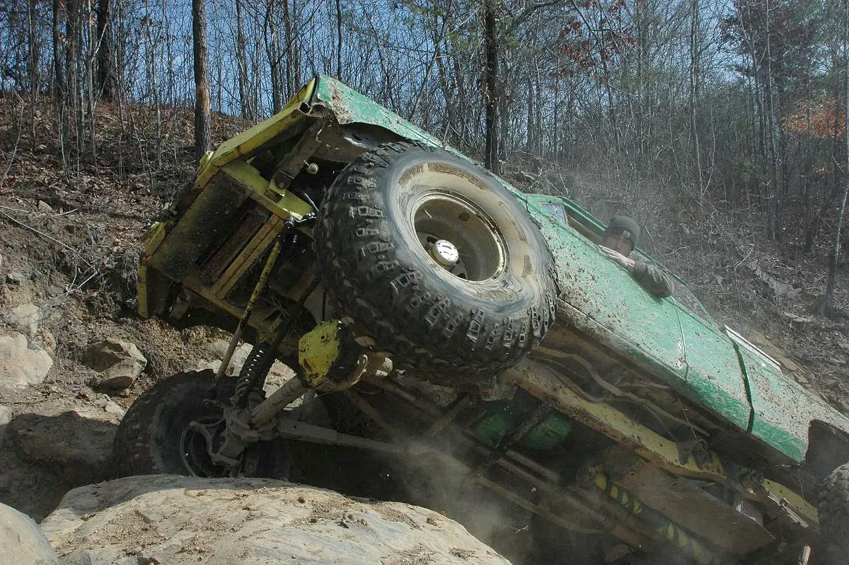

Byron’s Ranger wasn’t just painted to attract attention.
Underneath the unmistakable John Deere-inspired appearance was a seriously built four-wheel-drive truck.
The original Ranger had been transformed with a fuel-injected 1990 Ford 5.0L High Output V8 backed by a ZF five-speed manual transmission.
Power was sent through an impressive dual-transfer-case setup consisting of an NP203 doubler and NP205 transfer case. The NP203 was mounted directly to the ZF transmission, with an adapter connecting the NP203 to the NP205.
The drivetrain provided the kind of low gearing needed for serious off-road use.
Up front, the Ranger used a high-pinion Dana 60 with 5.38 gears, welded differential, 35-spline stub shafts, and Mile Marker hubs.
The rear axle was a Ford Sterling 10.25-inch, also equipped with 5.38 gears and a Detroit Locker.
The truck rode on 42-inch Interco IROK tires mounted on 15×10 steel wheels.
Suspension modifications included 5.5-inch Early Bronco coils and wristed radius arms in the front, while the rear used a custom combination of Explorer and Ranger leaf springs, longer shackles, and the factory lift block.
