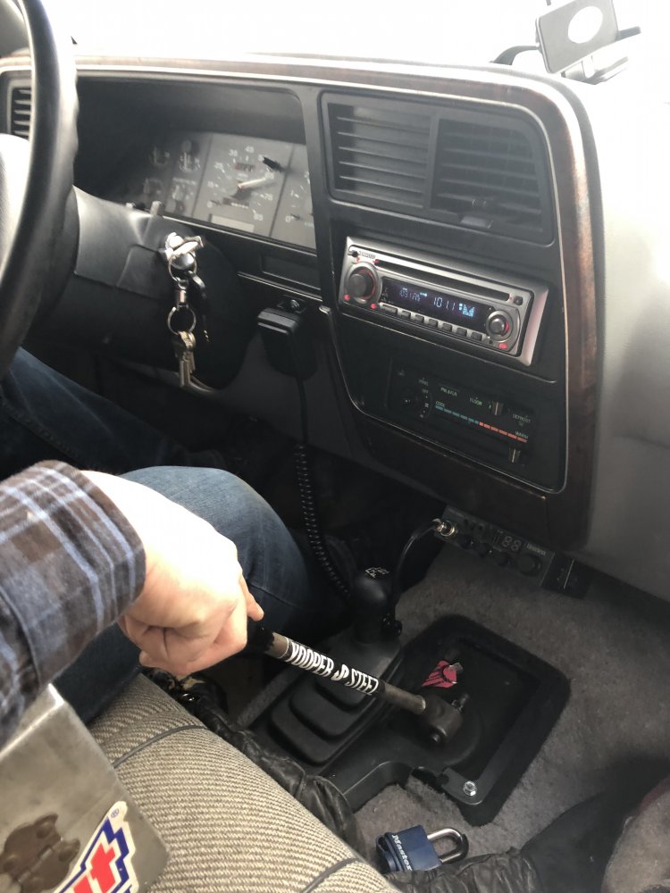

1994? Limited Slip carrier with Mustang Track Lock Clutch Discs
Mustang Vented diff cover
Perfection Heavy Duty Kevlar clutch
Aluminum Master and Slave Cylinder
Core Shifter (Hurst Clone)
