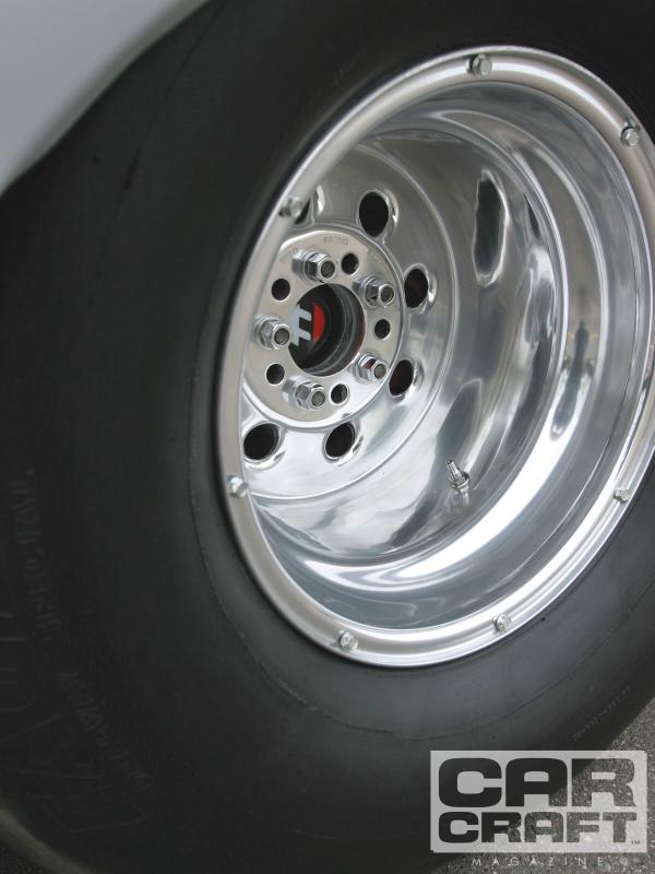

Wheels/Tires: 15×15 and 15×4 Weld Drag Lites with 165R15 tires, and 33×16-15 Goodyears.
