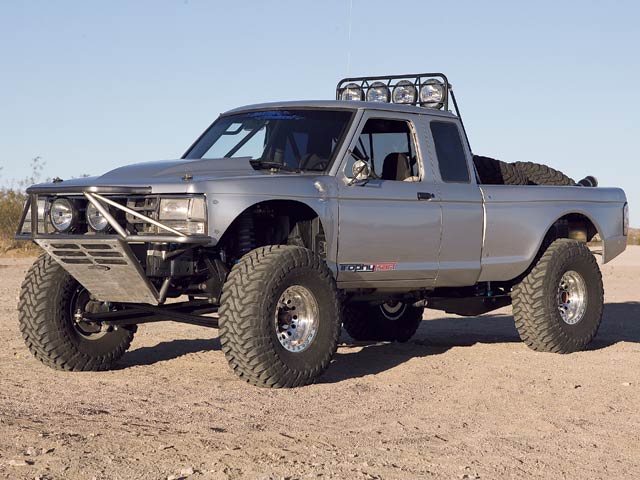

Tom Ledsinger began racing in 1986. Growing up, he gained his experience working for several race teams, learning skills that would benefit his fabrication and metalworking knowledge. Also having worked for Team Saleen in the pro SCCA circuit, he has prepped a world-record-holding drag-race car and both prepped and codrove a 7 Open Ford Ranger in the SCORE and Best In The Desert series. Recently, he has opened a race shop with his best friend Jeff Haugh, performing fabrication and prep services to racers and enthusiasts.
Silver Ford Ranger PreRunner

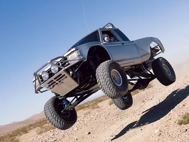

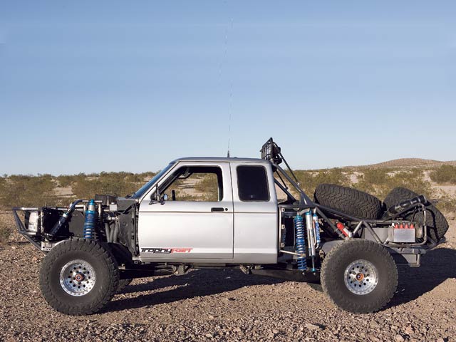

He started the build on his truck with the intent of making a fast, reliable prerunner and chase vehicle. The build started with an ’86 Ford Ranger extra-cab truck that would eventually be stripped of everything but the cab section. Robert built every piece of this truck himself aside from the suspension components. In this case, he called on Nestor at Newline Products to order up a set of his front equal-length I-beams with crossover steering replacement.

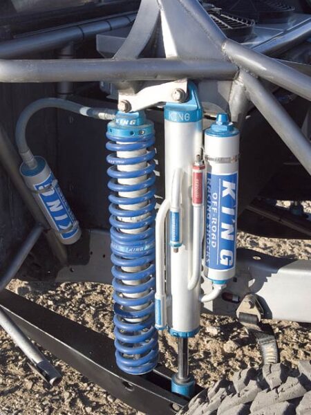

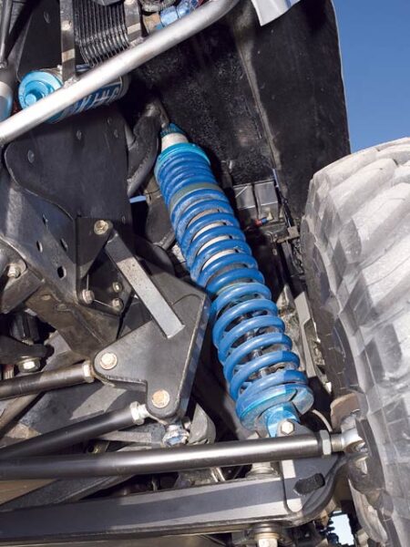

The front end uses massive 3×14-inch King coilover shocks and Fox hydraulic bumpstops that together allow the front end to achieve 19 inches of travel. Also found up front is a set of Cone Industries 1-ton hubs, a Lee power-steering pump, and a Lee hydraulic ram.

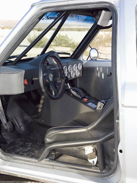

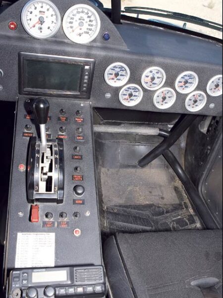

Robert custom-made an aluminum dash and then wrapped it in black leather. An entire picnic of Nordskog gauges is found littering the dash, as well as a Lowrance GlobalMap GPS unit and Kenwood 110W race radio with remote-mounted faceplate. Both seats are made by MasterCraft and use Crow five-point race harnesses. Above the cabin and in front of the truck are six Hella HID off-road race lights.
Prerunner Ranger dash
Robert did all of the wiring himself, and he even wired up a rearview camera with monitor display in the center of the dash to see who may be following a bit too closely.

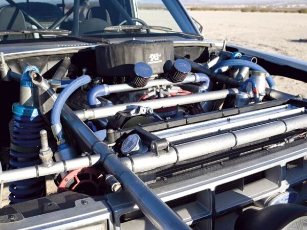

The transmission is a C6 built by Craig’s High-Performance Shop that uses a full manual valve body with a reverse shift pattern. The torque converter used is a model A1 Automatic that was custom-built for lockup over 3,500 rpm with special experimental internals that Robert told us were his little secret. Robert truly spared no expense with this build. He knew that not only did he need his truck to perform flawlessly, but it needed to be extremely reliable when traveling to the tip of Baja and back. Under the hood, he stuffed a 427ci small-block Ford engine that was also built by Craig’s High-Performance Shop. This isn’t just a small-block – it was built to push over 575 hp at 6,800 rpm and 575 lb-ft of torque while still being able to use regular pump gas. Other components that made this possible include a Dart cast-iron block; Trick Flow R-Series heads; an Eagle stroker crank; Eagle H-beam rods; COMP Cams custom-grinded to Craig’s specs; JE custom-forged pistons; an Edelbrock intake system; a Carb Shop off-road 950 double-pumper carburetor; custom-made, equal-length “stepped” headers built by Robert himself; and dual 3-inch Borla XR-1 race mufflers.

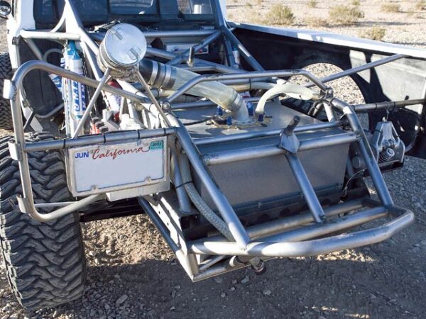

As you can imagine, that much power pushes a lot of gas; to keep enough in the tank to run Baja, a Fuel Safe 44-gallon fuel cell was installed with dual 140-gallon-per-hour fuel pumps located just behind the cab. Basically, Robert’s truck sounds like a Trophy Truck coming at you when he mashes his right foot.

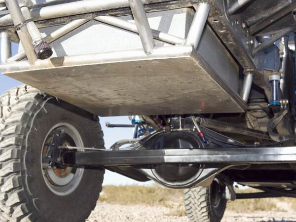

A Cone Industries full-floating 9-inch rearend complements the high-quality Cone components used up front. The Cone 9-inch boasts the strength of 40-spline Moser axles, disc brakes, and Cone Industries’ own full-floating hubs. The 9-inch’s nodular-iron third member is stuffed with a 4.86 ring-and-pinion set that surrounds a no-nonsense full spool.

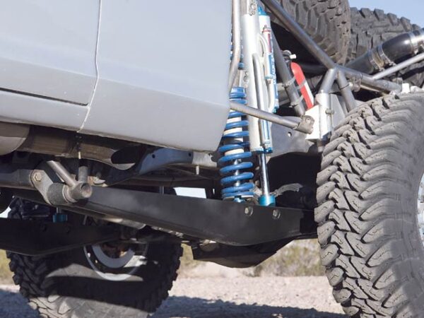

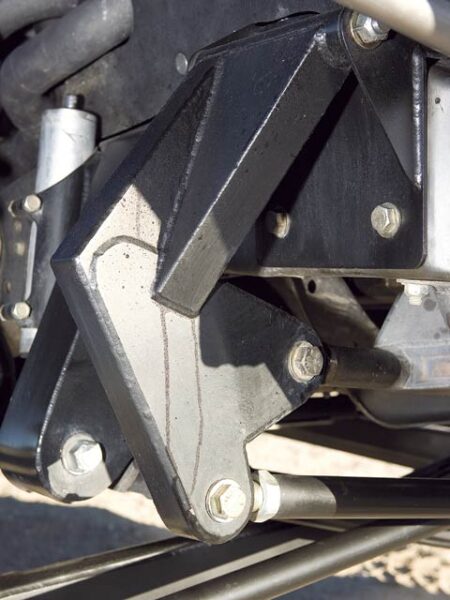

To go with the front-end suspension, Robert installed the Newline Products bolt-on four-Link suspension kit that uses 2.5×14-inch King coilovers, 3×14-inch King bypass shocks, and Fox hydraulic bumpstops. In its present configuration that includes an unmodified factory frame, rear suspension travel measures 22 inches. More rear travel can be had by either notching or “kicking” the framerails to clear the way for more compression travel.
