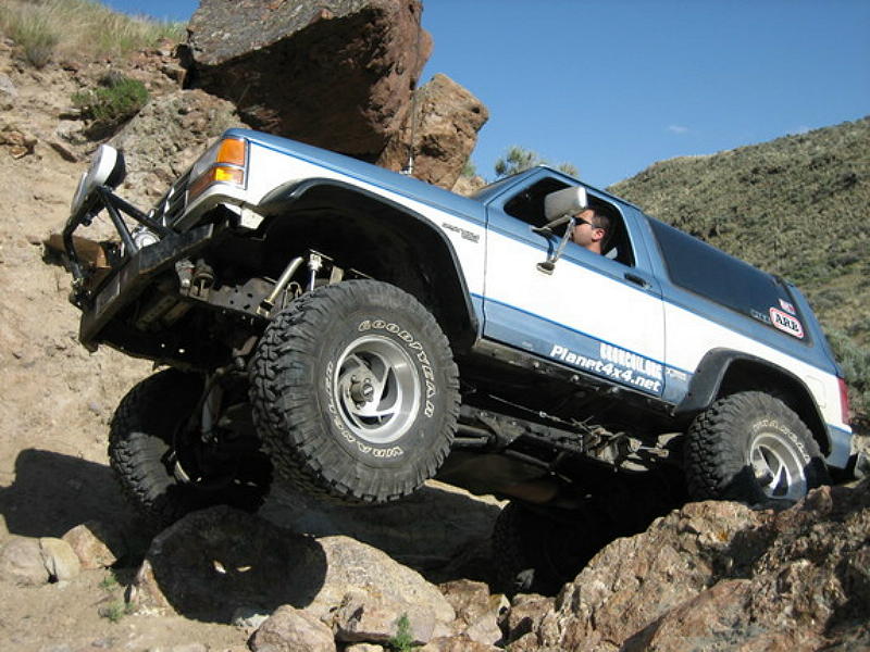

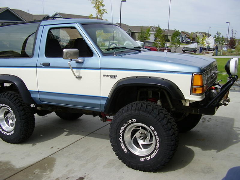

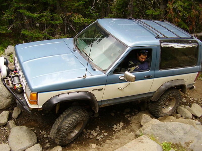

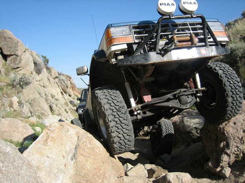

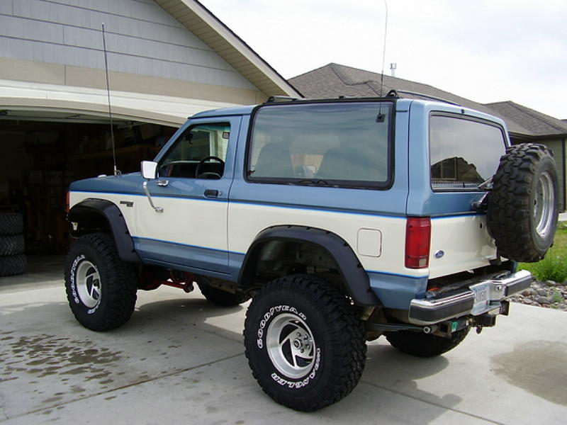

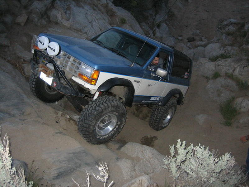

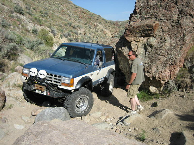

This Bronco II has been online for quite some time and is owned by internet user B2swiss. After rolling a previous Bronco II in Moab, he decided to build another one. This 1989 Bronco II XLT 4X4 features the stock 2.9L V6, and a 5-speed manual transmission.

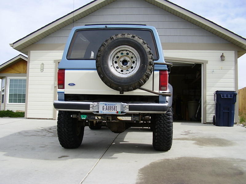

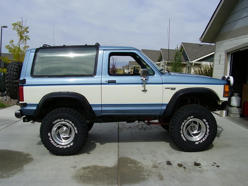

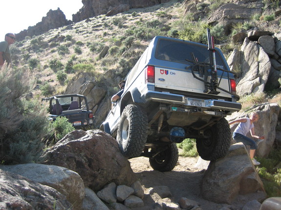

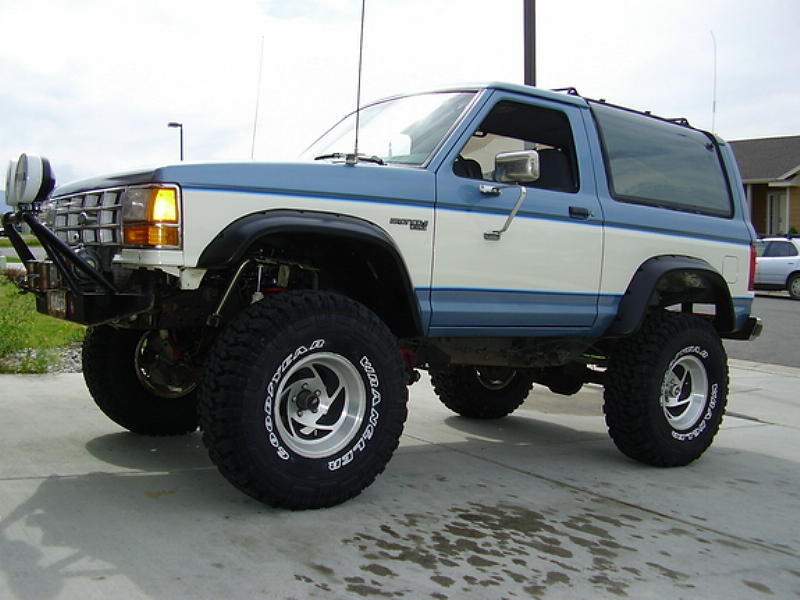

It uses a combination of 3-1/2 inch lift coils and a 2-inch spacer for the front lift, and Ford Explorer rear springs with GM lowering shackles for the rear lift. GM lowering shackles will actually lift the rear of a Bronco II 1-1/2 to 2-inches. The Ford Explorer leaf springs are also used for another 1-1/2 inches of lift. A 3-inch body lift and fender flares gives it the extra room needed to clear the 35×12.5×15 Wrangler MT/R’s.

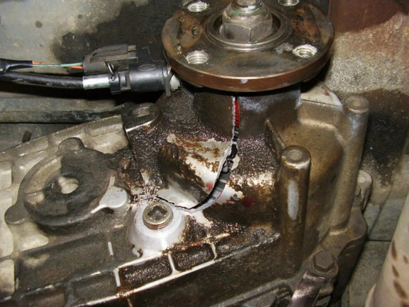

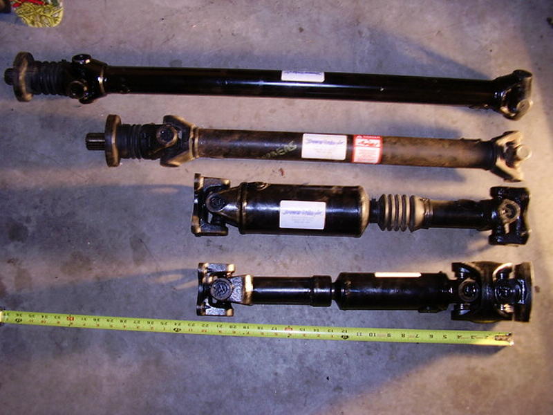

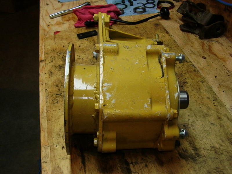

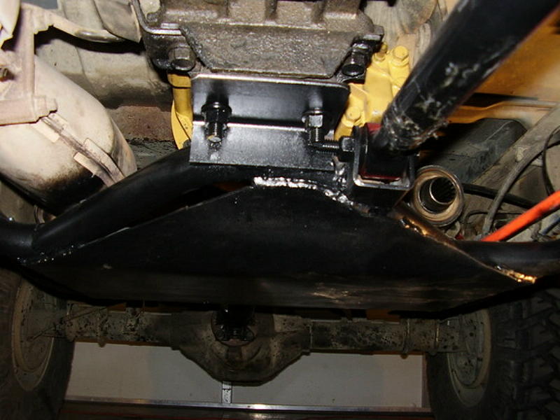

After breaking the transfer case….

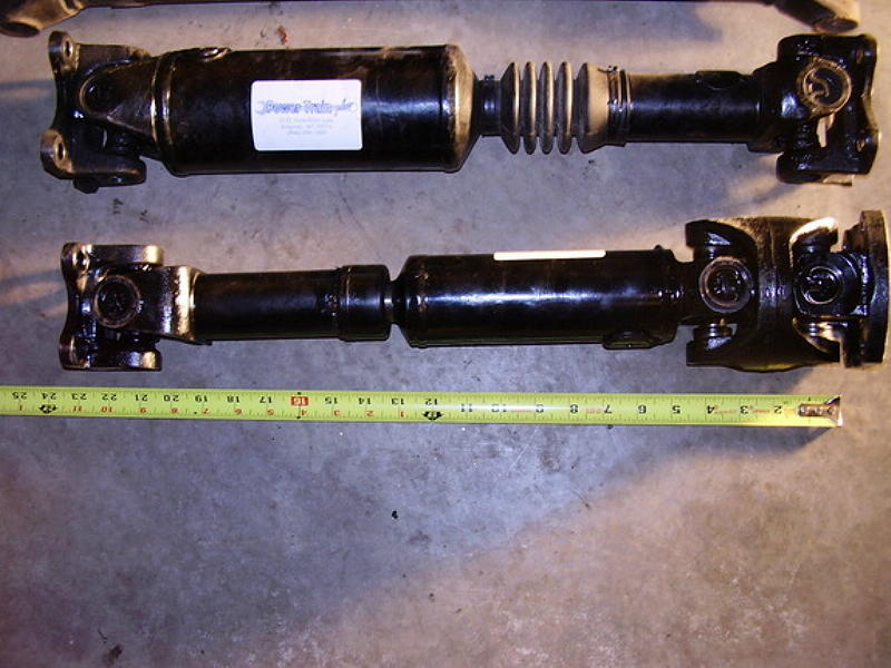

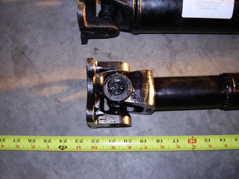

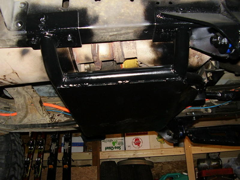

The Bronco II was upgraded with a replacement transfer case, and a custom T&M BW1350 Doubler. The 5.13 gears and 5-speed manual transmission results in a 120:1 crawl ratio.
The axles have been upgraded as well. The Dana 28 front axle, and Ford 7.5-inch rear axle, were swapped out in favor of a Dana 35 front axle, and Ford 8.8-inch rear axle. Both are equipped with 5.13 gears and an ARB air locker.

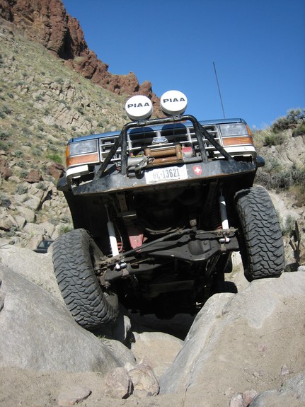

Other upgrades include James Duff shock hoops, a Ford Explorer radiator, ARB compressor, 3.5-gallon air tank, and a custom front winch bumper. For ALL of the modifications, check out the list below:

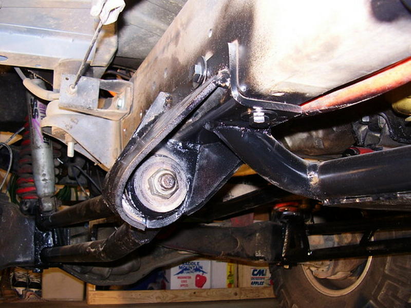

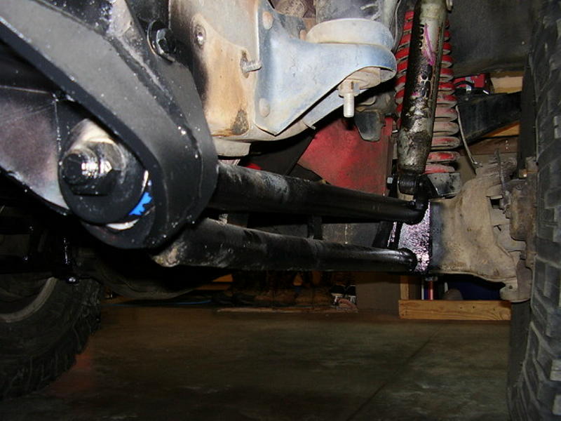

- Trail Master Radius arms for fullsize bronco, modified to fit application

- Custom Transfer Case and Doubler skid
