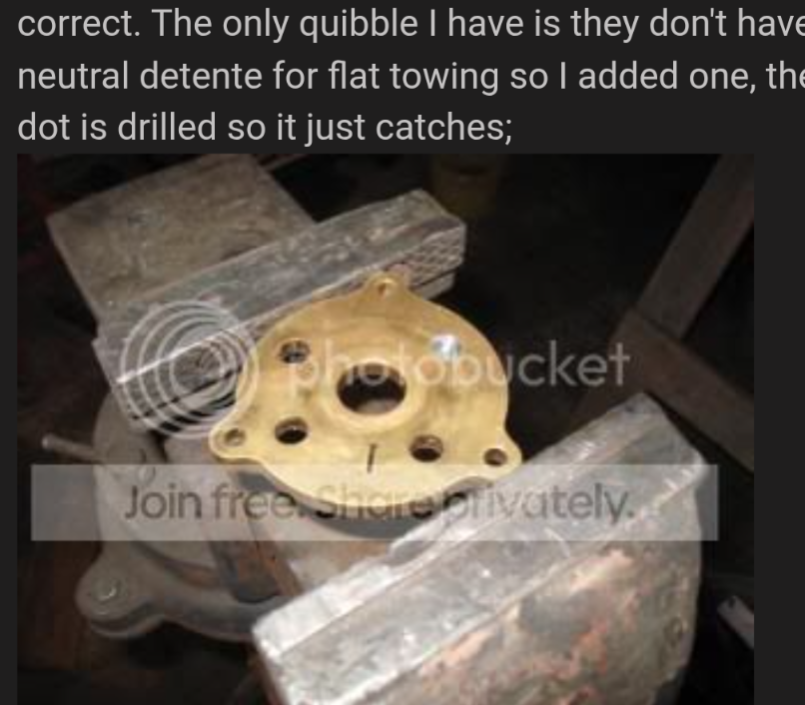

I have one with neutral indexed and drilled.

According to the person I bought it from... it was drilled and marked with Neu from shiftster when he bought it from them. But clearly it was a modified version of the three position unit.

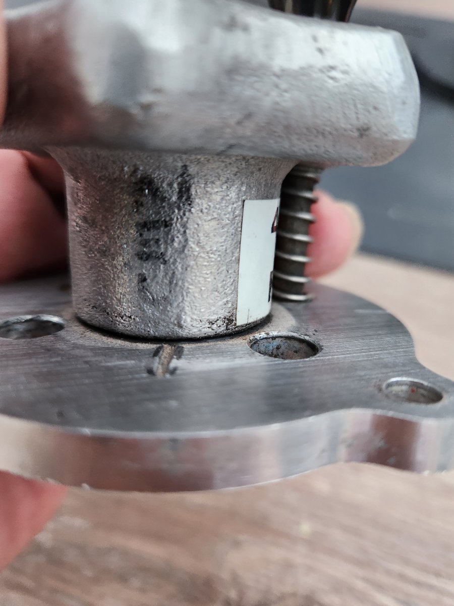

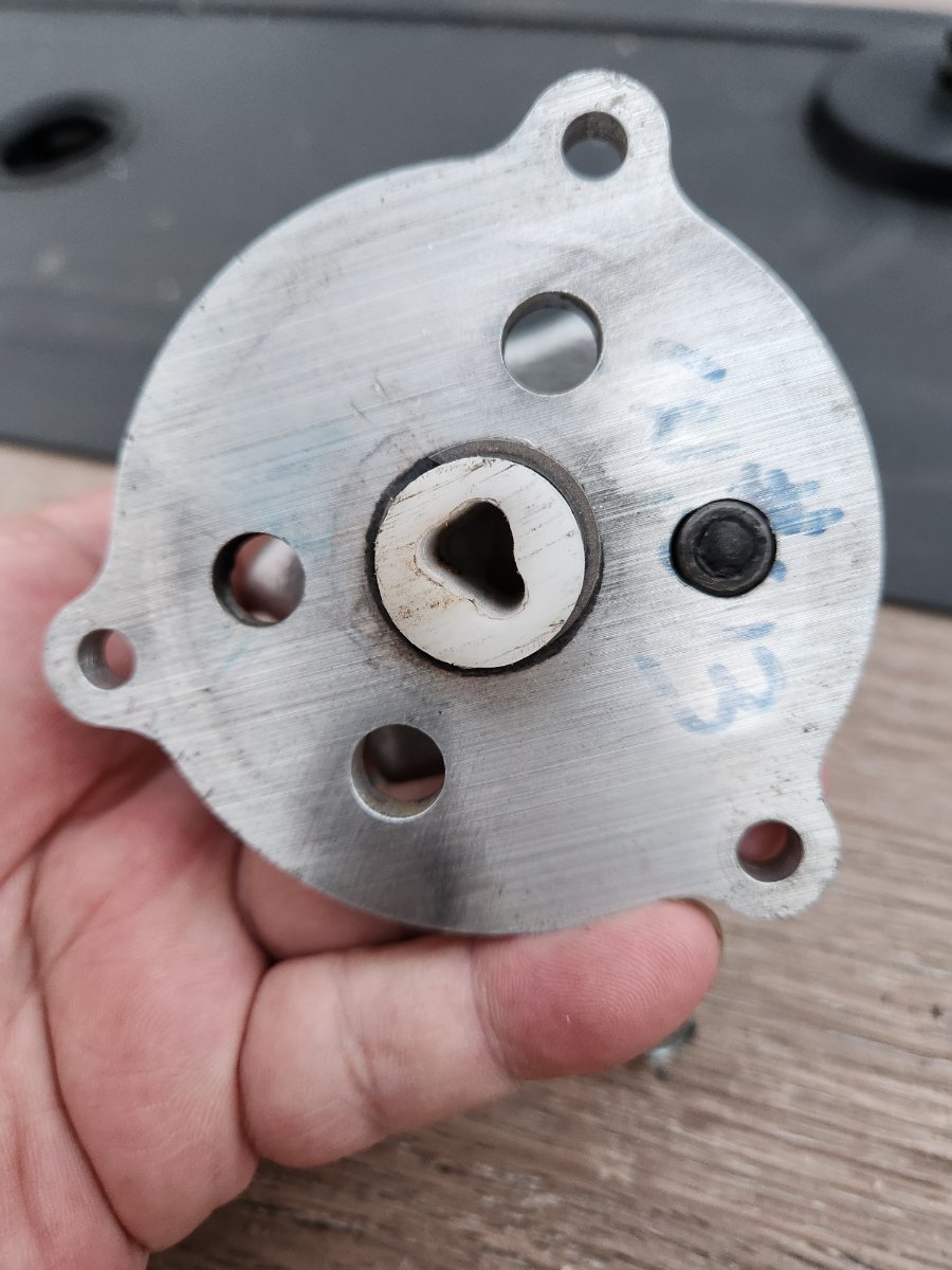

Interesting. A bit different than the one I have.
Slide my DMs. Would like to get a look at that one. 🙂

This is the only pic I could find of the neutral I put in mine. It's exactly 180° opposite of the hole on the other side. You can probably figure out which hole by looking at the orientation of the holes with each other.
