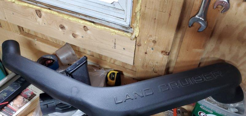

So, this after-market deal was made in God-knows-where by God-knows-who. Even so, I didn’t want to drop a ton of money on a snorkel for a Ford that wasn’t that great when it was brand new (…send the hate, go ahead…). Be careful what you order though, cause look what arrived:
Land Cruiser Snorkel
Yep, it says Land Cruiser on it. I personally don’t mind this and I think it’s kinda funny. I call it my poor man’s Land Cruiser. OK, a few things you need to know:

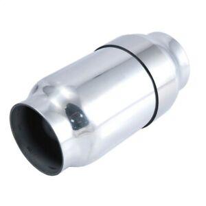

I hate crowded engine bays. Given this, I wanted to get rid of the massive airbox. I ended up going with a 4-inch Spectre in-line air filter which has a conical filter:
4-Inch Spectre In Line Air Filter
I am not sure how this thing is going to work out in the long run in real offroad situations. I will have to report back. For the rest of the plumbing, I used aluminum tubing and silicone couplers. Here is a pic of the engine bay mid-install:

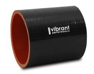

  • 3-inch snorkel inlet to silicone coupler #1 (Vibrant 2714)
  • Silicone coupler #1 to an angled piece of 3” aluminum intake tube (don’t remember the angle sorry – I think it is 30deg and I had to trim it down to the proper length)
  • Angled aluminum tube to Silicone coupler #2 (Vibrant 2714)
  • Silicone coupler #2 to in-line filter
  • Inline filter to 90-degree silicone coupler (Vibrant 2783) that goes from 3 inch to 2 ¾ inch at the intake manifold.
Vibrant 2714 Silicone Hose Coupler
They are not in the picture, but I used hose clamps at each junction. To get the first one on I had to remove the fender, it’s just easier, trust me.
