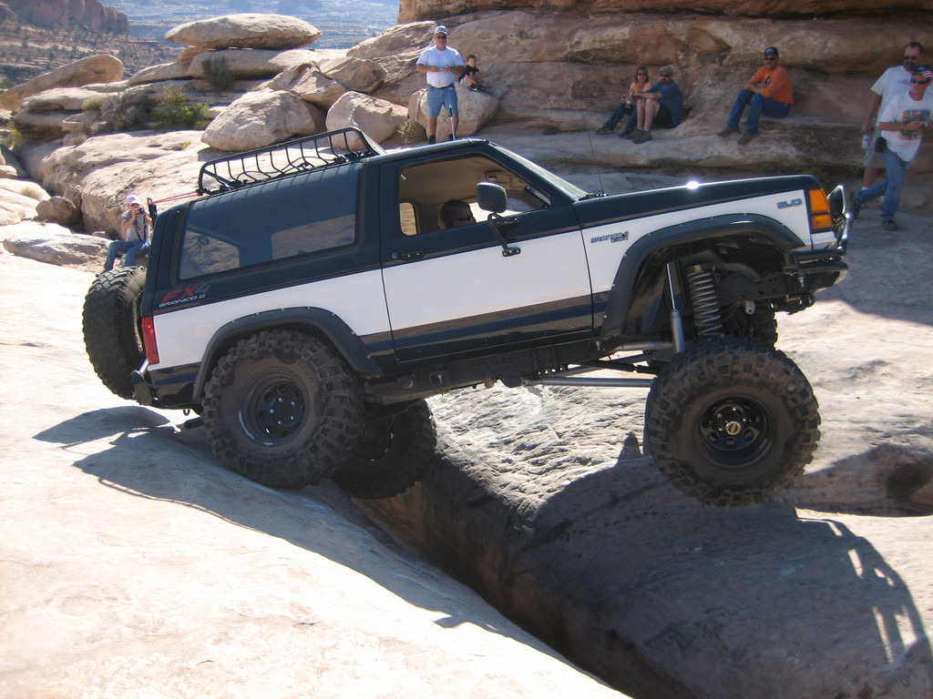

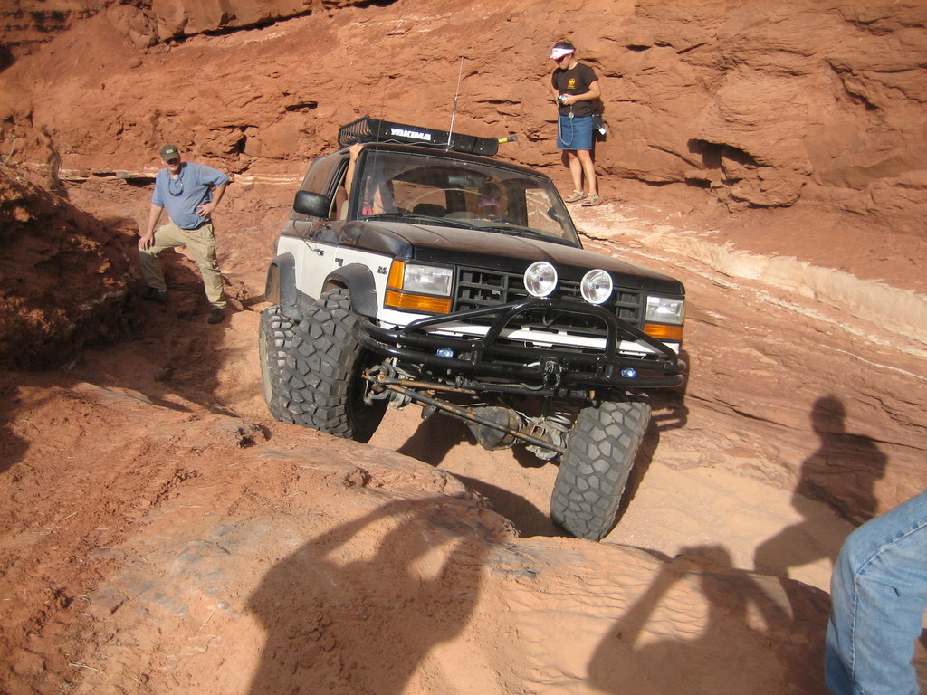

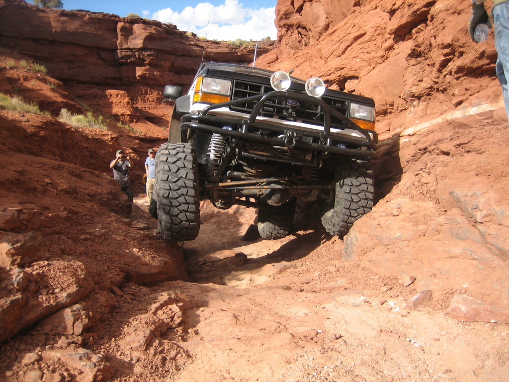

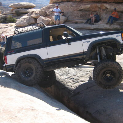

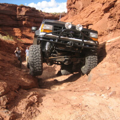

This 1989 Ford Bronco II owned by Josh (AKA MoabB2) from Sandy, Utah has always been one of my favorite Ford Bronco II builds. It’s definitely a nice clean well thought out build that functions as well as it looks.
Here’s an overview

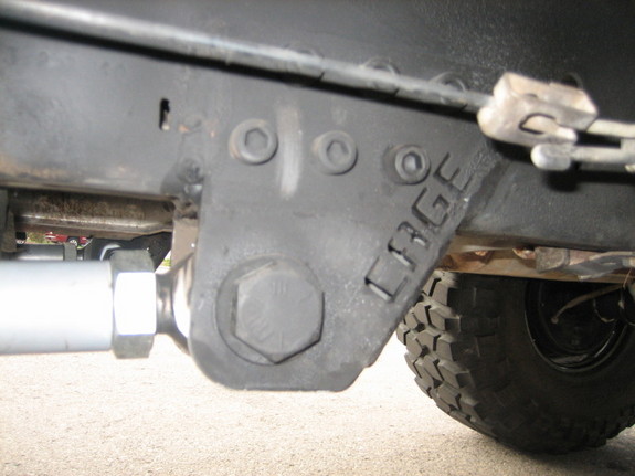

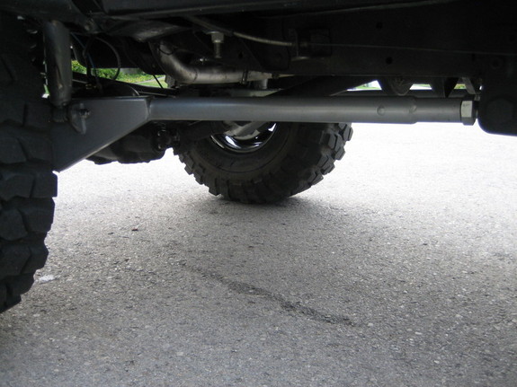

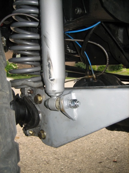

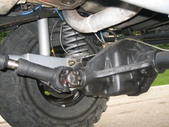

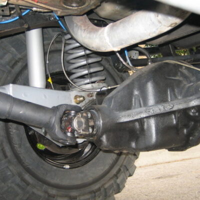

  • Eary Bronco Disc brake Dana 44 front axle installed, TRO steering, Yukon 4340 Chromoly axles, Yukon Superjoints, Yukon 4.88, ARB, Cage heavy duty track bar.

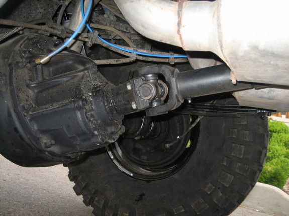

  • Early Bronco Big Bearing 9-inch rear axle installed, Yukon 31 Spline Forged axles, Yukon 4.88 R&P, ARB, Drums.
  • Manual BW1354 transfer case installed, replaced stock BW1350 for more travel in front yoke.
  • Wheelbase stretched 1.5-inches in front.

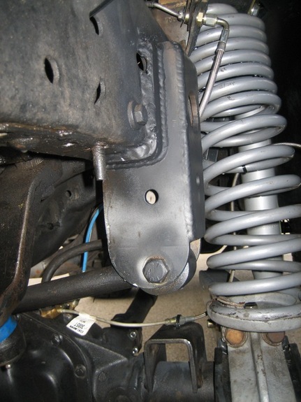

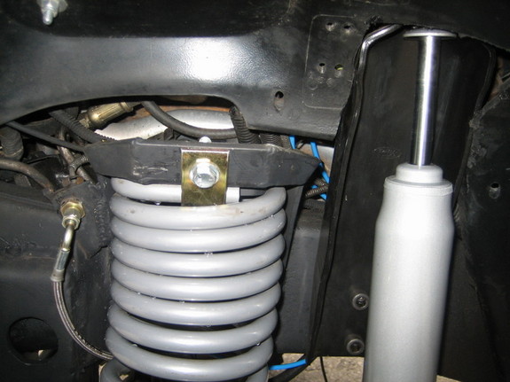

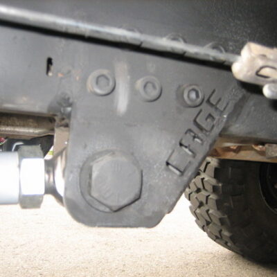

  • Front suspension: Cage Early Bronco 3.5-inch coils, Cage Tubular Radius Arms, Duff zinc plated coil towers, Cage nitrogen shocks.

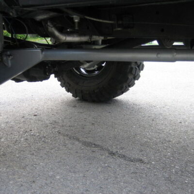

  • Rear suspension: Skyjacker 6-inch rear leaf springs, Cage nitrogen shocks, custom traction bars.
  • Wheels and tires: 35×13.50×15 BFG Krawlers mounted on 15×10 Cragar Series 397 wheels.
  • Custom brake lines and drivelines are being made right now. ARB compressor mounted and custom ARB dash switches underway.

BW1354 Transfer Case, 34.4:1 Crawl Ratio
Early Bronco Dana 44 Front Axle with Disc Brakes, Chromoly Shafts, 4.88 Gears, Superjoints, ARB Air Locker Warn Hubs, and Cage Offroad Trac-Bar Mount
Early Bronco big bearing Ford 9-Inch Rear Axle with Drum Brakes, Yukon 31-Spline Shafts, 4.88 Gears and ARB Air Locker

3.5-Inch Cage Offroad Early Bronco front coil springs
Cage Offroad Early Bronco extended radius arms & mounts
(4) Cage Offroad shocks
James Duff Zinc Plated Coil Buckets
Cage Offroad Shock Mounts
Skyjacker Bronco II 4-Inch Leaf Springs

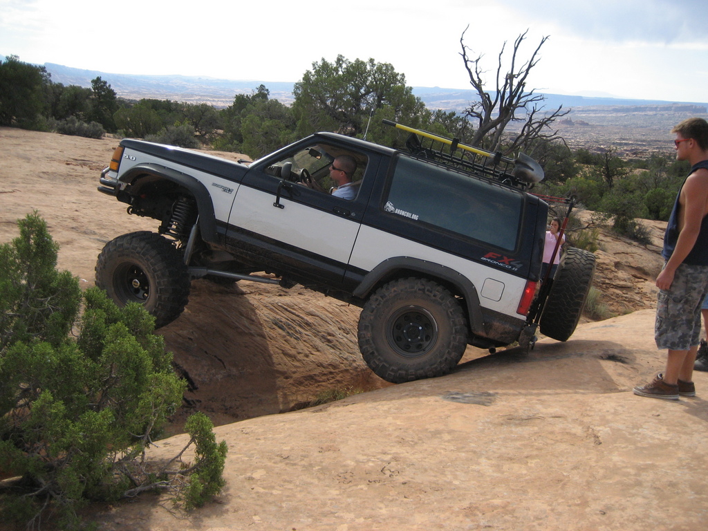

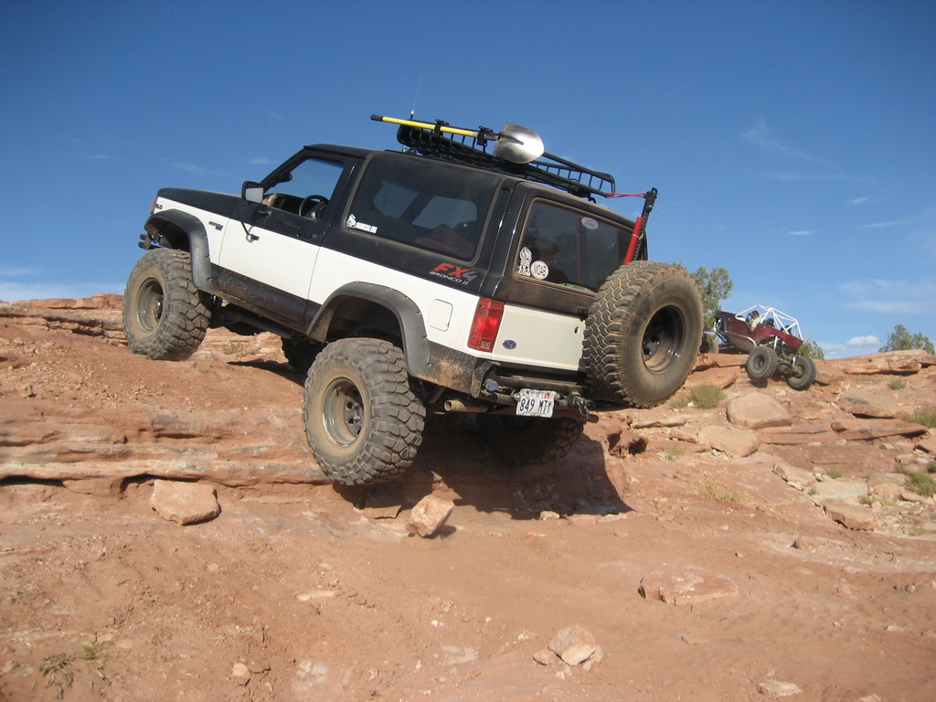

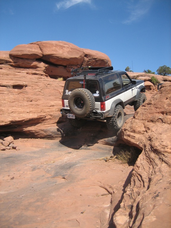

Rock crawling a Ford Bronco II in Moab Utah
