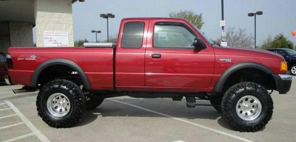

1998-2011 Ford Ranger: Starting in 1998, the Ford Ranger used a Short arm / Long Arm (SLA) front axle setup instead of the original Twin Traction Beam (TTB). The 1998-2000 Ford Ranger used a Pulse Vacuum Hub (PVH) front locking hub. These have proven to be problematic. While some people try to avoid these Rangers, they actually have two benefits:
  1. You can upgrade to manual locking hubs. For more on that, click HERE.
  2. If you install a front locker, you can unlock the front axles so they’re not turning when you’re on the street.
In 2001, Ford switched to a live axle setup which means that the front axle is turning all the time, and can’t be disconnected. The downfall to that is that you can’t run a true locker in the front axle, because there’s no way to disconnect the front axle shafts when you’re on pavement. Torsen makes a differential for these Rangers that is more like a limited slip. The only other option is a Lock-Right locker, but that would require you to have an open differential to install it in, and the 1998-2000 front axle setup with a manual hub swap.
(Ford Ranger FX4)
It’s important to note that Ford offered a FX4 model of the Ranger from 2002-2009. These trucks were specifically built with off-road in mind (I know because I personally discussed this truck with engineers when it was designed, and drove it before it was available to the public – more HERE) I would search for a 2002 FX4, or a 2003-2007 FX4 Level II model to ensure that you’re getting the 31-spline 8.8-inch rear axle, 4.10 gears and Torsen differential. For more information on the Ford Ranger FX4, click HERE.
Mild Build: Build a 2002 FX4, or a 2003-2007 FX4 Level II with a 3-inch body lift and 33-inch tires. Another option would be a 1998-2000 Ford Ranger with a 3-inch body lift, 33-inch tires, and a manual locking hub swap. I don’t really like cranking the torsion bars because you’ll lose downward wheel travel, but you could crank the front torsion bars, and add a 2-inch lift block to the rear, and easily run 33-inch tires (see my 2001 Ford Ranger below).
Moderate Build #1: Any 1998-20011 Ford Ranger 4×4 with a 3-inch body lift, mild torsion bar crank, 33-inch tires, and a rear locker. Install a Torsen differential in the front, or a Lock-Right locker if you have a 1998-2000 with a manual hub swap. Upgrade to 4.56 gears for 33-inch tires, or 4.88’s if you want to run 35-inch tires. Cut the fenders and add cut-out fender flares to make room for the 35-inch tires.
Moderate Build #2: Any 1998-20011 Ford Ranger 4×4 with a Rough Country 5-inch suspension lift, 33-inch tires, and a rear locker. Install a Torsen differential in the front, or a Lock-Right locker if you have a 1998-2000 with a manual hub swap. Either install a 3-inch body lift, or cut the fenders and add cut-out fender flares to make room for the 35-inch tires. Upgrade to 4.56 gears for the 33-inch tires, or 4.88’s if you want to run 35-inch tires.
Below is my 2001 Ford Ranger. It has a 3.0L automatic with an open 28-spline 8.8-inch rear axle and factory 4.10 gears. The previous owner cranked the torsion bars to lift the front, added a 2-inch lift block under the rear springs, and installed 265/75/16 (31-inch) tires. You can see from the photos that the truck could fit 33-inch (285/75/16) tires, but may require a little trimming of the front plastic valance behind the bumper to prevent rubbing. Since it has an open differential, I could easily add a Lock-Rite locker to the rear axle. If I added a set of cut out fender flares with 33-inch tires, this would make an inexpensive every day driver, and weekend trail truck.
For more examples of tire size and lift comparisons, click HERE.
