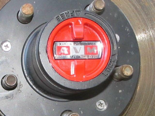

As I write this, so far I have put two good wheeling trips on these hubs (Oct. 2024, one trip on Swamp Lake trail, and one trip to Coyote Lake Trail, both quite-rugged trails in California’s Sierra Mtns.), along with multiple more-local trips, which so far has easily proven their strength is superior to the old #29071 Warn hubs.
I will be sure to submit updates here if any events happen, or if I receive reports of breakage from other users.
AVM hub installed
