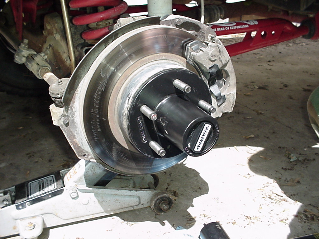

Look at your pretty new hub. Lightly grease the innards to prevent corrosion, but don’t fill the bottom. Too much grease in the cap will prevent it from locking.
finished!
Install the cap, and Voila! your done!
