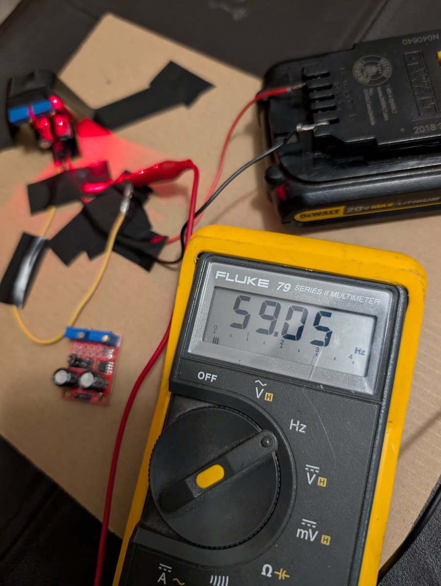

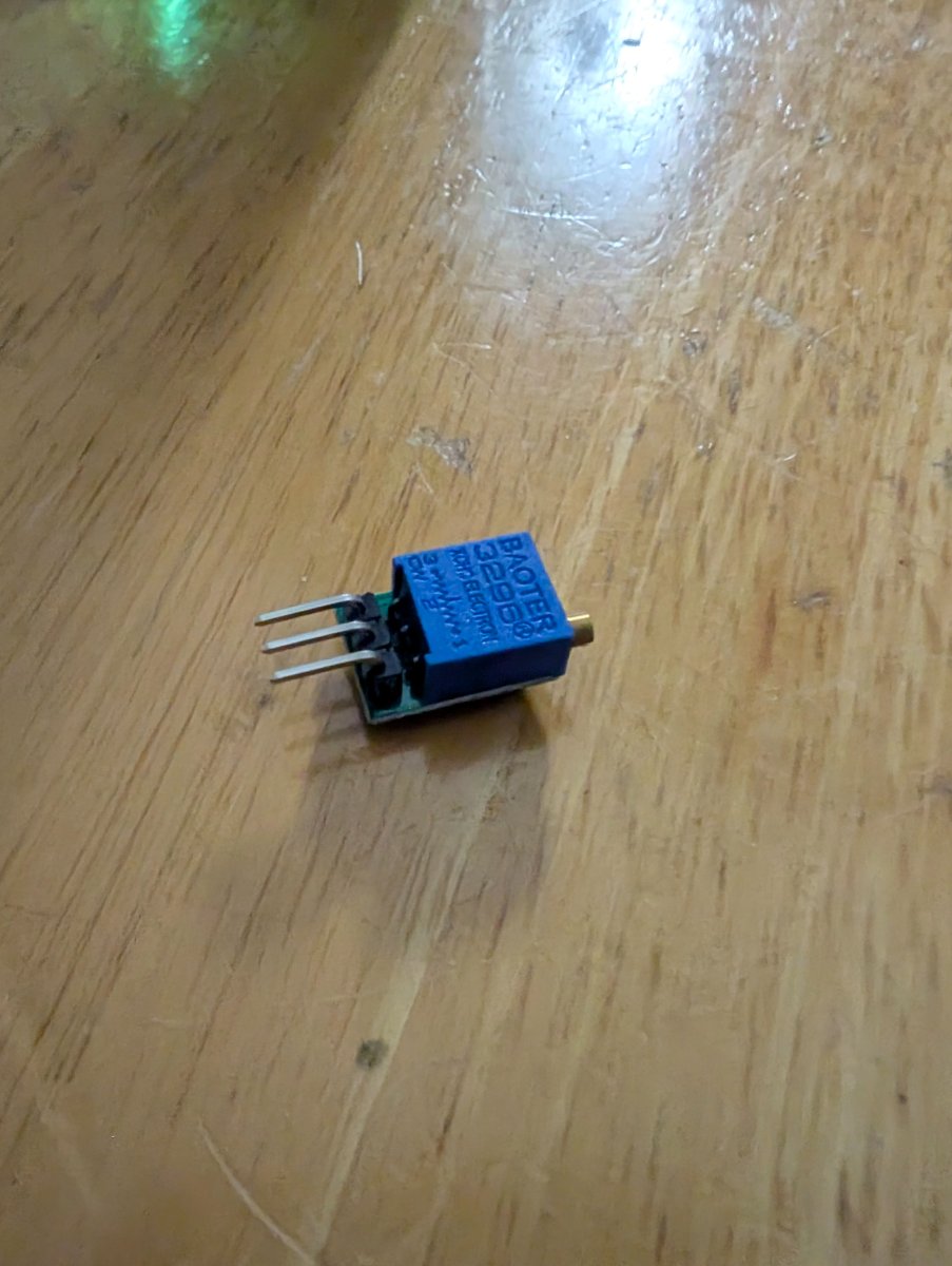

I know there's a $150 option on eBay for a plug and play frequency generator bypass. But I bought a couple styles off of Amazon to mess around with and have as an emergency backup if my sensor ever goes out.
My sensor reads 57hz according to scan data on regular 87. I can adjust from 1hz to 500hz so the frequency shouldn't be an issue.

it would be nice if it works. in the past I've had to buy 2 of the replicators.
do you have a scan tool? plug the freq generator in and read the % alcohol.

Yea l, I just gotta find the rest of my tiny molex connectors that I can plug into the connector for the sensor. I'll try in the morning and report back.

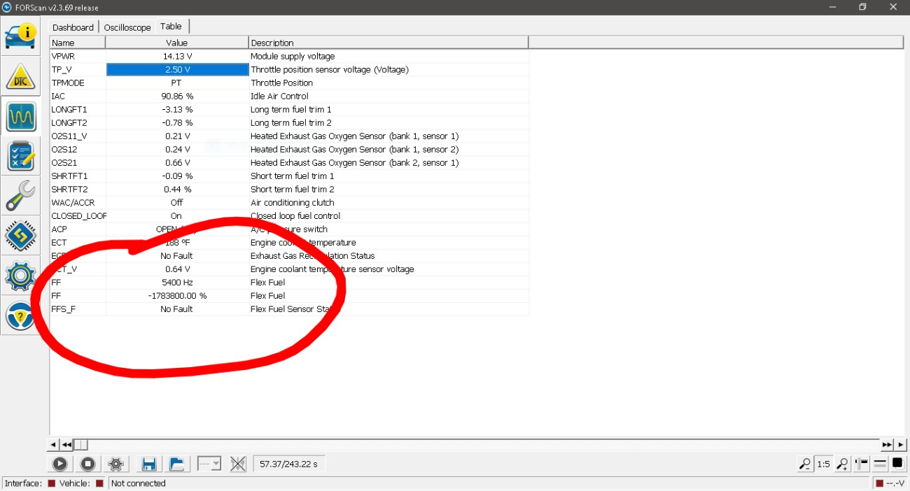

I use Forscan.
And the early 2000s Ford flex fuel sensors are dumb expensive and if they go bad the truck won't run. All the ECU needs is a frequency and it will supply fuel.

I use Forscan.
