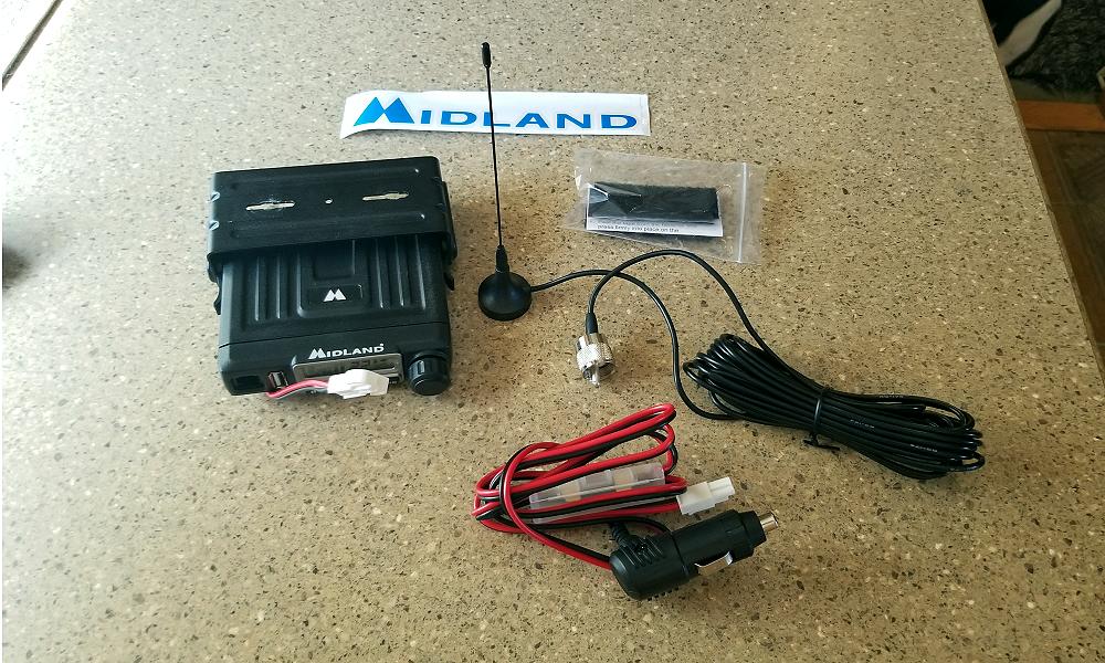

The nice thing about GMRS is that you can get small portable radios making it easy to communicate with your spotter when you’re on the trail, or with a friend or passenger (family member) that walks away from your vehicle. When I purchased my GMRS radio, I got the Midland – MXT115AG kit that included (2) portable radios and a charger (below).
A couple of other nice features is that the radio is so small and light weight that you could velcro it to your dash. It also comes with a quick release mount and a 12-volt plug for a lighter / accessory jack so you don’t have to wire it to your truck. PLUS, it comes with a magnetic antenna, so there’s no antenna to buy or have to tune with a SWR meter.

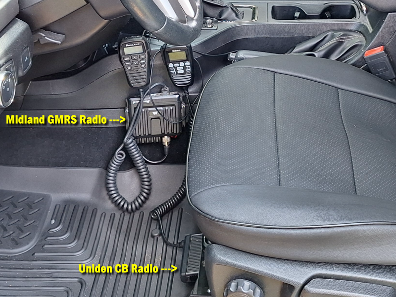

Size:

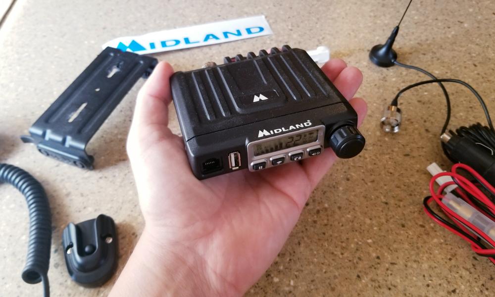

The Uniden PRO 520 is one of the smallest CB radios on the market, and as you can see, the Midland GMRS is much smaller.
The Midland MXT115 measures 5″ x 5.25″ x 1″ (with bracket attached) and actually fits in the palm of my hand:

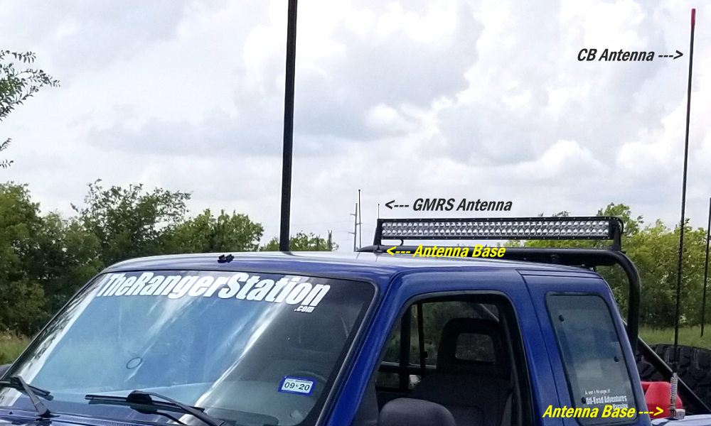

Antenna Lengths:
The longer the antenna, the more reception and clarity you get. Ideally you want at least 1/2 of the antenna above the roof line or 1/3 above the roofline at a minimum.
As you can see the 6-inch GMRS antenna on the roof is much smaller than the 4-foot CB antenna on the bed. My 4-foot Firestik antenna may be longer than the 3-foot CB antennas you typically see, but I was trying to stick with the above rule about 1/2 of the antenna being above the roof line.

I also spent the extra money and bought coax cable and a NMO antenna that mounted in to my roof so I didn’t have to deal with a magnetic base antenna and the wire. This means I drilled a small hole in to my roof and permanently mounted the antenna. The nice thing is that I can unscrew the 6-inch antenna and replace it with a 1/4-wave 2-foot antenna for better range in less than a minute.
