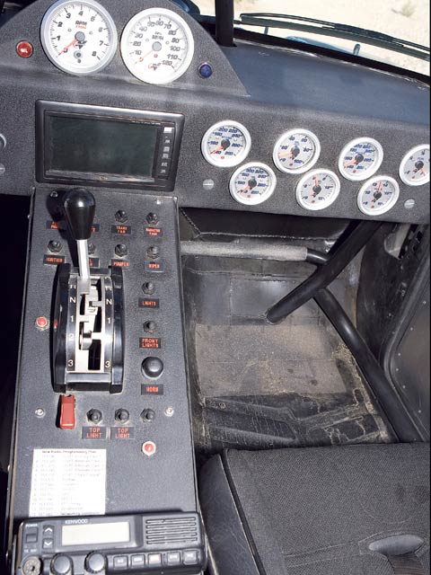

Robert custom-made an aluminum dash and then wrapped it in black leather. An entire picnic of Nordskog gauges is found littering the dash, as well as a Lowrance GlobalMap GPS unit and Kenwood 110W race radio with remote-mounted faceplate. Both seats are made by MasterCraft and use Crow five-point race harnesses. Above the cabin and in front of the truck are six Hella HID off-road race lights.
Robert did all of the wiring himself and he even wired up a rearview camera with monitor display in the center of the dash to see who may be following a bit too closely.

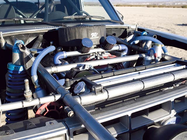

The transmission is a C6 built by Craig's High Performance Shop that uses a full manual valve body with a reverse shift pattern. The torque converter used is a model A1 Automatic that was custom-built for lockup over 3,500 rpm with special experimental internals that Robert told us were his little secret. Robert truly spared no expense with this build. He knew that not only did he need his truck to perform flawlessly, but it needed to be extremely reliable when traveling to the tip of Baja and back. Under the hood, he stuffed a 427ci small-block Ford engine that was also built by Craig's High Performance Shop. This isn't just a small-block - it was built to push over 575 hp at 6,800 rpm and 575 lb-ft of torque while still being able to use regular pump gas. Other components that made this possible include a Dart cast-iron block; Trick Flow R-Series heads; an Eagle stroker crank; Eagle H-beam rods; COMP Cams cams custom-grinded to Craig's specs; JE custom-forged pistons; an Edelbrock intake system; a Carb Shop off-road 950 double-pumper carburetor; custom-made, equal-length "stepped" headers built by Robert himself; and dual 3-inch Borla XR-1 race mufflers. As you can imagine, that much power pushes a lot of gas; to keep enough in the tank to run Baja, a Fuel Safe 44-gallon fuel cell was installed with dual 140-gallon-per-hour fuel pumps located just behind the cab. Basically, Robert's truck sounds like a Trophy Truck coming at you when he mashes his right foot.
