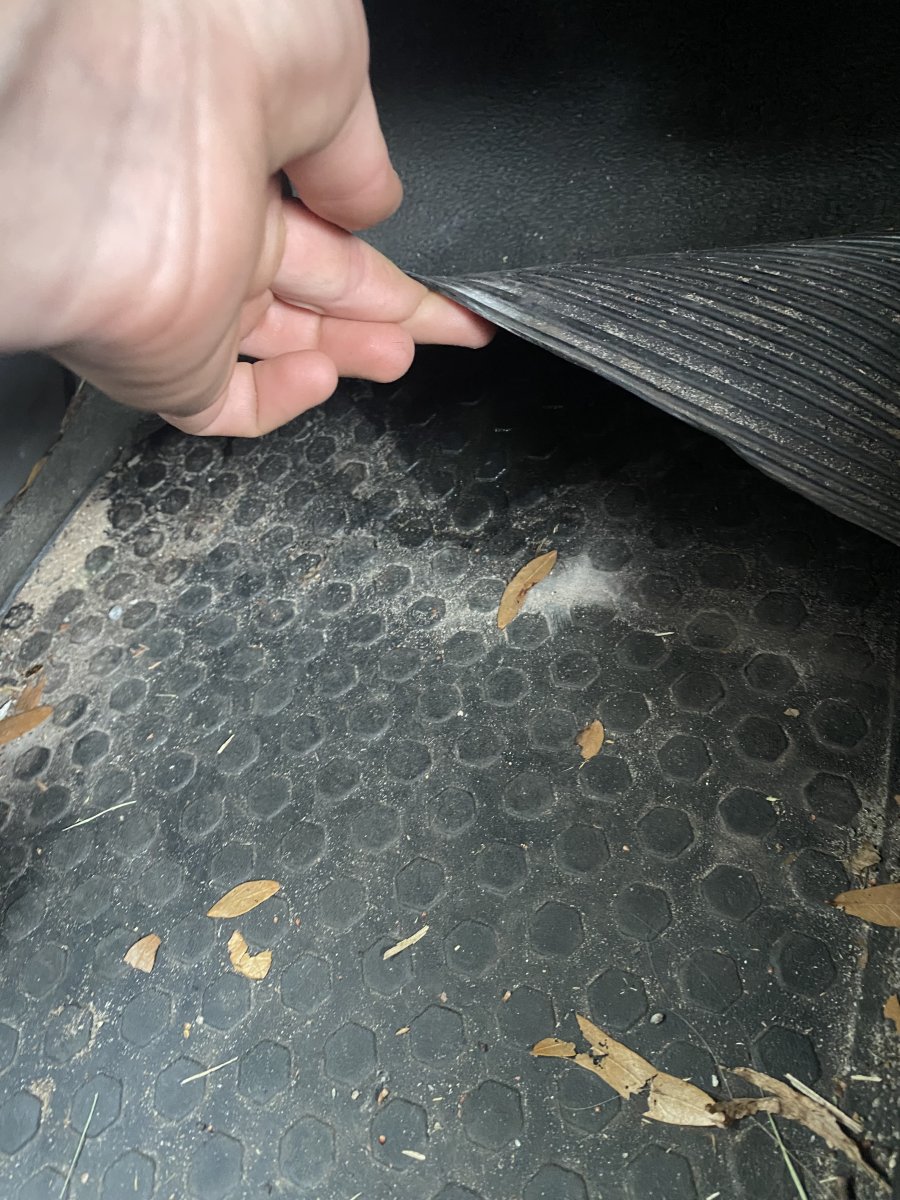

Unsure if this is a good place for this thread. I have noticed that on my drivers side, under the floor liner it has gotten wet, it doesnt seem to be coolant so i dont think its the heater core, im wondering if my ac drain line got clogged? Has anyone had any experience with this? I dont want my floors to end up rusting out. You can see the wet spot at the top of the photo ill put below

From memory, the A/C drain is on the passenger side. So while not impossible, unlikely. I would be looking more at a windshield leak or cowl leak, assuming the door seal is in good condition and the door isn't tweaked.
Unless it's been exposed to lots of leaves in the cowl or salt 06 seems awfully new to have that rusted out, but it IS a common problem.
I got my window replaced awhile back, since i got the truck the windows have a fogging up issue, probably due to this, i dont smell anything strange, weather strips seem to be good and all seals around the door.have heard of the cowl gathering leaves and causing this, easiest fix first to try because thats free before i start digging
I think i found it, have to confirm but my drivers side door weather seal has separated and the holes in the seal pretty much align where the wet spots are, ill replace em and give her a wash to see if it still happens, ill give an update, cant believe i overlooked something so simple, sometimes the mind likes to do that to you.
