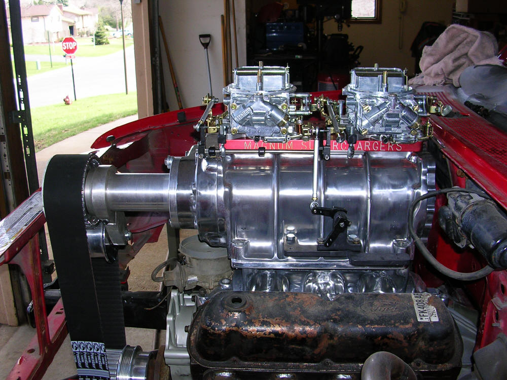

Engine: The 351 Windsor was punched to 383 by Gary at Magnum Superchargers in Oak Grove, Minnesota. It was built with SRP forged 8.5:1 pistons to handle the violence of the 6-71 supercharger and has a bumpy 244/254-at-0.050-duration cam. On the dyno, it made 683 hp and 635 lb-ft and was still making power past 6,000 when Tim first thought about purchasing an aftermarket block for the next build. “I really didn’t want to blow the stock block apart right there on the dyno, so we stopped at 6,000,” he says. The heads are from Trick Flow, the carbs are a couple of Holley 750s, and the headers were handmade and then coated by Jet-Hot.
