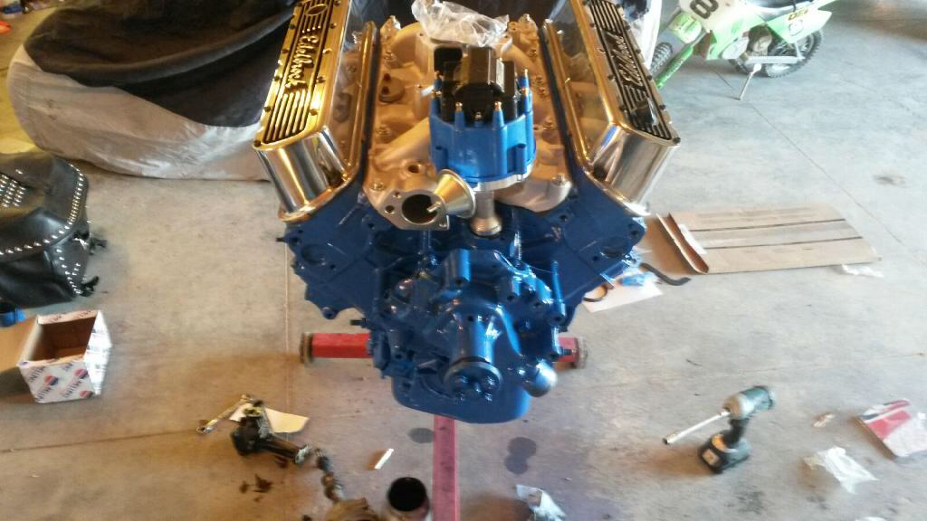

Ford78 drove with the 3.0L / automatic setup until the 3.0L died, and then swapped in a Ford 5.0L (carburetor) with a NP435 manual transmission, and NP205 manual transfer case. The exhaust finds its way out of the motor with help from Advance Adapters headers.
