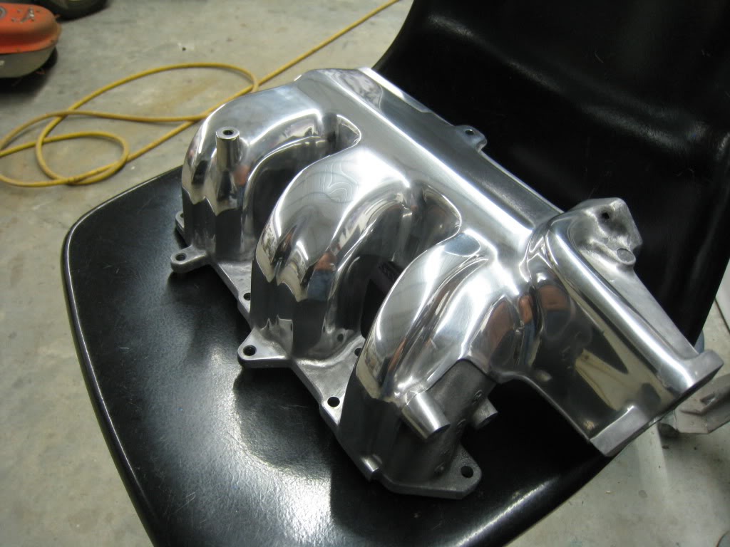

How do you polish an intake;
About 9-hours of sanding starting with 80 grit then moving to 180, 320, 600, and then 1500. (80, 180, 320 were dry on a sander. The 600 and 1500 were wet sanded.)
Polished Ford 4.0 upper intake

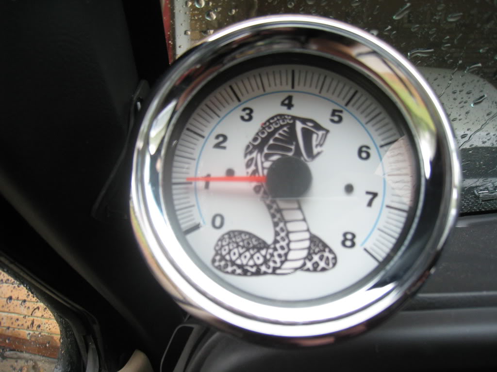

The interior panels and dash were given a new coat of gray paint, and the seats were replaced with red buckets. The dash received white face gauges and a tachometer. The 5-speed is shifted by a Hurst shifter.

Sun pro Tach
Grant GT steering wheel
Hurst shifter
White face gauges
