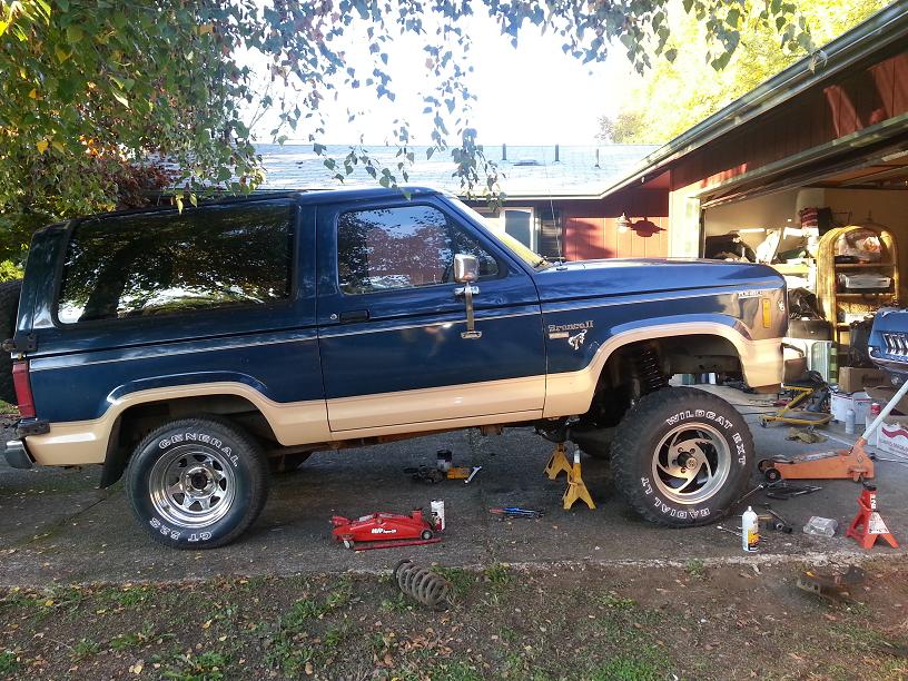

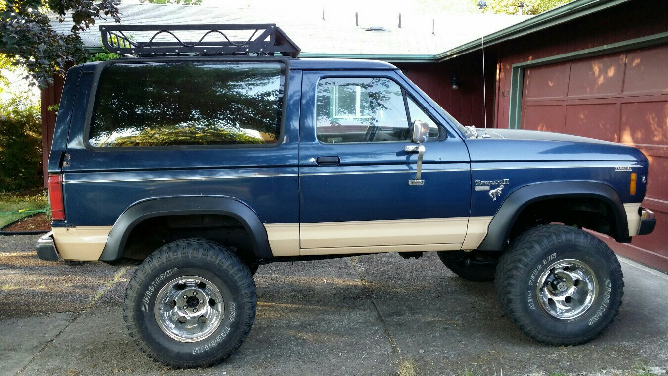

This Eddie Bauer 1986 Ford Bronco II has certainly been built with a true ‘Eddie Bauer’ feel.

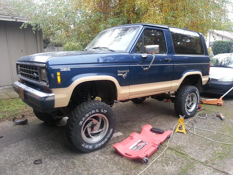

Forum Member ‘Harley’ bought this Bronco II for $400 and towed it home. Once he got it home, he replaced the computer relay and fired it up.

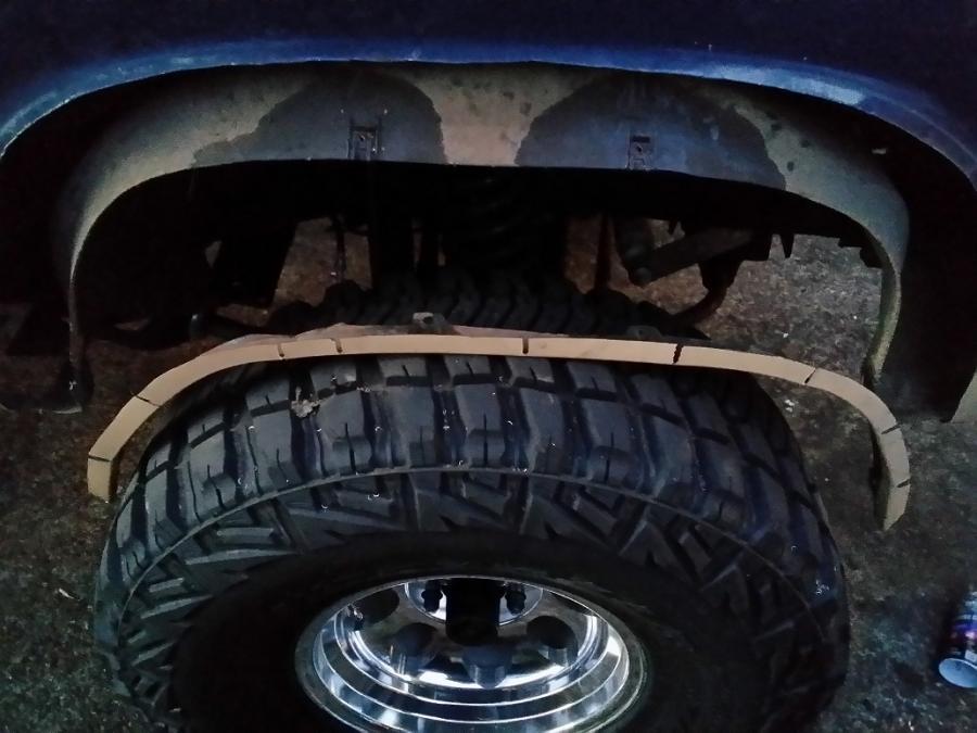

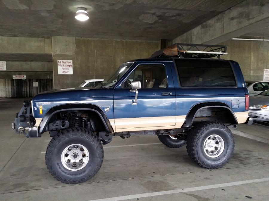

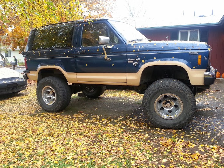

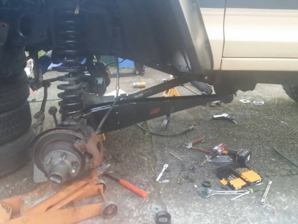

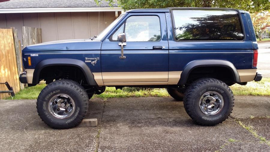

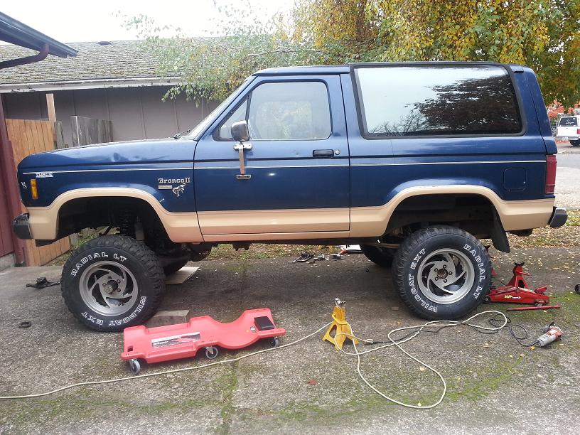

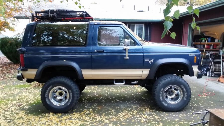

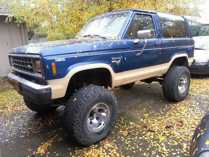

Harley lifted the Bronco with a set of Superlift brackets and 6-inch BDS coils. The rear was lifted with a lift block and add-a-leafs. He later added Skyjacker extended radius arms. A 2-inch body lift was added to make room for 33-inch tires. Harley found a used set of Bushwacker cut-out fender flares for $40, coated them with bedliner, and bolted them on. The used flares made room for larger 35-inch tires.
Skyjacker suspension

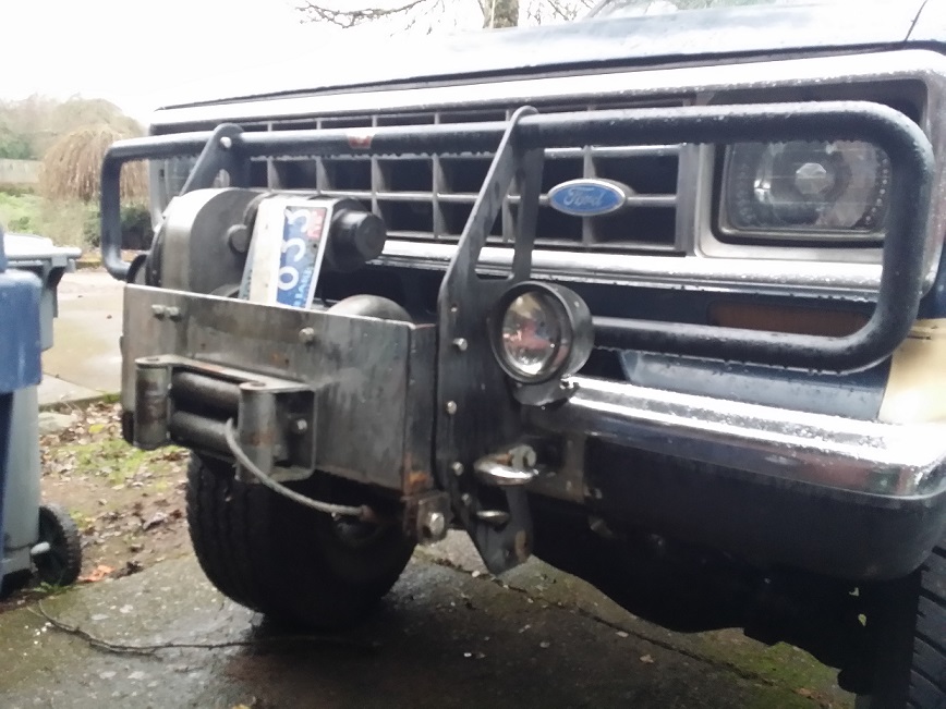

Harley found some manual locking hubs and swaybar drop down brackets on Craigslist for $30. Continuing with his used parts streak, Harley got a smoking deal on an 8000lb winch with a grill guard / brush guard for $150.
Ford Bronco II Warn Winch Bumper

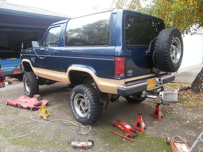

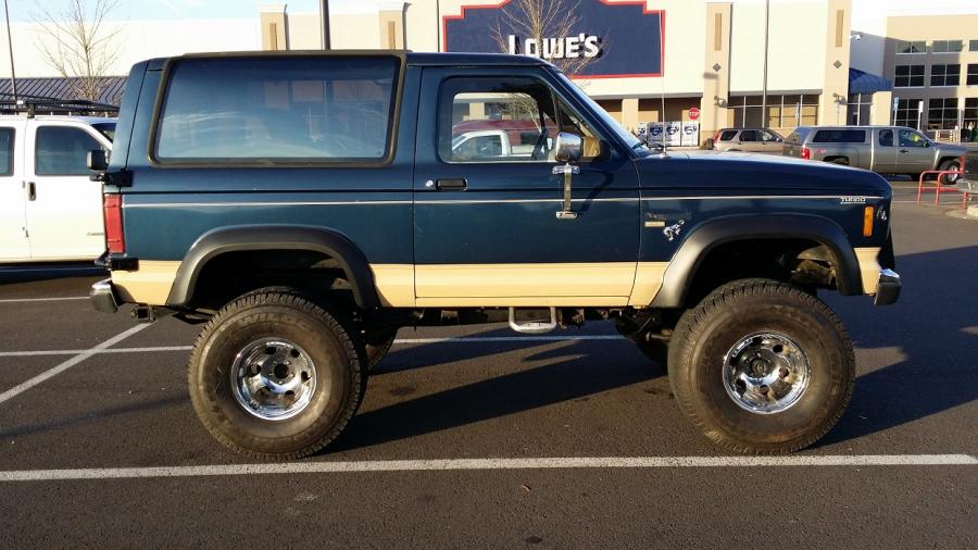

Upgrading to a set of Goodyear Kevlar MTR 35-inch tires needed a gear change to compensate for the larger tires. Harley accomplished this by picking up a junk 1992 Ford Ranger 4×4 that came with 4.10 gears and a larger Dana 35 front axle.
Ford Bronco II Overlander
