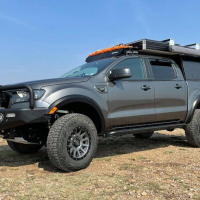

  • Icon stage 4 2.5 remote res coilover kit on the front. Springs adjusted to account for weight of bumper and winch
  • Icon billet UCA’s
  • Icon Compression +25mm 17×8.5 Wheels
  • 255/80r17 Falken Wildpeak tires with factory TPMS. True 33” tire whilst keeping weight to a minimum. Huge fan of the tall skinnies. Comfort, drivability and fuel economy of this truck all support that.
  • 255/80r17 Spare on factory spare wheel
  • Old Man Emu mid weight leaf pack on rear with greaseable shackles / bushings
  • Firestone airbags and daystar cradles
  • The OME leaf pack and airbags are a perfect combination in my opinion. If running the camper empty take the air out of the bags and it rides perfect. If the camper is full or the dirtbikes are on the trailer behind, put a few pounds in the bags and it firms everything up and levels the truck out perfectly. Shrader valves are run to the rear of the truck to easily adjust airbag pressures.
  • Icon remote res 2.0 shocks round out the rear end
  • ARB summit deluxe bulbar up front with LED fog lights
  • ARB Solis Driving lights (1spot, 1 fog) also include clear and amber protective covers
  • Factory FX4 Skid plate reinstalled under ARB bumper for clean look and decent protection
  • Shrockworks Sliders bolted up to the frame offers a clean look and excellent protection when off-road
  • Warn VR10s 10k winch with Synthetic line and Factor 55 Flatlink E
  • Bushwacker OEM fender flares offer great coverage from the increased offset of the wheels, help to protect from stone chips and looks sleek at the same time.

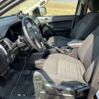

  • Inside of the truck is fairly stock with the addition of Husky floor mats front and rear since day 1, the ARB Solis driving lights switch, Builtright industries tray to mount accessories to and a Midland GMRS radio which can be easily removed if needed.

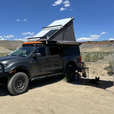

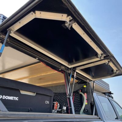

  • For full transparency, the wedge style camper is a DIY project and not a purchased product. With that said, it is extremely well built and receives a ton of compliments with the greatest being that people do not believe it was a DIY job. The camper was built for this truck and matches it perfectly with a low profile above the cab of the truck and clean lines on the sides. The camper is as waterproof as any truck cap out there and all doors have double bulbed seals to prevent the ingress of dust and water. The doors are all keyed alike, are reinforced for durability and have gas struts for easy opening. The tent portion is a 600D waterproof fabric with an additional waterproof membrane added. The tent portion has two windows, one at the back which fully opens and has a zipper bug screen and awning. The driver side window has a zipper opening and fixed bug screen. The camper fits an Exped Megamat duo LW+ and is included in the sale.
  • There is an ARB awning on the driver side which has adjustable warm colored led lights that plug direct into the camper
  • ARB awning tent for an optional full enclosure.

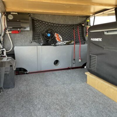

  • The camper Electrical System includes a 100w solar panel running to a Redarc BCDC1225 charger and is monitored by a Victron Battery Monitor with Bluetooth. The Redarc is also connected to the truck battery for easy and rapid charging whilst driving. The power is stored via a 100AH house battery. There are x3 National Luna adjustable bi-colored lights (white and red) inside the camper which are perfect for visibility inside or cooking at the tailgate. The camper also includes several charge ports (both USB and 12v cigarette) as well as a dedicated 12v run for the fridge. Outside lighting is made easy by two KC Hilights camp lights that are run via a relay and switched in the camper.
  • The kitchen and living portion of the camper consist of a false floor to support a 48” sliding drawer to store ample amounts of gear. Custom built kitchen slide utilizing a ClearView Expanda fridge slide which houses a Dometic CFX3 IM55 fridge with insulated cover, Coleman Triton two burner stove and cutting board / prep area all permanently fixed to make cooking food a breeze. Just slide it all out and away you go! The main slide is 500lb rated and double locks so no stability issues when fully extended. Rounding out the living quarters is a 13 gallon slimline fresh water tank at the front of the truck bed which is accessed via the passenger side hatch.
