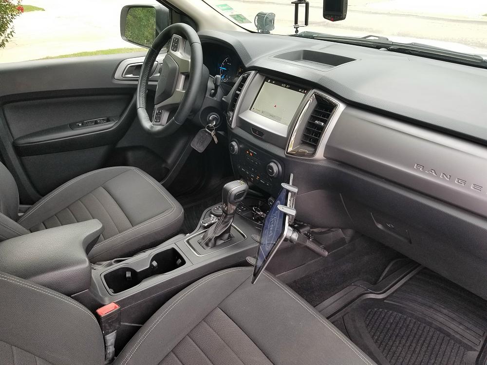

In the inside I added an Arkon adjustable tablet mount that clamps on to the console, and holds my Samsung 10-inch tablet. The tablet is crucial because I use it with the Gaia GPS app to navigate the Trans America Trail.
You’ll also notice an in-cab camera and a cell phone windshield mount. I use the cellphone mount so I can use my cellphone to record videos of my adventures. The in-cab camera constantly runs, and is more for capturing the unexpected.
I also use a GoPro suction mount for my action camera on the windshield, but it’s not shown in the photo.
The Ranger comes with (2) USB ports in the console, (2) on the back of the console, as well as a 110-volt outlet for me to plug in my phone, tablet, laptop, and any other electronic devices that I need to charge.

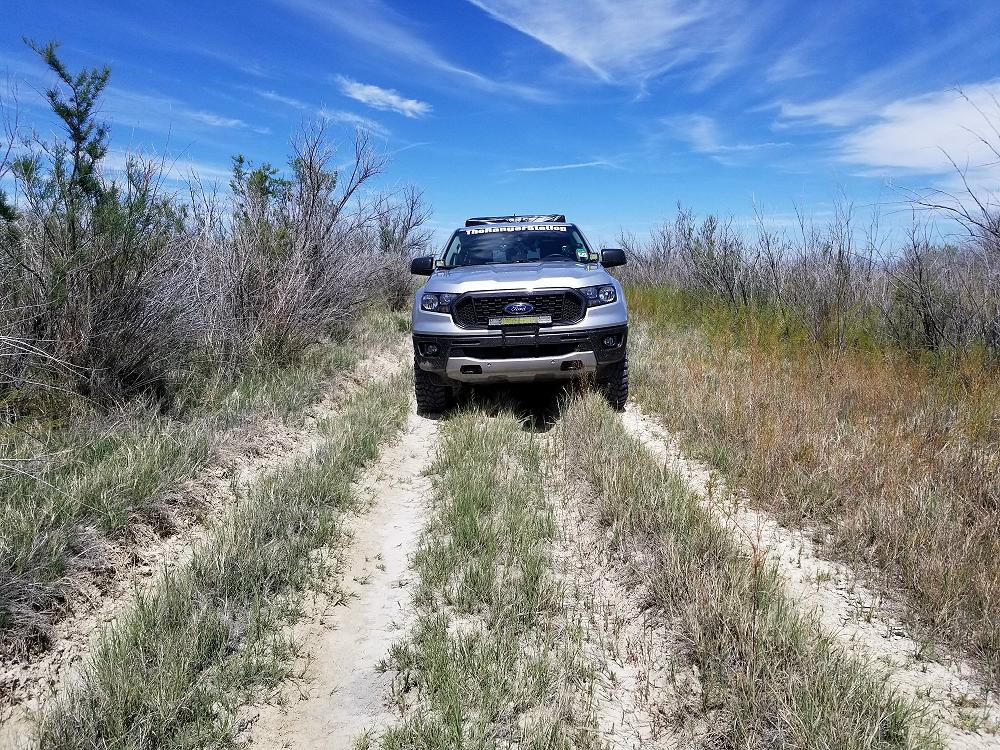

I’ve subjected this Ranger to an off-road park, sand dunes in New Mexico, and the Trans America Trail.
In fact, I drove the Ranger 1,861 miles off pavement on the Trans America Trail, and subjected the truck to a variety of rough terrain. I found myself driving on dirt, rocks, over rocky ledges, through sand, mud and heavy wet snow, as well as through and over brush and downed trees. I’m not aware of anyone that has ever completed the Trans America Trail in any Ford Ranger, and I’m definitely the first to do it in the all-new Ranger. I doubt that there’s any 2019 Ford Ranger out there right now that has been subjected to what this Ranger has been subjected to.
Not only did the Ranger perform great, but it did so comfortably. I wish I still had this Ranger when I tackle the Continental Divide from Mexico to Canada in 2021.
I’m not the average consumer. I’m an off-road enthusiast that likes to travel to remote areas, and drive on roads that can barely be classified as a road. I don’t have any complaints about the truck, but I was disappointed that the FX4 has an open front differential, and not a limited-slip. This caused me a little difficulty in some heavy wet snow on the Trans America Trail, but I was able to overcome it.
