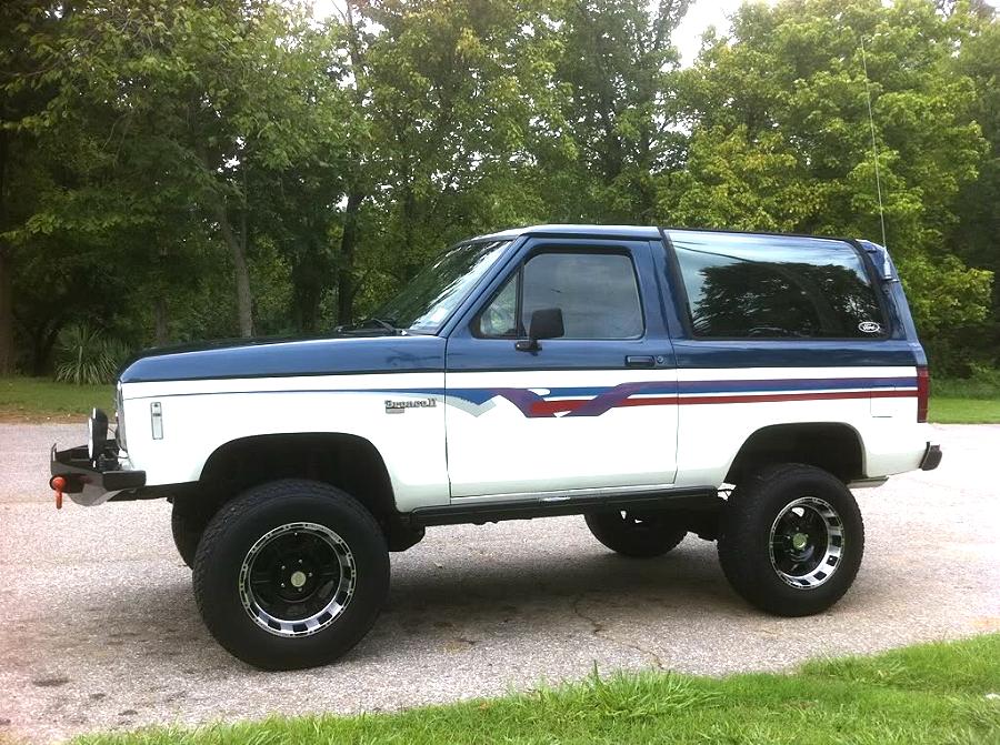

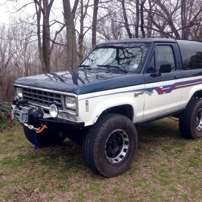

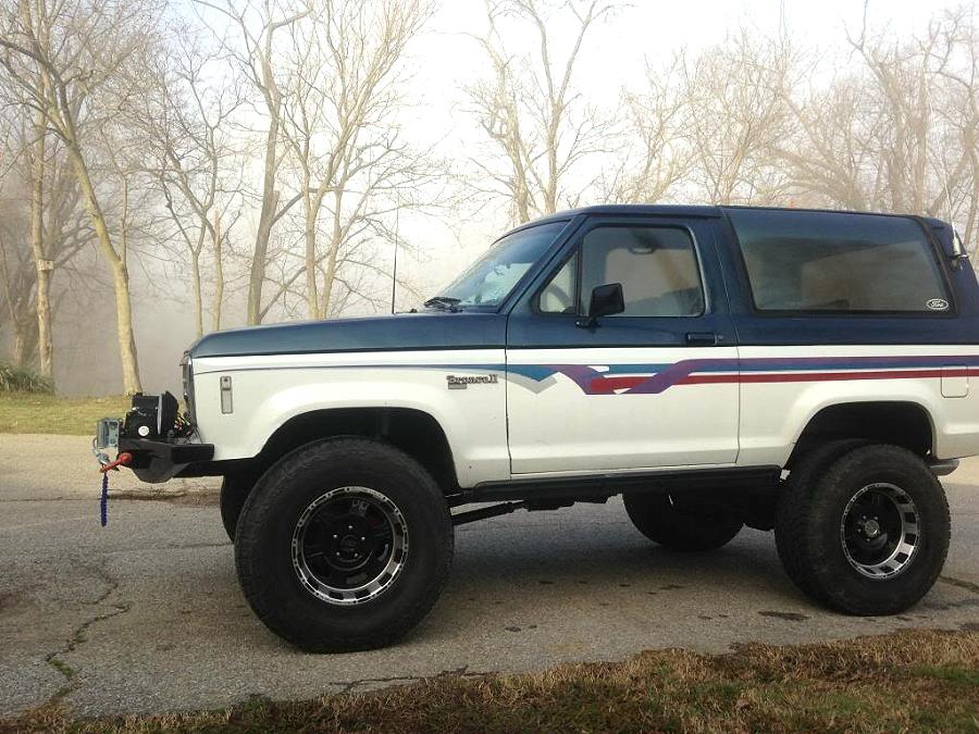

This 1988 Bronco II belongs to Ben Hodges (AKA 4.0B2) and has been in his family for a long time.
According to Ben:

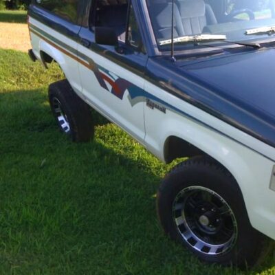

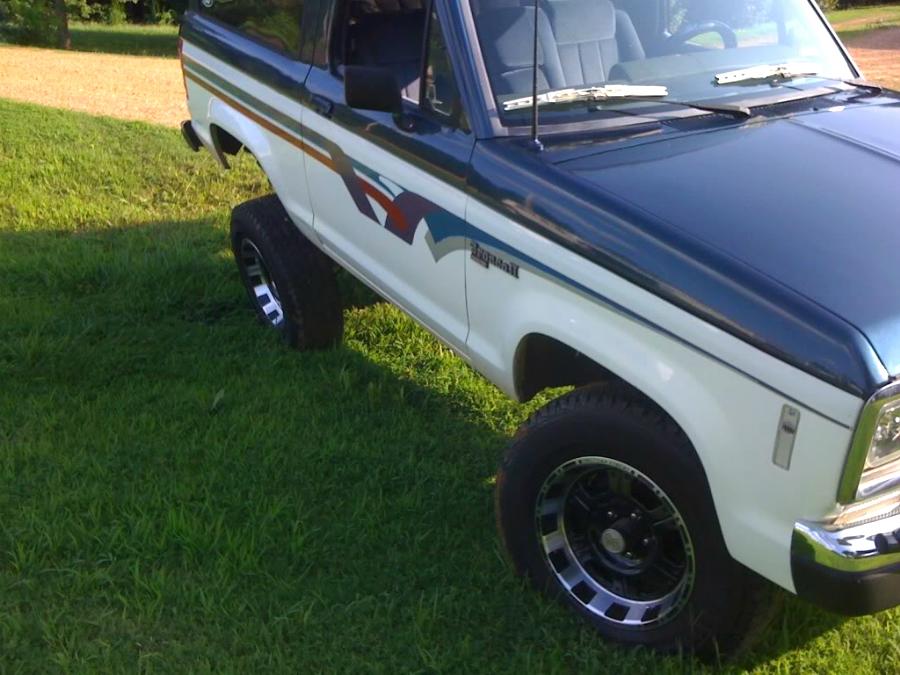

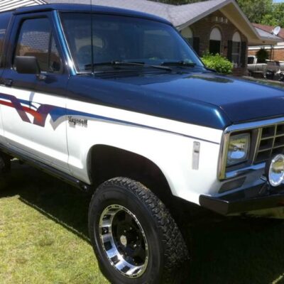

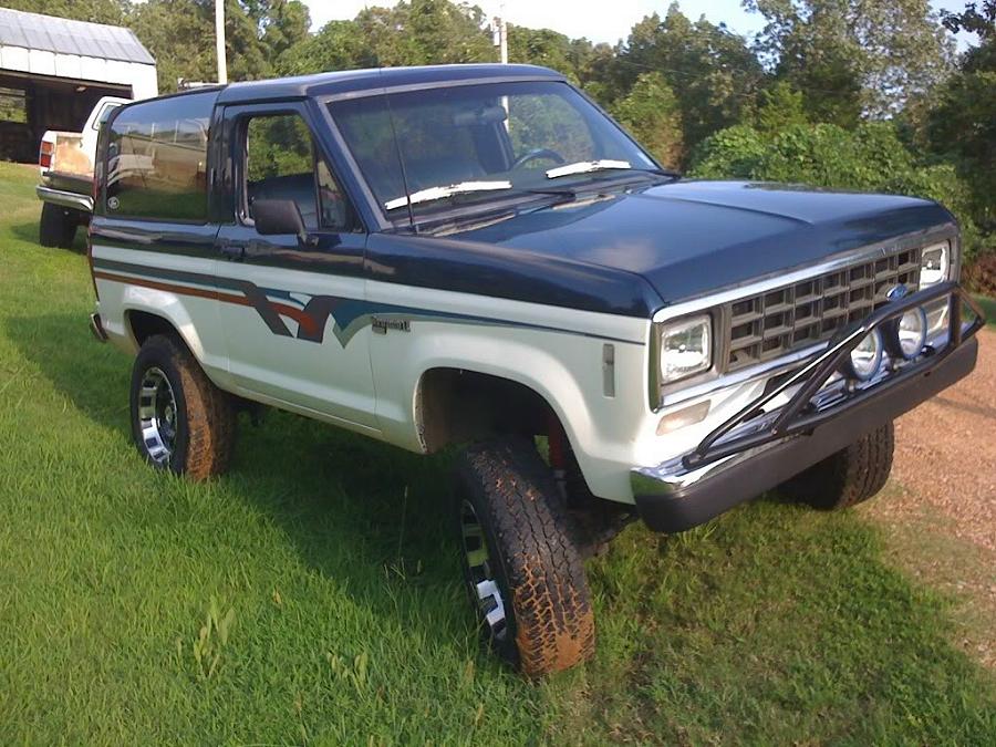

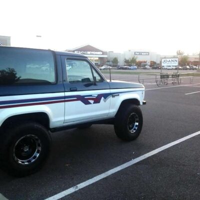

My love for the Bronco II started when my dad had an ’86 when I was young, but it burnt due to an electrical fire. He replaced it with this ’88. When he bought a Ford F-150 he sold it to my uncle. When I was 13 or 14, we bought it back for me. Paid $500 for it. The trans was messed up. It had a custom paint job then, but all stock with the 2.9L and all. First lift was a homemade 2-inch body lift. When I could afford the RC (Rough Country) I took the body lift out. Any pics with the EX’s (Explorer) bullet hole rims are the stage one of my personal build with the body lift and others.. “

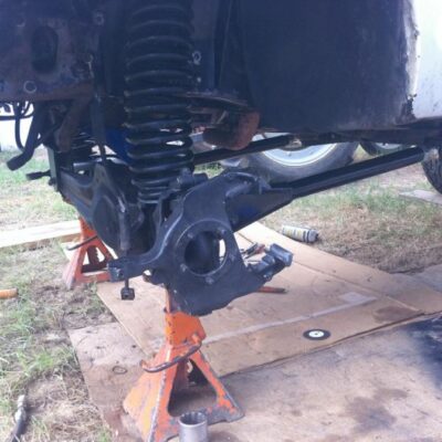

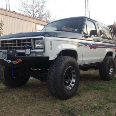

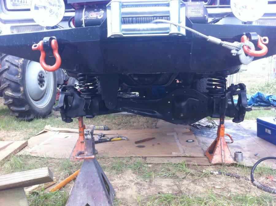

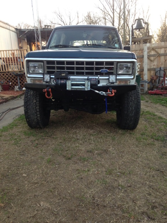

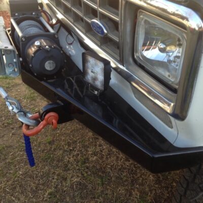

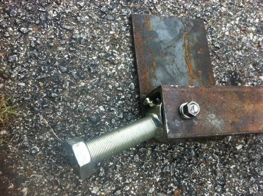

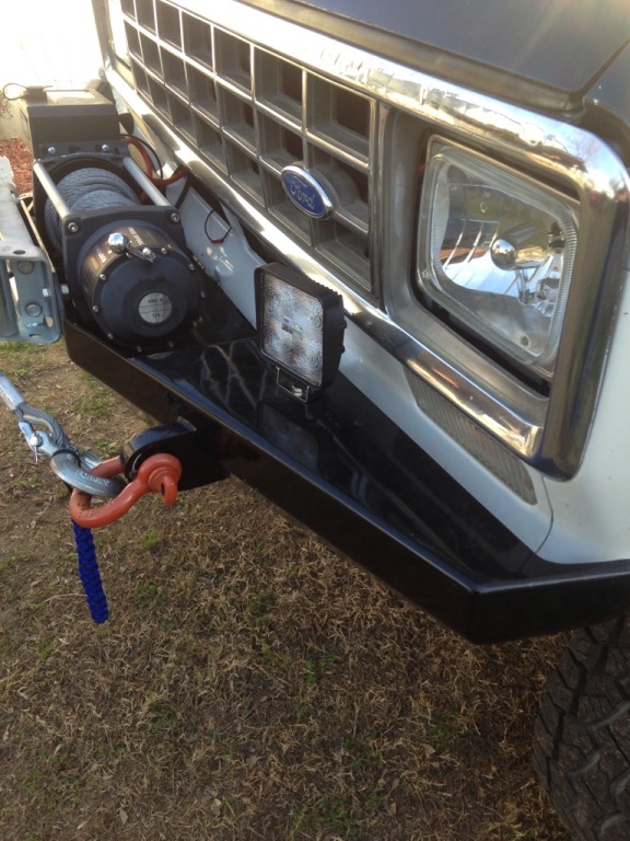

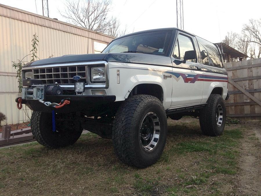

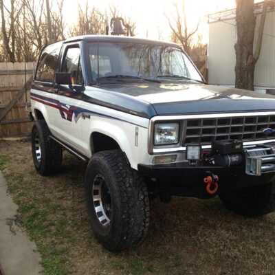

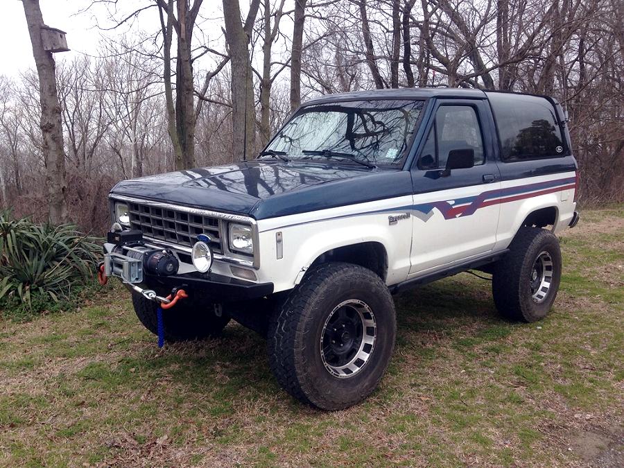

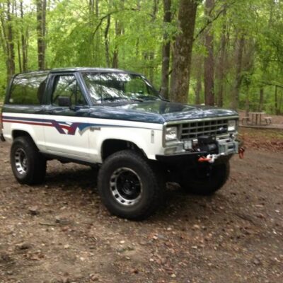

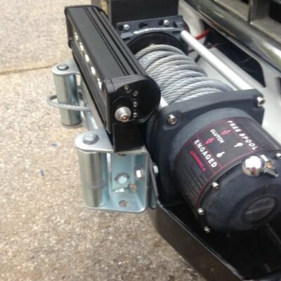

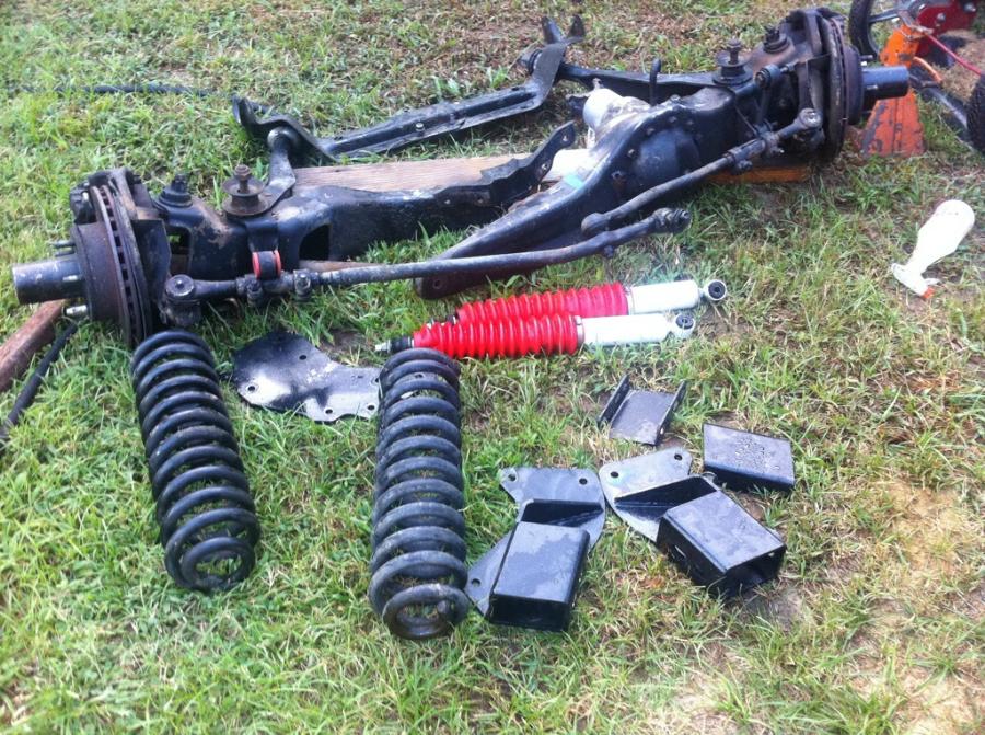

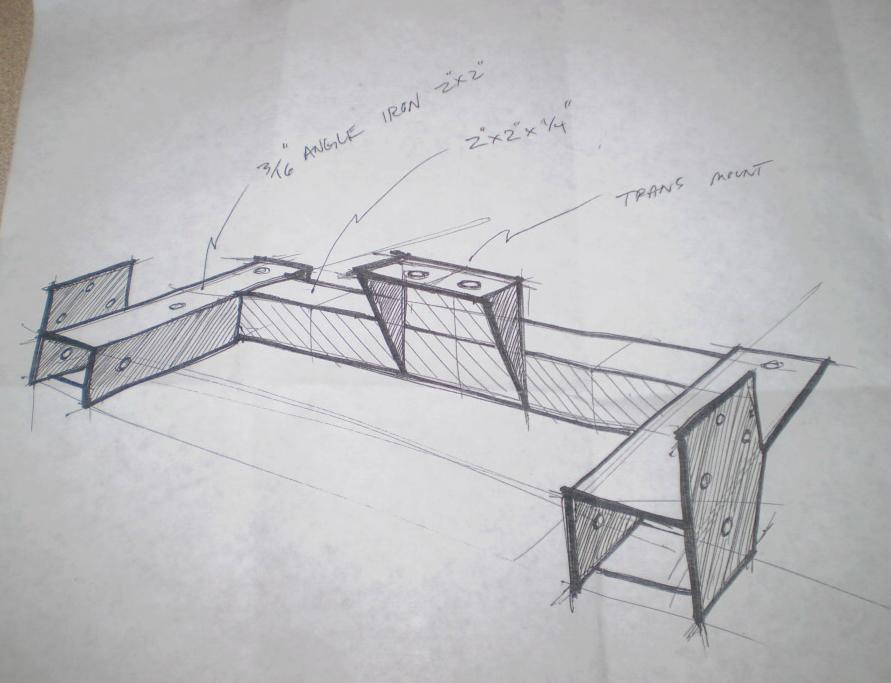

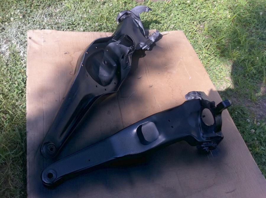

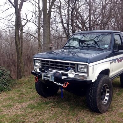

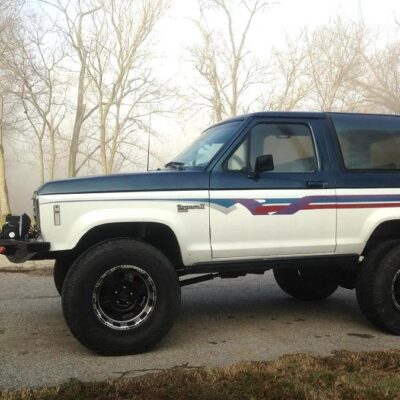

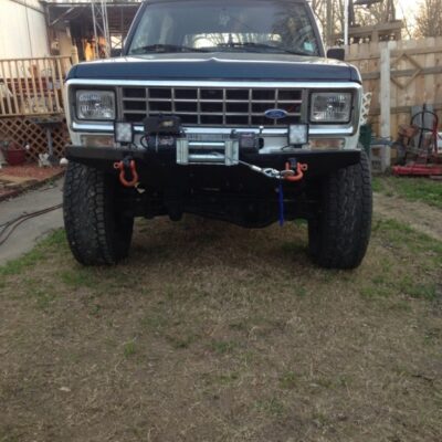

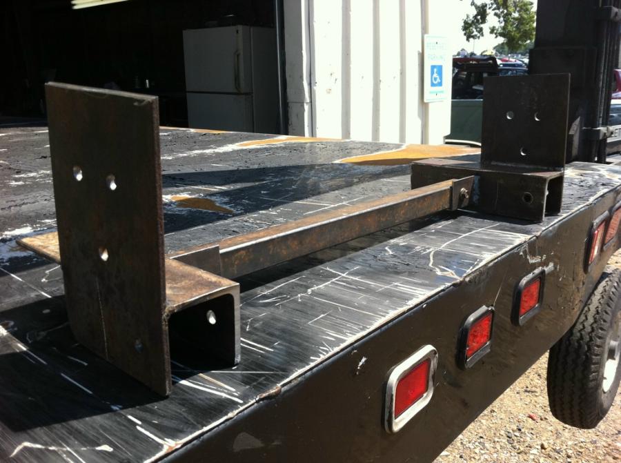

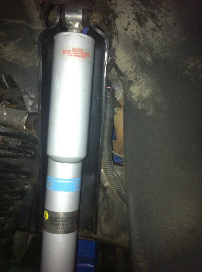

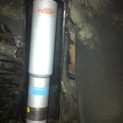

It was great getting his dad’s Bronco II back. As a young guy, it was probably nice getting a vehicle that had a custom paint job. But Ben wasn’t content to just drive the Bronco the way it was. Over time, the Bronco II received a 4.0L V6, and a lift that included a home-built transmission crossmember/radius arm mount, and extended radius arms. Taller F-250 shock mounts and longer Bilstein shocks allow for more wheel travel. A Superlift Superrunner steering kit helps keep it running straight down the road. A Ford 8.8-inch rear axle and Dana 35 front axle are both loaded with Aussie lockers, and 4.56 gears. They transmit the power to the ground thanks to a set of Dynapro 285/75/16 (33″ x 11″ x 16″) tires. The Bronco II has a Smittybilt 8,000lb winch mounted to a custom built bumper, just in case the Bronco II should get stuck.
The Bronco II has several more modifications that are listed further below.

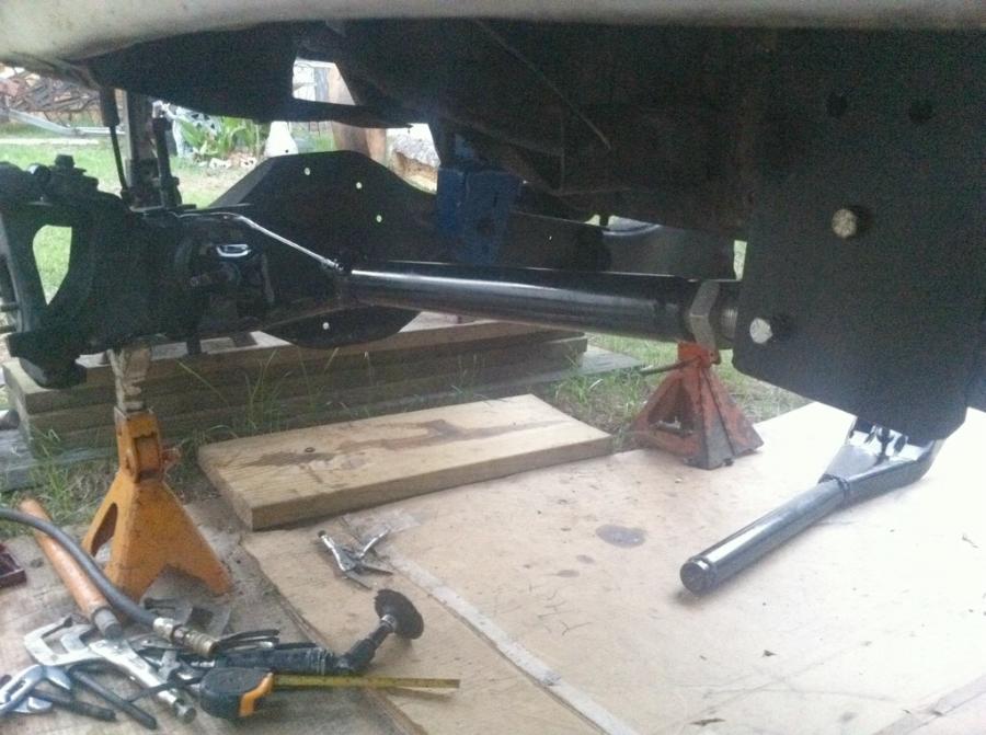

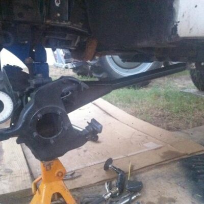

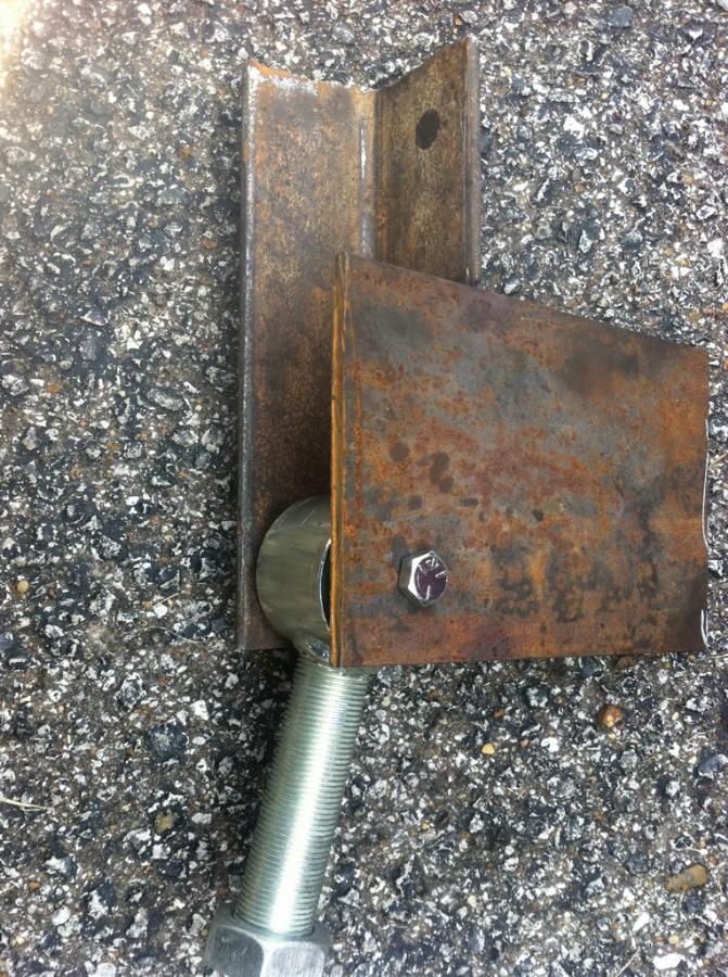

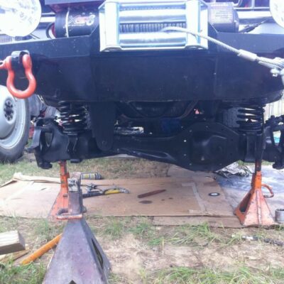

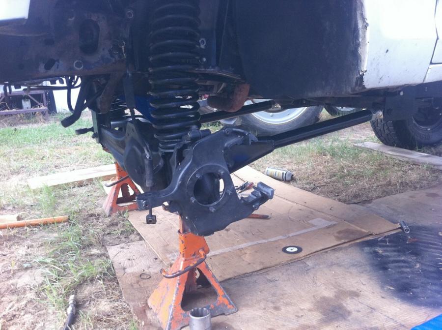

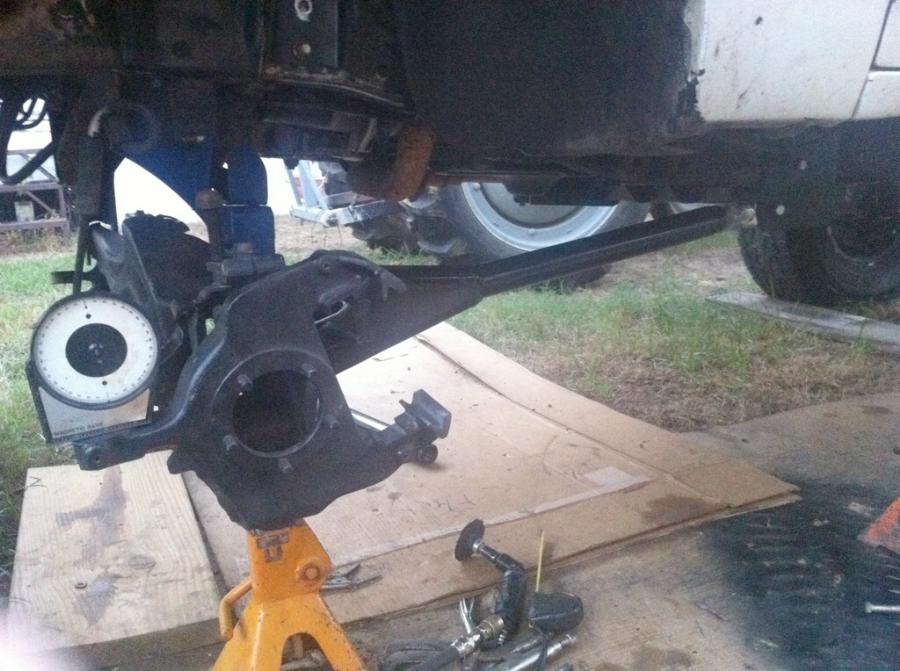

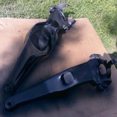

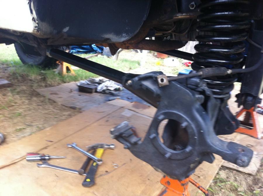

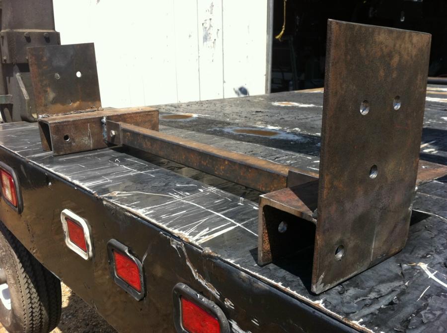

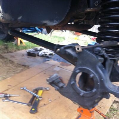

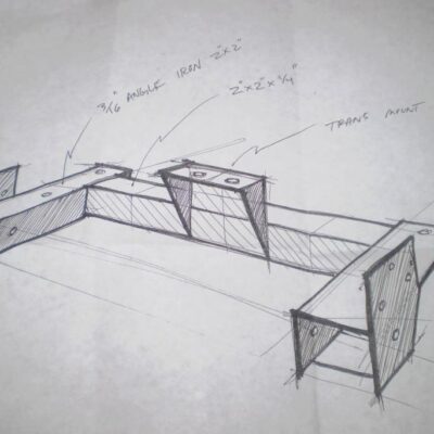

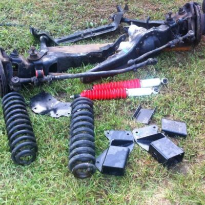

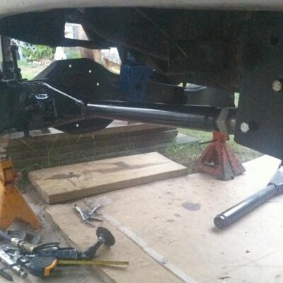

Dana 35 with longer radius arms
A Dana 35 with longer radius arms mounted to a custom transmission/radius arm mount

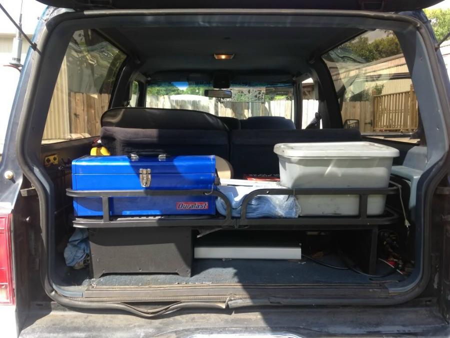

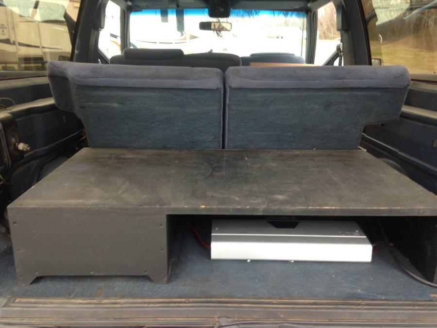

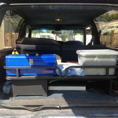

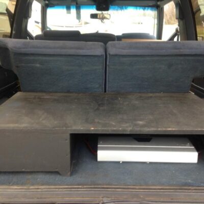

Ford Bronco II Rear Cargo Area Organization
Harbor Freight ATV cargo basket mounted on a homemade wooden amp/subwoofer box

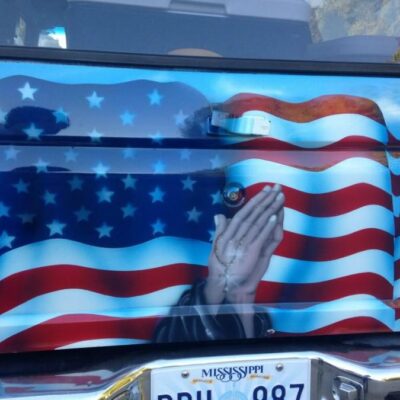

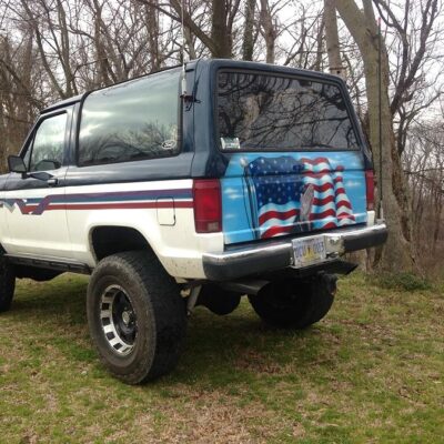

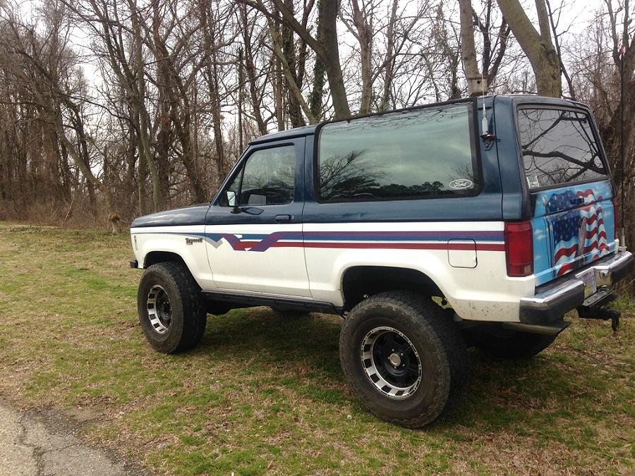

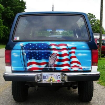

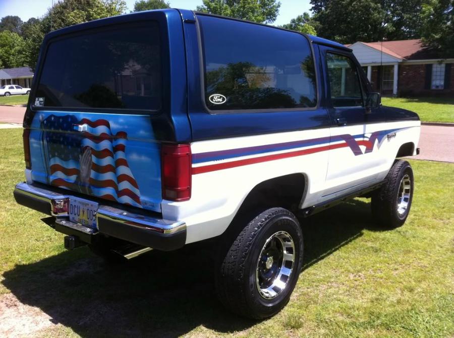

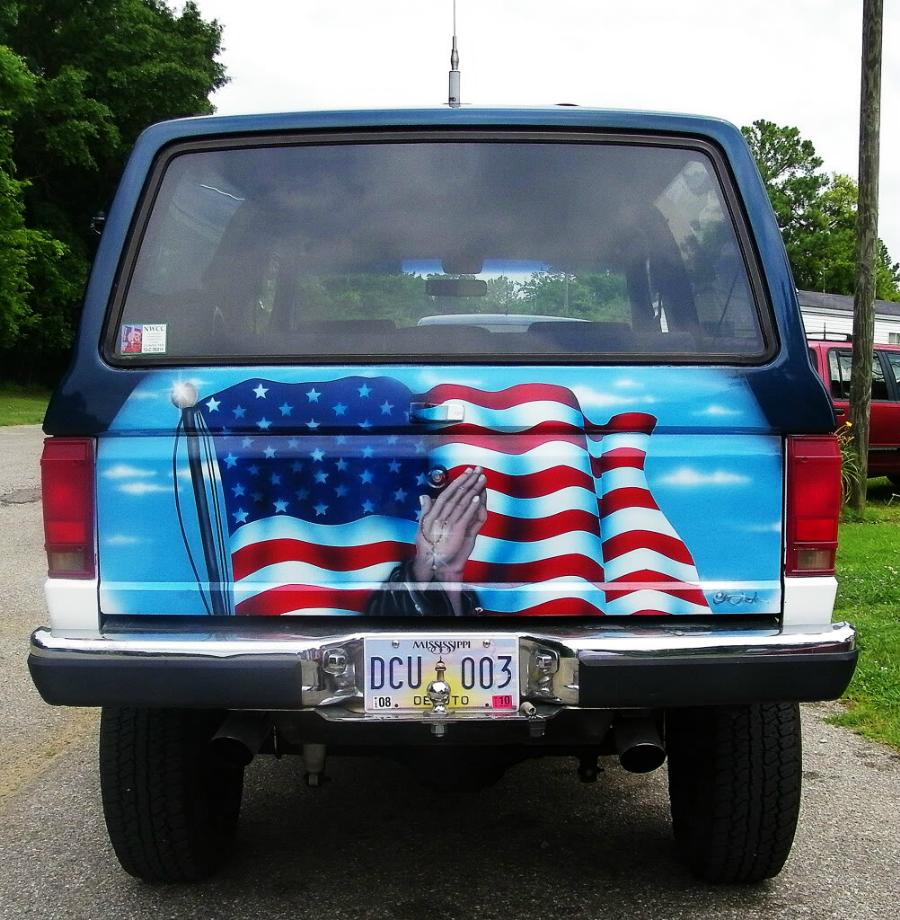

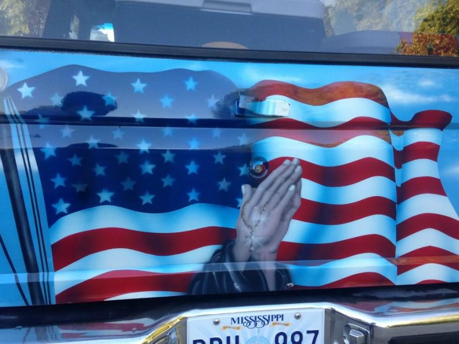

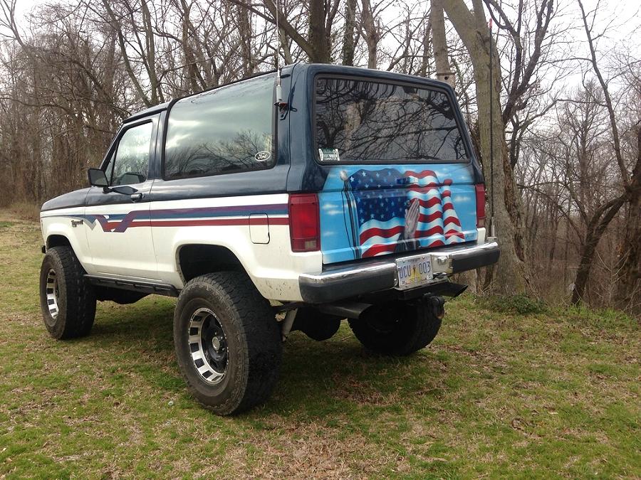

Ford Bronco II American Flag airbrushed on rear gate
Gotta love the mural πŸ˜‰

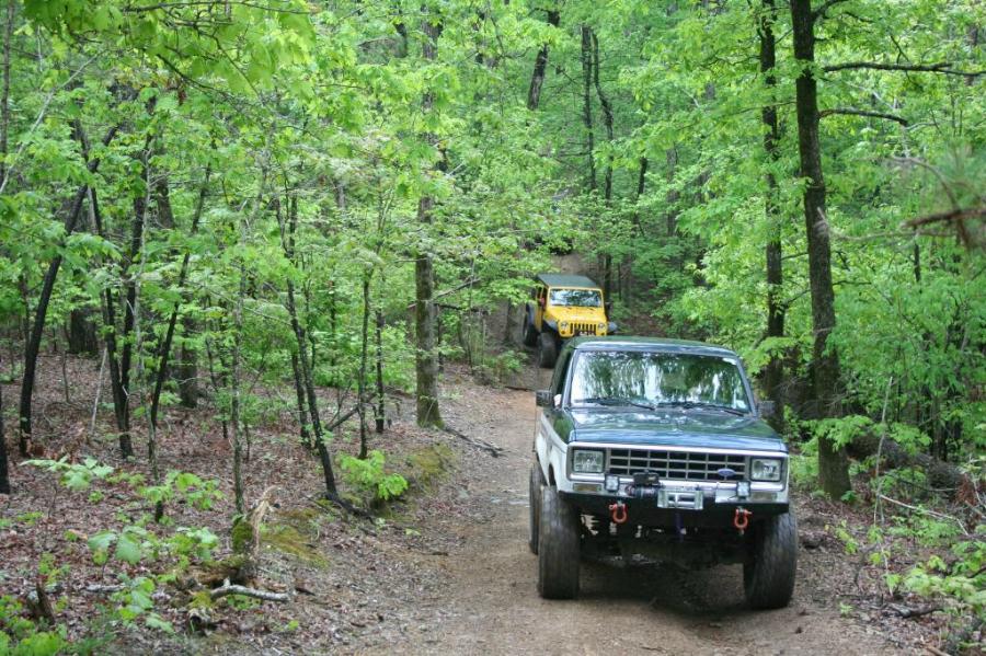

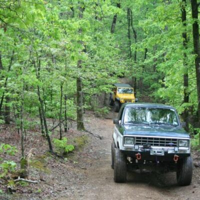

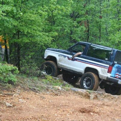

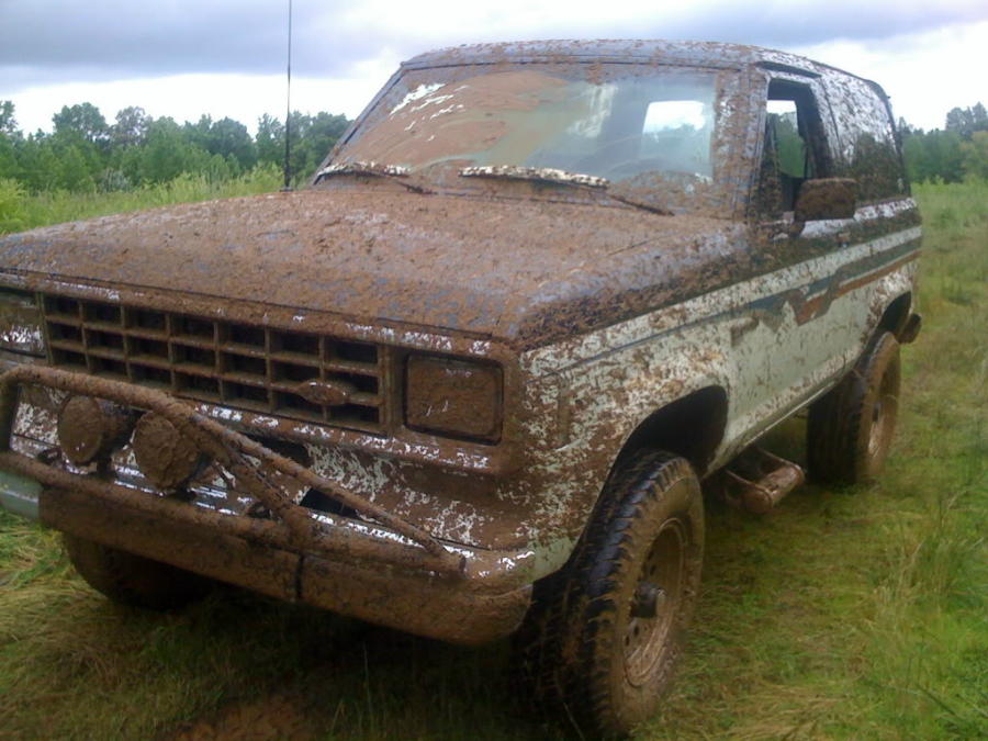

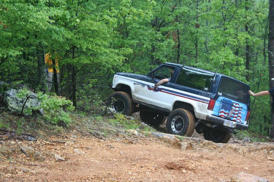

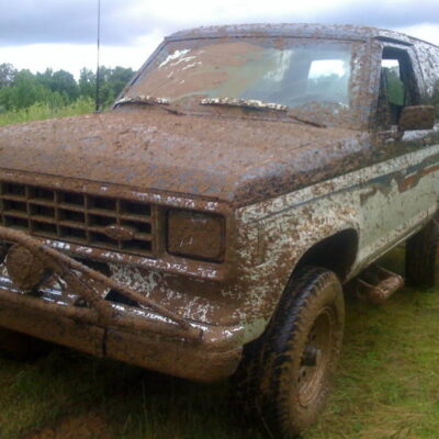

1988 Ford Bronco II on the trail
Yes, he actually wheels it

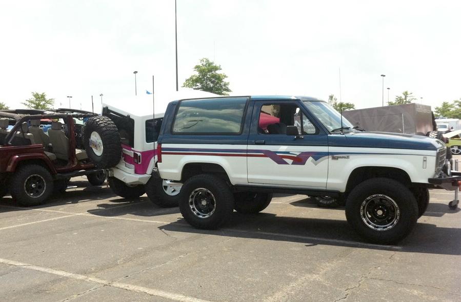

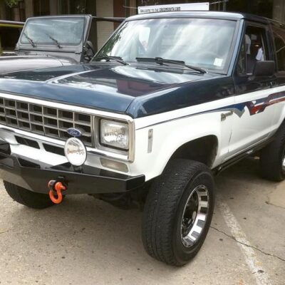

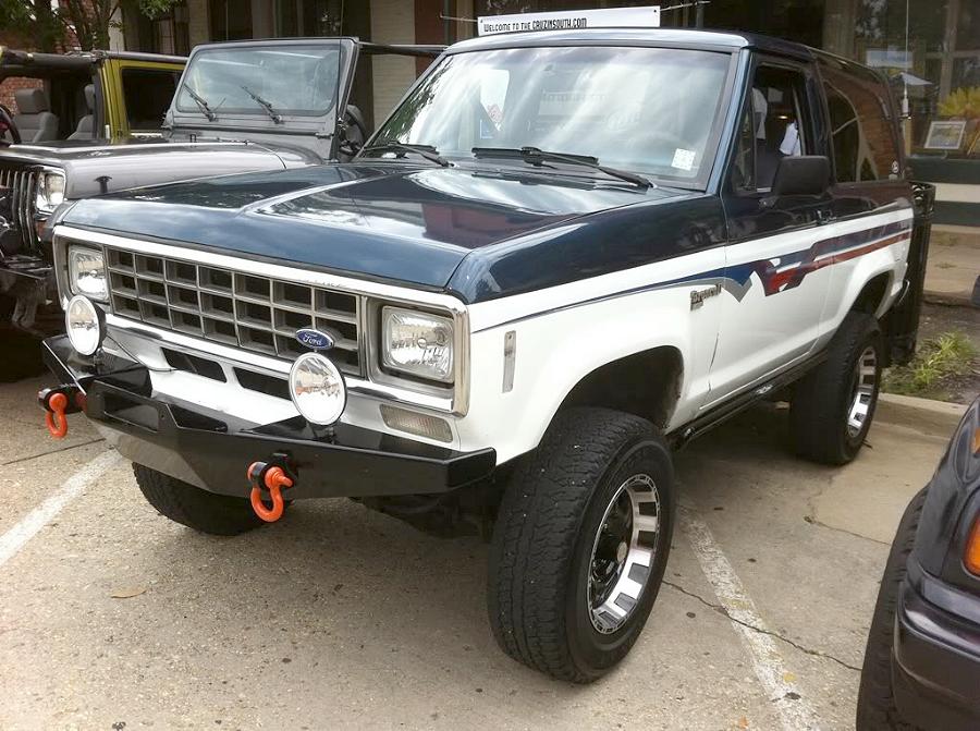

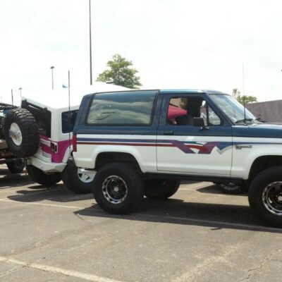

Ford Bronco II Car Show

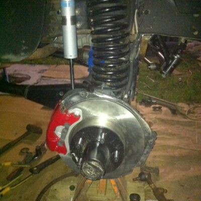

  • 8.8-Inch Axle: 4.56, Aussie, RuffStuff Cover, disc brake swap

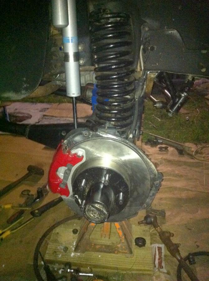

  • Dana 35 TTB: 4.56, Aussie, C-Clip Elim, Manual Hubs
Suspension/Steering / Tires

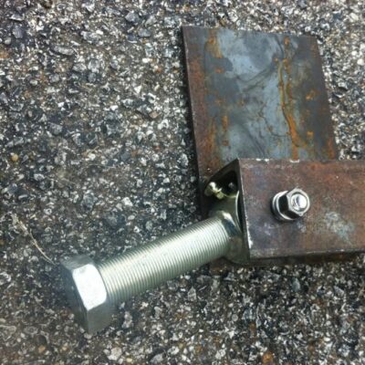

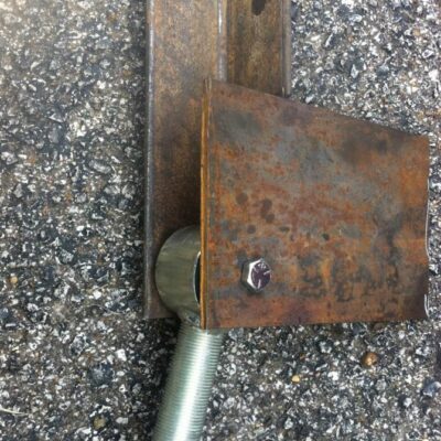

  • Custom Long Arms with Flex Joints
  • F250 Shock Towers with Bilstein 5150 Shocks
  • 3.5″ Early Bronco Coils
  • Jeep JKS Quick Disconnects
  • Superrunner Steering
  • VMS Drop Bracket on one side, Custom Bracket on the other
  • Rear is 2″ Blocks and one extra leaf

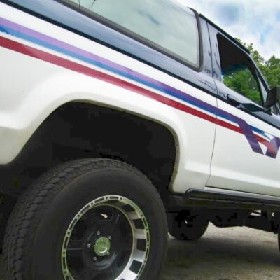

  • Dynapro 285/75r16’s
  • Procomp 8089’s 16×8″

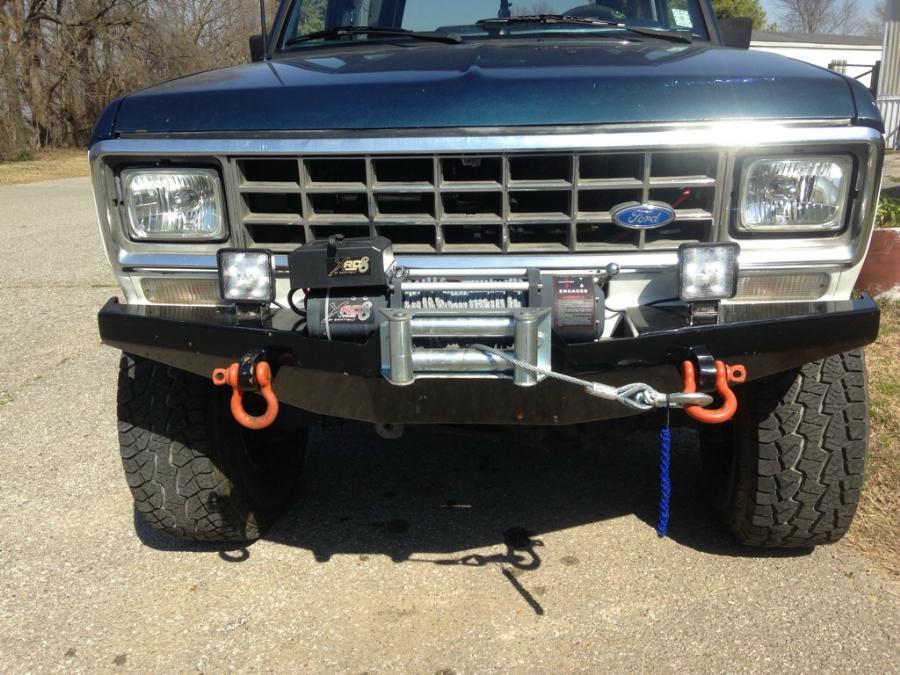

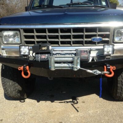

Bumpers/Armor/Recovery

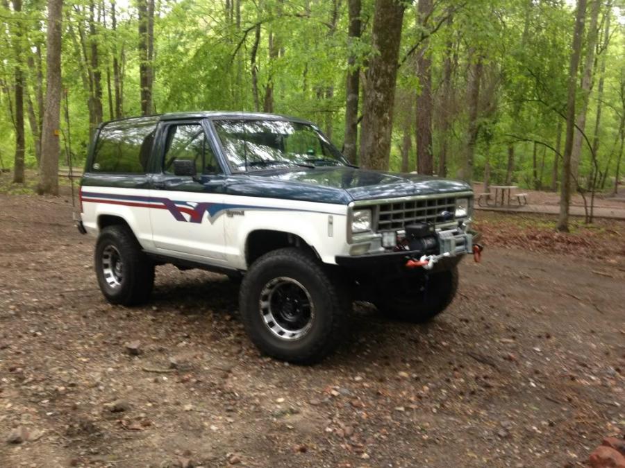

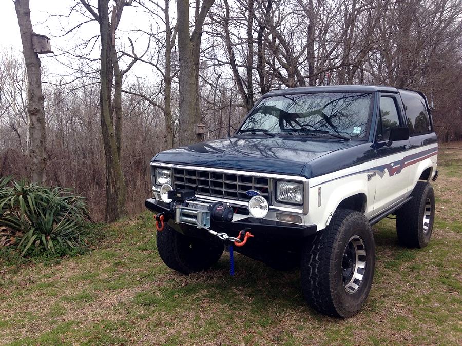

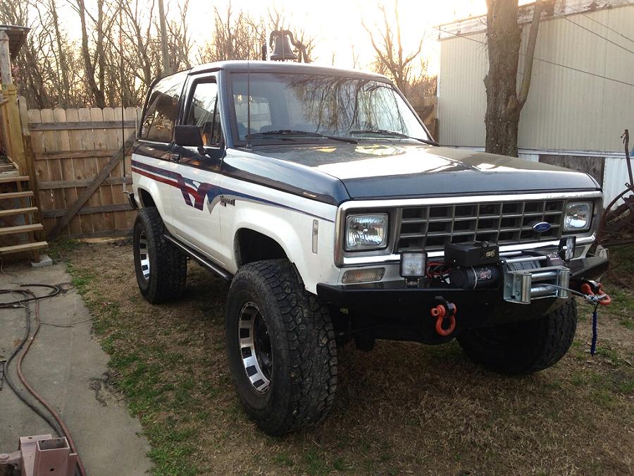

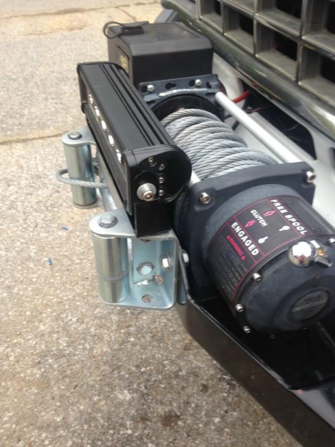

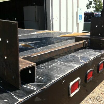

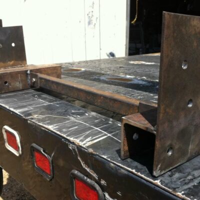

  • Custom Front Bumper
  • Smitty 8k winch
  • Custom Sliders
  • Custom Receiver Hitch with D-ring Hitch

  • Lifetime Flood LEDs on the Bumper

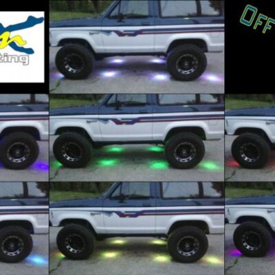

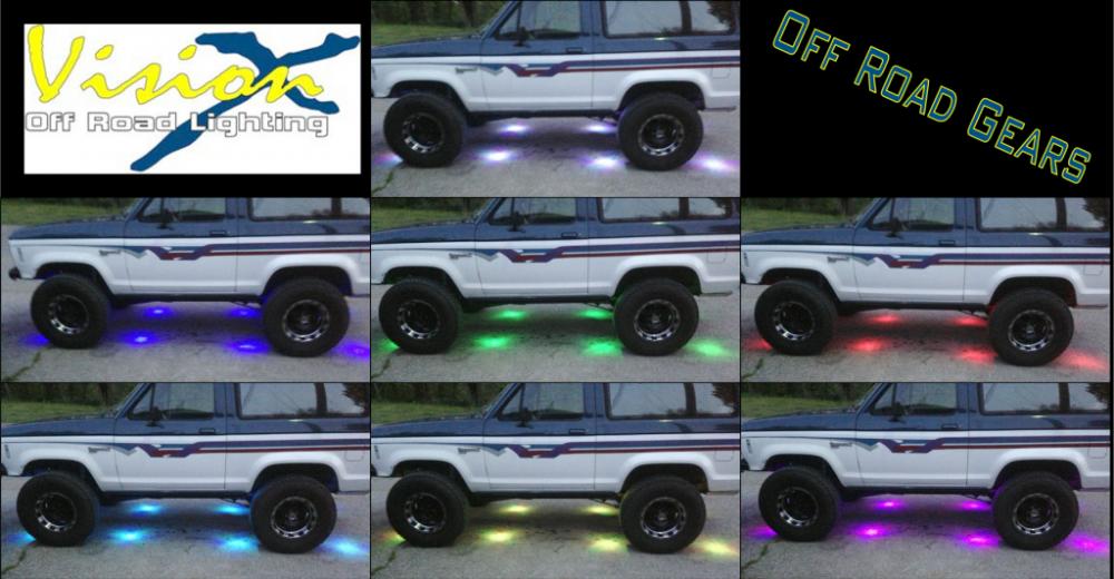

  • VisionX LED Rock Light Kit
