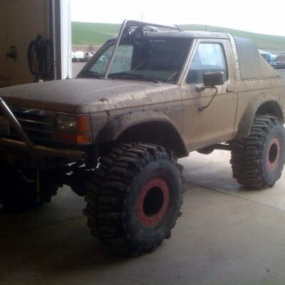

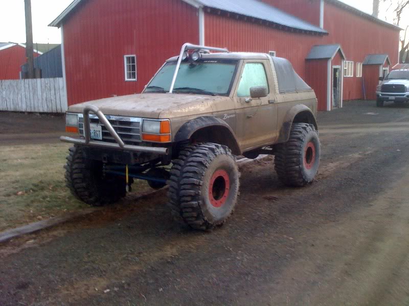

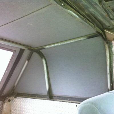

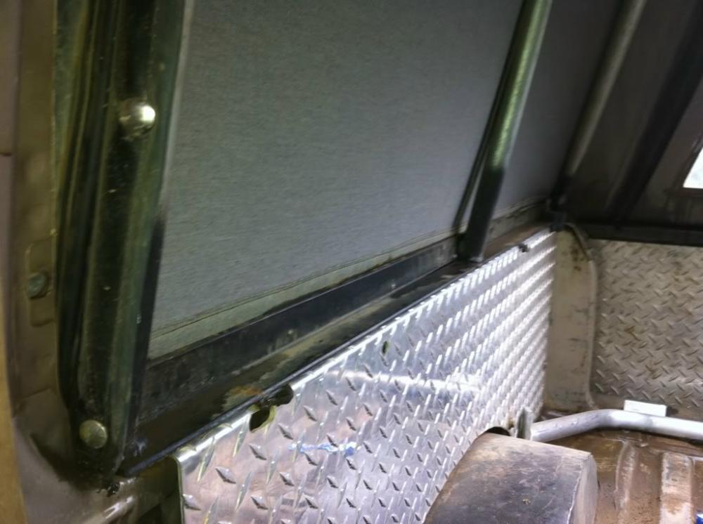

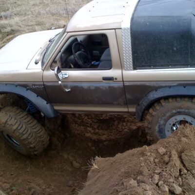

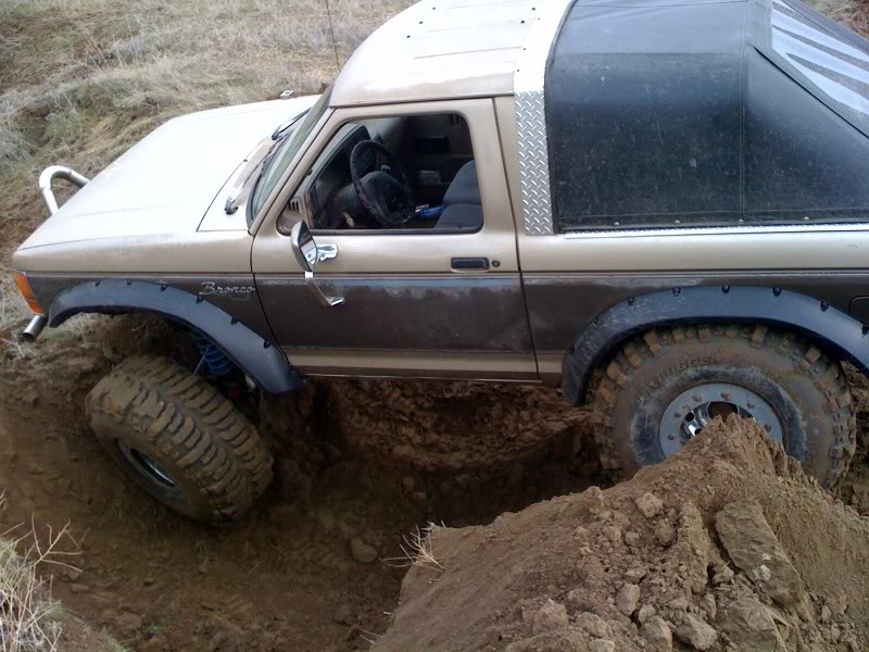

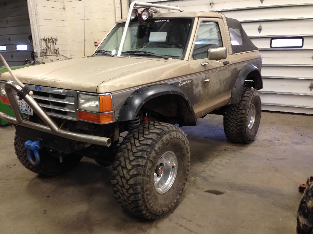

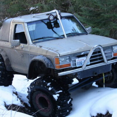

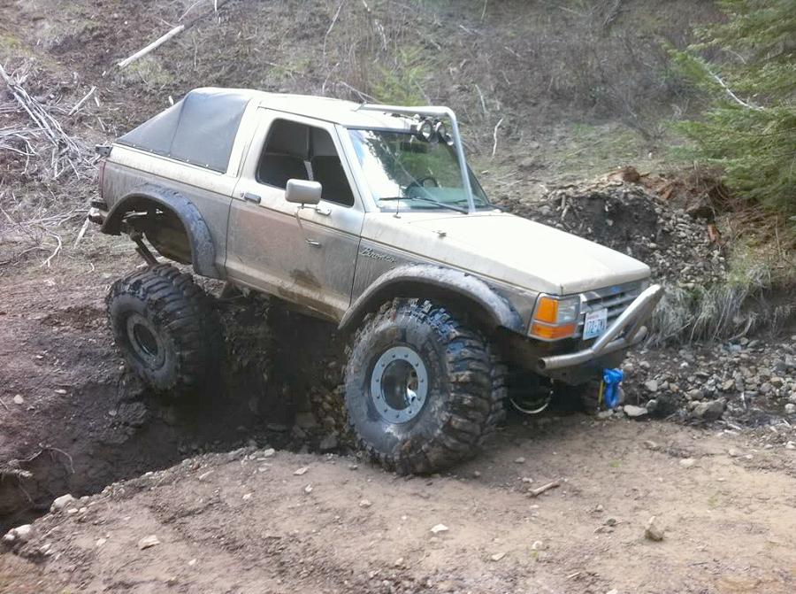

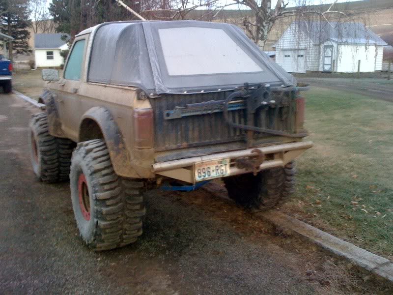

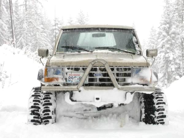

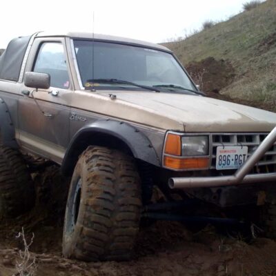

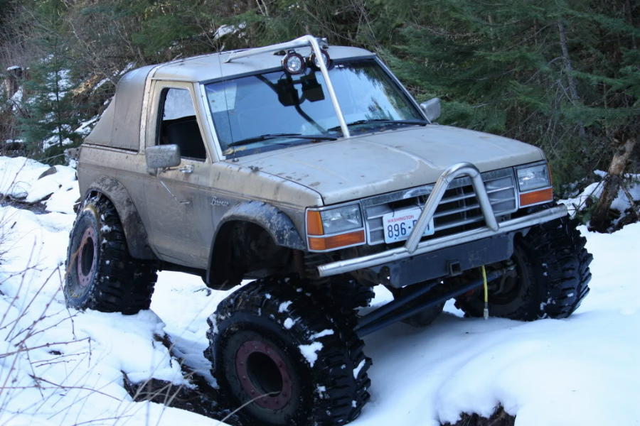

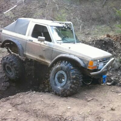

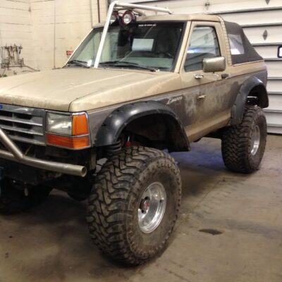

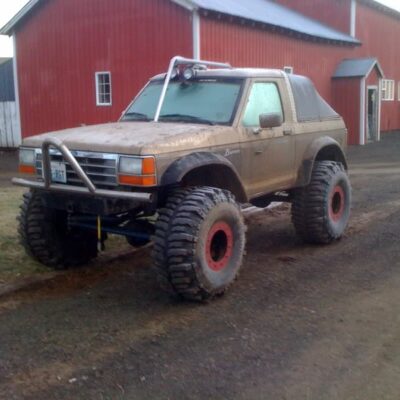

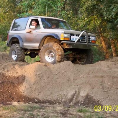

Specifications: This Bronco II has been upgraded to a 4.0L V-6 with a 5-speed manual transmission and a dual transfer case (doubler). The power is sent to Dana 44 & Ford 9-inch axles with Superior axles and 5:13 Gears. Power is delivered to the dirt by 39-inch Boggers on 15×14 wheels. They’re covered by Bushwacker fender flares designed for a fullsize Bronco. The roof was chopped and a custom top with a tube frame was added to keep the foul weather out. Stainless tube bumpers were built.

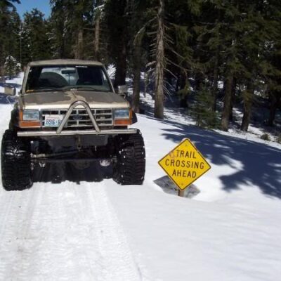

Ford Bronco II Snow Wheeling

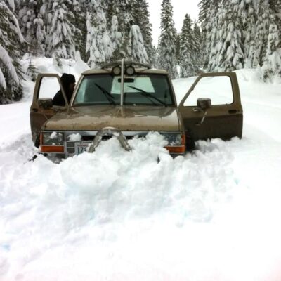

Could your truck drive through snow this deep?
Chop Top 1989 Bronco II on 39's - Rear

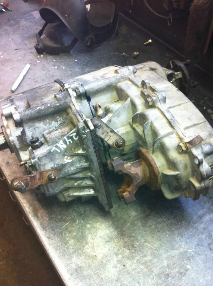

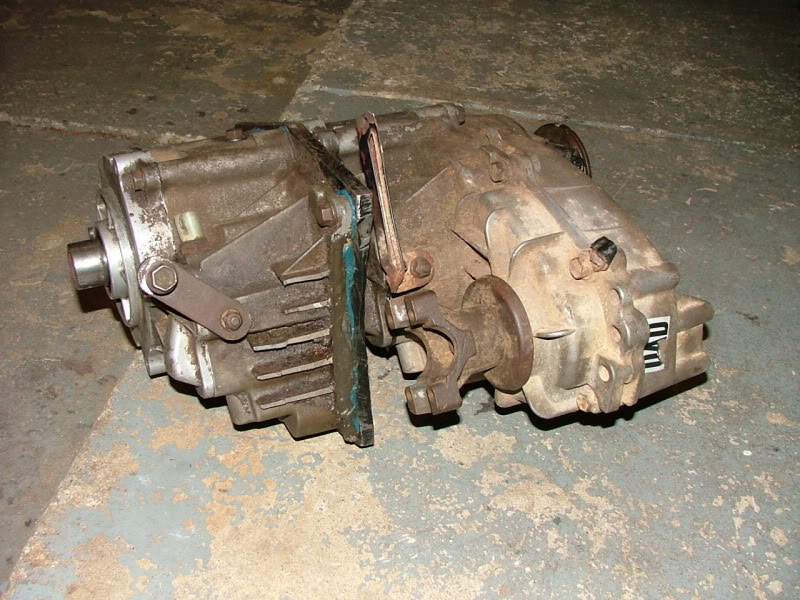

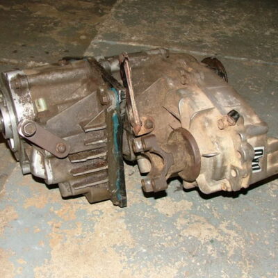

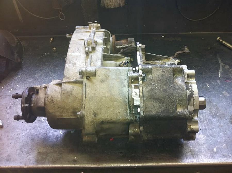

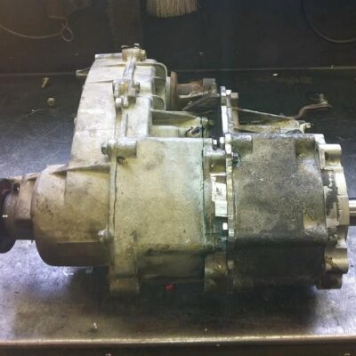

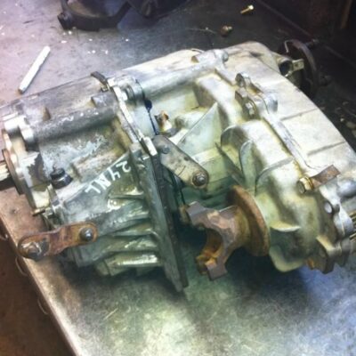

BW1350-1356 Transfer Case Doubler
Doubler transfer case (Two transfer cases mated together to reduce the gearing for a better crawl ratio)
