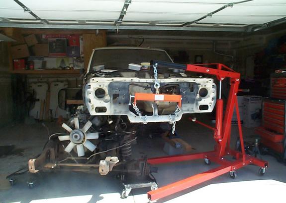

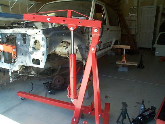

Next: Lift the body. For this I used my engine hoist. Remember: you’re lifting sheet metal, so unless you plan to replace it, set up a sling to distribute the weight.

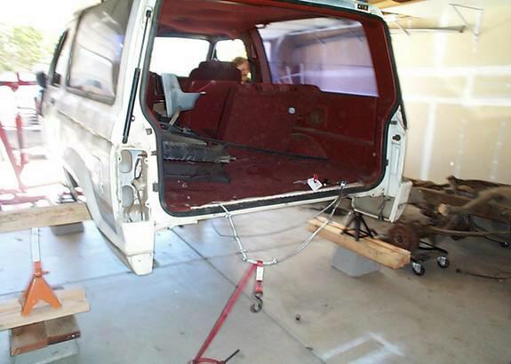

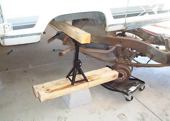

I used concrete deck footings, 4×4 posts, and jack stands. I know, not great, but with a little caution it can be done.
Bronco II body supported by jack stands
Ford Bronco II body supported by 4x4 wooden posts
You’ll notice that I also used vehicle dollies. These things are worth the cost and make life so much easier. To lift the back, I ran a 3/16 “wire rope” through the mounting bolt holes, to from a sling. Due to the overhead restrictions of a finished garage, I wasn’t able to pull the chassis straight out the front. However, I had tons of clearance to swing the engine out under the front right wheel well. With the front supported by the hoist and a jackstand on the left front cab support, I pulled the right front jackstand and swung the engine through the right wheel well. Then I replaced the right jackstand once the chassis was clear.
Moving the bronco with a shop crane / engine hoist

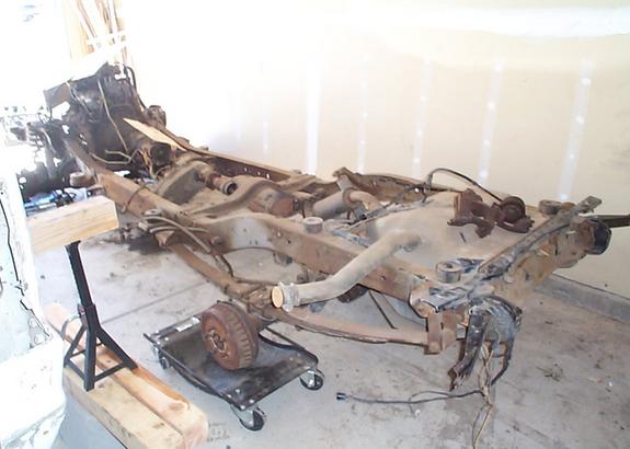

So now I have completely separated the body and the chassis. The only help I had was my 16 yr. old daughter acting as a spotter.
Ford Bronco II frame and chassis
