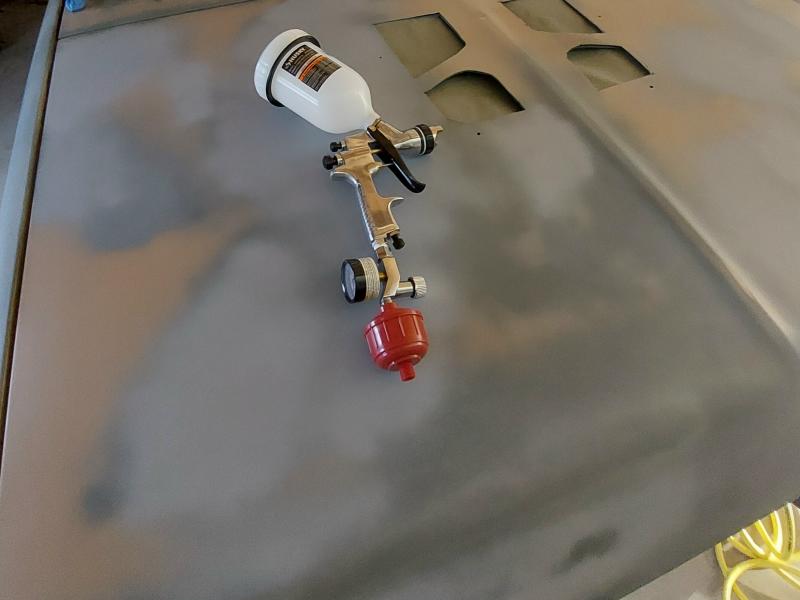

I will be painting the vehicle with a Husky HVLP paint gun that I got from Home Depot.

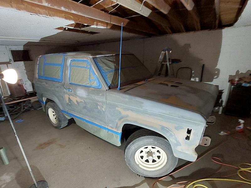

I washed the truck with Dawn dish soap and then brought it into the shop.
I removed the bumpers, grill, lights and all of the trim except for the XLS moldings along the sides. I was concerned that I would damage the molding. Especially since it seems to have an adhesive holding it place. And since it’s in good shape and not loose, why take the chance.

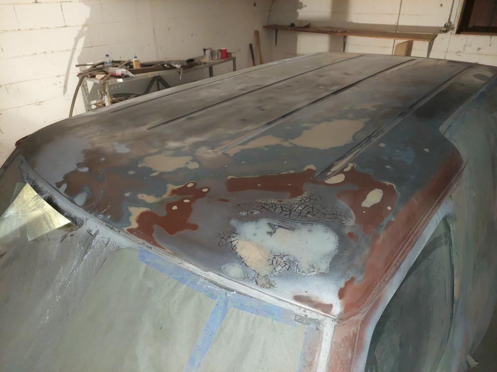

The rusty areas were sanded down with 180-grit sandpaper. I fixed the more noticeable dents with Bondo, but not all of them.
I used 220-grit and then 320-grit to sand down any rough areas and to feather the paint and bare metal so it all blends.
I had to use a wire wheel to get the seam sealer out of the drip rails above the doors and remove the rust that was under them. They got a coating of rust convertor before getting a now coat of seam sealer.
I used rusty metal primer on a few bare metal spots that still had dark areas in the metal after I sanded them, and self-etching primer on all other bare metal areas. I used filler primer over the sections that either had minor imperfections or Bondo work.
I went over the whole vehicle with a 360-grit scuff pad to make sure that the new paint would have a surface to bite to.
Finally, I wiped the vehicle down with wax and grease remover.

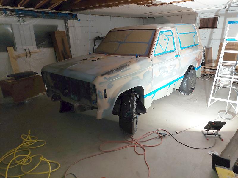

I covered the windows and the XLS molding with masking paper. DO NOT use newspaper. Paint can soak through newspaper. I covered the wheels and tires with some plastic yard trash bags.
cleaning and masking for paint
Masking the windows and other areas before paint
Ford Bronco II cleaned, prepped, and masked for a Rust-Oleum paint job

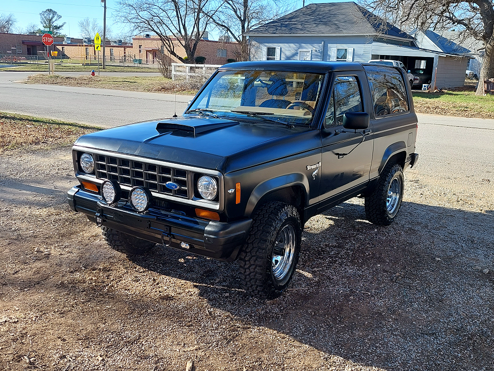

The XLS moldings were a plastic rubber type of material, so I chose to not paint them when I painted the vehicle because I didn’t know how well the paint would adhere to them. After the paint had cured for a day or two, I masked above the moldings and painted them with Krylon Fusion Satin Black. I could have used Rust-Oleum Painter’s Touch 2X Satin Black, but I already had the Krylon.
I also painted the plastic end pieces for the bumpers (I removed them) and all of the trim that I removed from around the windows satin black as well.
Painting The Bumpers, and Tire Carrier

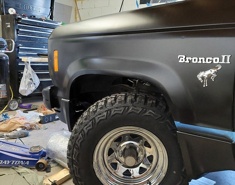

The bumpers and tire carrier were repainted with Rust-Oleum High-Performance Enamel Gloss Black.
Stripes and Emblems
I bought some new Bronco II and Ford emblems and used a vinyl cutter to make new gloss black XLS stripes to go down the side of the vehicle. They’re hard to see in the photos but look great in person. I also added a hood scoop and a set of glass black racing stripes that go up to it.
New Bronco and Bronco II emblems

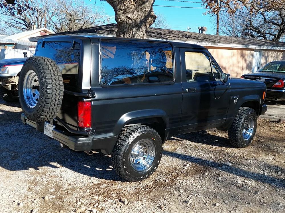

Ford Bronco II Rust-Oleum Paint Job - Finished
Interested in the round headlight conversion? Check out: Round Headlights On Your Bronco II
Ford Bronco II Rustoleum Paint Job - Right Rear

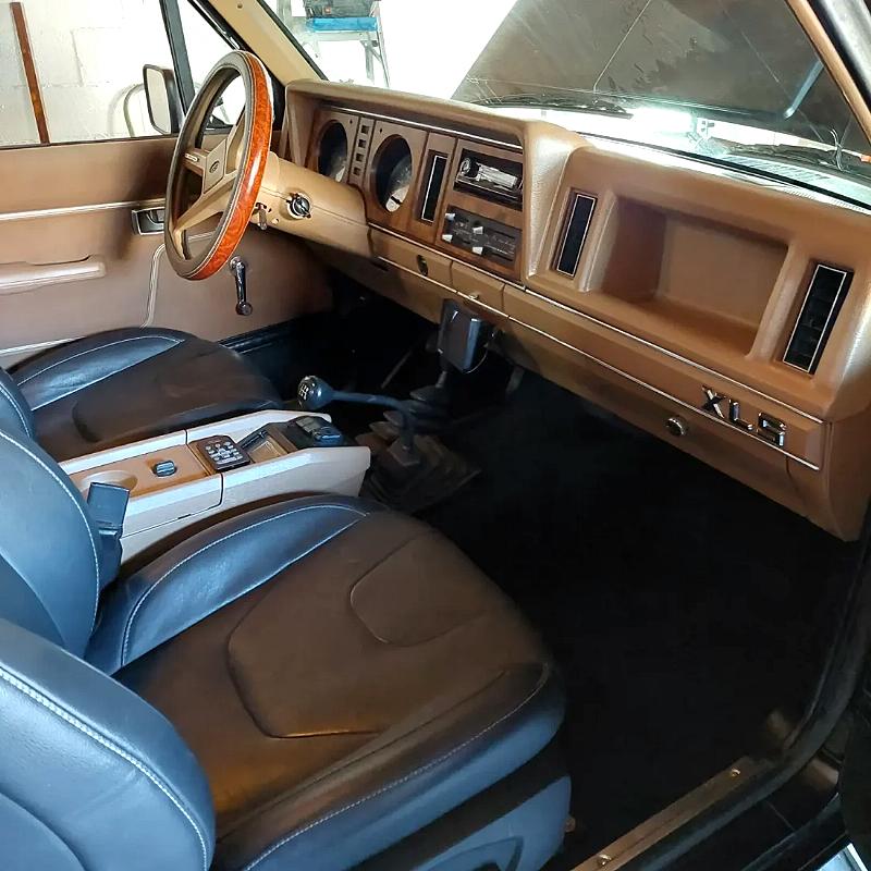

I wasn’t trying to make this a ‘Rust-Oleum’ build, but I ended up completely redoing the interior and painting the dash, console, and all of the panels with Rust-Oleum Painter Touch Satin Nutmeg because it was an almost exact match to the original interior color.
