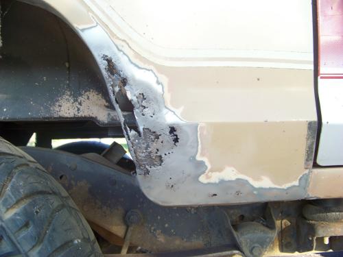

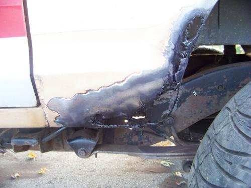

The Bronco II Project had some serious bubbles in the paint around the fender wells. The best way to address it was with media blasting. It’s easy to do with an economical media blasting kit, and an air compressor. The best part about media blasting is that it will remove the rust without removing good solid metal. Also, you don’t have to deal with the rusty edges ripping your sandpaper, or a grinder grinding away good metal.

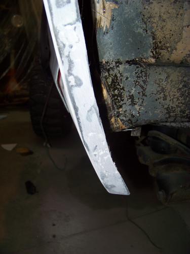

Here you can see the front of the wheel well on the driver’s side. This photo was taken right after I media blasted it.

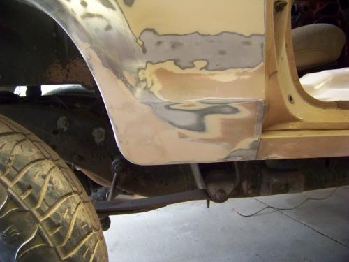

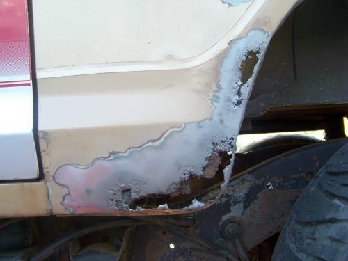

Rear quarter panel rust
After I blasted the area, I sprayed the area with Dupli-Color Rust Fix and let it set for 24-hours. According to Dupli-Color, Rust Fix destroys rust on contact by bonding and transforming it into a sandable and paintable surface. It sprays on clear and transforms into a black, metal protecting coating, that prevents future rust from forming.

Even though I blasted the area, I was still concerned about any rust that may have been left, especially on the back side of the metal. I sprayed both sides making sure that I got the back side of the panel from inside of the wheel well. I let the Rust Fix sit for 24-hours as directed.
Before continuing, I sanded the surface back off before starting the repair work. Although it looked like I had blasted all the rust, I wanted to make sure that I had gotten everything (especially on the back side) and that rust wasn’t going to return.

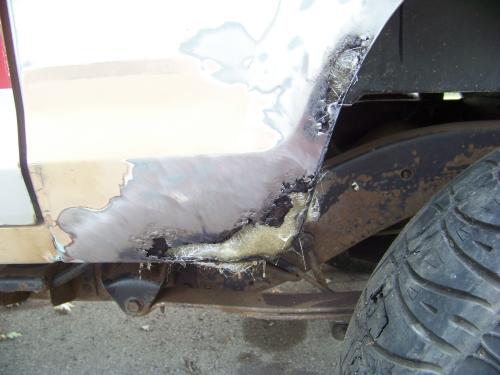

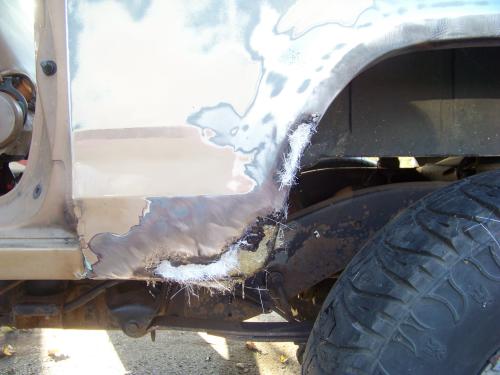

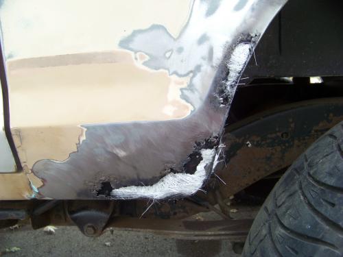

I took some fiberglass mat and applied it to the back side of the sheet metal. You want to build it up from the back. If you apply it on the front, the surface will become too thick. You have to remember that if you add a patch to a surface, you have to use a filling compound to smooth it out, so you don’t have a ‘hump’ in the surface. The thicker the patch, the more you have to taper the filler out so it’s smooth and flat. Patching it from the back, I only have to fill and smooth it level with the front of the panel.
Before doing the work, I actually tapped the edges of the rust holes in so they would be below the surface when adding filler and sanding.
Adding fiberglass
You can’t just put body filler in the holes to fill them up. The fiberglass mat is put in place, and then resin is brushed over it.
adding resin
There are actually (2) sheets of metal here. With the interior out, you can see down into this space where the metal comes together. I was able to put fiberglass down into this opening from inside the Bronco II. The photo below was taken before I applied the resin. I added several coats of fiberglass and resin to make sure I had a strong repair.
adding more fiberglass

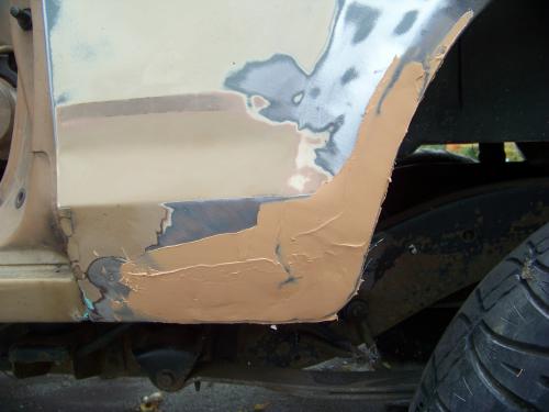

You can see where I filled in the area over the hardened fiberglass mat with the Bondo-Glass and then sanded down the high spots. The dark spots show the low area, but they’re shallow enough to be able to be filled with normal body filler.
From there, regular body filler was used the smooth the area.
Adding regular body filler

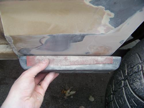

It’s important that you use a long sanding board to get a flat, straight surface. The board below is not my longest, but good for the small size of this area.
Long sanding board
A few more light coats of filler and a lot of sanding, and it was finally flat and smooth. The photo above doesn’t show the finished work before it was primered.

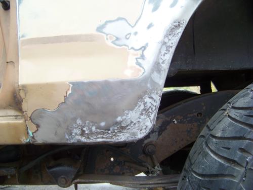

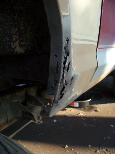

The front of the wheel well on the passenger side had a bad rust spot as well.
Drivers side rust
Drivers side fender rust holes
I won’t go through much detail on this side, but I repaired it with fiberglass, resin, Bondo-Glass, and body filler just like I did on the driver’s side.

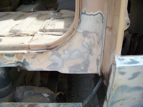

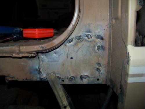

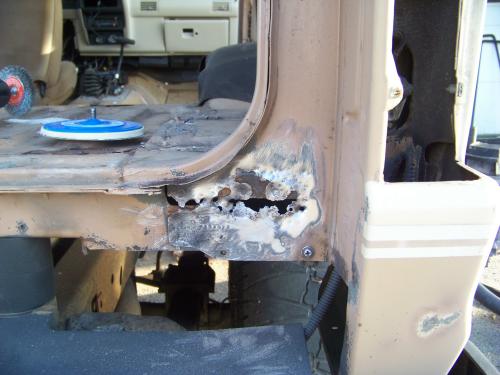

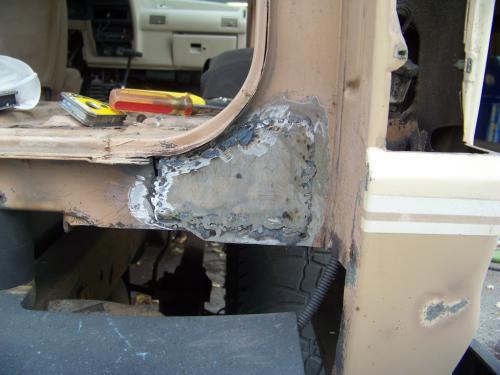

The rear of the Bronco II had a rust hole in the lower right corner inside the opening for the rear lift gate. I feel that this spot has more structural importance, so I’m going to patch it with some sheet metal and a MIG welder.
Rust hole
I cut a piece of sheet metal and then tacked it in place. I used one of those less expensive Campbell-Hausefeld MIG welders for the repair. I just did a series of tack welds moving from opposite sides with each weld, so I didn’t overheat the metal and warp it.
Welding in a patch
Once I had the piece welded in, I grinded down the welds with a grinder to smooth it out. You have to make sure you don’t grind them down to the point that you break the weld.
grinding it smooth
Once the welding and grinding was done, I used some body filler to get everything smooth.
Smoothing with body filler

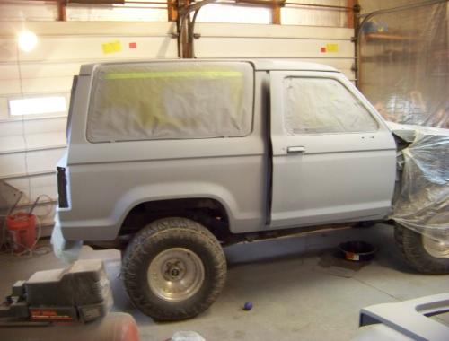

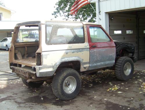

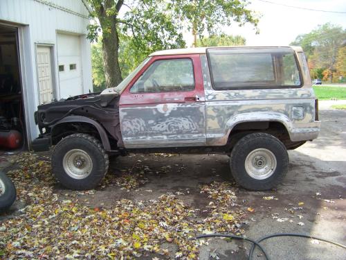

The Bronco II is finally sanded and ready for primer. The original doors were too rough and were replaced with some newer rust-free ones. The new ones have power windows and locks. A nice upgrade. I also bought new fenders. That’s why there’s no front fenders on it.
Sanding the body
Body sanded and ready for primer

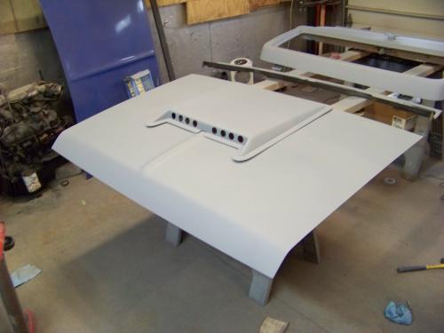

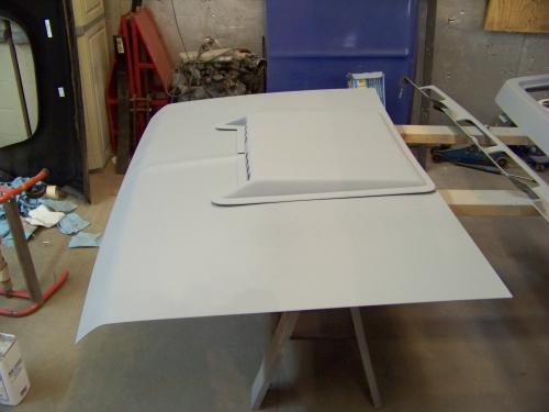

My wife got me this hood scoop from Summit Racing. I had to cut a notch in the front to go over the hump in the hood. I also cut the holes in to the front to let air enter and cut a huge hole on the hood under the scoop. I primered and painted the hood and scoop separately. I just sat it on here to see how it was going to look.
hood scoop
Hood with hood scoop

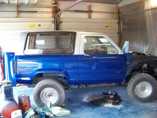

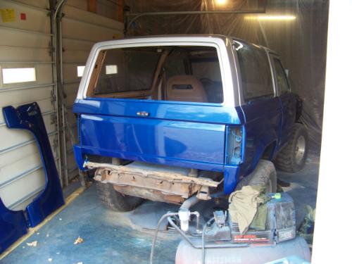

The Bronco II was painted with Nason Ful-Cryl II acrylic enamel using Evercoat Wet Look hardener. This is a single stage paint which means it doesn’t require a clear coat to be shiny. I masked the Bronco II off and painted the top silver and then waited (2) days before shooting the blue.
new paint job
Passenger side view of new paint
I’m going to let the Bronco II sit in the shop for a couple of weeks before re-assembling it. Fresh paint can chip easily, so I want to make sure it has plenty of time to cure and harden up.
