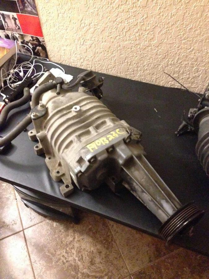

In May 2015, a TRS forum member started a thread titled “Supercharge your 3.0 Vulcan for cheap.“
He wasn’t just talking about the idea. He had designed an Eaton M90 intake adapter using Mastercam and was working toward having it machined.
At the time, he estimated that an existing commercial M90 adapter, combined with the other parts required, could approach $1,000 before all of the supporting modifications were considered. His goal was to design something that would use readily available parts and bring the cost down.
His proposed combination used an Eaton M90 Gen V supercharger with a bypass valve, Taurus 3.0L fuel rails and a custom intake adapter. He had found used supercharger and fuel-rail components for around $300 or less and estimated that the complete basic supercharger installation could potentially be assembled for under $1,000.

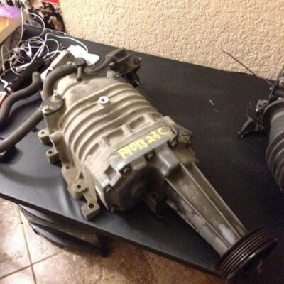

M62 or M90?
One of the more interesting discussions in the thread involved whether an M90 was actually the right supercharger for a 3.0L.
Don4331 ran the numbers for approximately 6 psi of boost using a 150-hp 3.0L as his starting point. At sea level, 6 psi of boost gives a pressure ratio of about 1.42.
Using an estimated M90 efficiency of 77.5 percent at the airflow and pressure ratio he expected from the 3.0L, he calculated an ideal temperature increase of about 55°F and an actual increase of roughly 71°F after accounting for compressor efficiency. That worked out to an estimated air-density ratio of about 1.25.

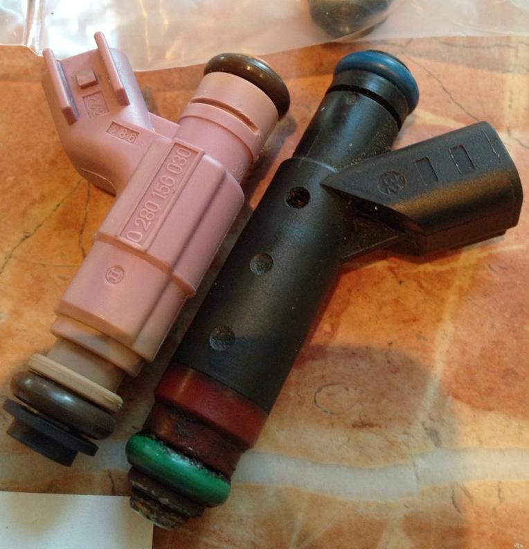

During the M90 project, the builder upgraded to 52 lb/hr high-impedance EV6 injectors. He chose the shorter injectors partly because they allowed him to lower the fuel rails to accommodate the installation. He also planned to use a larger fuel pump.
Those parts were chosen for the particular project and intended power level. They shouldn’t be interpreted as a universal injector or pump requirement for every supercharged 3.0L.
The important lesson is that fuel capacity has to be matched to the engine’s actual airflow and power target.

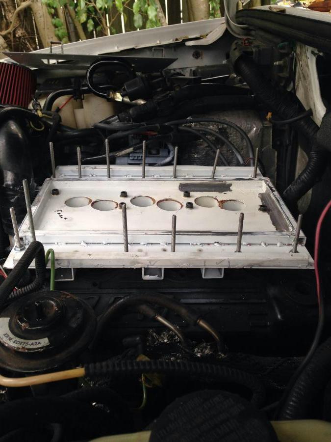

Building the Intake

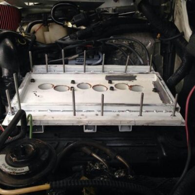

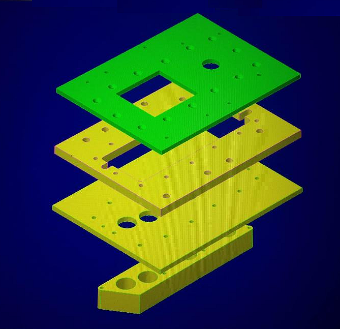

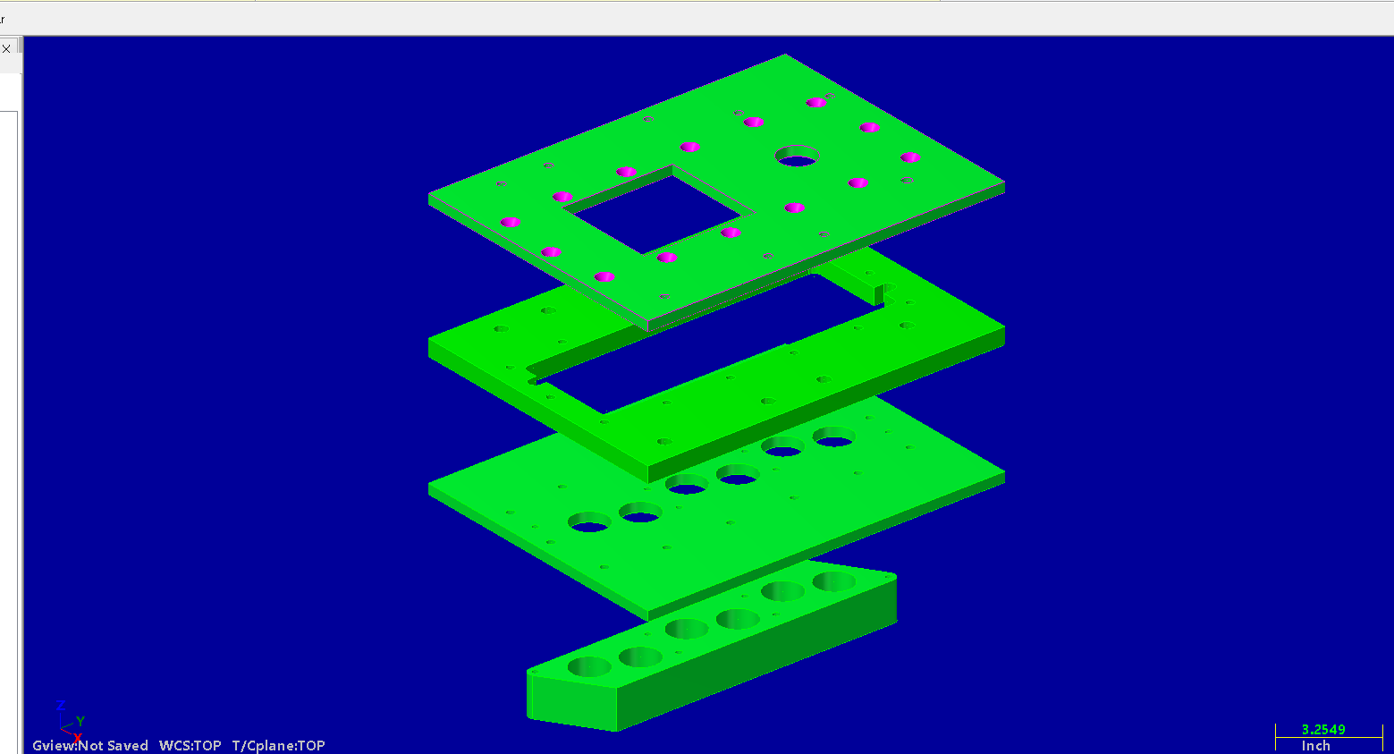

One of the most interesting parts of the thread is that oodannyboyoo didn’t just talk about bolting a supercharger onto the Vulcan—he actually started designing the adapter required to make it happen.

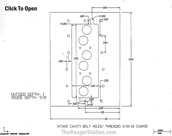

The intake adapter was drawn in CAD/CAM and was intended to mate the Eaton M90 to the 3.0L intake.
Intake Drawing #1
An initial prototype was built, but it didn’t work out. The prototype revealed problems with fitment and serpentine belt alignment. The thread includes photographs showing the prototype and the problems encountered during the process.
Rather than abandoning the project, oodannyboyoo went back to the drawing board. He continued refining the design, creating stencils and checking alignment, tolerances and clearances before committing to the final machining.
Revised Intake Drawing #2
Eventually, he released the final intake drawing so that others could use it as a starting point for fabrication.
Final 3.0L supercharger intake drawing PDF
The drawing doesn’t turn this into a bolt-on kit. It still requires someone capable of fabricating or machining the part and verifying the fit on their particular engine and supercharger combination.
But having a usable design eliminates one of the biggest hurdles in attempting a project like this.

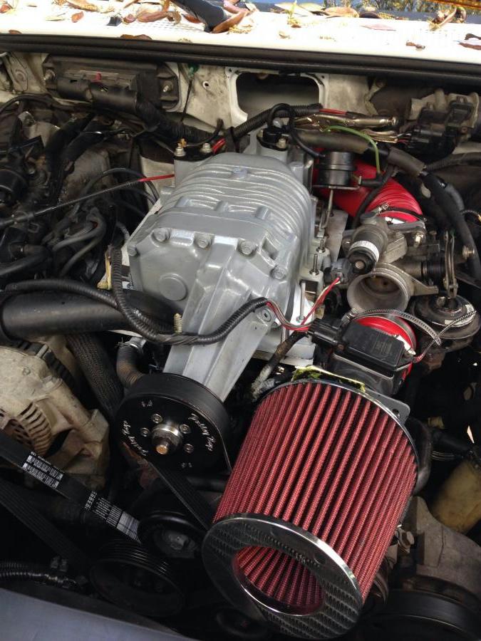

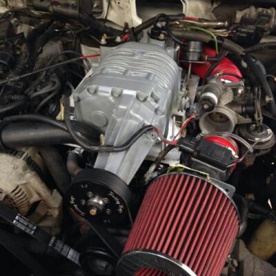

A Real Supercharged 3.0L Ranger
If you want to see what a supercharged 3.0L Ranger actually looks like, you don’t have to imagine it.
TRS member stmitch built one.
His 2000 Ranger eventually received a Whipple supercharger along with a substantially modified 3.0L. The engine received ported and polished heads and lower intake, 1.8 roller rockers, upgraded valve springs, ARP head studs, 42 lb/hr injectors, a Cobra fuel pump and supporting modifications. The truck was also converted from an automatic transmission to a 5-speed manual during the project.
The build took years and included plenty of problems along the way, including valve-cover clearance, wiring, cooling and tuning issues.
It is a much more involved project than the inexpensive M90 concept discussed above.
But it is also valuable because it actually happened.
You can see the truck and follow its build in our feature:
Stmitch’s Supercharged 3.0L 2000 Ford Ranger
