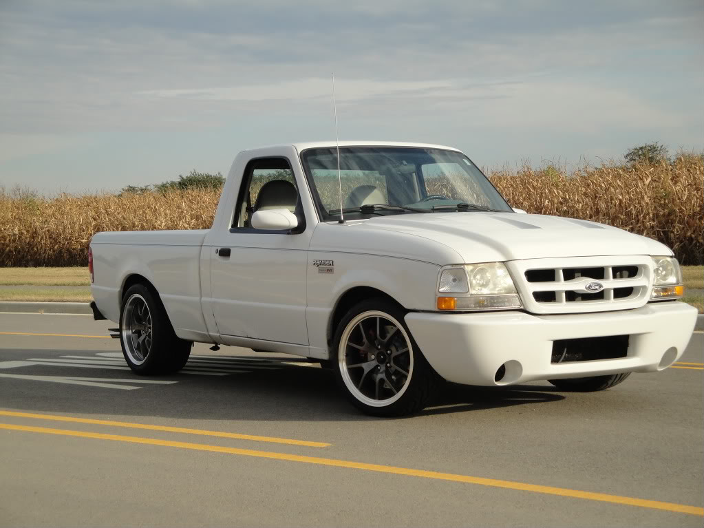

Stmitch’s Ranger started out as a clean 2000 regular-cab 2WD in Oxford White. Even before the major engine build, it was far from stock.
The truck had a lowered stance courtesy of a DJM 4/5 drop kit, with Doetsch Tech shocks and Roush front and rear sway bars. Mustang Cobra brakes were fitted at all four corners, with 13-inch Cobra brakes up front and 11.65-inch units in the rear.
The wheels were anthracite FR500s, measuring 18×9 in front and 18×10 in the rear. BFG KDW tires filled the staggered setup with 245/35R18 tires up front and 295/35R18 tires in the rear.
The combination gave the Ranger the proportions of a proper street truck without making it look like a collection of aftermarket parts.

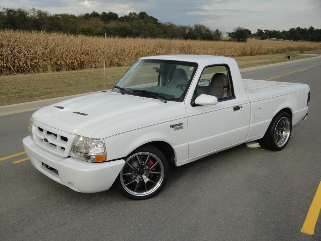

The exterior modifications were centered around giving the Ranger a more aggressive appearance while keeping the overall design clean.
A custom 2003 Mustang Cobra-style hood became the most noticeable change to the body. A Keystone bumper cover and Street Scene mirrors complemented it, while projector headlights and clear corner lights updated the front of the truck.
The grille and rear bumper were color matched, and SVT badges added a subtle connection to the Mustang components used elsewhere on the truck.
The result wasn’t an attempt to make the Ranger look like something it wasn’t. It was still clearly a Ranger, just a very carefully modified one.

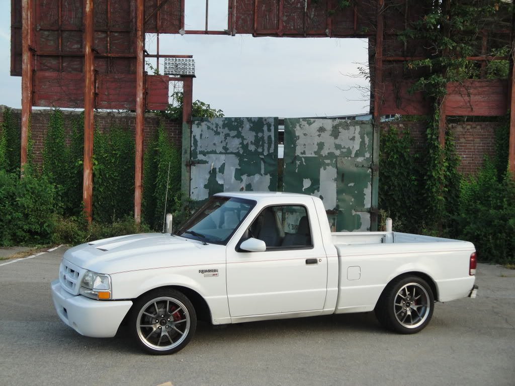

Suspension, Wheels and Brakes
The truck’s stance came from the DJM 4/5 drop kit, combined with Doetsch Tech shocks and Roush sway bars.
The brake system was upgraded substantially as well. The front received 13-inch 2003 Mustang Cobra brakes with drilled and slotted rotors and custom braided stainless-steel lines. The rear used 11.65-inch 2003 Mustang Cobra brakes, also with custom braided stainless-steel lines.
The staggered FR500 wheel setup completed the look. The 18×9 front wheels carried 245/35R18 BFG KDW tires, while the 18×10 rears carried much wider 295/35R18 tires.
These chassis upgrades were already part of what made the truck special before the Whipple installation. The supercharged engine was added to an already well-developed street truck rather than starting with a stock Ranger.

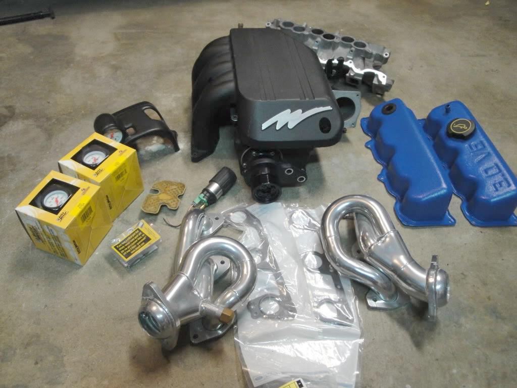

The Whipple
The Whipple was the centerpiece of the new engine.
The supercharger had been acquired used, and Stmitch continued working through the details of adapting it to the 3.0L. The engine was assembled with the blower installed in October 2012.
It wasn’t completely trouble-free.
The supercharger interfered with the valve covers, forcing him to change them before the engine could go into the truck. Once that problem was solved, the engine was ready for installation.
