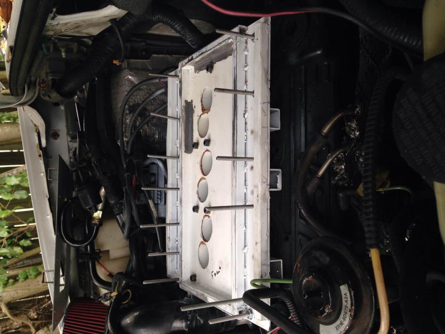

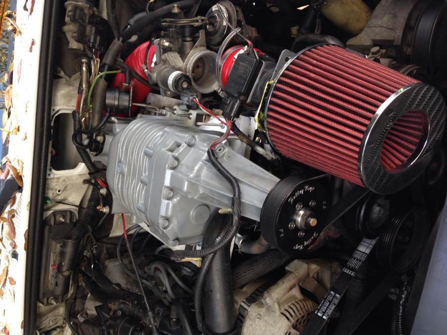

Hey this is my first time posting here as I have never really felt the need to post until now. I’m not going to give a biography but I am a student at my local university in south florida working towards becoming a mechanical engineer in the automotive industry. I don’t have a whole lot of free time between school and work, but have managed to just finish up building an Eaton m90 supercharger intake on MasterCam. I haven’t used mastercam since high school but this is what I really want to get into as a career. I guess it’s safe to say this is one of my hobbies.
Regardless I am really here not only to demonstrate that the Vulcan engine can not only be supercharged, but for cheap! As of now your only option as a 3.0 owner is Tom Morana racing for an m90 adapter. Which is well close to 1,000$ and more since youll need custom fuel rails and an older generation eaton m90 supercharger. Not to mention when talking to Mr Morana, his measurements and clearances were not on par with the engine bay on my truck and would require extensive cutting to get to work. Once I get this milled out this summer and tested, I will, if the demand is present, sell or simply give away the master cam files so you can send off it off to your machinist. My machinist quoted me 500$ to get this milled out but I have yet to confirm that. With my design and if all my measurements are correct you should be able to use this intake with an Eaton m90
Supercharger generation V (with bypass valve), Taurus 3.0 fuel rails, and the intake itself. The supercharger and fuel rails can be found off ebay for as little as 300$ or less for both. With the intake combined youre looking at supercharging your ranger for less than a 1,000$ easy. However, I am still in the process of confirming all this. Now granted you will need to upgrade your fuel injectors, fuel pump, and ignition system. But with low boost you might get away without it.
Here’s a picture of the whole assembly, let me know what you guys think. Id love to hear your input and any advice you might have.

Pretty cool! The only thing I'd suggest, and maybe it can be an optional thing later on, is finding a way to incorporate a charge air cooler or water meth setup between the supercharger and intake manifold. The middle plate seems like the best option to me.
The 3.0 loves to detonate in stock form, and the Eaton builds a lot of heat. Having some way to cool the air charge would make tuning much easier, and make more power to boot. Otherwise, it seems like you've got a nice start going. I'm looking forward to seeing your progress.
That's something I will definitely consider. For my truck I made this with the intent of running nothing higher than 6 psi of boost, but thats still quite a hot amount of extra air even in an ideal situation. I really do like the idea of having some kind of cooling system within the cavity plate. Its 5/8" thick which leave me a fair amount of room to work with.
What do you think would be more effective at cooling the intake? Air cooled, or water cooled?

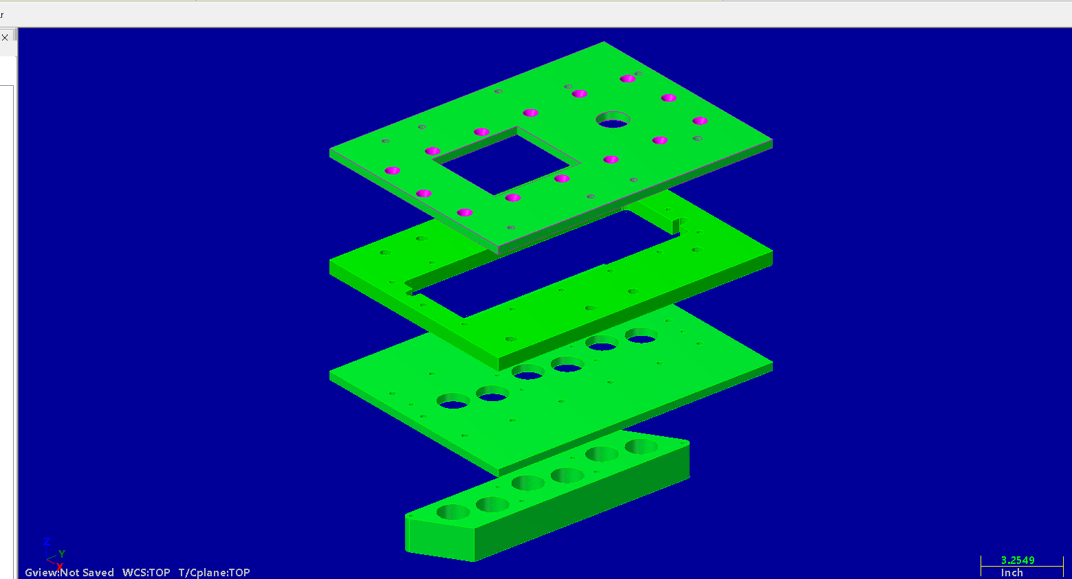

Prototype
One thing I forgot to mention is that I have made a prototype by hand out of steel. It didn't work and the serpentine belt came out of line, however I did get to hear the supercharger whine and get an idea for how it will sit inside my engine bay.

Don thank you for the information, I really appreciate it. As far as your math is concerned it seems a bit conservative and I do have some proof that might say otherwise. First being this website I based the m90s specs off of http://www.mscperformance.com/specpg2.html showing that the amount of power needed to turn an m90 at about 6,000 rpm and 5psi of boost is something around 10hp not 15hp. My harmonic balancer I believe is 4 inches in diameter and the pulley on the supercharger is a quickchange 3.6", doing the math when my engine is at around 5,500 rpm the supercharger is turning at 6,111 rpm. I know for a fact the m90 I have spin freely and is in good shape as I rebuilt it when I purchased it. To be honest, its much much harder turning the pulley, even though much larger, on my powersteering than it is on the supercharger and if it is true the supercharger is dragging away 10-15 hp looks like power steering removal is next on my list! hahahahaahaha
As far as boost to net hp is concerned I do know for a fact the whipple supercharger put out numbers similar to 80 hp and 90 or so torque on 8 or so psi. I believe it is safe to say, considering how much CFM the m90 puts out for such a small displacement engine like the vulcan, I have full confidence it will power this engine with ease. Something to note is I do have 1.8 ratio roller rockers and do plan on putting headers when I get the supercharger on assisting and amplifying the net gain of the supercharger. Personally heat is my main concern, as stock my upper aluminum intake gets very very hot after a long drive, so applying some kind of cooling system to the design is on my list for sure. I will more than likely mill out what I have now and test that it works then design the cavities for the coolant or air to flow through into the cavity plate and install some kind of intercooler/radiator with an electric pump.
As far as Tom is concerned I dont quite agree with his price on the means that his design would not work, his spacer for one offered is way to small and when asked he could only provide me a spacer of 1" when I need much more with the taurus fuel rails. His intake plate is also to long and will hit my fire wall and simply not fit. The box is way to high and will hit the roof of my hood. Simple put is not very easily compatible for the 1,000$ id spend. Hence why I decided to take the time to make it myself.
Personally, I will be happy to see close to 200 hp at the wheels. With the supercharger and other mods. I like the unique aspect of supercharging this reliable but slow engine, and considering it is my first truck, it has a bit of sentimental value. Hopefully I can get it up and running and share this neat mod with everyone
As for my highschool we did have access to MasterCAM and AutoCAD with some davinci 3 axis mills but we were only taught mastercam when I took engineer course there. Its my second year in college and will start the engineering program this fall but from what I can see some time in a year I should have some classes, and therefore access, to some larger machinery. For now I will rely on my machinist to mill this all out.
