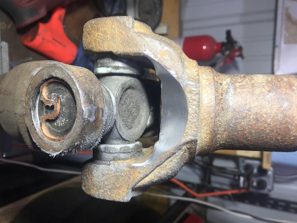

The initial problem was classic: the U-joint C-clips would “spit” out, allowing the caps to eject and the yokes to self-destruct. The owner attempted several stages of fixes:
  1. Full-Circle Clips: A significant improvement, but with 37s, the yoke ears eventually stretched, allowing the caps to walk.
  2. Welded Caps: Tacking the caps 50% into the ears lasted two years, but eventually, the metal itself reached its fatigue limit—snapping a yoke ear entirely off.

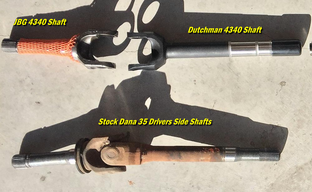

The Driver-Side Secret: The Dutchman Shaft
The foundation of a 30-spline Dana 35 is the driver-side inner shaft. Since no off-the-shelf 30-spline option exists for the TTB, a custom 4340 Chromoly shaft from Dutchman is required.
Precision: Unlike “import” shafts that suffer from core shift, the Dutchman shaft is fully machined. This provides critical clearance inside the knuckle, reducing the “witness marks” and binding that lead to snapped axle ears.
Dimensions: It measures 13.3125″ long. While the owner originally measured 13.265″, Dutchman cuts in 1/16″ increments, making the 13.3125″ the functional standard.

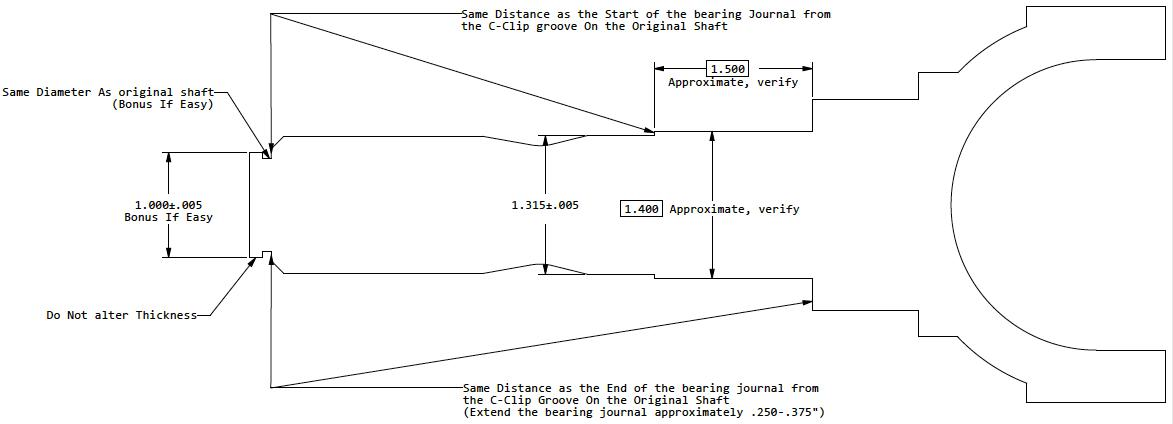

2. The Machinist’s Fix: Locker & C-Clip Interference
If you are using a 30-spline Yukon Zip Locker, a standard Dana 50 shaft will not fit without secondary lathe work.
Journal Interference: The “neck down” area on a Dana 50 shaft is significantly shorter than a Dana 35. The shaft will bottom out against the locker’s bearing journal before it can seat.
C-Clip Boss: The boss on the Dana 50 shaft is larger in diameter, which prevents the C-clip from seating in the side gear pocket.
The Solution: Provide your machinist with a stock Dana 35 shaft for reference. They must turn down the C-clip boss and extend the neck-down relief to match the D35 profile.

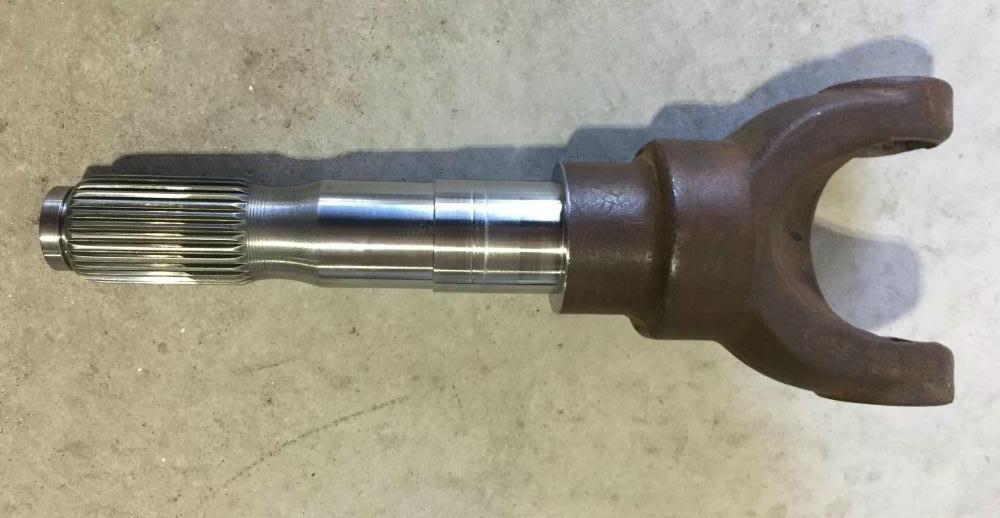

3. The Clearancing Requirement
While the move to Dana 50 parts is done for strength, the actual shaft diameter increase is a lesson in diminishing returns; the neck-down is only about .010″ larger than a stock Dana 35 shaft. The true gain is in the massive yoke. However, out of the box, the Dana 50 yoke is a liability—it will bind at just 20° of angle.
Manual Clearancing: You must carefully clearance the yoke with a grinder to achieve at least 28° of travel (be careful not to break through into the splines). Without this work, the center joint will bind and self-destruct during normal suspension cycling.

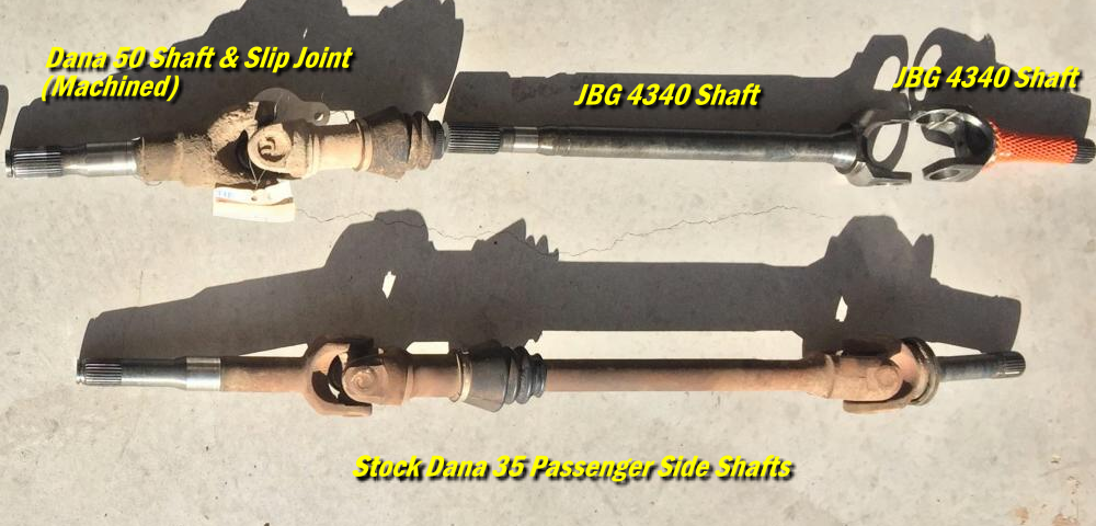

Achieving this level of strength requires a specific recipe of custom and repurposed parts:
  1. Driver-Side Outer: JBG 4340 Chromoly Stub Shaft.
  2. U-Joint: Spicer 5-760X with 30mm Full-Circle Snap Rings.
  3. Driver-Side Inner: Dutchman Custom 4340 Chromoly. (30-spline, 13.3125″ long, 1.315″ seal surface).
  4. Differential: 30-Spline Yukon Zip Locker (Jeep D35 application).
  5. Passenger-Side Inner: Dana 50 TTB Inner Shaft. (Turned down on a lathe to match D35 bearing/seal surfaces).
  6. Center Joint: Spicer 5-1350X. (Massive 1350-series strength with external snap rings).
  7. Slip Yoke: Dana 50 TTB Slip Yoke. (Clearanced for 30°+ angularity).
  8. Passenger Intermediate: JBG 4340 Chromoly Shaft.
  9. U-Joint: Spicer 5-760X with 30mm Full-Circle Snap Rings.
  10. Passenger-Side Outer: JBG 4340 Chromoly Stub Shaft.

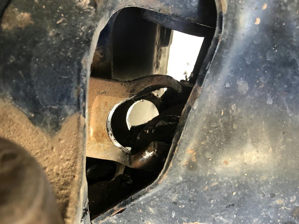

Despite the 30-spline Chromoly and 1350 joints, “El Chingón” eventually suffered another failure: a twisted 4340 ear at the knuckle. The diagnosis? Steering Bind.
Witness marks proved the shafts were physically prying themselves apart at full lock. This is the ultimate lesson: 4340 shafts and heavy-duty hubs (like the AVM XP) will hold 35s indefinitely. But with 37s and a doubler, even the “Super Dana 35” requires constant vigilance. If you see bind marks, adjust your stops—or accept that you’ve reached the absolute physical limit of the compact TTB platform.
