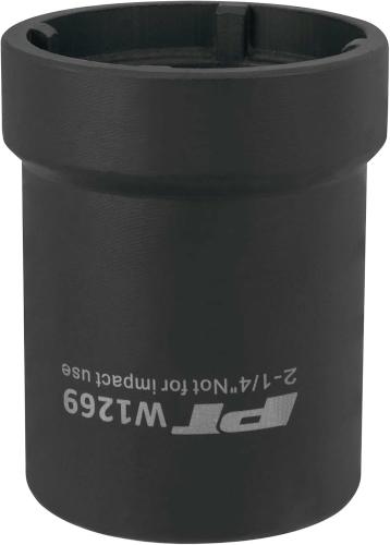

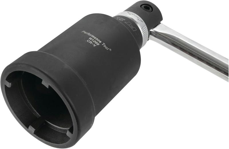

The Right Tool
The proper tool that you need is a Performance Tool W1269 1/2 in. Drive 2-1/4 in. 4-Slot 4WD Lock Nut Socket. The socket incorporates a reinforced outer lug sleeve that helps keep the tool from sliding off the spindle nut as your applying force to it.
