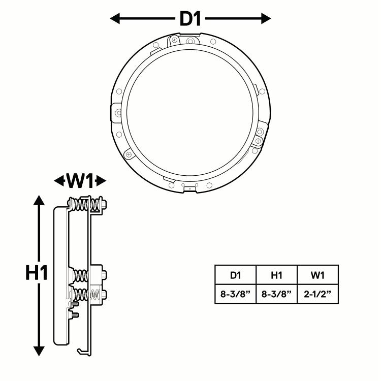

I found this 7-inch round headlight mounting ring on Amazon for $20.00.
Ford Bronco II Round Headlight Mount
Ford Bronco II Round Headlight Mounting Kit
Round headlight diagram

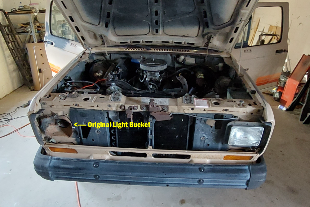

You can see the passenger side headlight removed and the original headlight bucket.
Ford Bronco II round headlight installation
Original Ford Bronco II rectangle headlight mount bucket

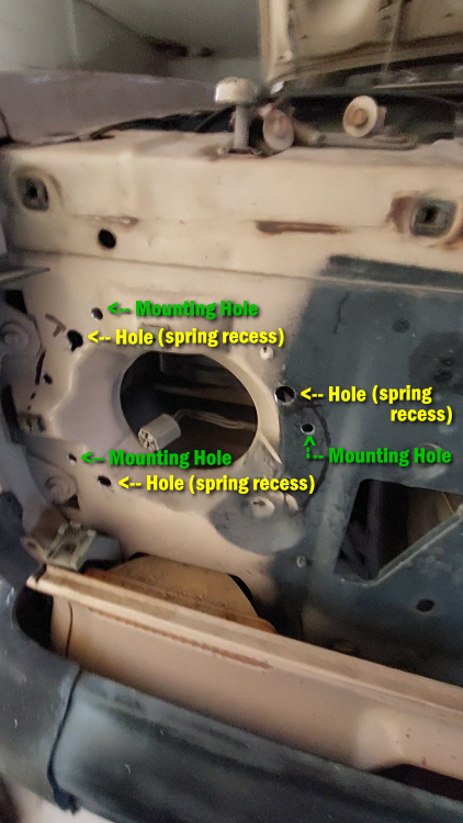

I used the mounting ring as a template, so I knew where to drill mounting holes.
Round headlight in mounting bracket
You can see the holes I drilled below. There are holes to bolt it to the body, and larger holes to allow the alignment springs to recess.
round headlight mounting points

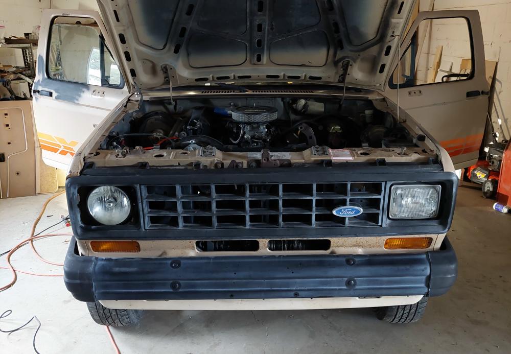

Below is what it looks like with both headlights in and the grill installed.
Ford Bronco II with round headlights
