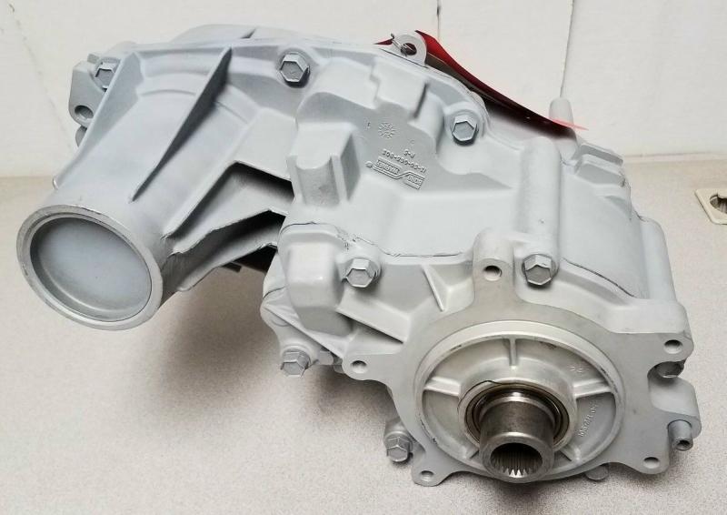

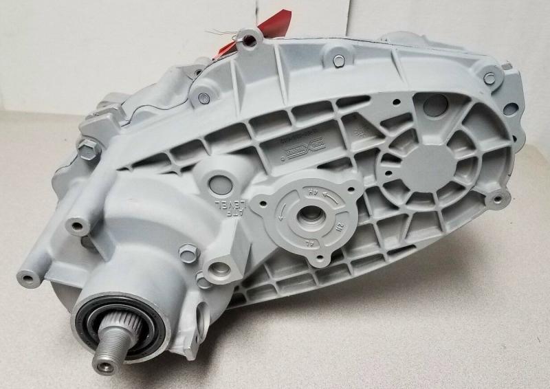

What the BW1359 Actually Is
The BW1359 used in 2WD Bronco IIs is essentially an empty BorgWarner 1350-series aluminum housing.
Internally, the unit is “gutted” compared to a true transfer case.
  • Aluminum case
  • Rear output only
  • 1:1 direct drive
  • No shift mechanism
  • Permanently sealed front output bore
Inside the case is a splined sleeve that connects the transmission output shaft directly to the rear driveshaft. There are no gears, no chain, and no low-range components.
Mechanically, the BW1359 functions as a drivetrain spacer and adapter, not a torque-splitting device.
Exterior view of the BorgWarner BW1359 dummy transfer case used on 2WD Bronco IIs
Rear output of BW1359 transfer case
