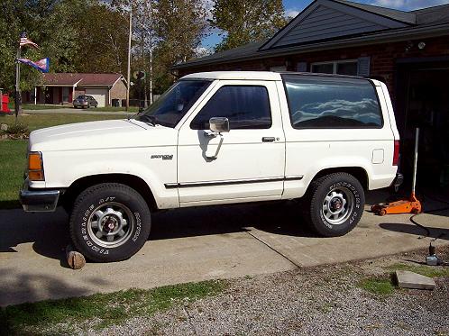

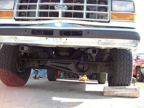

BEFORE: 2WD Bronco II:
Stock before photo

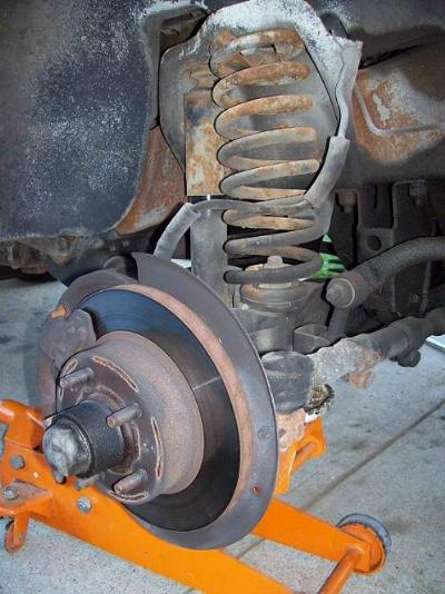

1. Start by jacking up the front of the Bronco II and support it on a pair of jack stands; I used one (1) jack stand under each front frame rail in front of the front suspension.

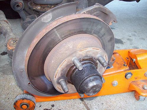

2. Remove the tires from the driver and passenger side of the front.

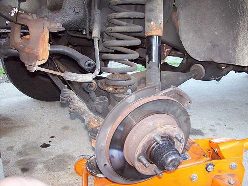

Wheel and tire removed

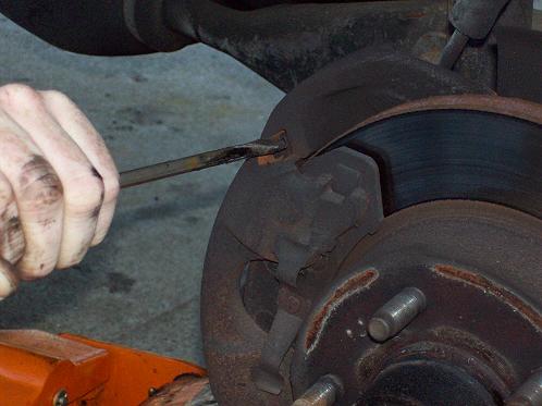

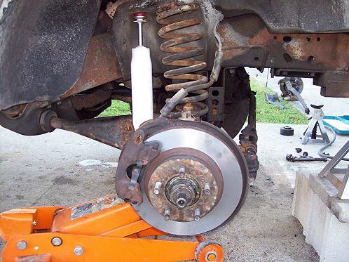

3. Knock the slide pins out of the brake calipers using a flat screwdriver and a hammer. Using wire ties, tie the brake caliper up to the frame. Be careful not to allow the brake caliper to hang by the brake hose.
Caliper removed

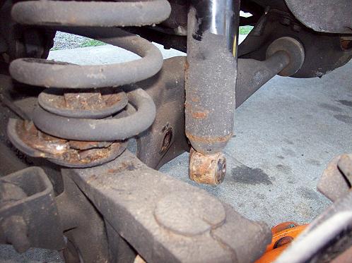

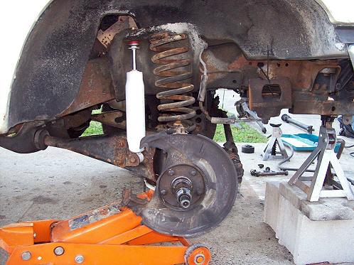

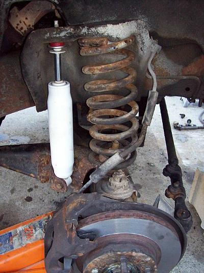

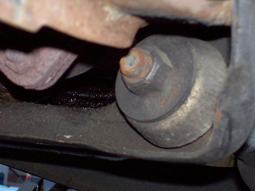

4. Remove the lower shock mount from the radius arm using a 1/2″ drive ratchet and a 3/4″ socket on one side and a 3/4″ wrench on the other. Allow the shock to hang free for re-installation, or remove if replacing shock. If you are removing the shock, the upper stud has a 9/16” nut that is needed to be removed.

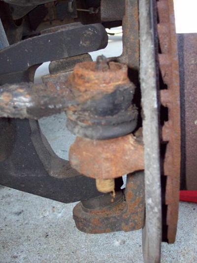

6. Remove the cotter pin in the tire rod end (TRE). Now remove the nut on the TRE using a 1/2″ drive ratchet with a 7/8” socket. Using the TRE separator, drive the TRE out of the steering knuckle. Place the TRE nut back on the TRE and lower it to the ground.

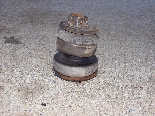

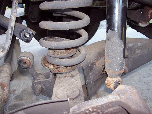

7. Remove the nut holding the lower portion of the spring onto the beam using a 1-1/8” wrench. Once the nut is off and the washer is removed, rotate the spring out of the coil bucket and lay it off to the side.
Spring removed

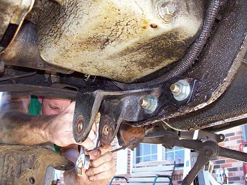

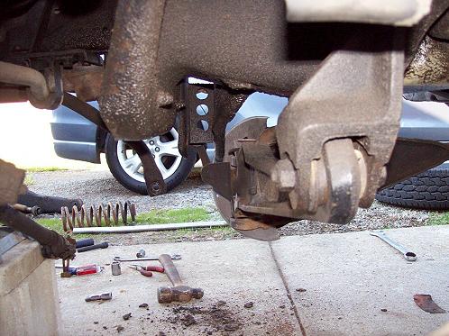

8. Remove the beam to bracket bolt using a 1/2″ drive ratchet with an 18mm socket on one side and a 18mm wrench on the other.
Beam removed

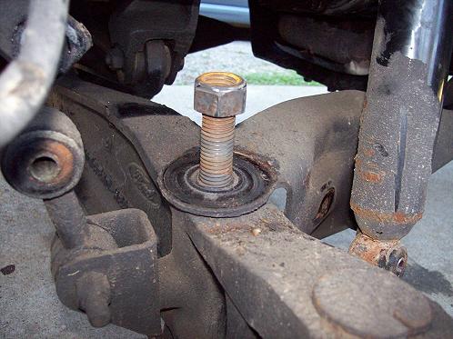

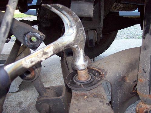

9. Drive the radius arm mounting bolt out of the beam with a hammer.

**REPEAT STEPS #2-11 FOR THE PASSENGER SIDE 2WD BEAM**
When finished repeating Steps #2-11 on the passenger side, you should have the front suspension completely out of the truck.

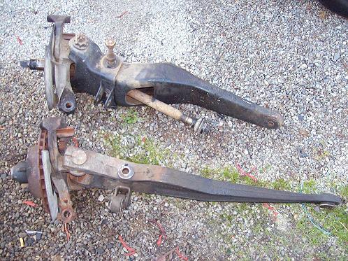

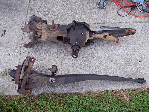

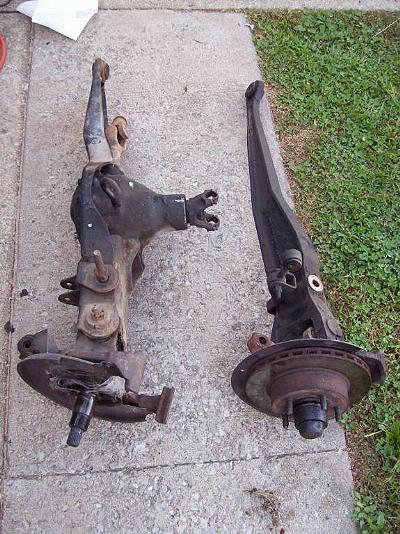

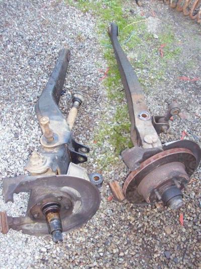

Not it is time to start putting the 4wd components in. Compare the 2wd to 4wd beam pictures (below) and then continue to Step #12.
4WD axle beam next to 2WD axle beam
4WD passenger beam next to 2WD passenger beam
2WD Passenger axle beam and 4WD passenger axle beam

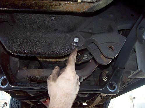

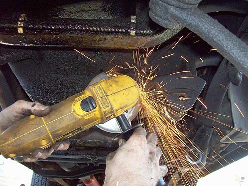

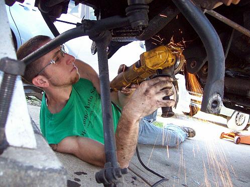

12. Using the angle grinder and cut off wheel, grind the rivet heads holding the passenger side beam bracket down flush with them bracket. Then use a big hammer to knock the bracket off the engine cross member. Once the bracket is off, use the same hammer to punch out the rivets exposing the holes.
grind rivets
head of rivet ground off

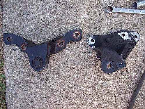

Notice the difference in the passenger side beam brackets (below). The 4wd bracket is on the left and the 2wd bracket is on the right.

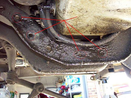

13. Now you need to clearance the holes circled in the picture below to 1/2” using a 1/2” dill bit. Those will be the holes you use to mount the 4wd bracket.
clearance the holes

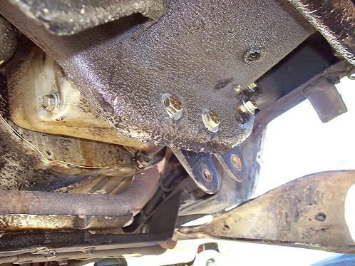

14. Mount the 4wd passenger side beam bracket using the 1/2”x1” bolts and hardware. Be sure to use a washer on each side of the bolt. The bracket goes on the rear side of the engine cross member. Remember to use the red thread locker on the nuts so they do not back off.
bracket bolted on

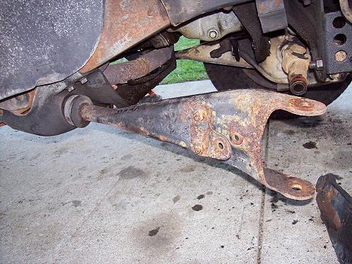

15. Install the 4wd radius arms. Be sure to get the proper one on the proper side so you will not have alignment issues. Make sure to put the bushings back on in the same way they came off and then tighten down the nut using the 1-1/8” socket.

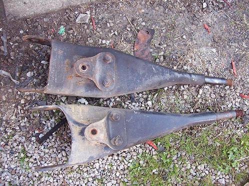

The top radius arm (below) is the 2wd radius arm.

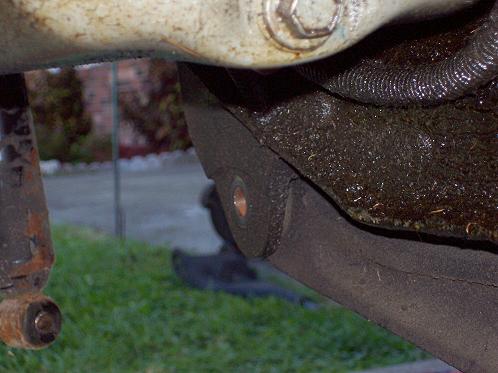

Since the 2wd beam is only about 5” thick and the 4wd beam is closer to 6-1/2” thick, you have to use 4wd radius arms

19. If you removed the rotors from the 4wd beams, see your repair manual on how to re-install those now.
20. Re-install the brake caliper onto the steering knuckle by driving in the slide pins.
21. Now either re-install the original shock, or install the new shock.
reinstall shock
shock installed
caliper installed

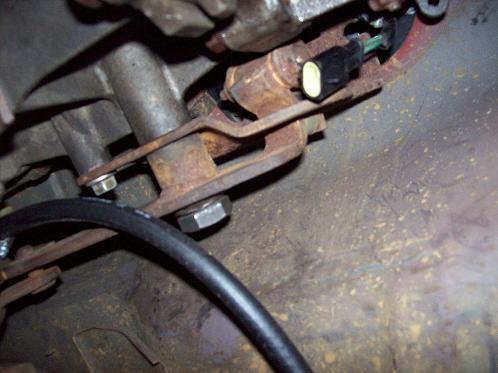

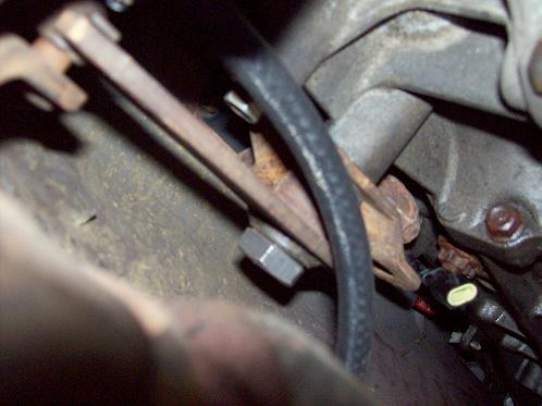

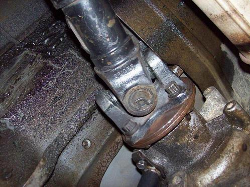

24. Using the 12mm 12 point socket, break the bolts on the drive shaft to transfer case flange lose. Then using a 12mm 12 point wrench, remove them the rest of the way and allow the drive shaft to hang from the rear end.
driveshaft and flange

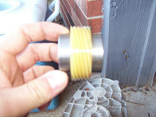

29. Remove the speedometer worm gear.
(You can now discard the dummy transfer case once it is off as it will NOT be used for anything and doubtfully anyone would want it.)

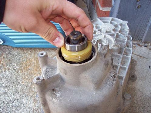

Look into the speedometer cable hole in the transfer case you are going to be using.
If the worm gear you just removed is the same color (either red or yellow) as the one in the transfer case, then skip to Step #36.
If not the same color, then continue to Step #30.

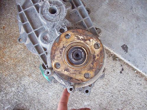

30. Remove the rear output flange, using the 1-1/4” socket, from the transfer case you are going to be using.
rear output flange

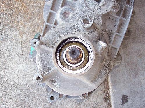

31. Remove the rear seal on the transfer case by prying with a screwdriver.
Output flange removed
32. Remove the speedometer worm gear.
Remove speedometer worm gear
33. Install the speedometer worm gear out of the dummy transfer case.

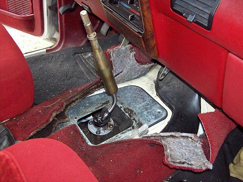

40. Pull the carpet back to expose the floor plate.
Remove the floor plate using a 8mm socket.
41. Remove the floor plate using a 8mm socket.

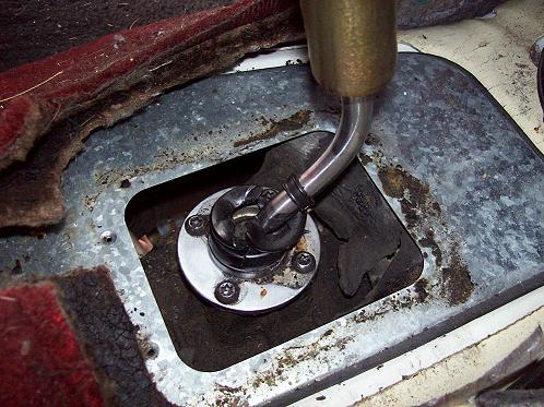

42. Now cut out a small section to allow the transfer case shifter to come into the cab and have full range of operation.
43. Install the transfer case shifter using a 1-1/8” wrench and a 1/2” wrench to bolt the shifter bolts to the transmission tail housing.

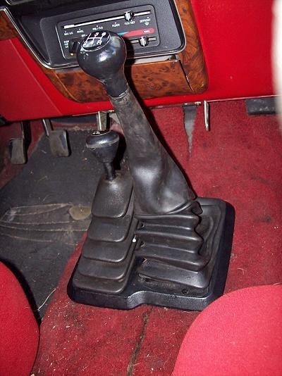

45. Install the new shift boot console that has the provision for the transfer case shifter.
