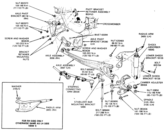

3) If you plan on keeping the stock suspension and not lift it, you’ll need the mounting bracket for the passenger side axle beam. The 4WD bracket mounts the pivot point behind the rear flange of the engine crossmember. The 2WD bracket mounts to the same holes but places the pivot point INSIDE the crossmember (See Axle Pivot Bracket 3K090 in diagram below).
a) If you plan to install a suspension lift when doing this swap, then all you’ll have to do is use the brackets in your lift kit.

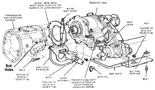

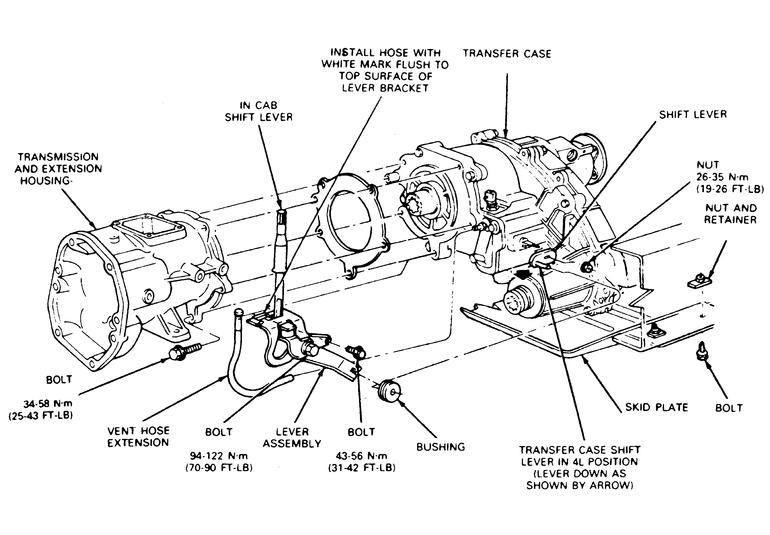

4) Install the transfer case shifter and linkage. The linkage bolts to the two holes on the driver’s side of the transmission tailhousing (see diagram below). Do not fully tighten them for now.

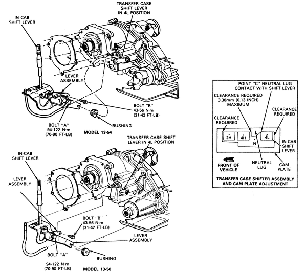

6) Linkage adjustment:
a) Put the transfer case into the low range position.
b) Then move the cam plate rearward until the bottom chamfered corner of the neutral lug just contacts the forward right edge of the shift lever. The lever linkage should be engaged into the shift linkage on the transfer case.
c) Hold the cam plate in this position and torque the larger bolt first to 70–90 ft. lbs. and torque the smaller bolt to 31–42 ft. lbs.
d) Move the transfer case in cab shift lever to all shift positions to check for positive engagement. There should be a clearance between the shift lever and the cam plate in the 2H front and 4H rear (clearance not to exceed 3.3mm) and 4L shift position.
e) Install the vent hose. The cam plate has a notch for this that the hose slips in to.

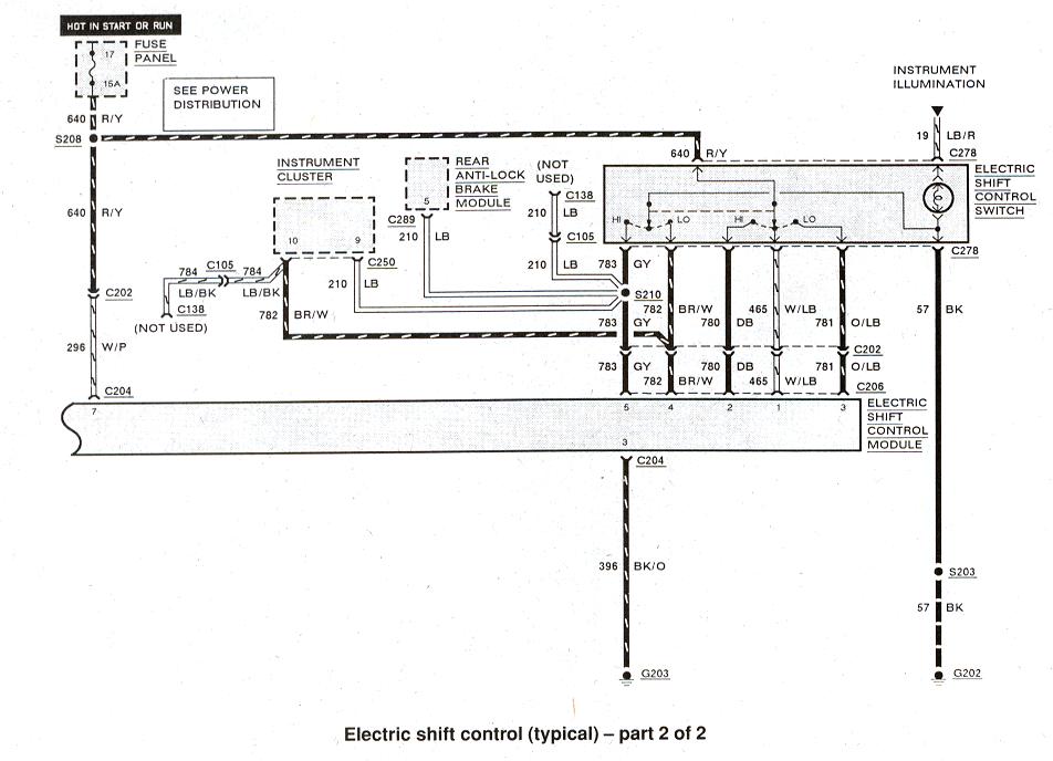

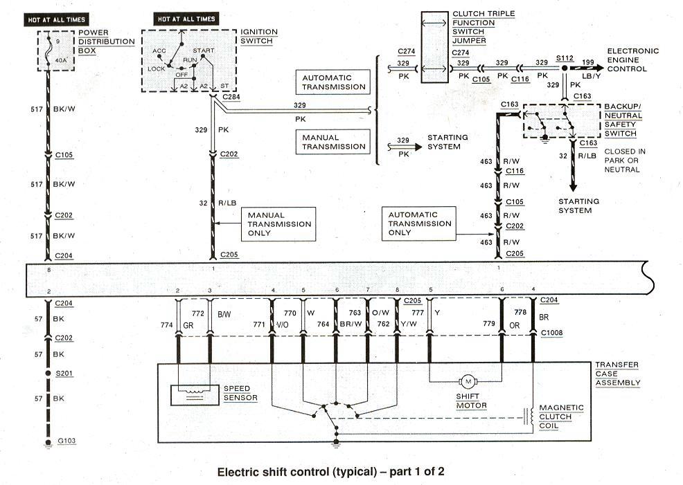

Below are diagrams of the electric shift control.
Electronic Shift Control Wiring Diagram 1
Electronic Shift Control Wiring Diagram 2
Wire Color
Purpose
Black Wire Ground
Black With Orange Stripe Wire From Electric Shift Control Module To Ground
Black With White Stripe Wire Hot At All Times To Electric Shift Control Module
Brown Wire Electric Shift Control Module To Transfer Case Assembly Shift Motor
Brown With White Stripe Wire Electric Shift Control Switch (4-Lo) To Electric Shift Control Module & Instrument Cluster. Also Electric Shift Control Switch To Transfer Case Magnetic Clutch Coil
Dark Blue Wire Electric Shift Control Switch (4-High) To Electric Shift Control Module
Gray Wire From Electric Shift Control Switch (4-High) To Electric Shift Control Module And Instrument Cluster
Light Green Wire Electric Shift Control Module To Transfer Case Speed Sensor
Light Blue Wire From Electric Shift Control Switch Gray Wire (From 4-High) To Instrument Cluster And Rear Anti Lock Brake Module
Orange Wire Electric Shift Control Module To Transfer Case Assembly Magnetic Clutch Coil
Orange With Light Blue Stripe Wire Electric Shift Control Switch (4-Lo) To Electric Shift Control Module
Orange With White Stripe Wire Electric Shift Control Module To Transfer Case Magnetic Clutch Coil
Pink Wire To Transmission Neutral Safety Switch
Purple With Yellow Stripe Electric Shift Control Module To Transfer Case Magnetic Clutch Coil
Red With Light Blue Stripe From Neutral Safety Switch To Starting System
Red With White Stripe Wire Neutral Safety Switch To Electric Shift Control Module
Red With Yellow Stripe Wire Hot In Start Or Run Position To White With Purple Stripe Wire To Electric Shift Control Module
White Wire Electric Shift Control Module To Transfer Case Magnetic Clutch Coil
Yellow With White Stripe Wire Electric Shift Control Module To Transfer Case Assembly Magnetic Clutch Coil
Yellow Wire Electric Shift Control Module To Transfer Case Assembly Shift Motor
