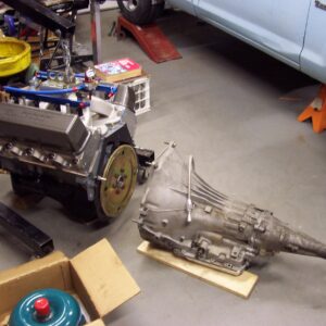

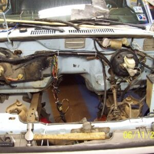

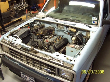

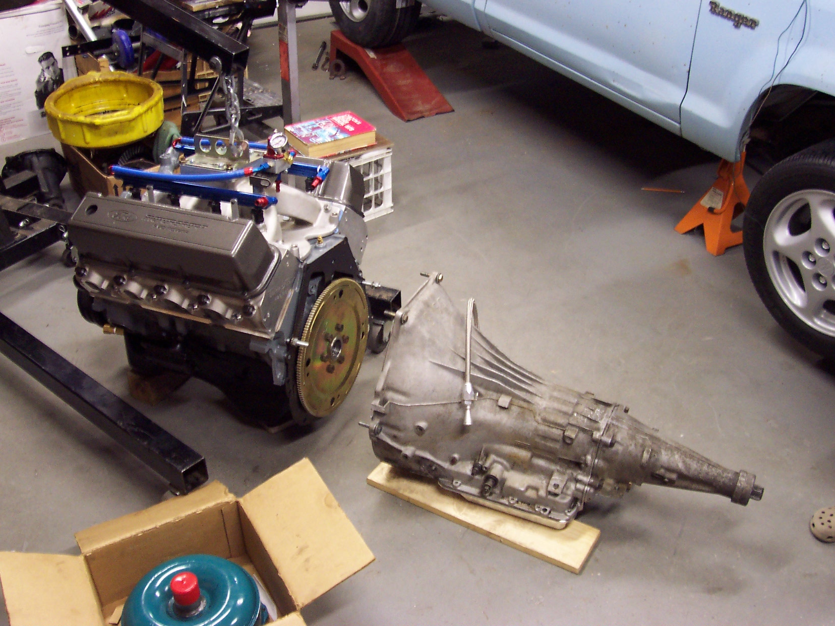

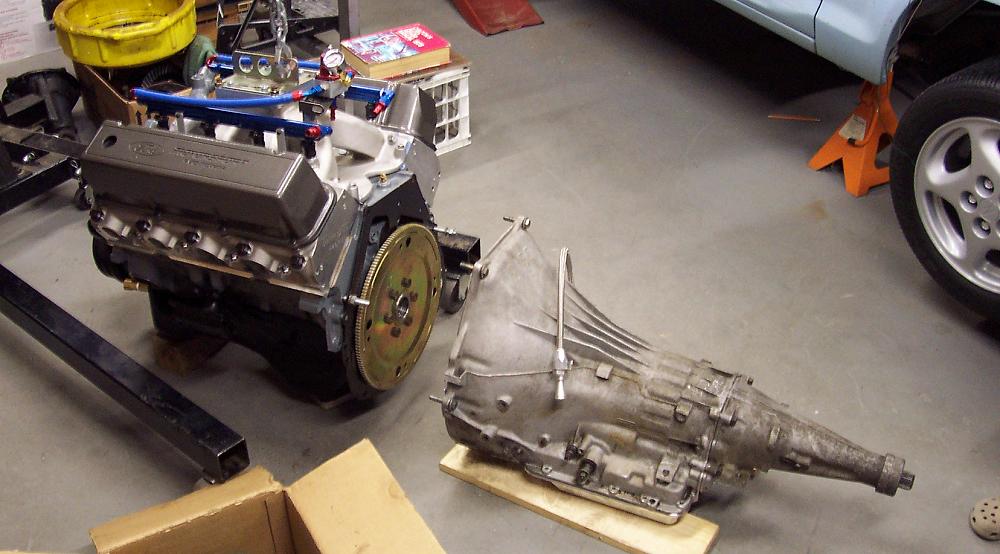

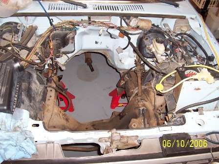

The truck itself was nothing special at first glance. It already had a small block 5.0L swap and some prior modifications, including a notched core support. But all of that was about to change. The small block and T5 were pulled to make room for something much larger—a stroked EFI 460 paired with a C6 automatic.
That’s when the real work began.

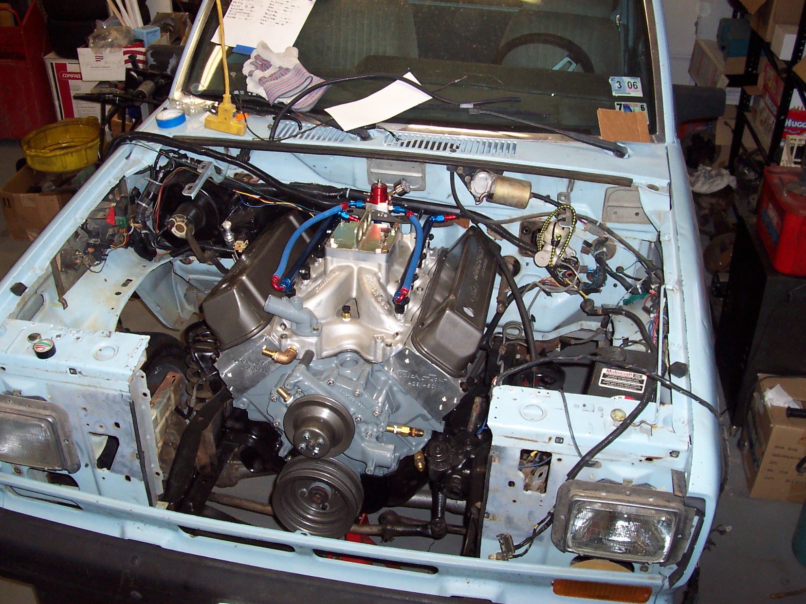

Making a 460 Fit Where It Shouldn’t

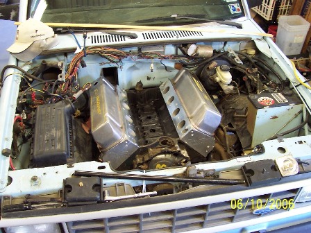

Fitting a big block into a Ranger engine bay isn’t just a matter of dropping it in—it’s a constant exercise in compromise and problem-solving.

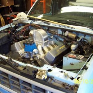

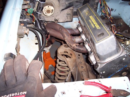

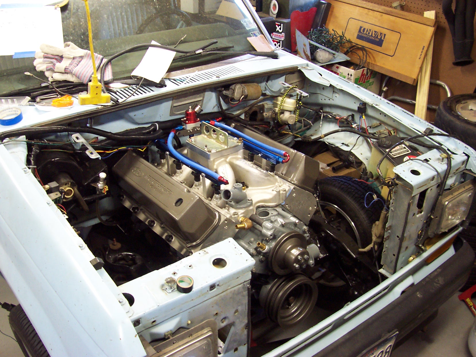

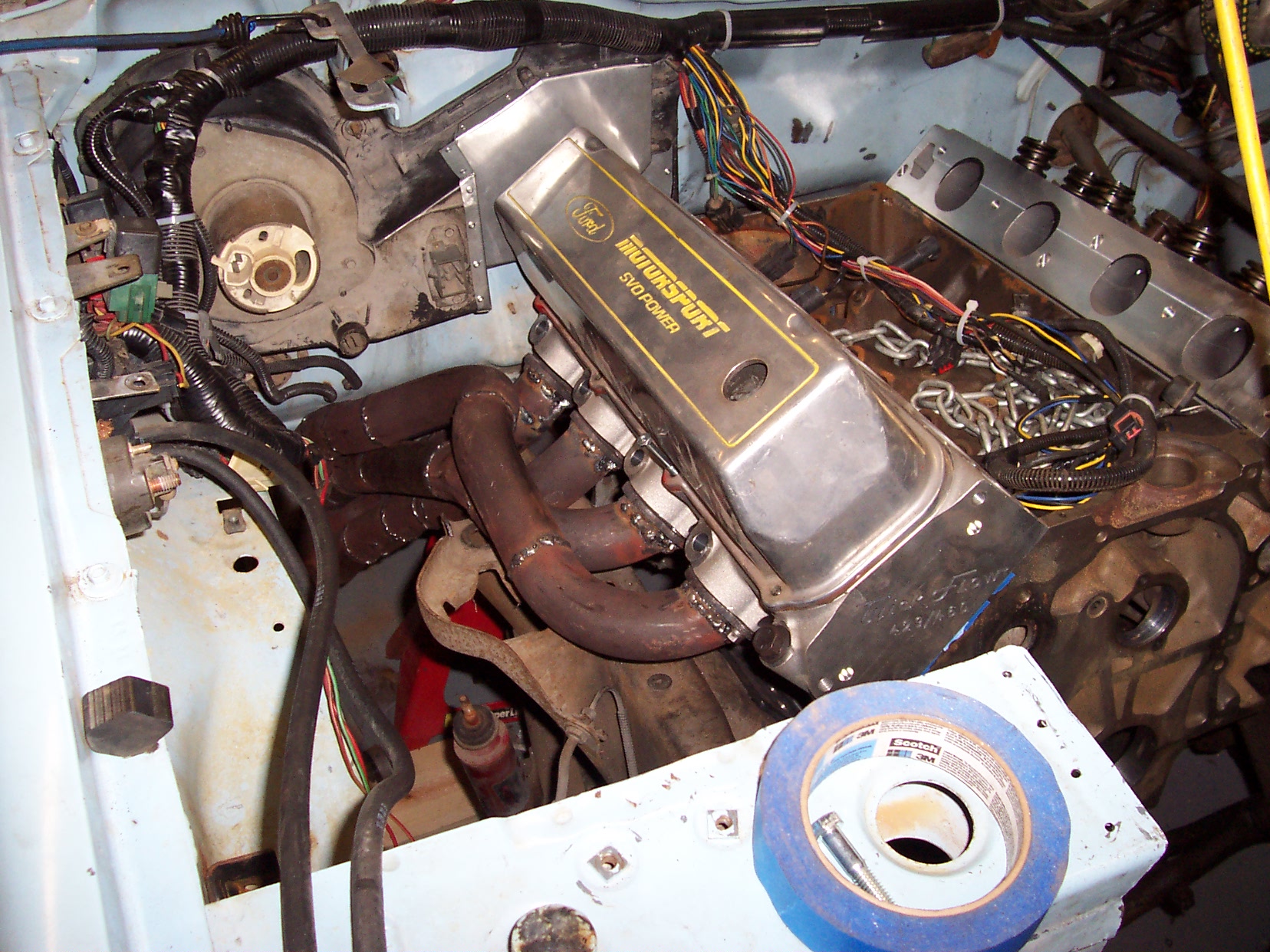

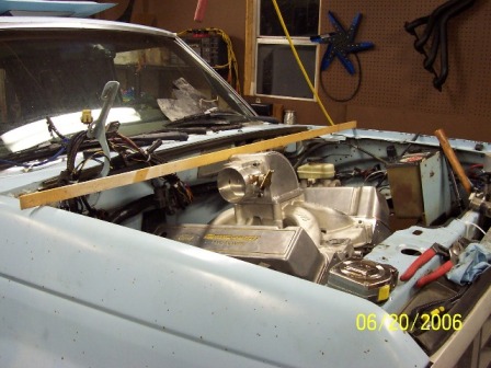

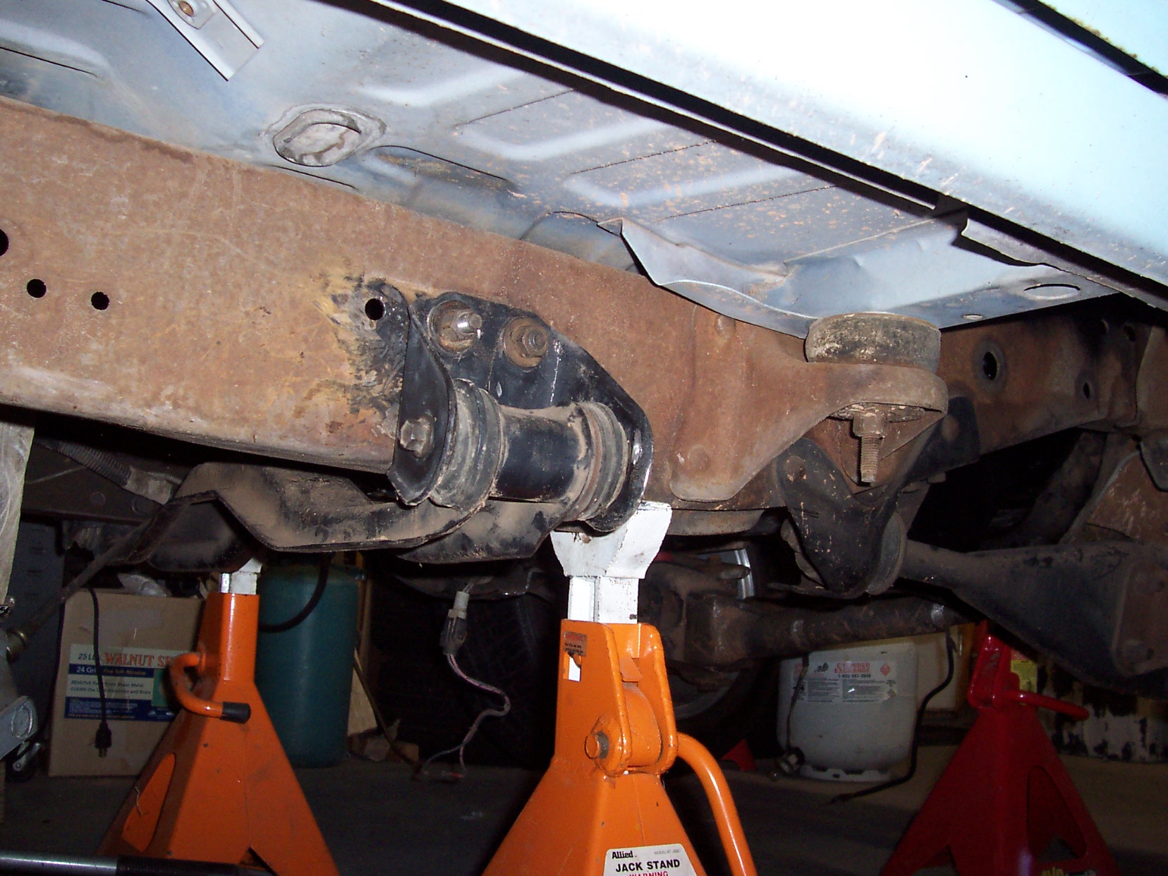

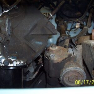

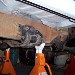

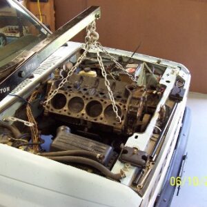

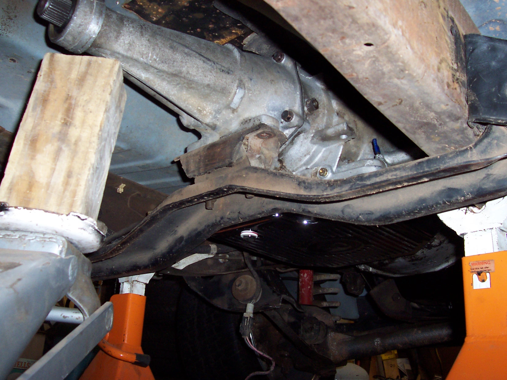

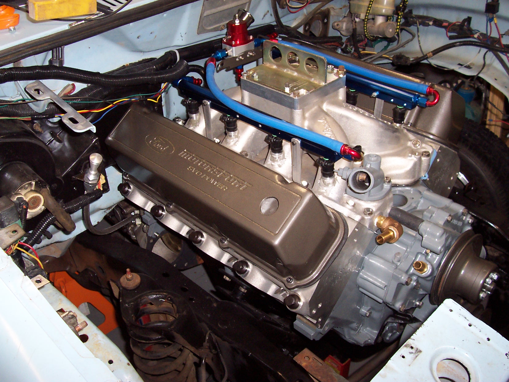

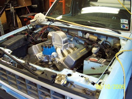

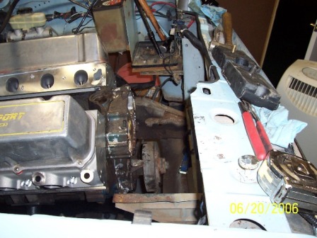

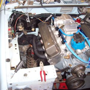

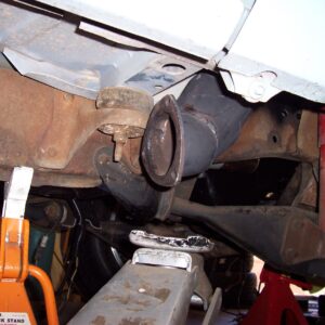

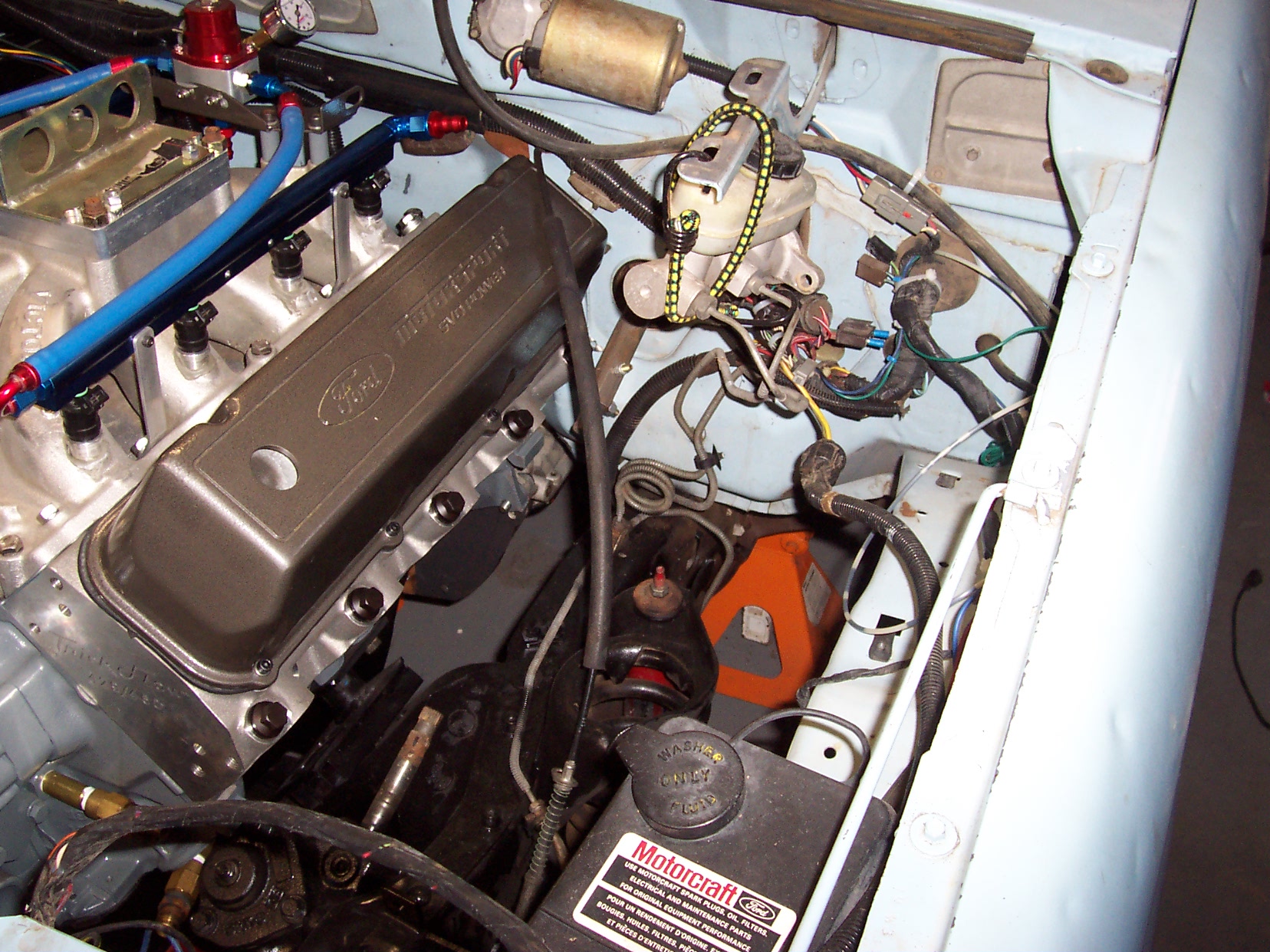

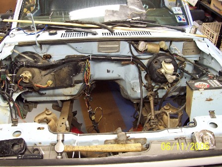

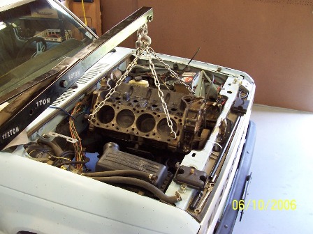

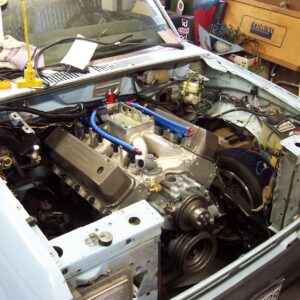

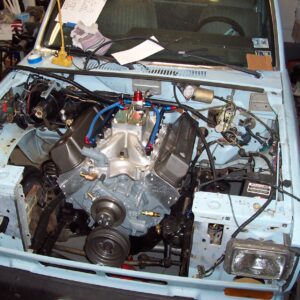

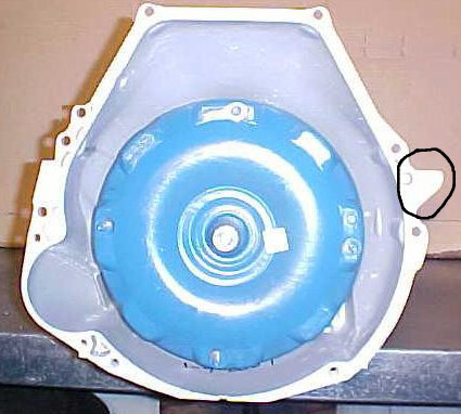

The radius arm crossmember had already been modified, but it needed to become removable to clear the massive C6 bellhousing. With that handled, the 460 was lowered into place for mock-up. Surprisingly, the initial fit wasn’t as bad as expected, thanks in part to earlier modifications.

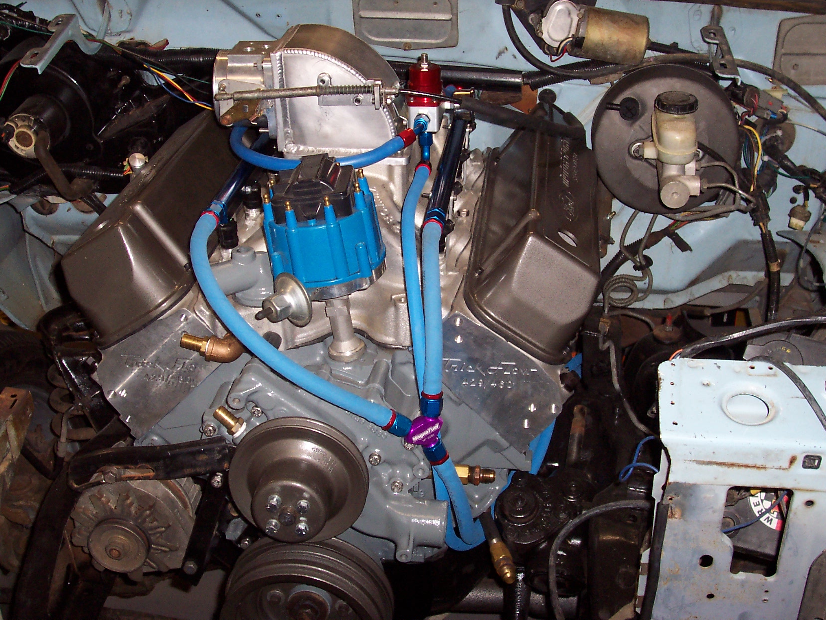

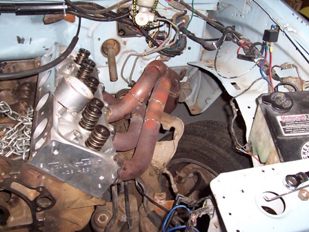

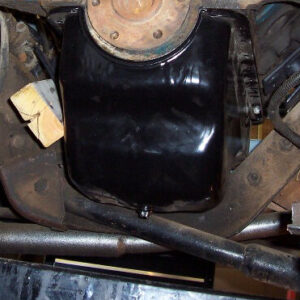

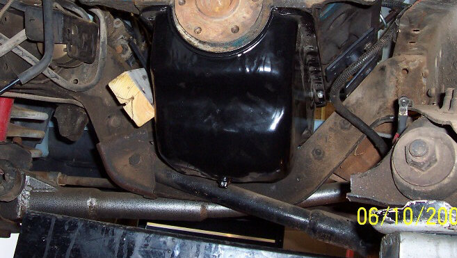

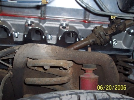

Instead of pushing the engine back into the firewall like many swaps, this build focused on positioning the engine for optimal clearance across the board—oil pan, suspension, and front accessories. The result was an engine offset slightly toward the passenger side, a decision that helped balance space constraints throughout the bay.

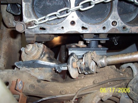

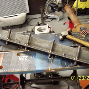

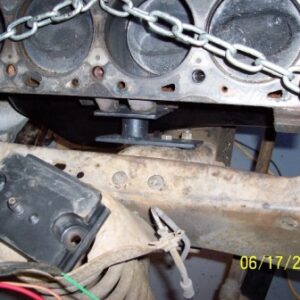

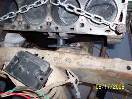

Custom engine mounts were fabricated using Ford Racing components combined with square tubing. The mounts positioned the engine low in the chassis, avoiding the excessive height that would have resulted from using standard isolators.

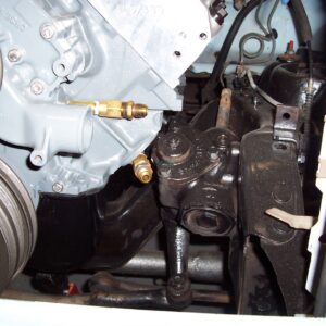

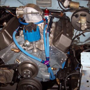

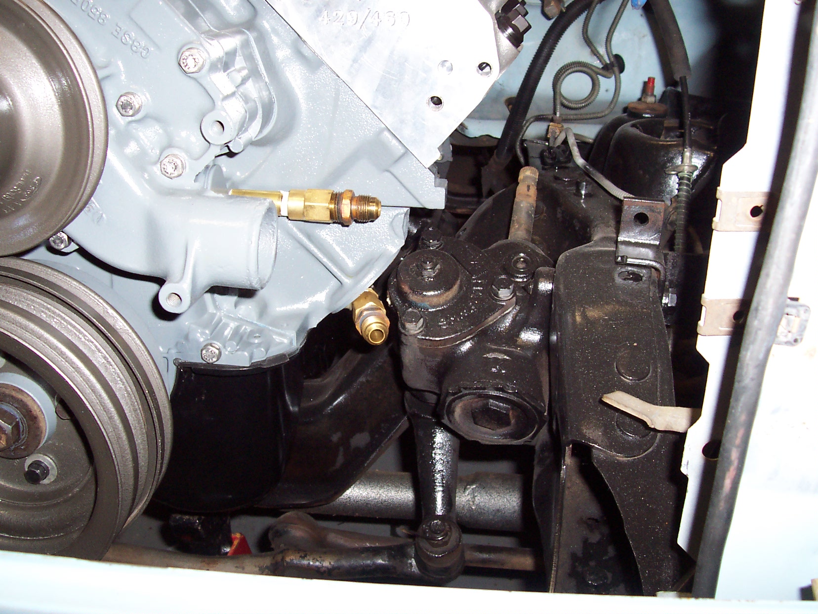

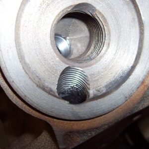

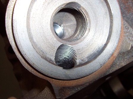

One of the biggest challenges came from the oil filter location. Rather than relocating the engine to accommodate it, the solution was to modify the block for remote oil lines directly—allowing the engine to sit exactly where it needed to be.
Clearance Battles

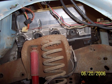

With the engine in place, the real fight began—clearance.

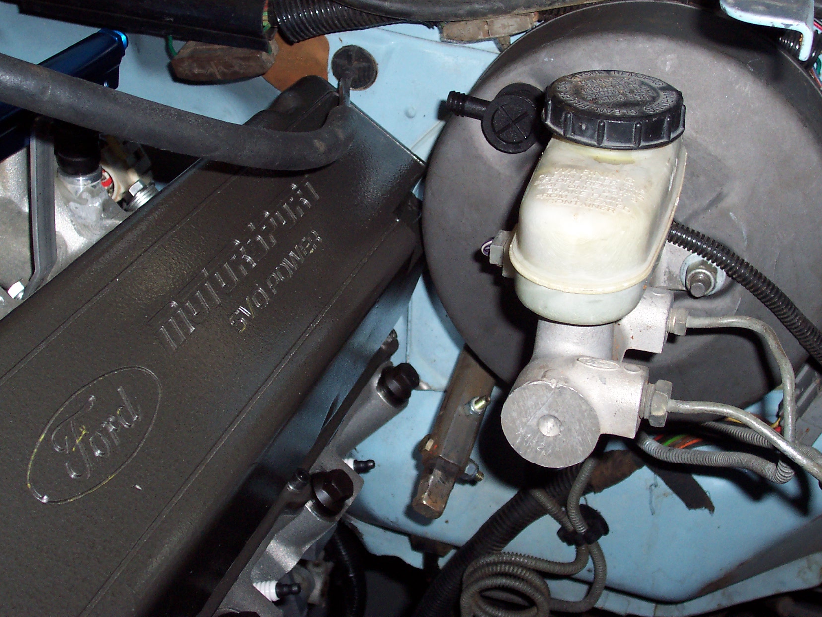

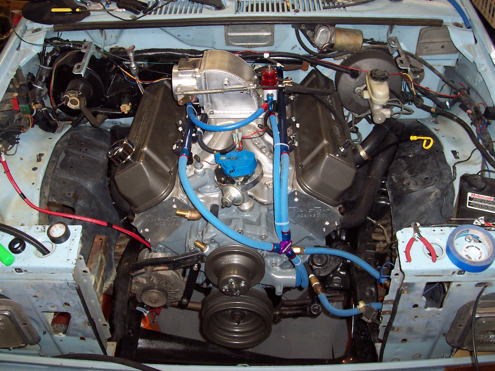

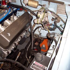

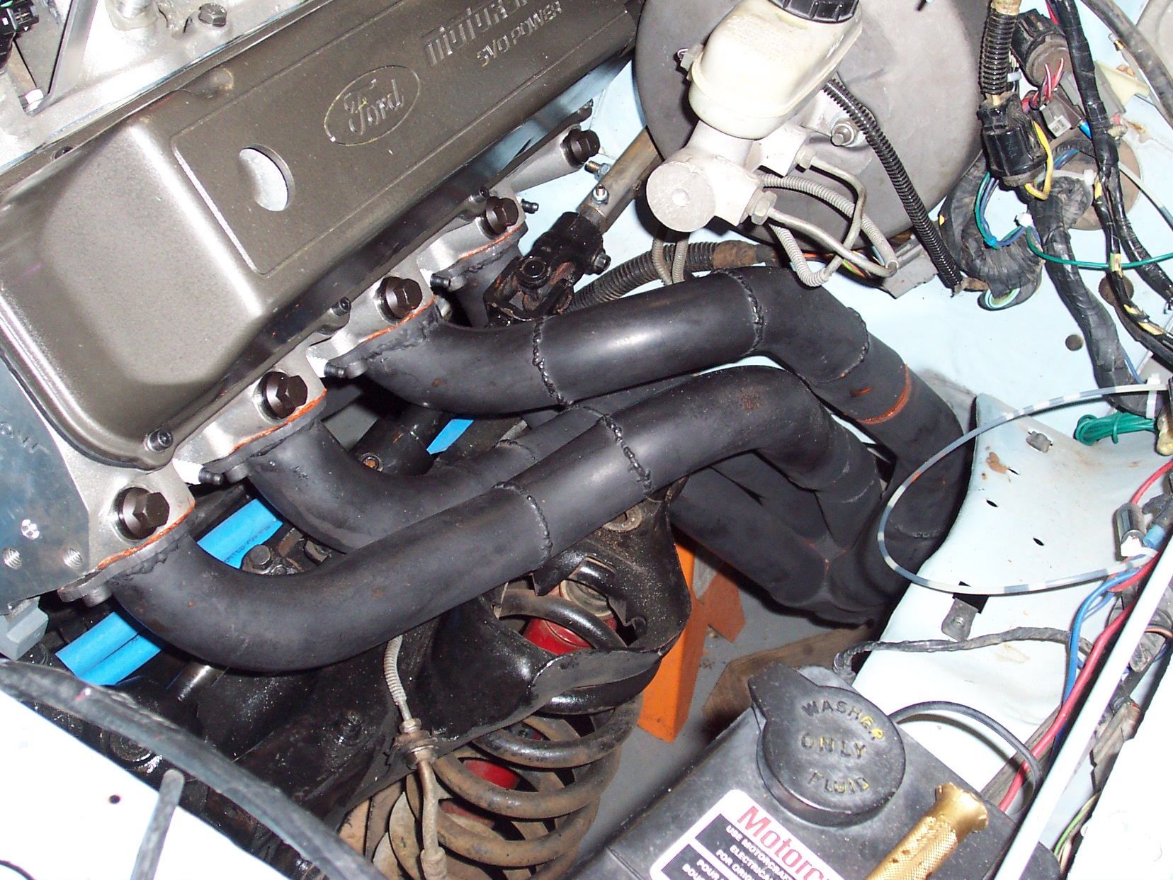

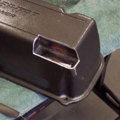

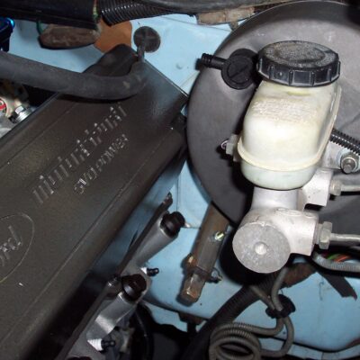

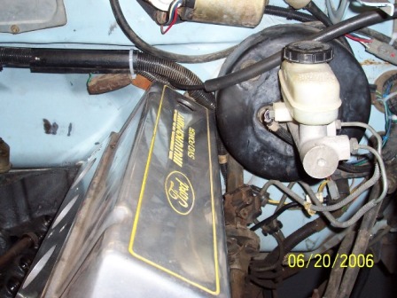

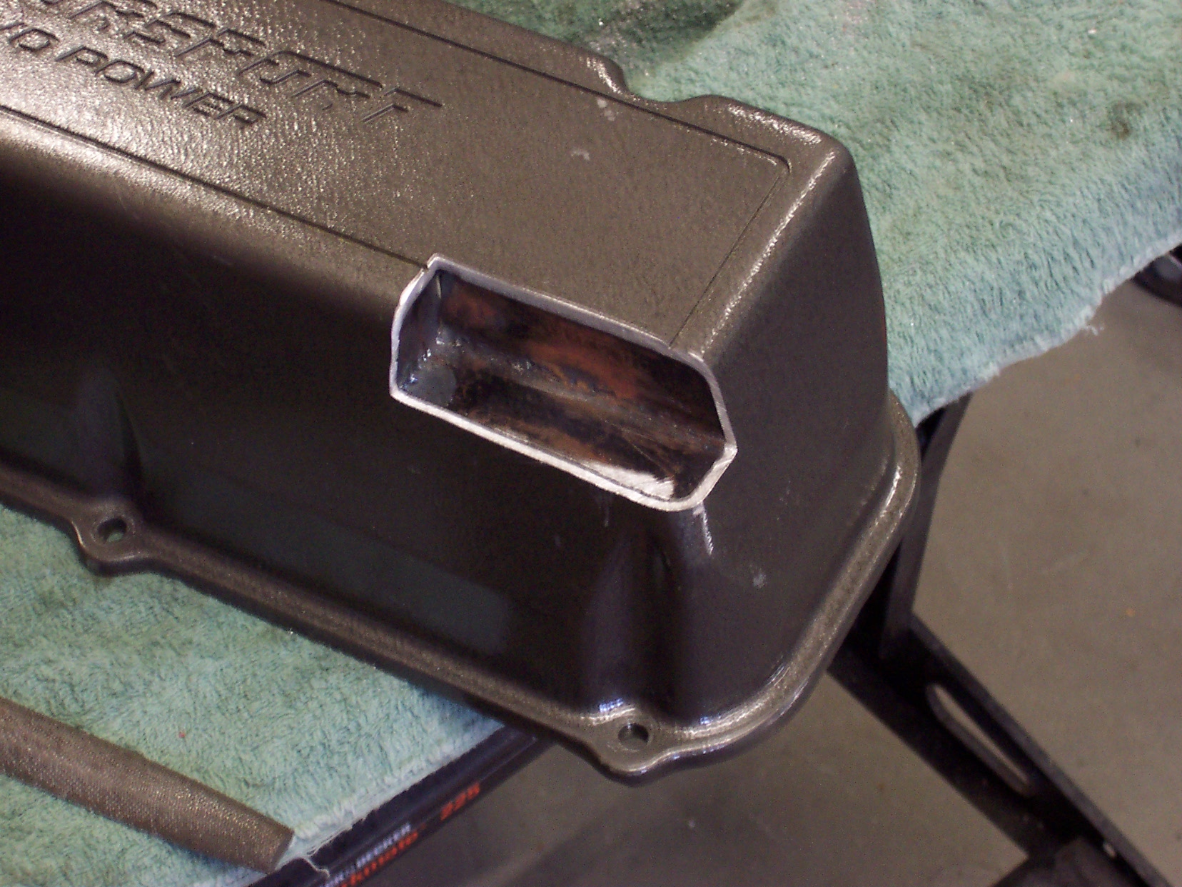

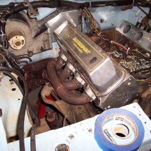

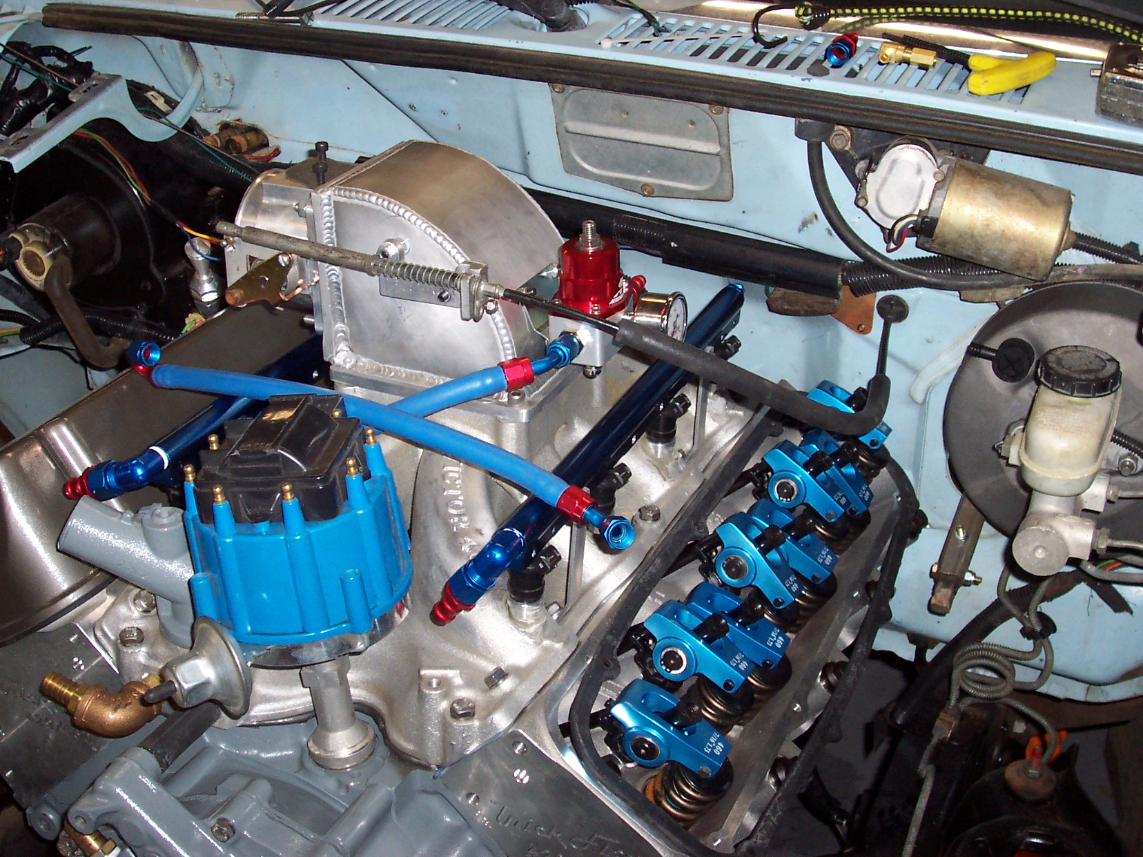

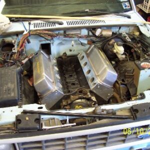

The brake booster and valve cover nearly occupied the same space, leaving only fractions of an inch to work with. The solution? Notching the valve cover itself. Tight, but effective.

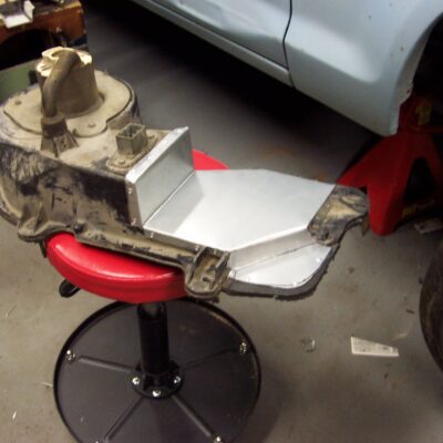

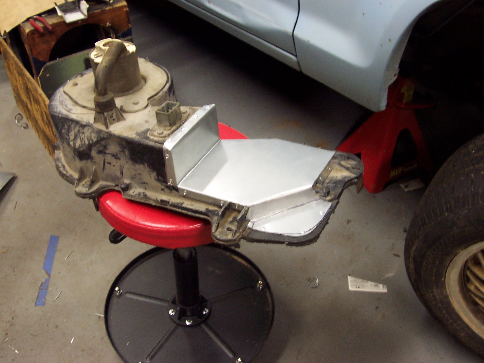

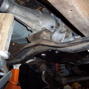

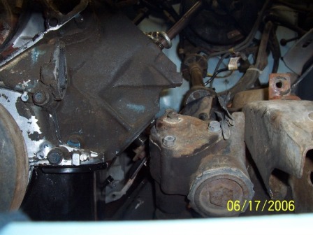

The heater box required modification, the passenger-side I-beam came dangerously close to the oil pan, and the transmission tunnel needed trimming to accommodate the bulk of the C6.
Up top, hood clearance checks showed that a modest 2-inch cowl hood would be enough to clear the tall big block.
Every inch of the engine bay had to be negotiated—and nothing fit without a fight.

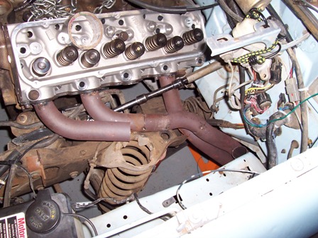

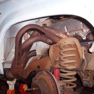

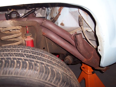

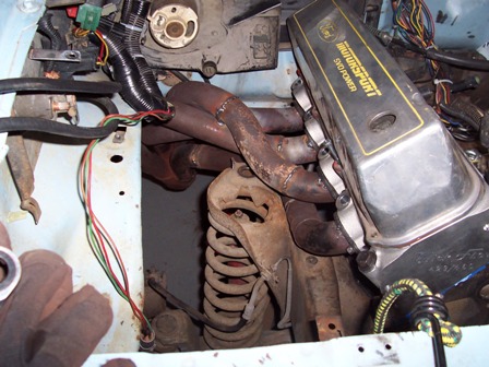

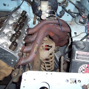

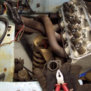

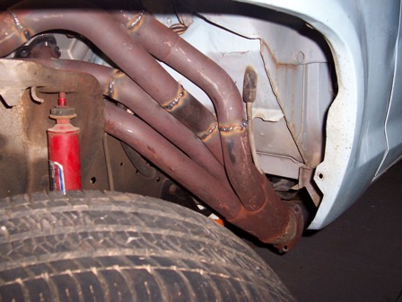

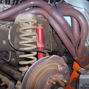

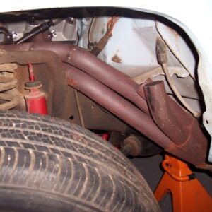

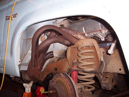

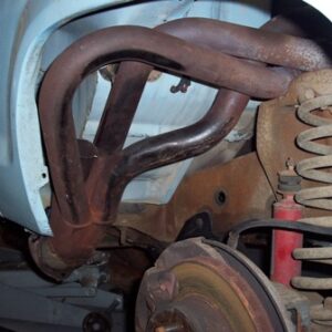

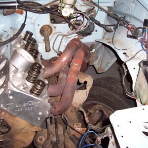

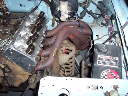

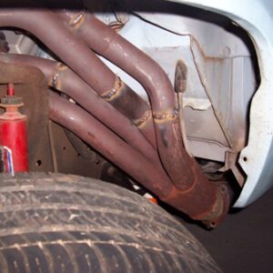

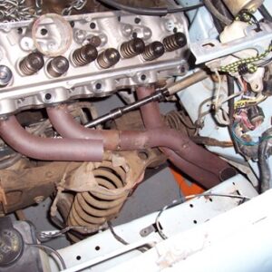

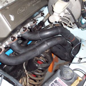

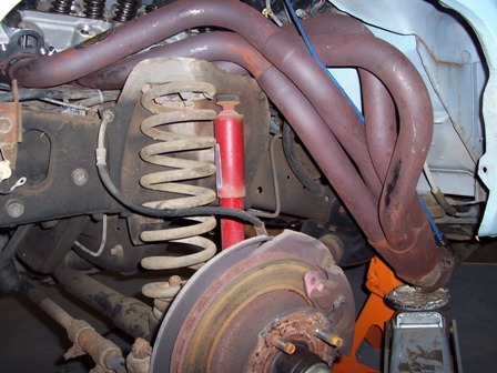

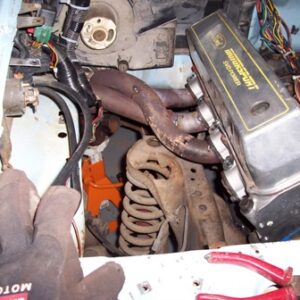

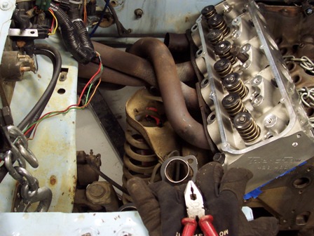

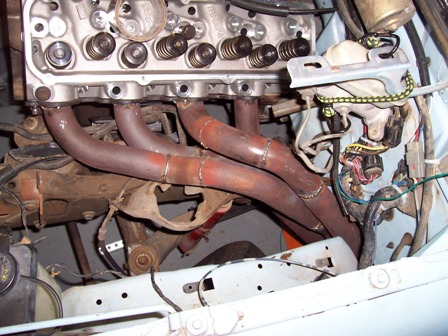

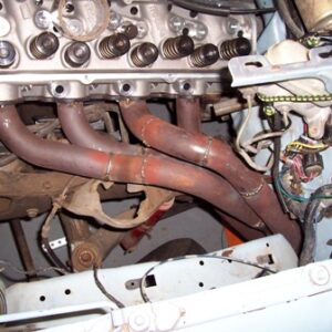

The headers, in particular, became a project of their own. Starting with a set of big block Chevy fenderwell headers, extensive cutting, rerouting, and welding transformed them into something that would actually fit the Ranger chassis. Tube routing had to account for steering clearance, suspension travel, and tire movement—all while maintaining access to spark plugs.

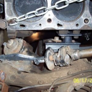

The steering shaft itself was swapped out for a slimmer unit from an Aerostar to gain additional room.

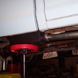

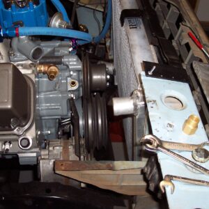

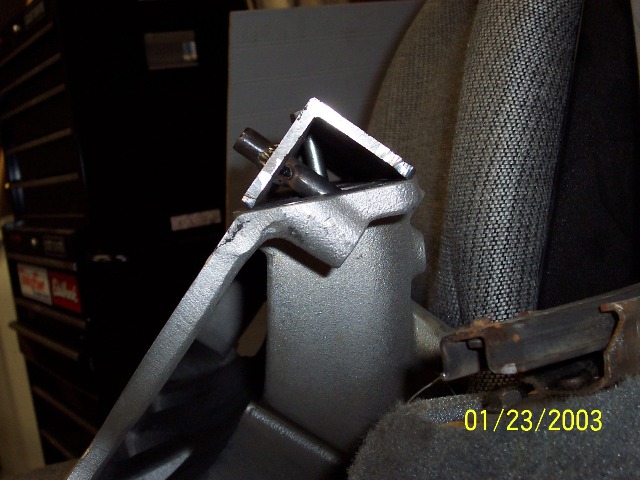

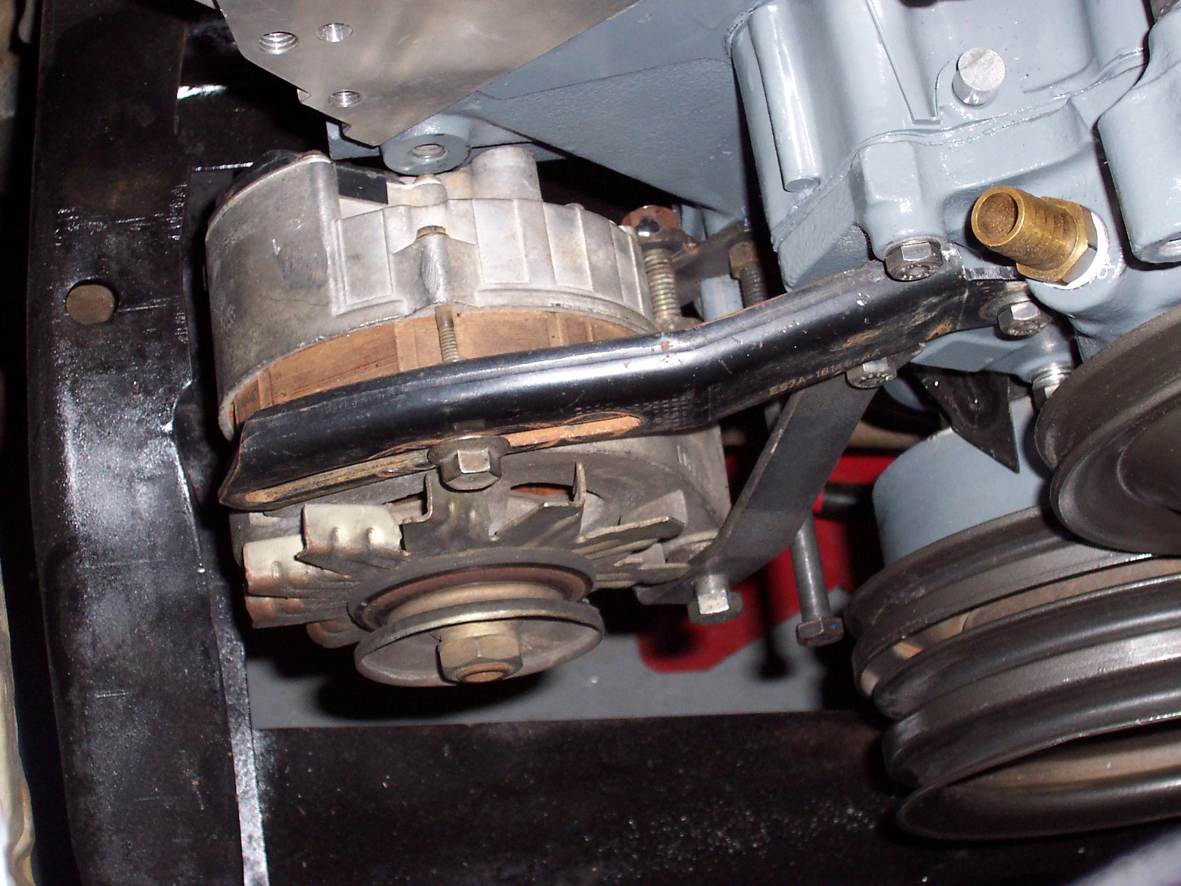

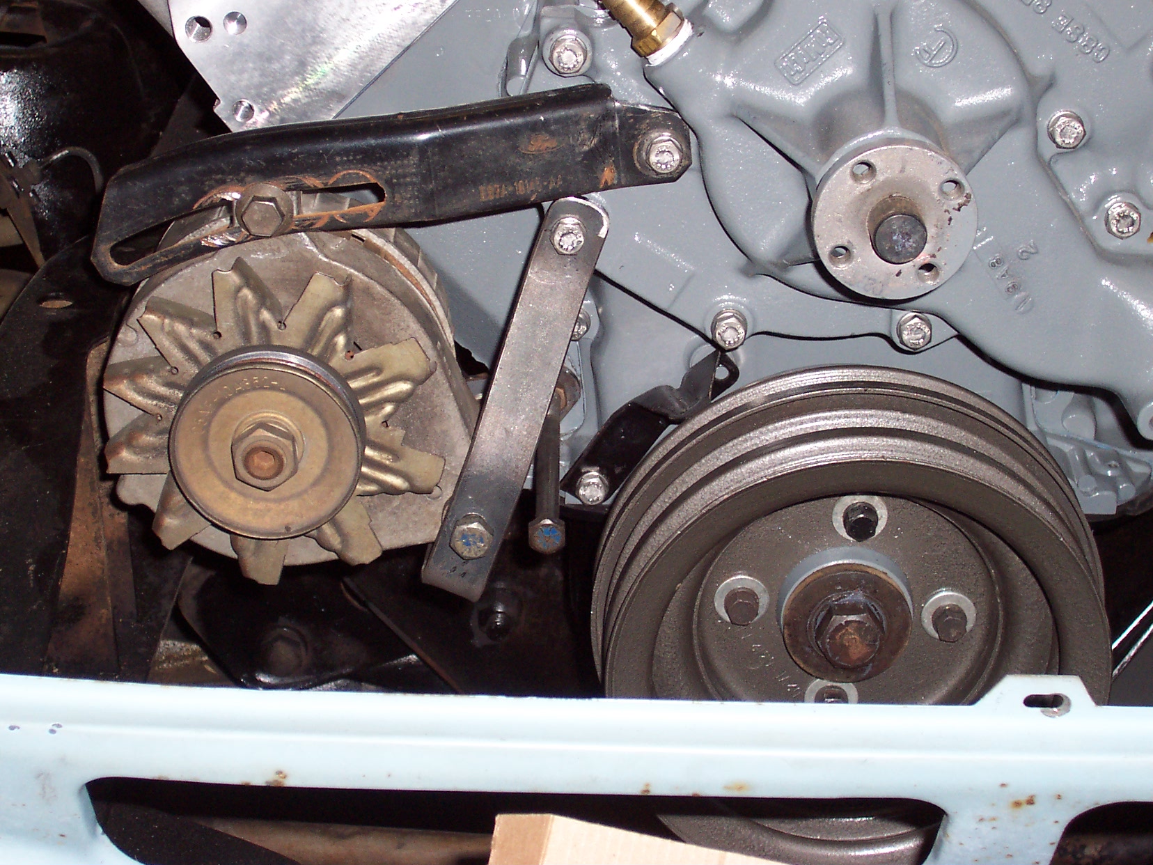

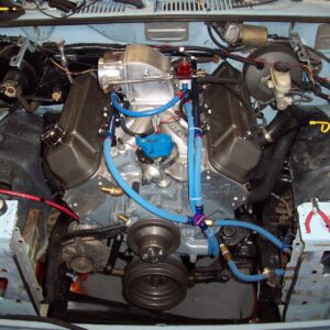

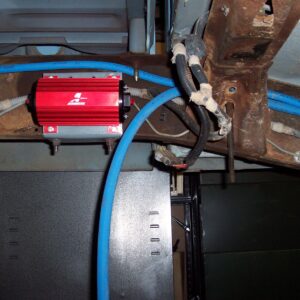

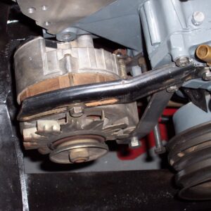

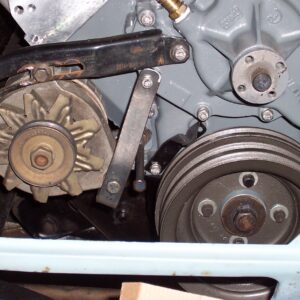

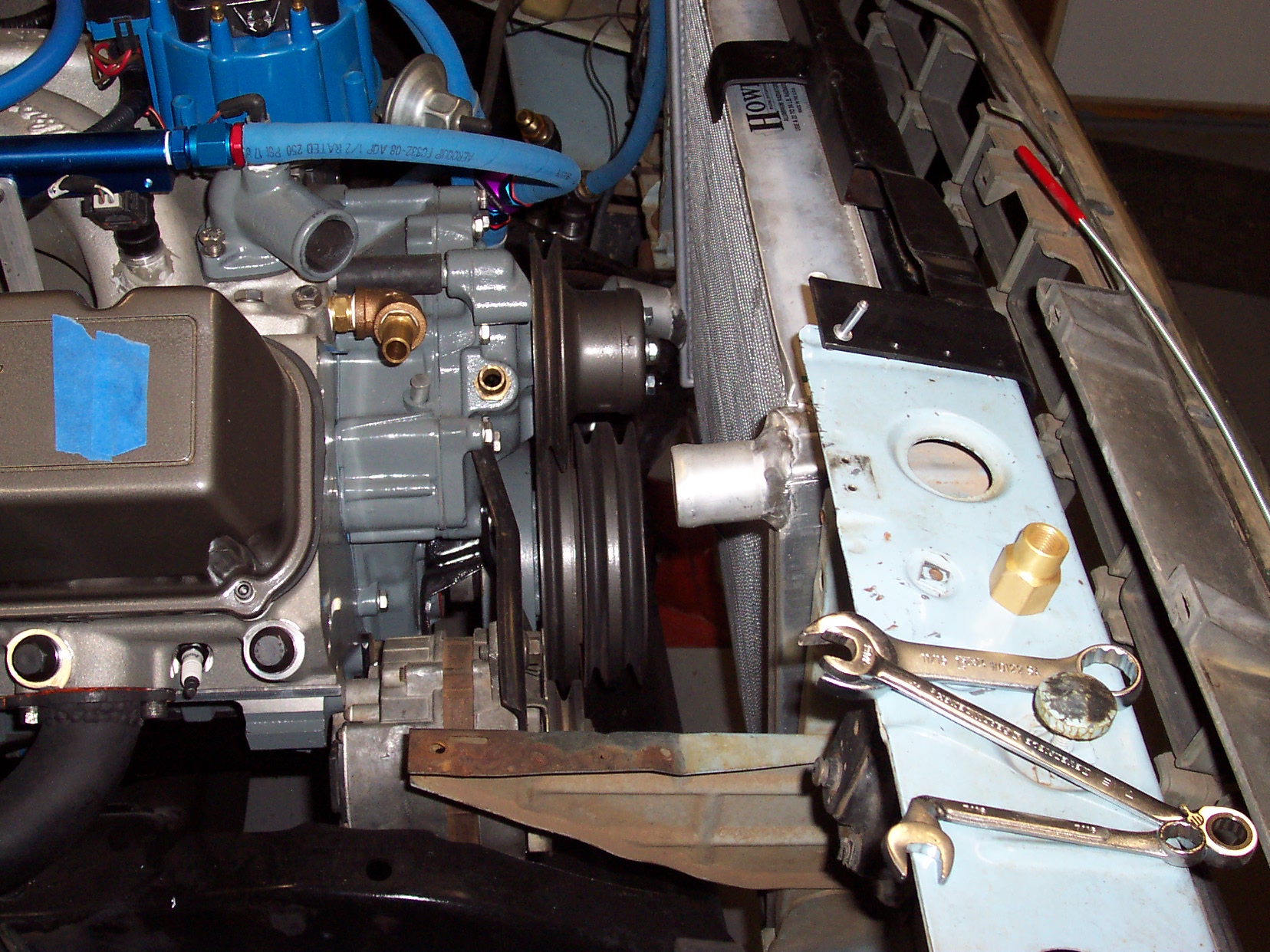

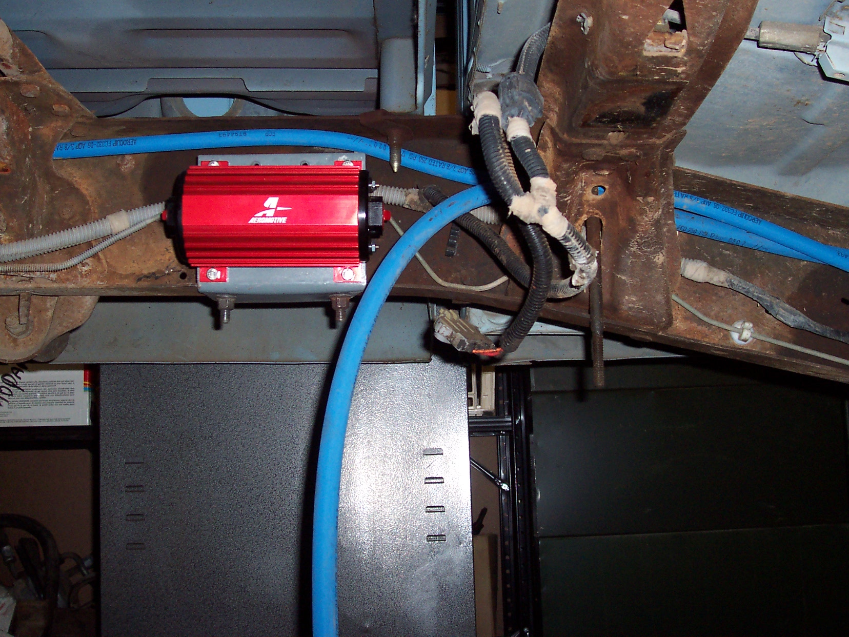

Elsewhere, a custom low-mount alternator bracket was fabricated to work with the unique pulley combination, and a fully custom fuel system was built. This included a rear-mounted fuel cell recessed into the bed, an Aeromotive A1000 pump mounted to the frame, and carefully routed lines kept well away from heat sources.
Even the battery found a new home in the bed, housed in a custom-built enclosure fabricated from an old surplus cabinet.

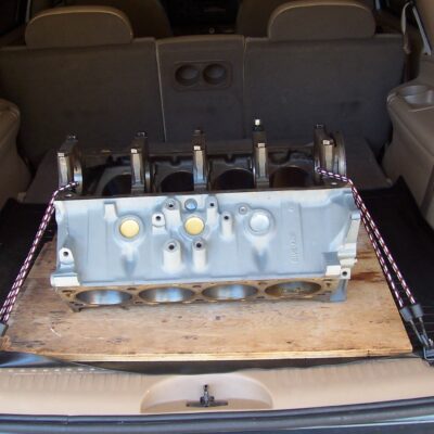

Building the Stroked 460

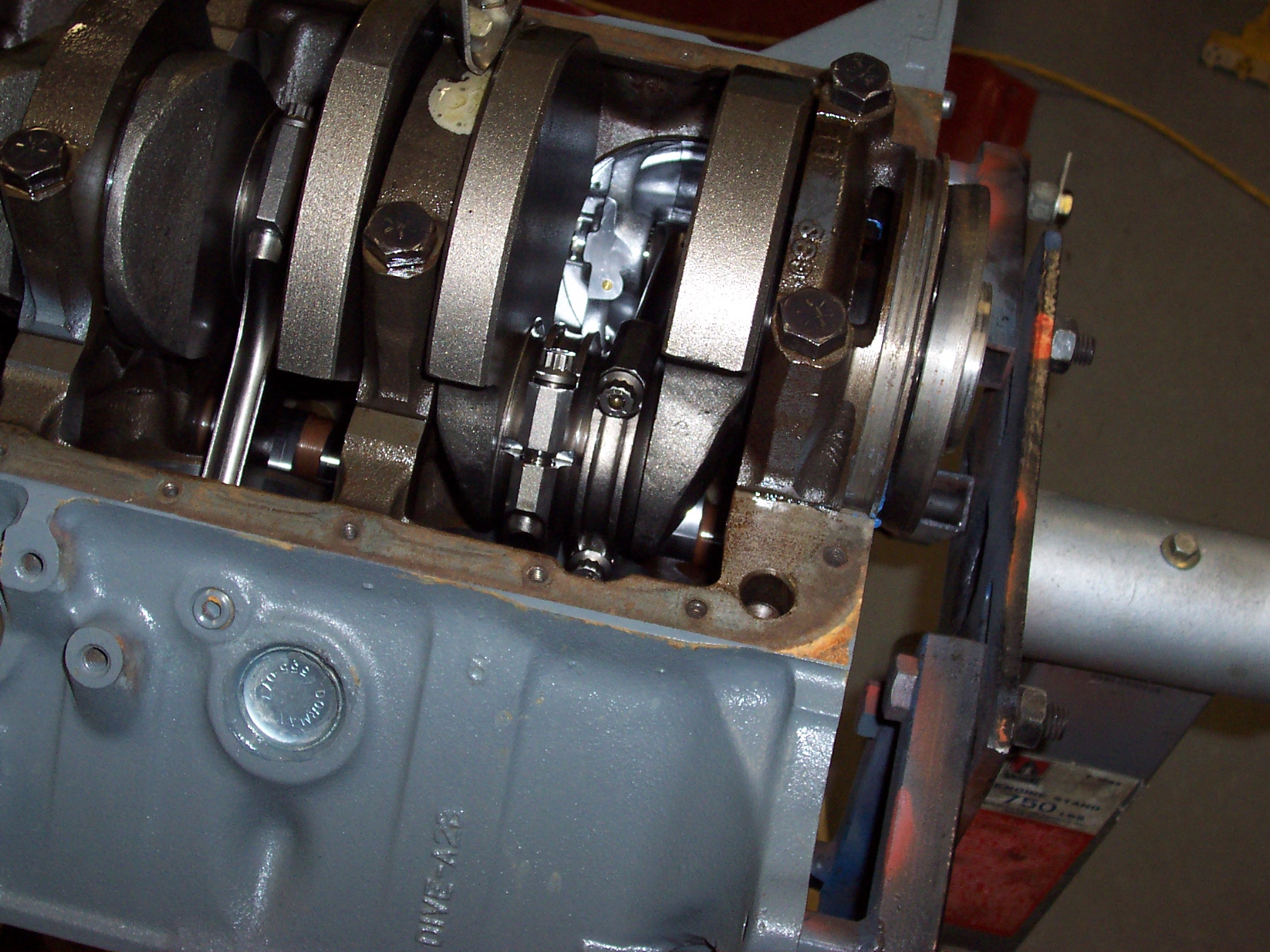

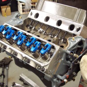

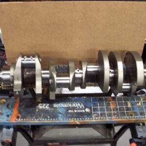

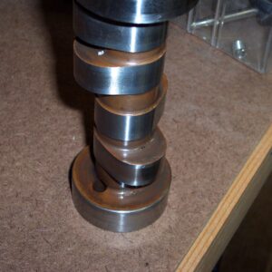

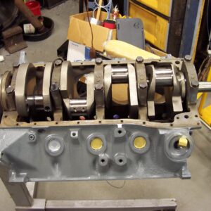

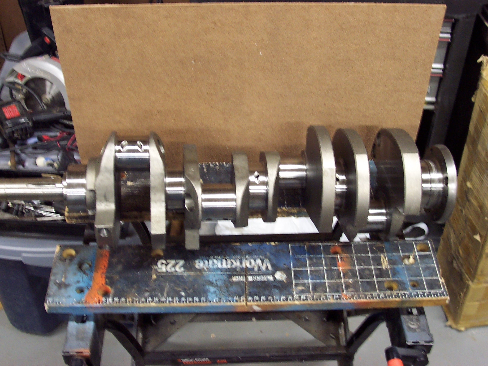

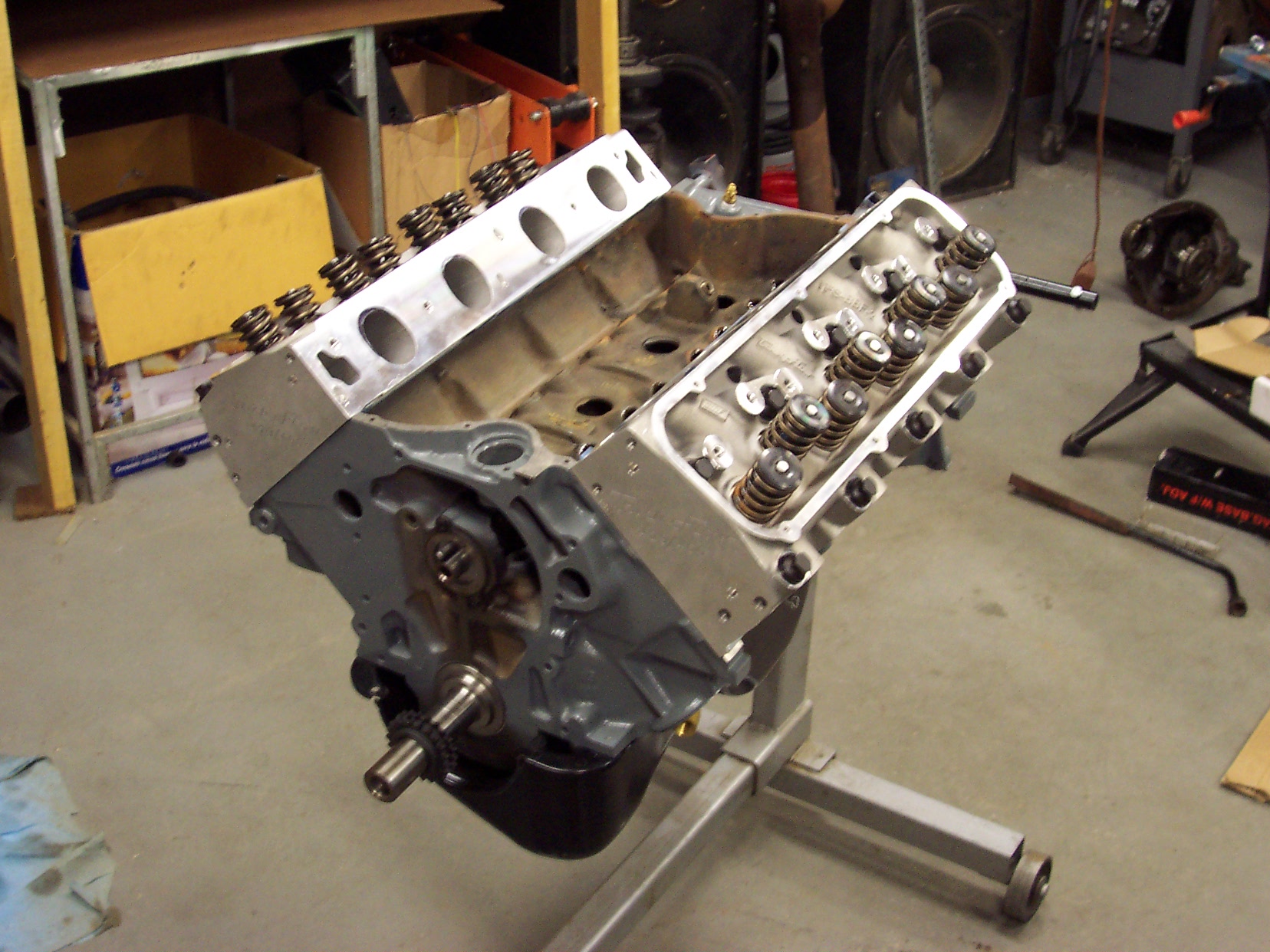

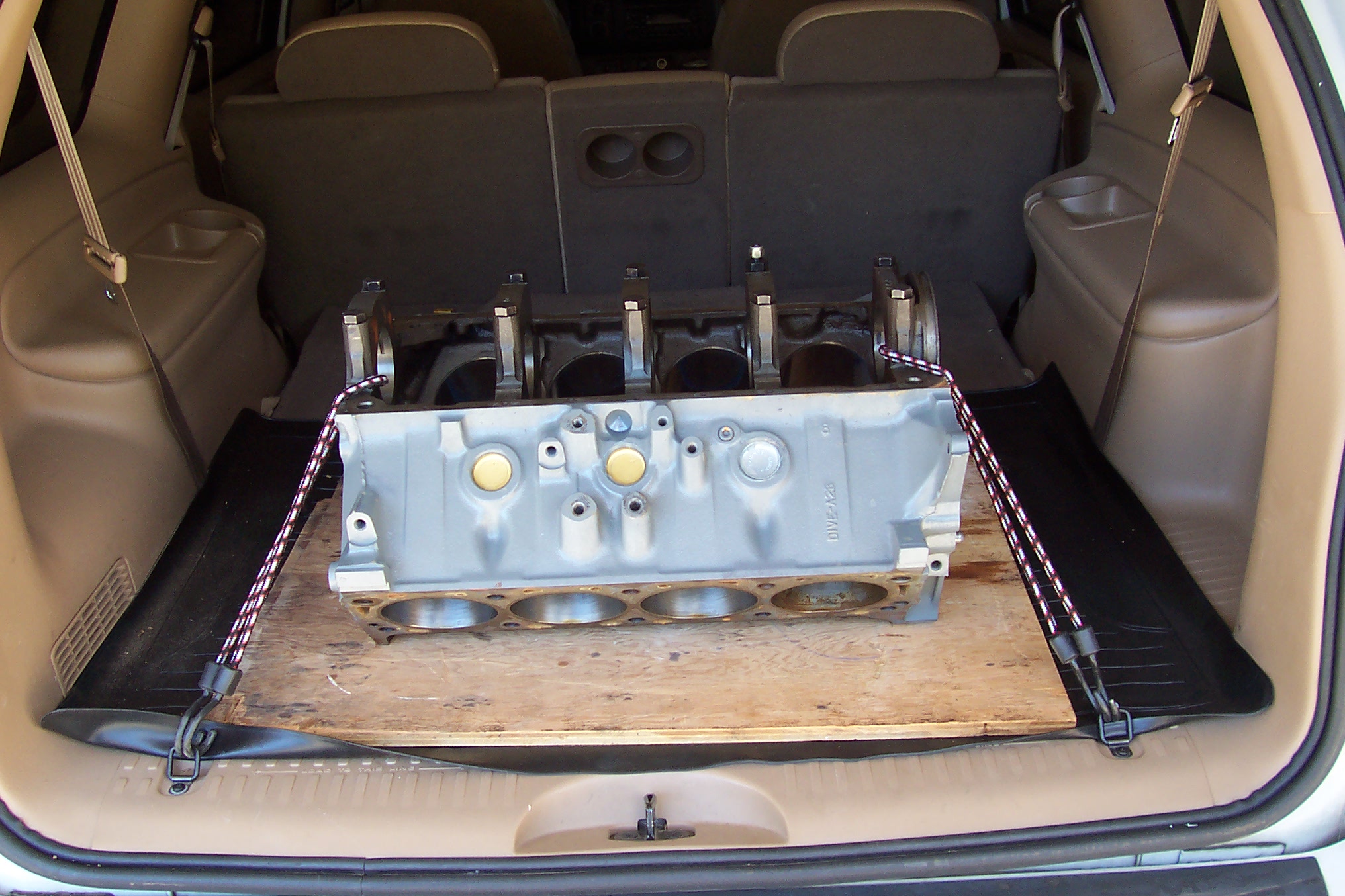

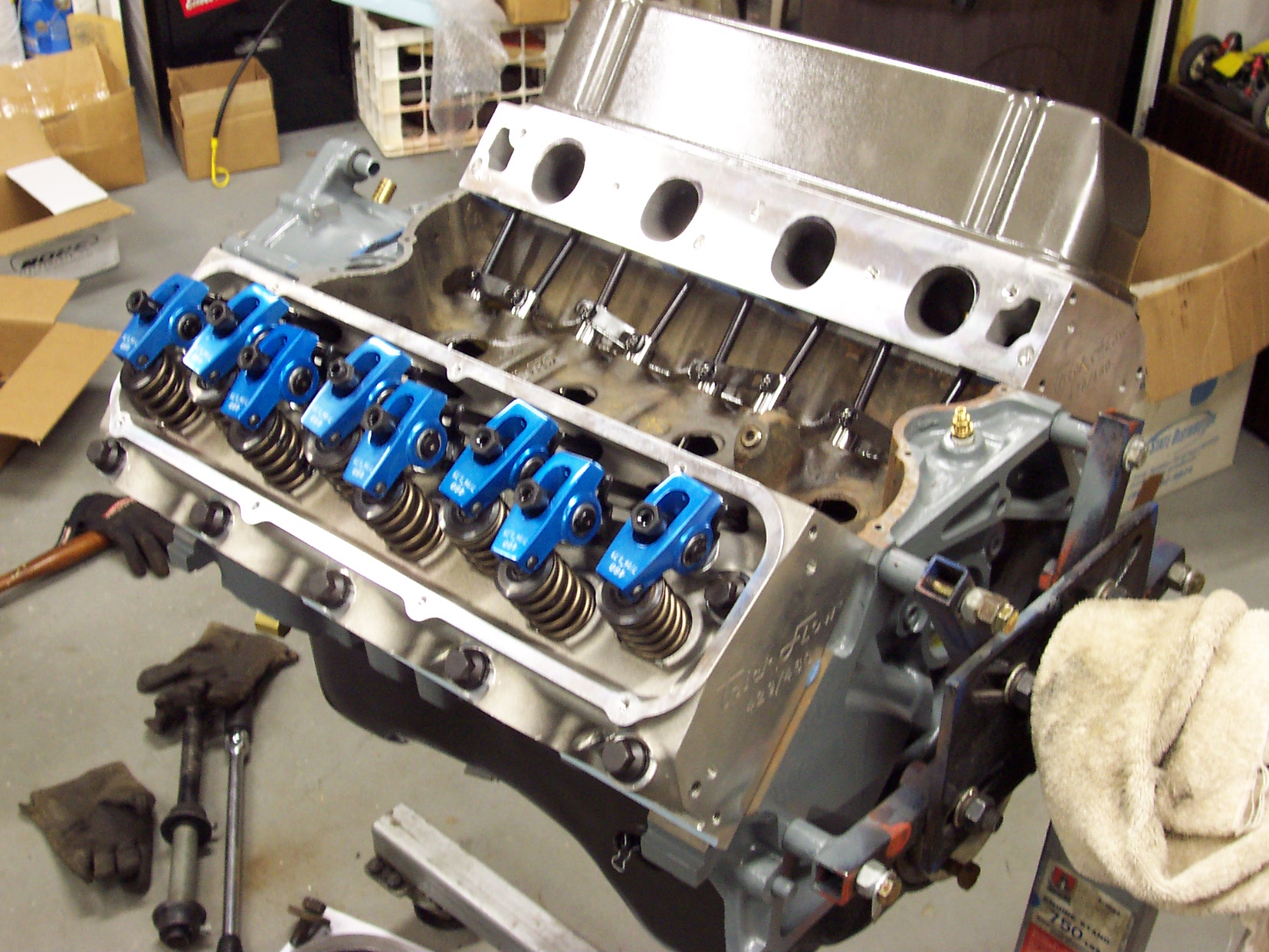

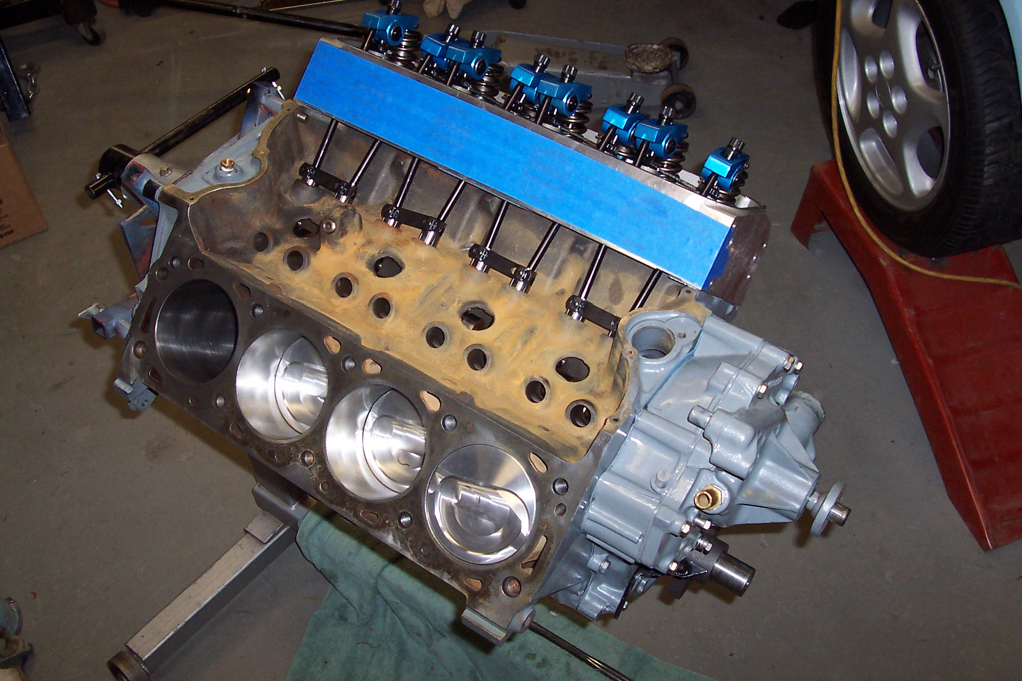

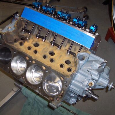

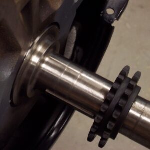

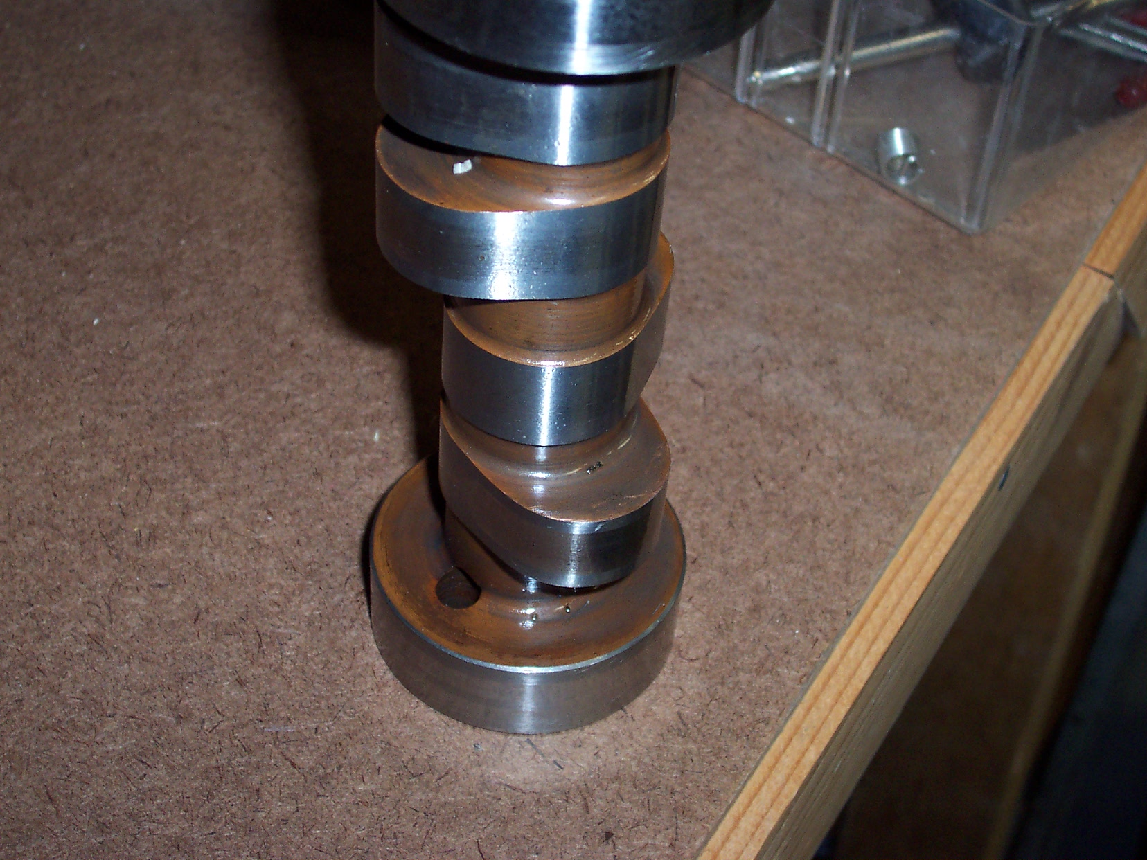

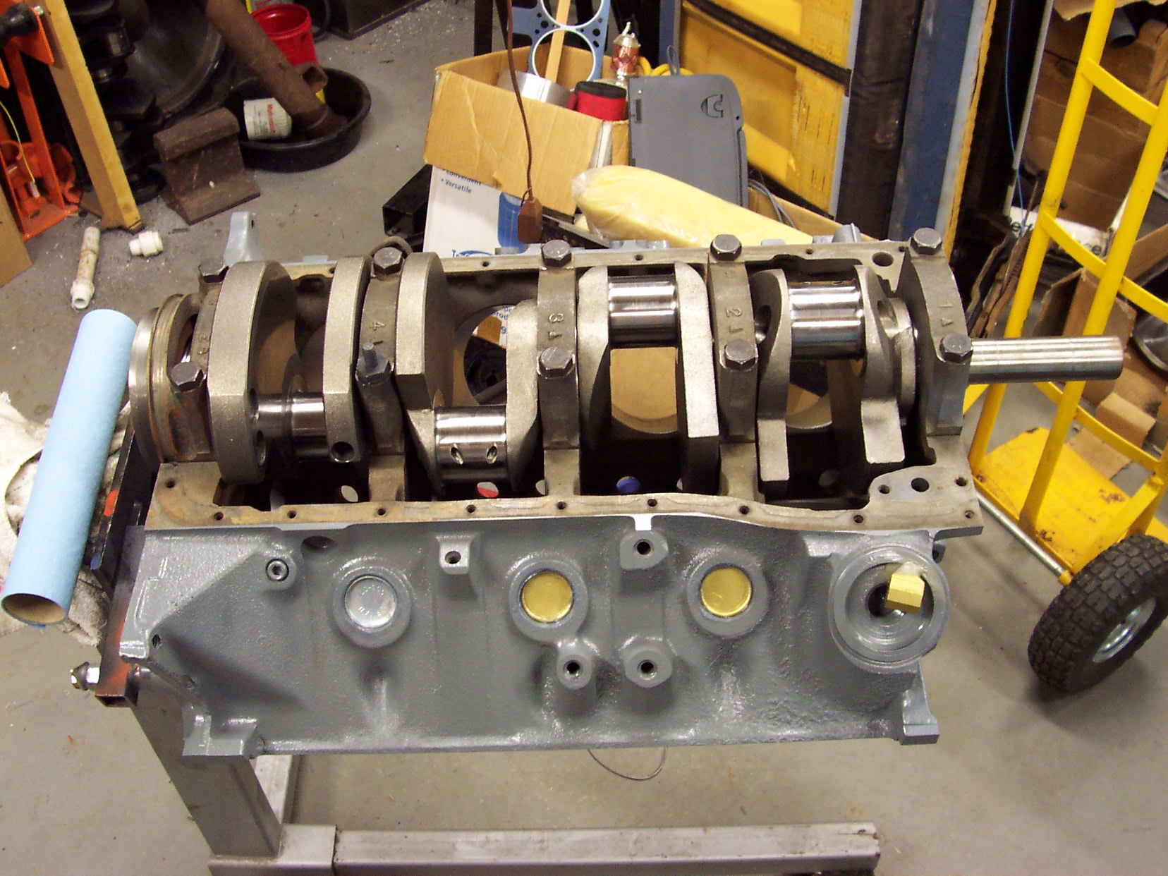

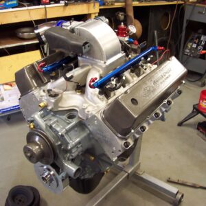

At the heart of the build is a stroked 460, built with a 4.5-inch stroke crank and a carefully selected valvetrain to match.
The bottom end went together smoothly, with no clearance issues—a rare win in a project full of tight fits. Roller lifters, pushrods, and aluminum roller rockers completed the valvetrain, while a mechanical roller cam delivered the aggressive profile the build demanded.

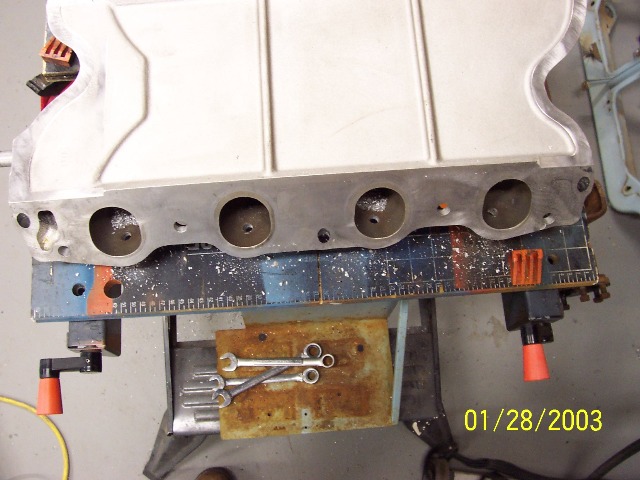

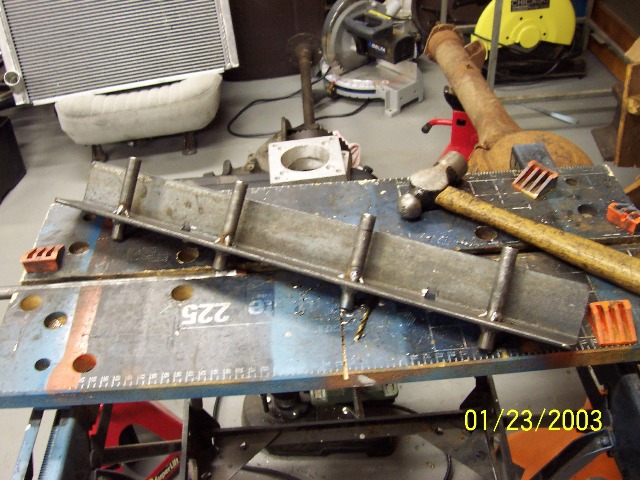

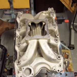

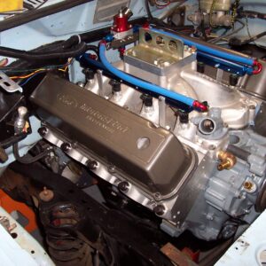

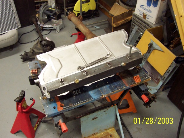

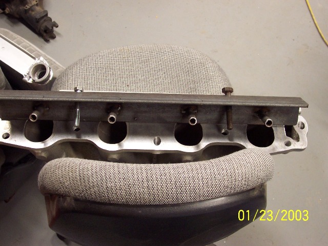

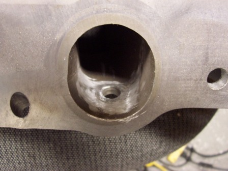

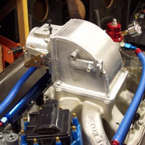

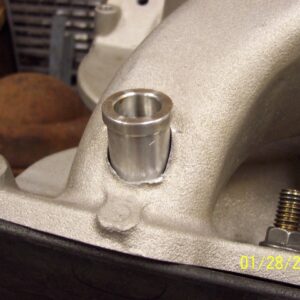

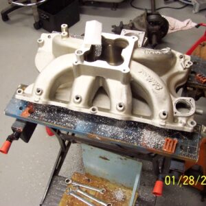

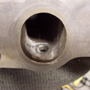

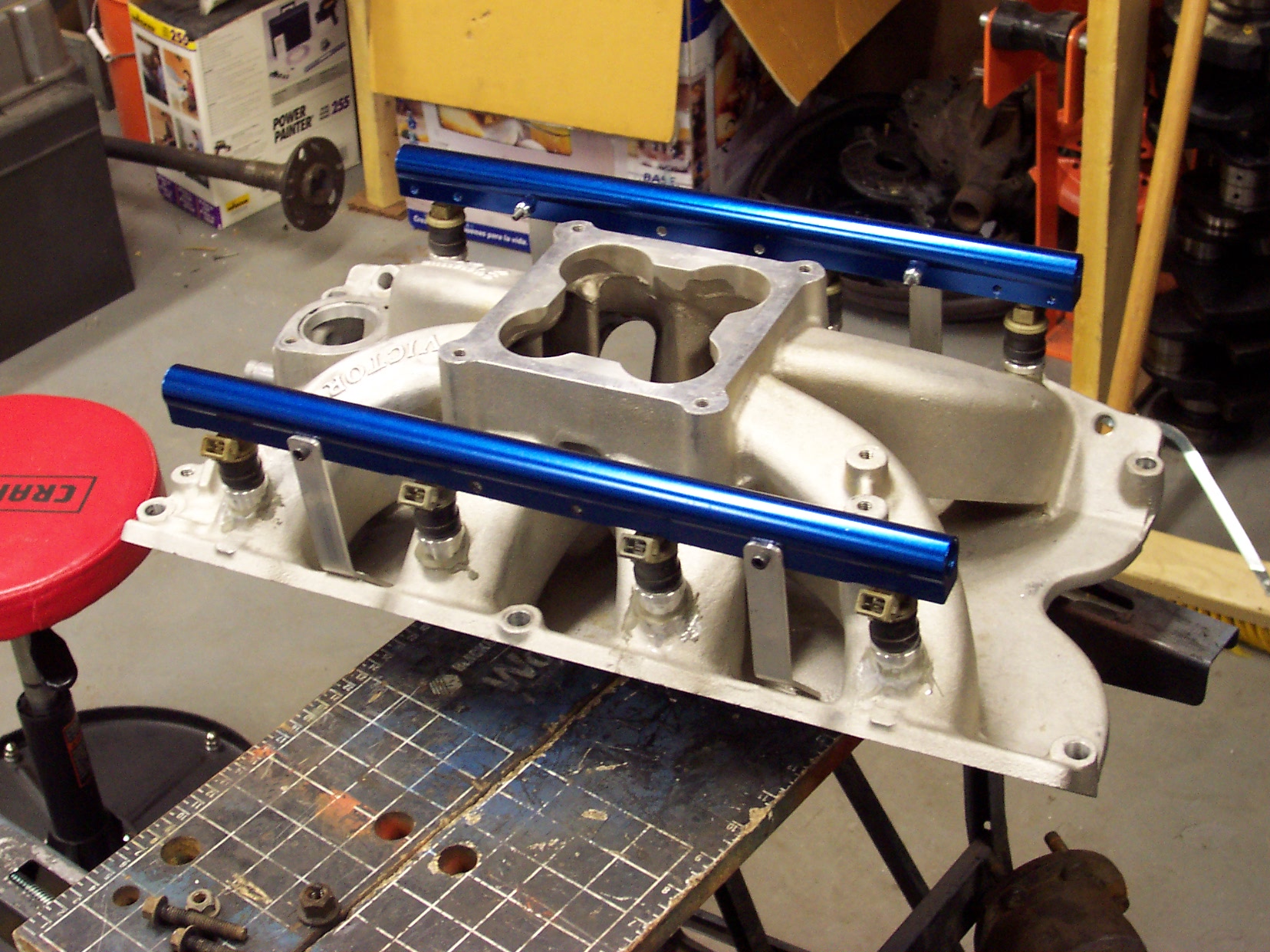

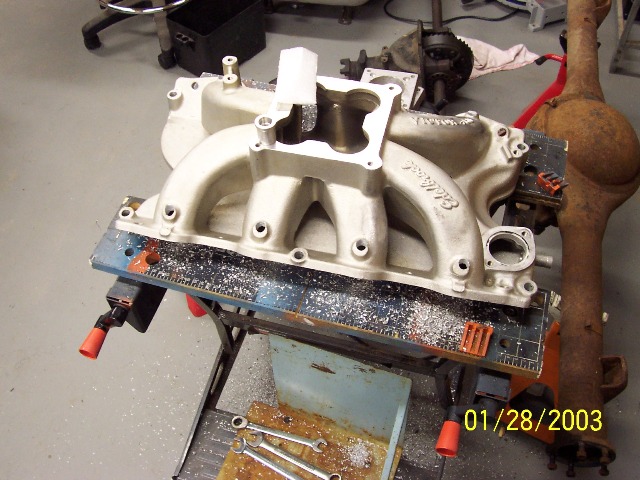

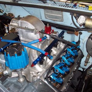

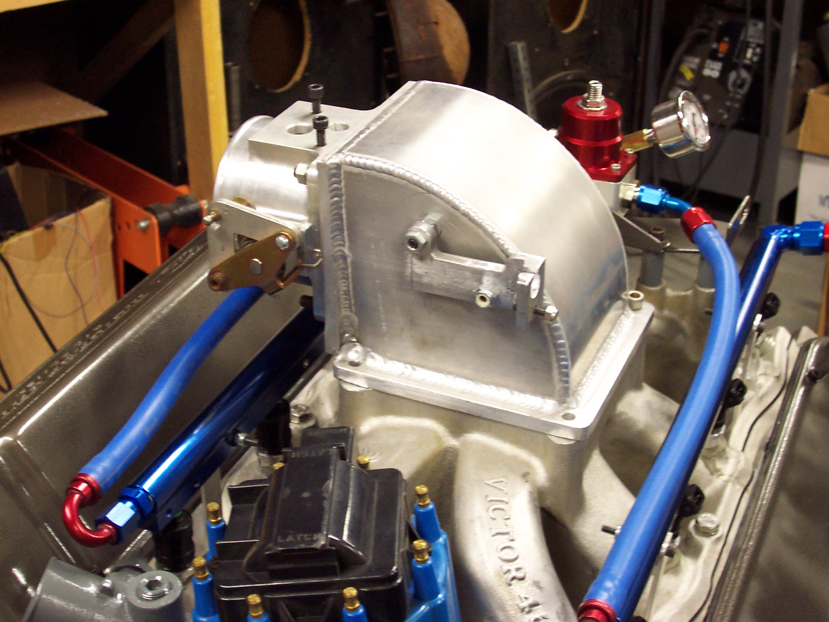

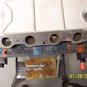

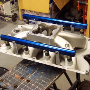

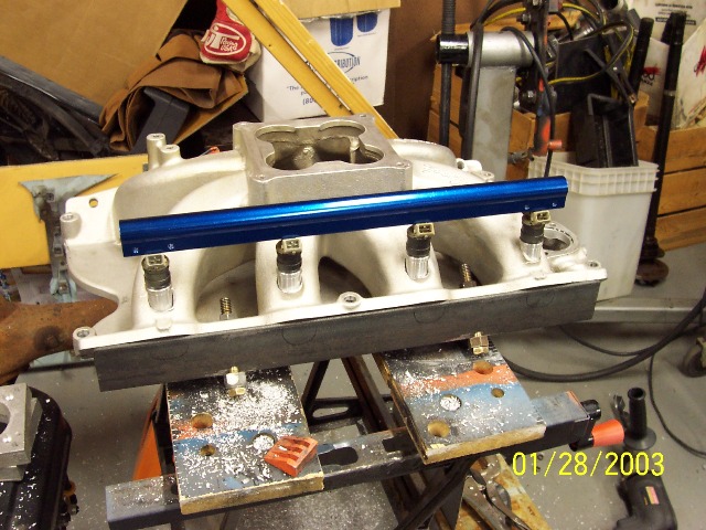

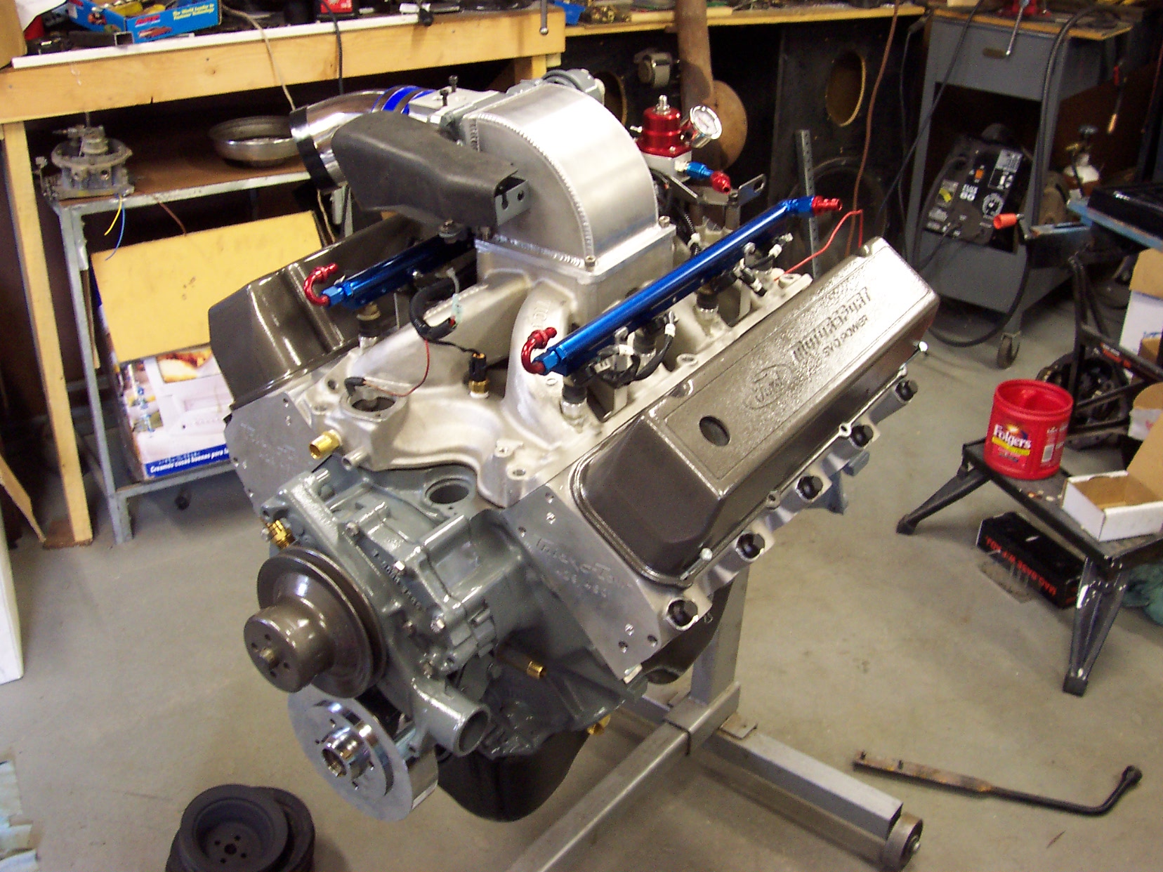

One of the standout elements of the build was the custom EFI intake. Rather than buying an aftermarket solution, injector bungs were added to an existing Victor intake using a homemade jig to ensure precise alignment. The process involved drilling, fitting, and epoxying the bungs into place, followed by careful port blending.

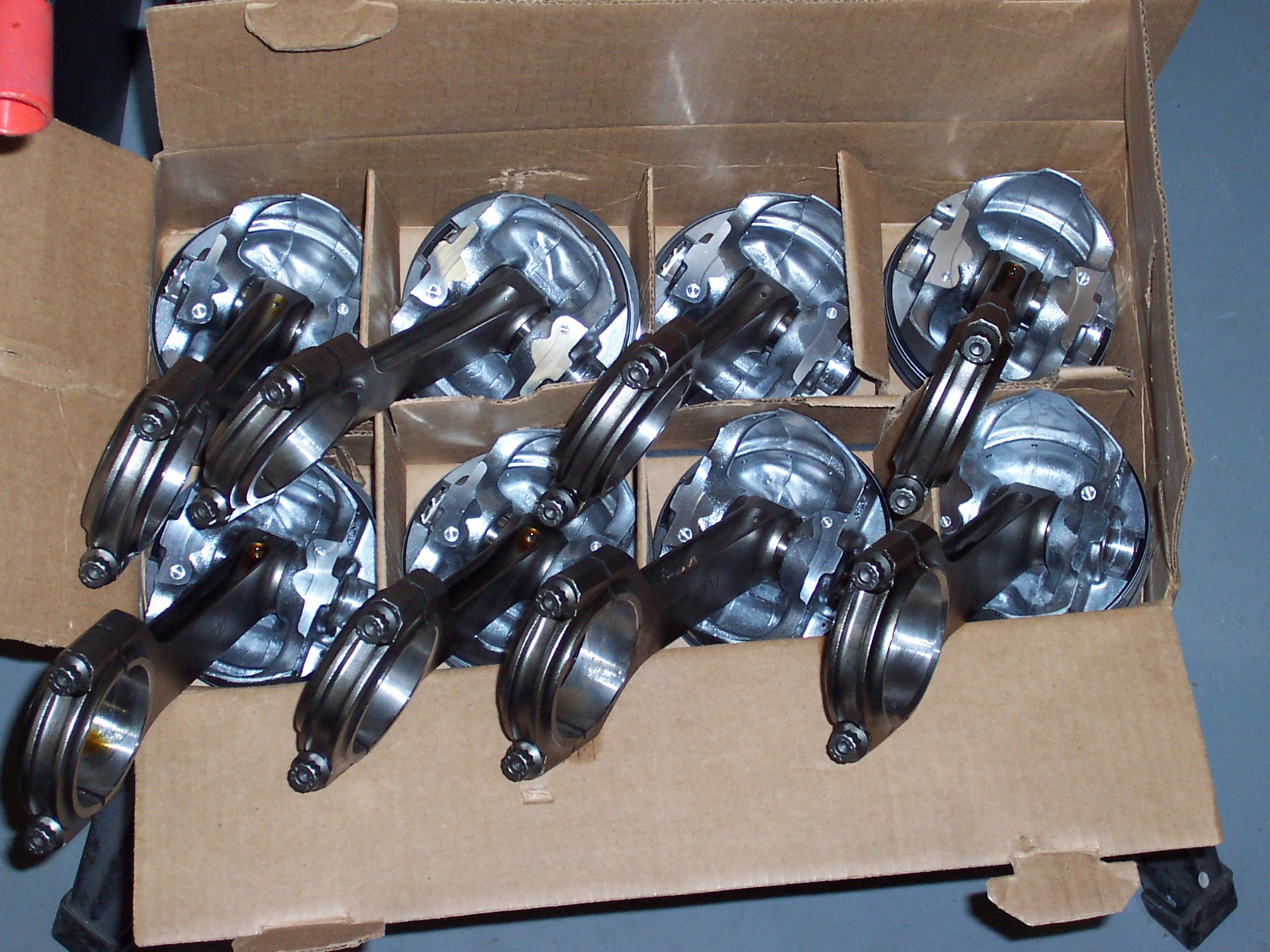

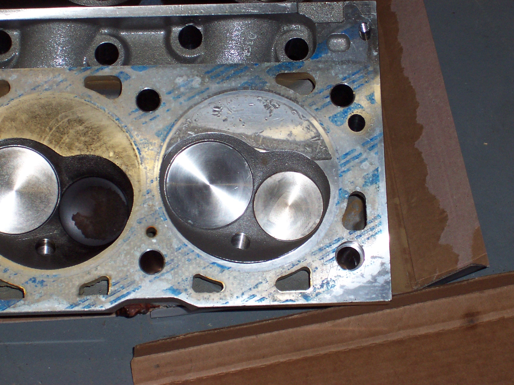

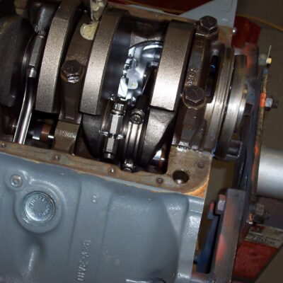

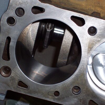

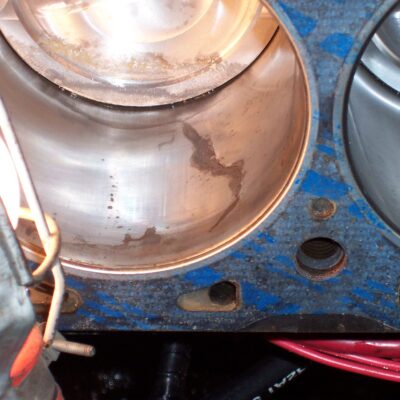

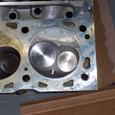

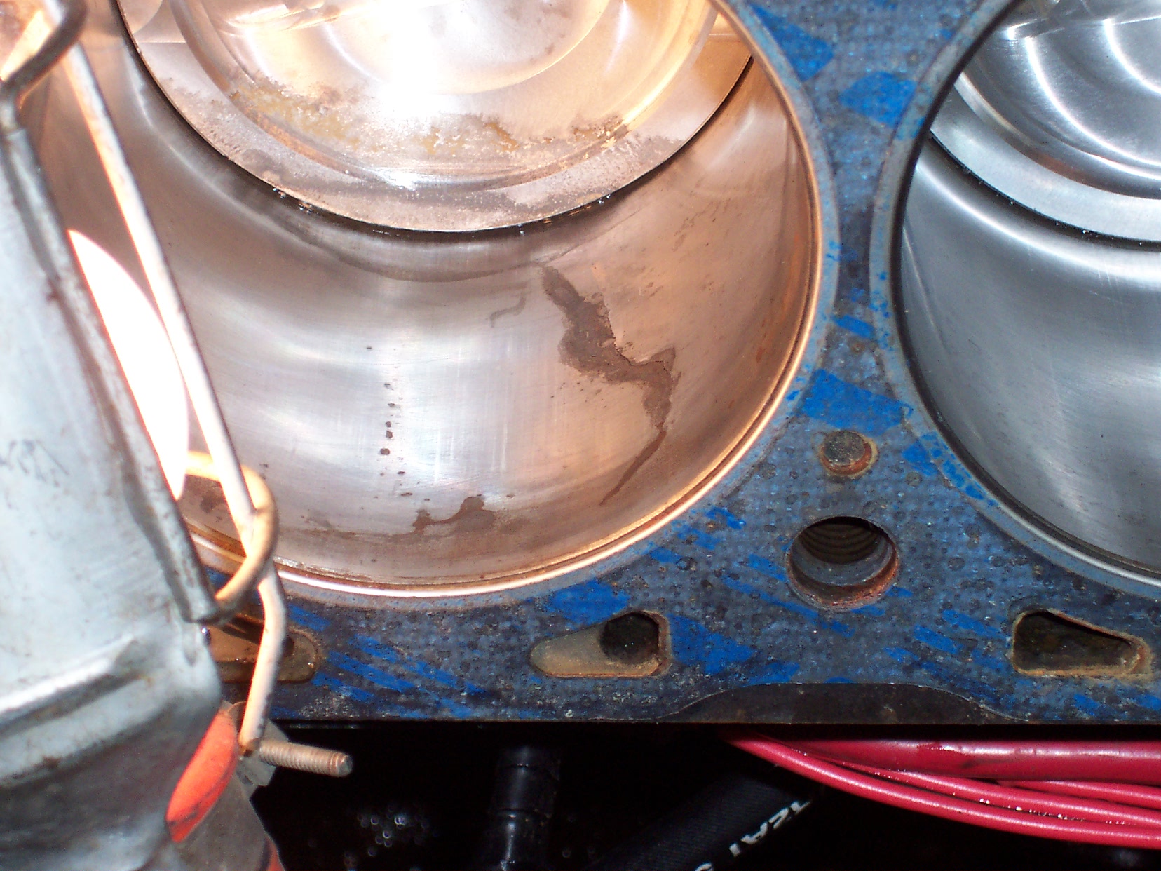

Water began dripping from one of the header tubes. What followed was the kind of discovery every builder dreads—a cracked cylinder wall, damaged piston, and clear signs of internal contact.
The cause? Loose connecting rod bolts that had been overlooked during assembly.
It was a hard lesson—and one that meant pulling the engine back out.
Tear Down and Redemption

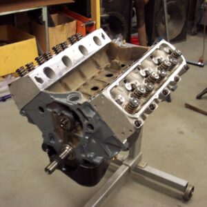

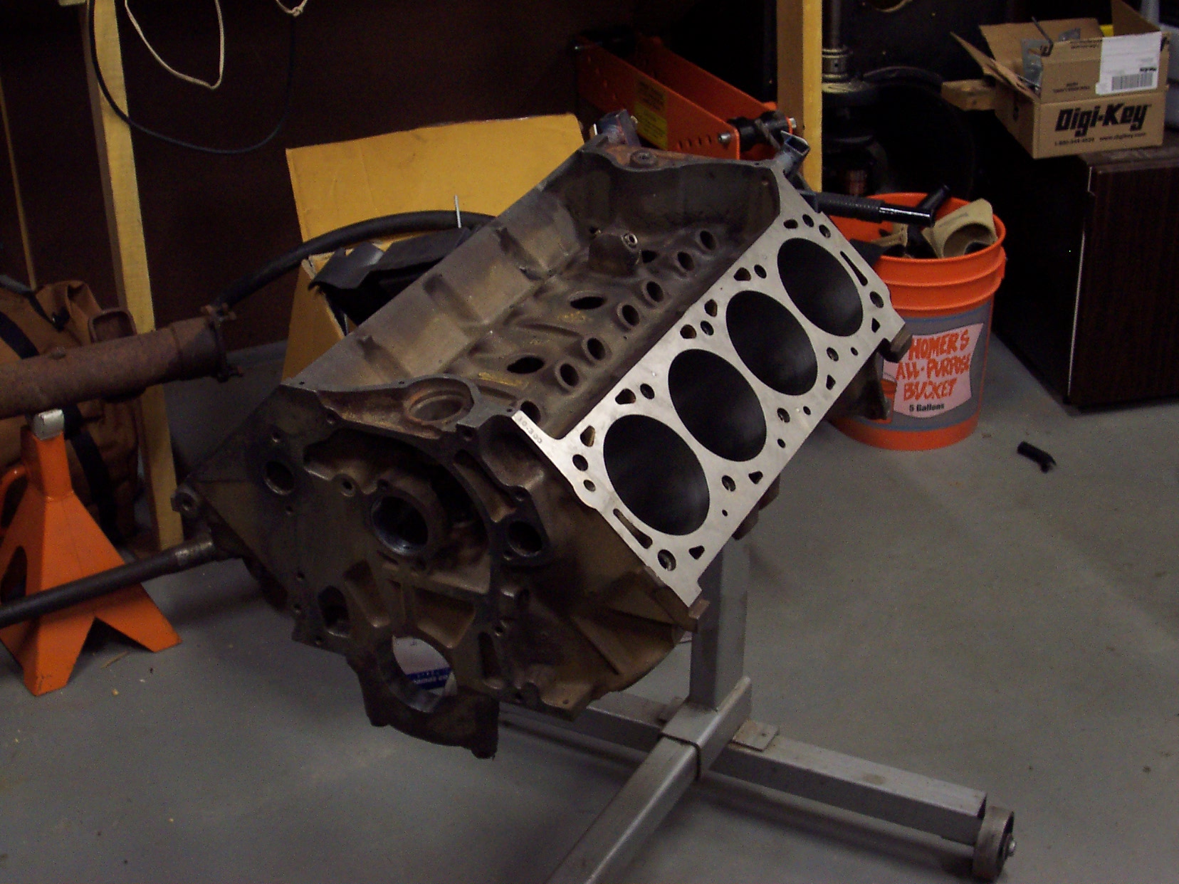

The engine was completely disassembled and sent to the machine shop, where the damaged cylinder was sleeved and the affected components repaired or replaced.
A new piston, fresh rod bolts, and careful reassembly brought the big block back to life—this time with every detail double-checked.

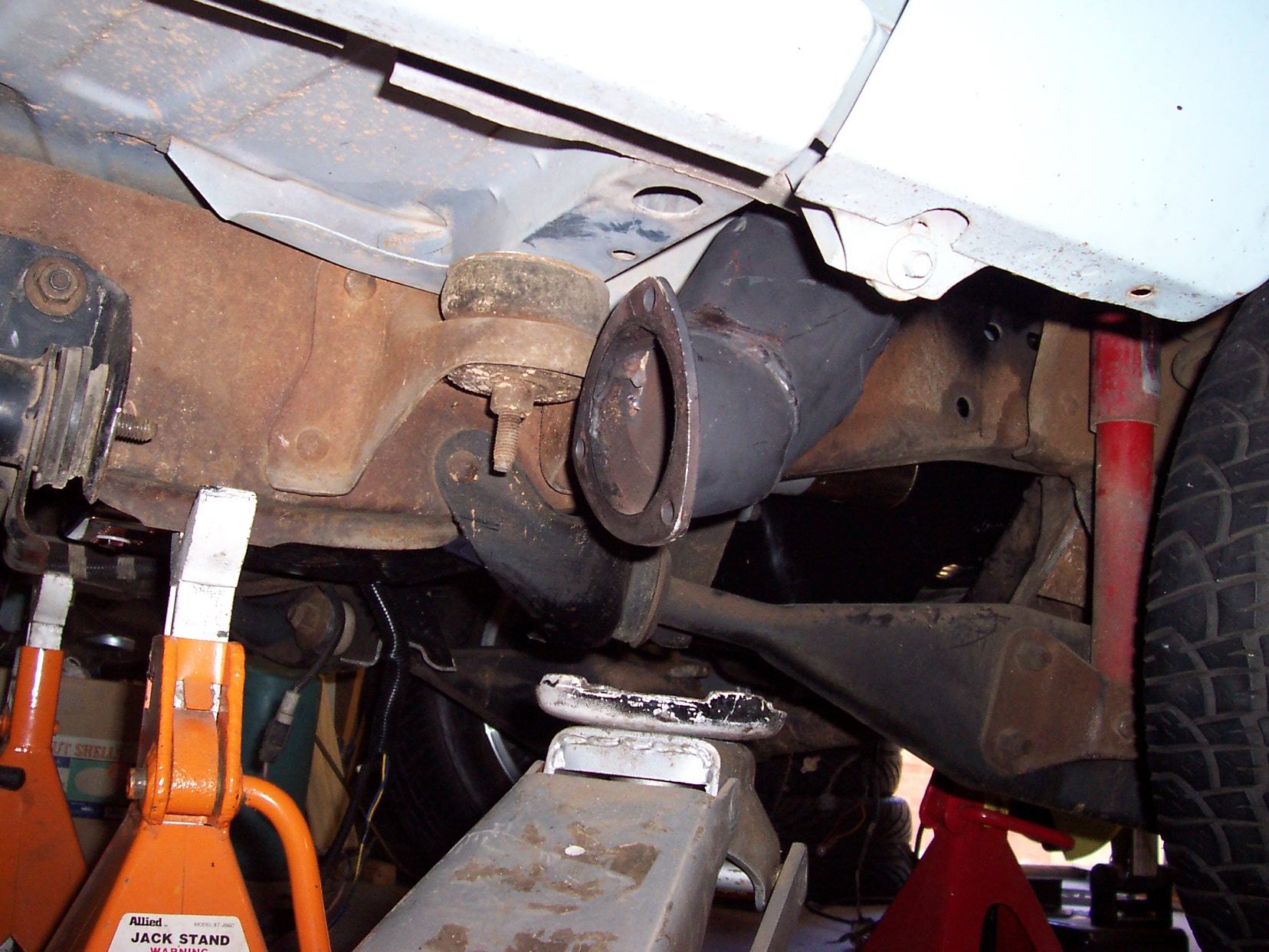

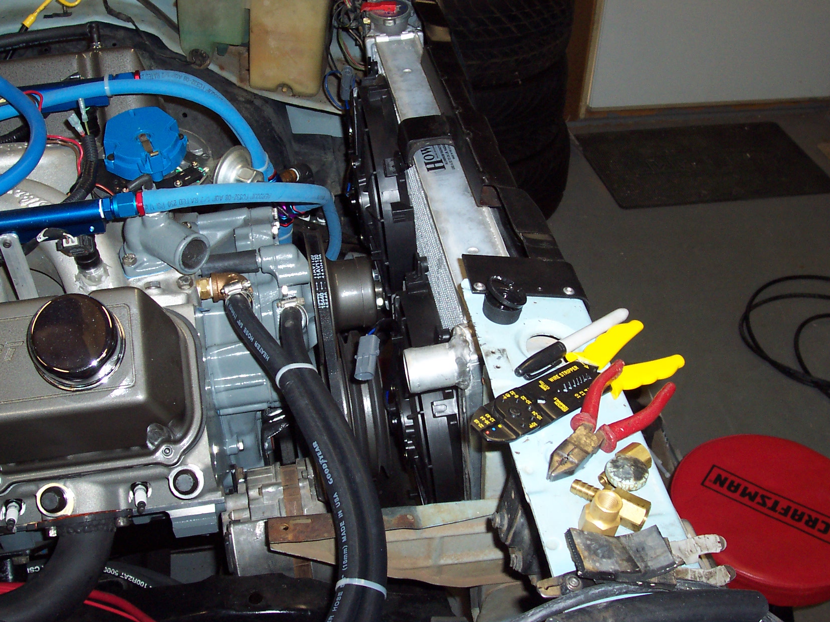

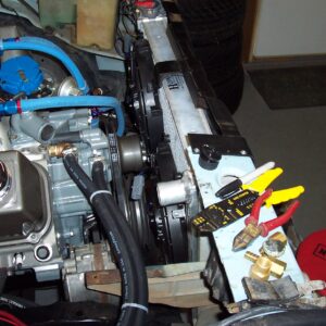

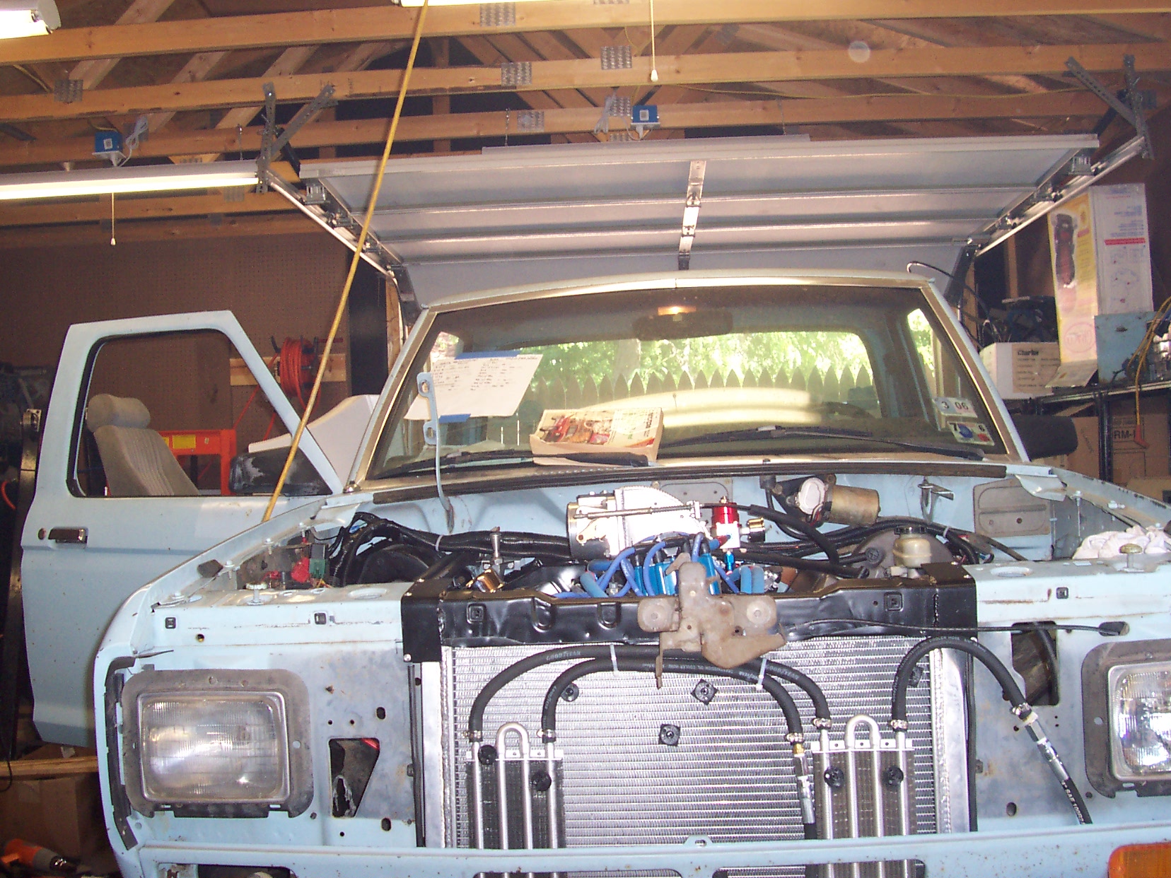

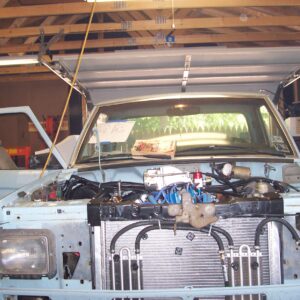

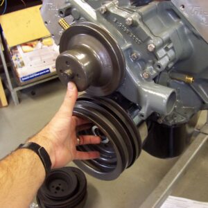

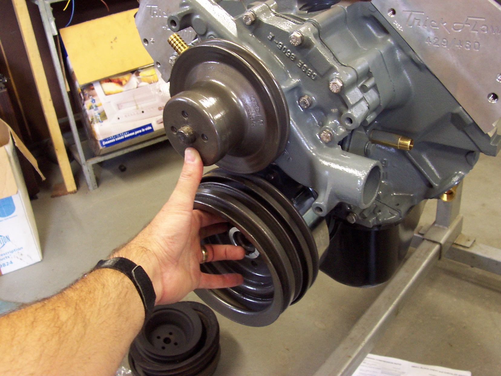

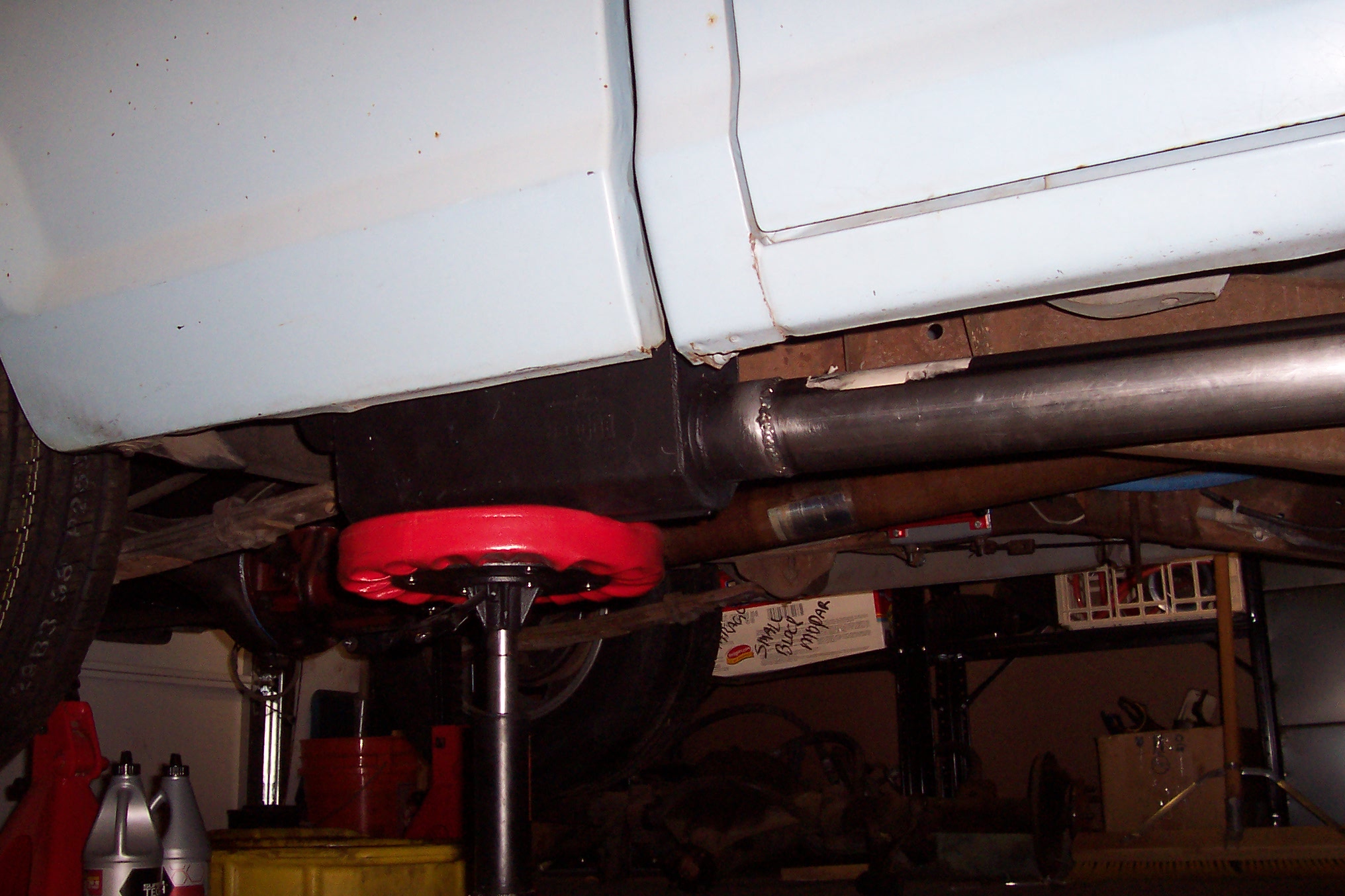

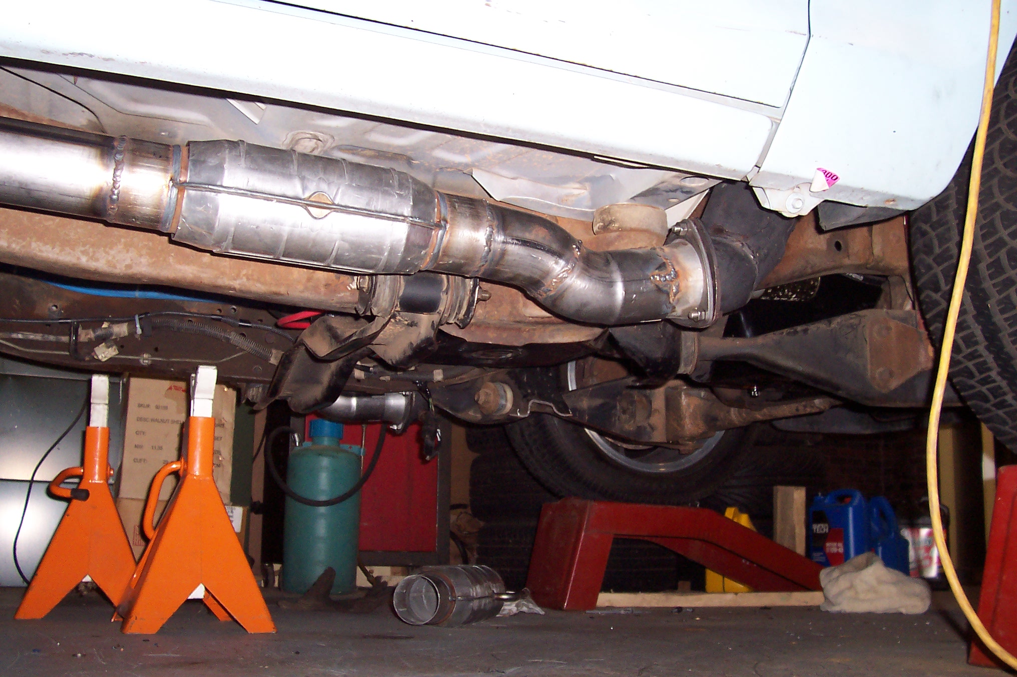

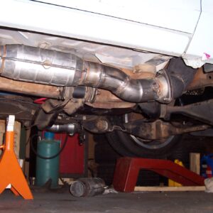

The exhaust system was completed with catalytic converters to keep things street-legal, along with performance mufflers and turn-downs exiting ahead of the rear wheels. Dual electric fans were installed up front, taking full advantage of the limited space created by the short water pump setup.
The fuel system, cooling system, and wiring were finalized, and the truck finally stood as a complete, running machine.
