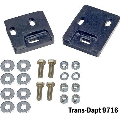

Trans Dapt P/N 9716 – 2WD Motor Mount Bracket For 1983-1997 Ford Ranger 2WD (Requires stock V-8 Motor Mount)

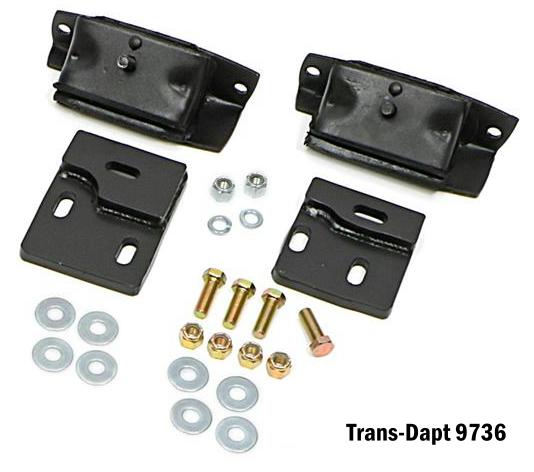

Trans Dapt P/N 9736 – 2WD Motor Mount Kit For 1983-1997 Ford Ranger 2WD (Includes mounting bracket & motor mount)

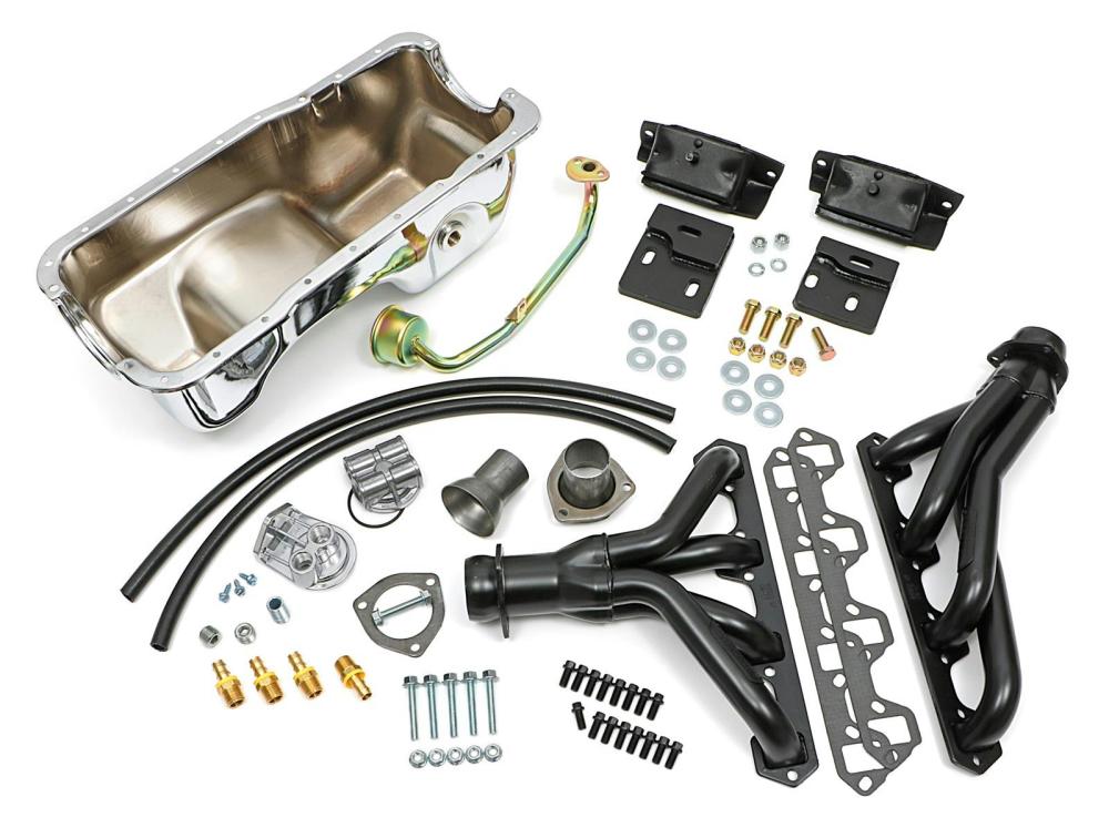

Oil Pan:
The first consideration is the oil pan on your engine. Ford engines of the 1960’s and 1970’s generally used front sump oil pans. These will not fit the Ranger/Bronco II chassis properly. Instead, a rear sump or dual sump oil pan must be used. Rear sump oil pans are originally used on full-sized trucks and Econoline vans and hold (6) quarts of oil. They are the preferred oil pan as the extra quart of oil is of somewhat of an advantage for performance and off-road applications.
The other choice is a dual sump oil pan. These are easy to spot because they literally have two sumps, one at the front and another at the rear with a drain plug on each. The front sump is for clearance to the oil pump and the rear sump is the reservoir for the oil. The biggest advantage to the dual sump pans is that the engine may be situated about half an inch lower in the chassis.
  • 302/5.0L dual sump oil pans were originally installed on:
  • 1979-1995 Ford Mustangs
  • 1980-1993 Ford Crown Victoria’s and Grand Marquis
  • And a few others.
Please note, 1980’s Crown Victoria police cars are the only vehicles with a 351W that use the dual sump oil pan. If you need the dual sump pan for a 351W, you’ll have to find one from a police car or order one for that application.
Advance Adapters P/N 71642 For Ford 302/5.0L
Ford Racings P/N M-6675-A50 For Ford 302/5.0L
Exhaust:
You basically have (3) choices when it comes to exhaust manifolds for your V-8:
1) Early to mid 1970’s exhaust manifolds
2) Explorer 5.0L exhaust manifolds
3) Advance Adapters exhaust manifolds
1996-1998 Ford Explorer 5.0L Tubular Exhaust Manifold
1996-1998 Ford Explorer 5.0L Cast Exhaust Manifold (no smog)
Advance Adapters P/N 717044
1970’s Ford 289, 302 or 351W Exhaust Manifolds
The problem with exhaust manifolds is having enough clearance between the engine and frame rail. The nice thing about the 1970’s exhaust manifolds is that they don’t have any downward flanges that might point the exhaust in to the frame rail. An exhaust shop will easily be able to plumb an exhaust system that will clear the frame rail and firewall.
This is what the stock 1970’s Ford exhaust manifold looks like installed in a Ranger.

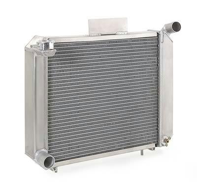

Radiator – There have been many members of The Ranger Station forums that have used the stock 4.0L radiator successfully with a small block Ford V8. If your Ranger doesn’t have a 4.0L in it now, look for a radiator from a 1991-1994 Ford Explorer which is a direct bolt in. The 1995+ Explorer radiator will require modifications to the core support to get it to fit.
The only issue that the stock radiator may raise is clearance. Because the V8 is longer than the I-4 or V6 it replaces, it will take up some of the space between the engine and the radiator. Not all Ford water pumps are the same depth. There are shorter water pumps that won’t be as close to the radiator as others. Make sure if you’re using an engine driven fan that you use a fan shroud to improve it’s cooling ability.
Advance adapters offers a replacement radiator for your V8 swap:.
  • P/N 716683 – 4-core brass radiator
  • P/N 716696-AA – 2-core aluminum radiator w/transmission cooler
Summit Racing carries radiators from Griffin and AFCO that are designed for these swaps.
While some people feel the Ford Explorer 5.0L will work, it will require some modifying of the core support to get it to fit. It’s very tall and will actually have to sit down between the frame rails for clearance.
Advance Adapters P/N 716683 Shown Above
AFCO Radiator

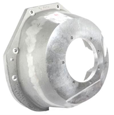

On some transmissions, such as the C4, Ford has used a variety of bellhousings, flywheels, and starters over the years. Whenever you have a choice, use the smallest diameter flywheel and bellhousing available to you to install the V8 into your Ranger. The bellhousing bolts are already extremely tight to the firewall. You do need to use the correct starter and flywheel for the bellhousing your using, regardless of which transmission you choose to install. Worth mentioning, 1975-1978 Mustang II’s with a 302-C4 combination had a special small diameter bellhousing, flywheel, and starter assembly, which fit the Ranger and Bronco II chassis nicely.
J.W. Performance Transmissions makes a ULTRA-BELL bellhousing for the C-4 tranny. It fits 157 tooth flywheel mated to a small block Ford. I purchased one of these for my V-8 conversion. This is a nice heavy duty piece although it is not SFI approved for racing. In my area the factory 157 tooth bellhousings are rare and hard to find. JEG’S offers these at this time for $149.99. JEG’S P/N 564-92480. (This paragraph submitted by Marc)
P/N 564-92480

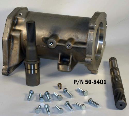

Advance Adapters carries (3) different conversion kits for the C4. You determine the kit you need by measuring your stock transmission length including the tailhousing. The you choose a kit that will give you the same overall length (O.A.L) as your stock setup.
C4: The C4 is 17″ long. Combined with the new adapter length, use the best adapter suited for your application.
P/N 50-8400 – C4 to Borg Warner 1350 T/C. Adapter length of 6.812″ O.A.L. 23.812″.
P/N 50-8401 – C4 to Borg Warner 1350 T/C. Adapter length of 11.5″ O.A.L. 28.500″.
P/N 50-8402 – C4 to Borg Warner 1350 T/C. Adapter length of 8.75″ O.A.L. 25.750″.
Tailhousing & Output Shaft
